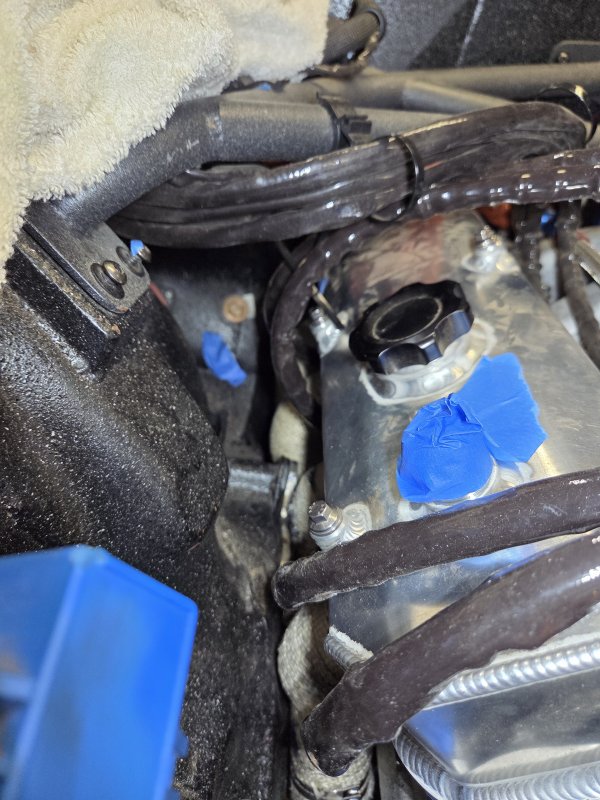

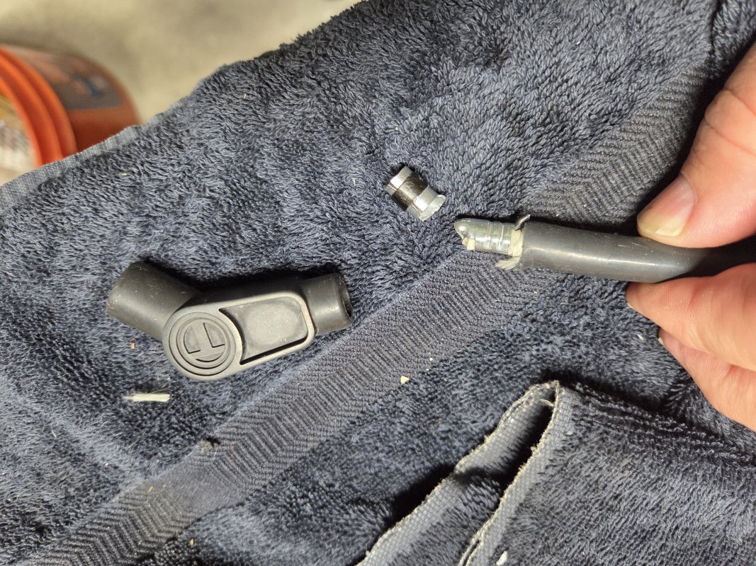

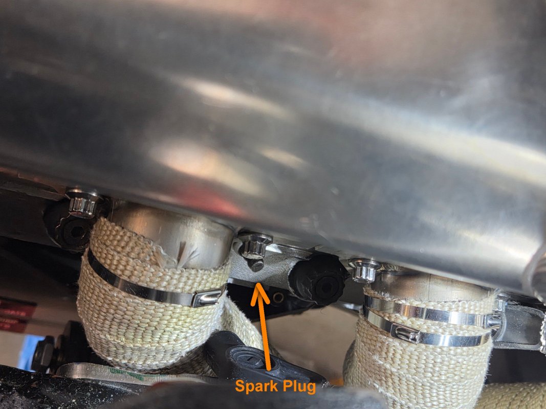

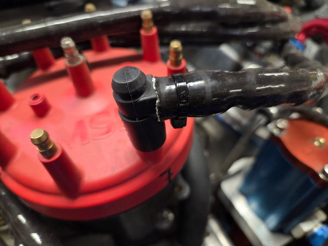

Spent the last few days (well a few hours, still sad) trying to get a spark plug wire on the #7 Cylinder on the Tiger. Not much room, non-cooperative plug boot, and finally a broken spark plug connector. Not sure why so hard but ruined a spark plug wire as I broke the contact in half after trying to get it on the plug. Bottom line is that the 135 degree plug wire will not work on this cylinder (possibly others). Part of the problem is the thick header flange and how close the bolt is over the plug which prevents easy
positioning of the wire boot around it.
So off to Summit for more wires. Snapping the wire on the plug is easy if you can get you hand in and apply pressure at the right angle and strength. Can't quite do that, tried to use a small piece of metal to try to pop it on, all that did was scratch up the paint on the support brace
Going to try a straight boot for this one and see how it goes. Also ordered some spare metal clips for the spark plug to see if I can repair the one that is broken or get broken. The wires are F'n expensive these days

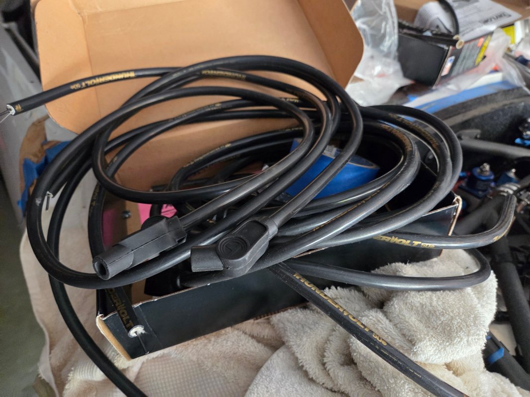

Laying out the wires, 1 out of 8 connected to a plug. Driver size is difficult to get them on the plugs.
Box number 2 cracked open (steeling from the Mustang Project). Taylor 409 10.4mm wires are nice!

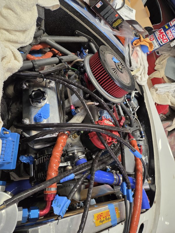

After trying to get #7 wire on, this was the results of trying. Going to try a straight plug boot on the problematic ones.

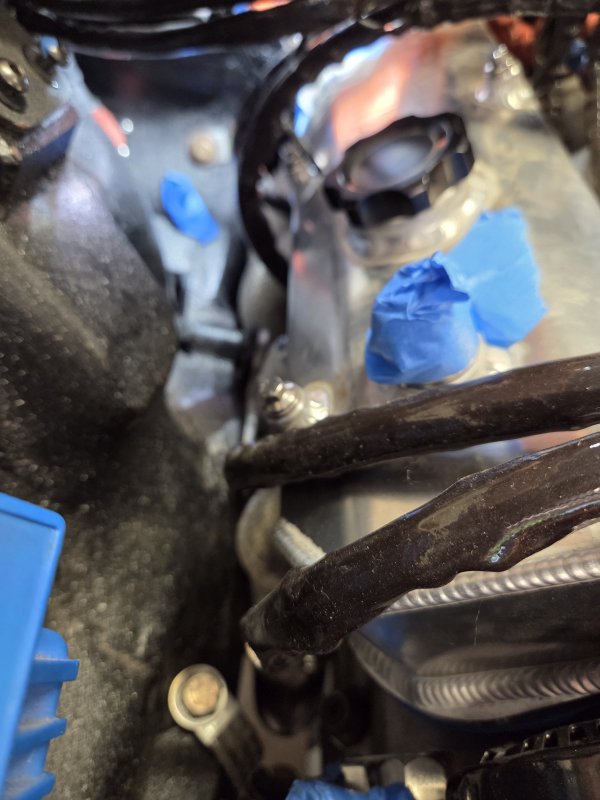

The driver side has really limited access to getting your hand in the rear 2 cylinders due to the steering shaft. I should really just take it out and put the wires on, but not good to need to do that so going to try a straight (180 degree) boot.

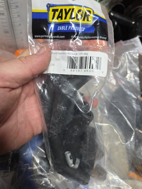

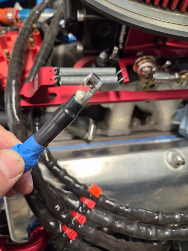

All wires and plugs in and good to start routing to the distributor. Found a replacement part for the clips from Taylor, figured I would give it one last try with the 135 degree set. Seemed to do the job! Got all the plugs in without too much trouble (well the #8 plug had to be put in prior to header install).
All header tubes installed as well. Moving along!

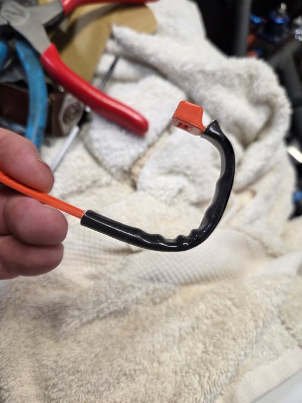

The broken plug clip
The same clips used in the 8mm wires, had to get the boots, but what can you do.

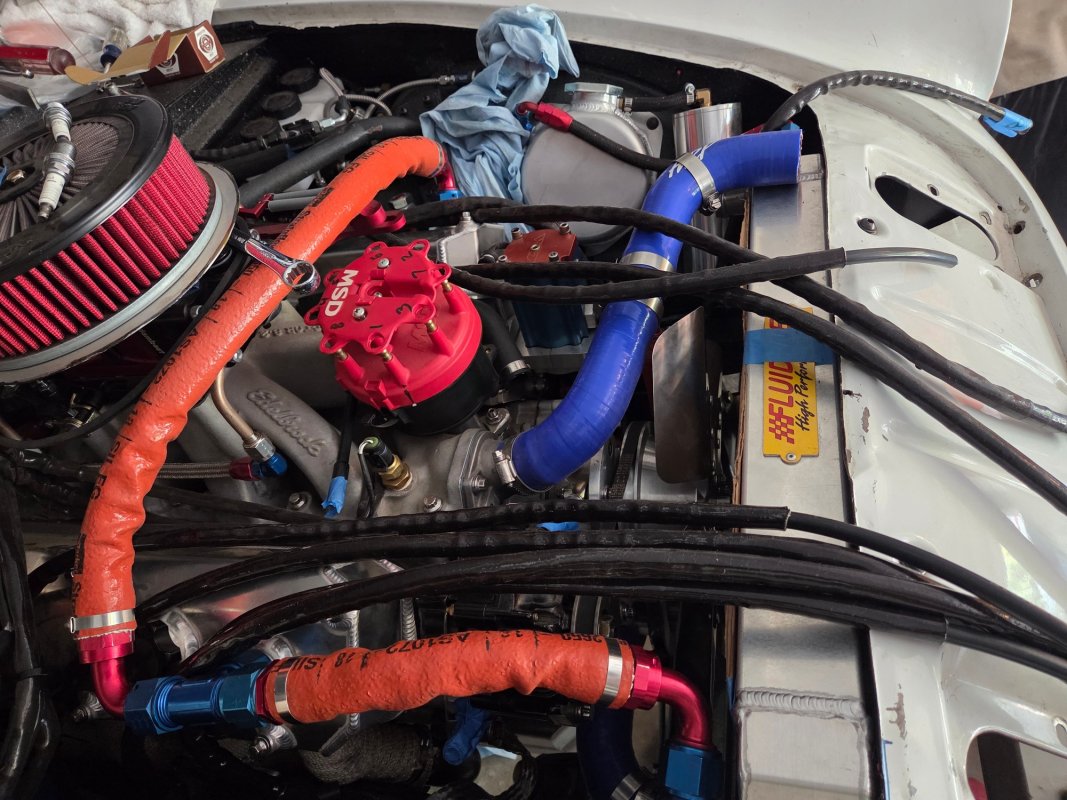

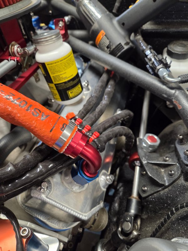

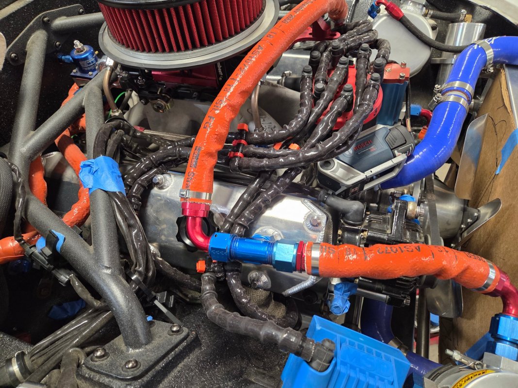

Good to go on this side, plugs installed, and all header tubes on
Little different angle, it's tight

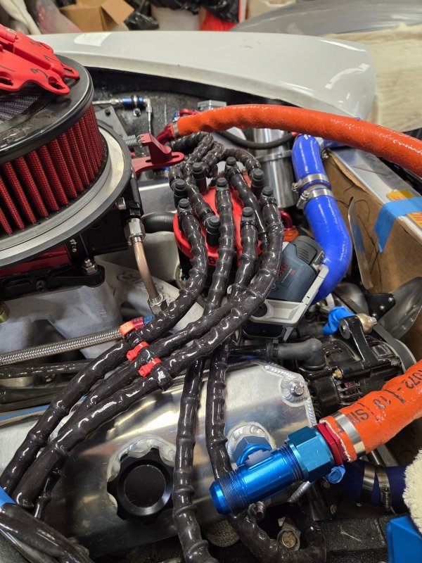

Passenger side, all plugs, tubes and wires installed!

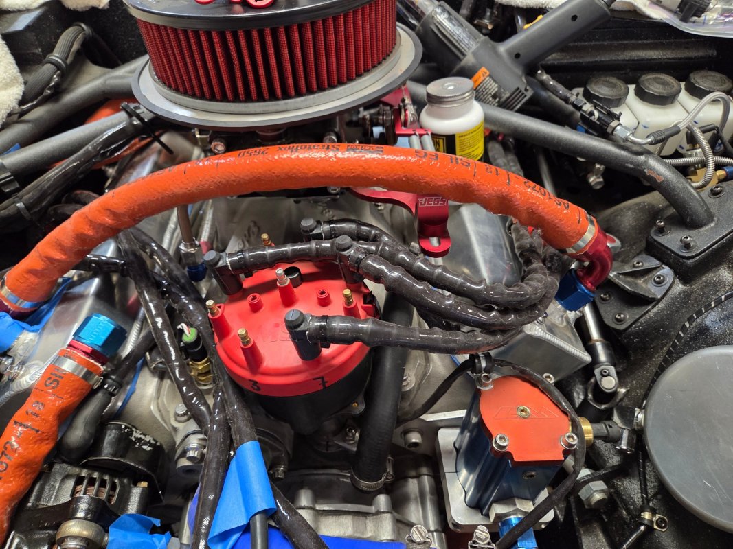

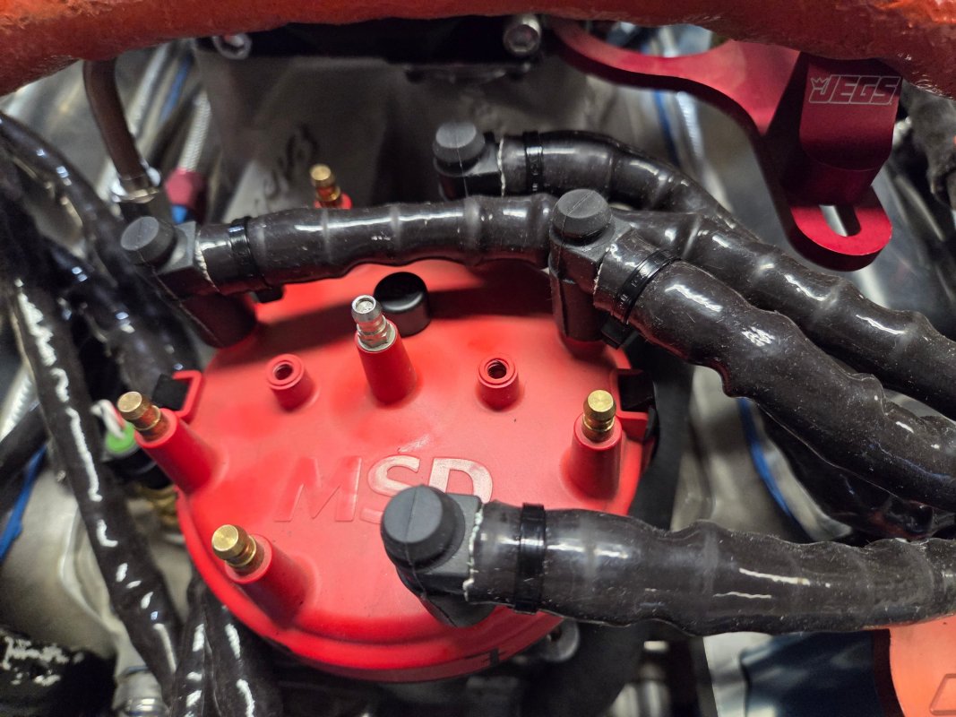

Now to route and connect to the 'Dizzy'

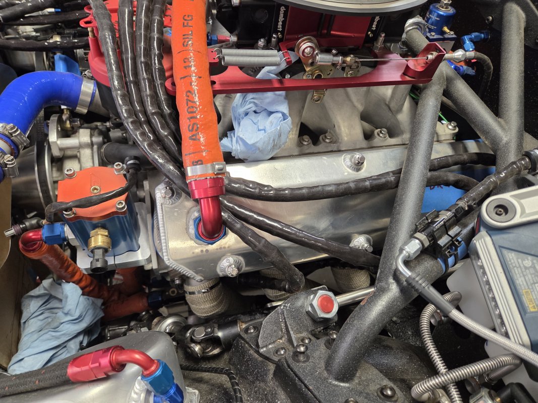

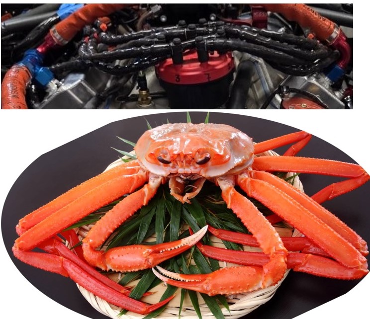

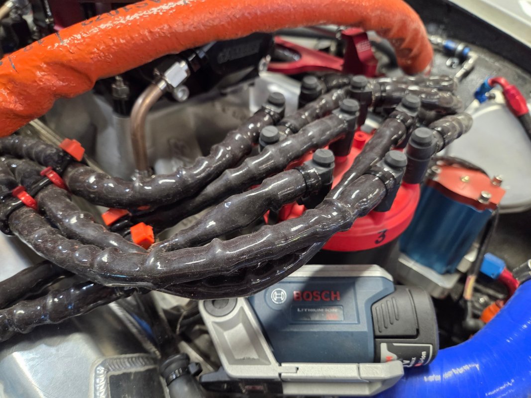

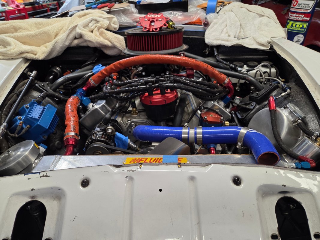

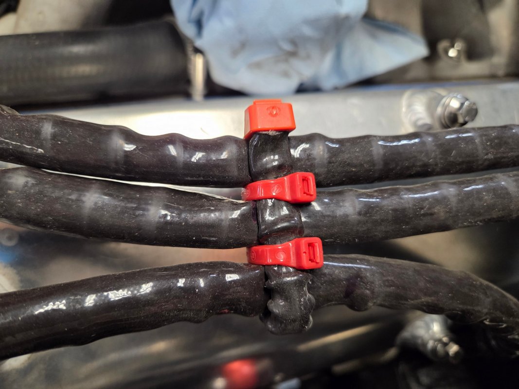

The wrap up, all wires done, wire separators made up, and coil wire done.

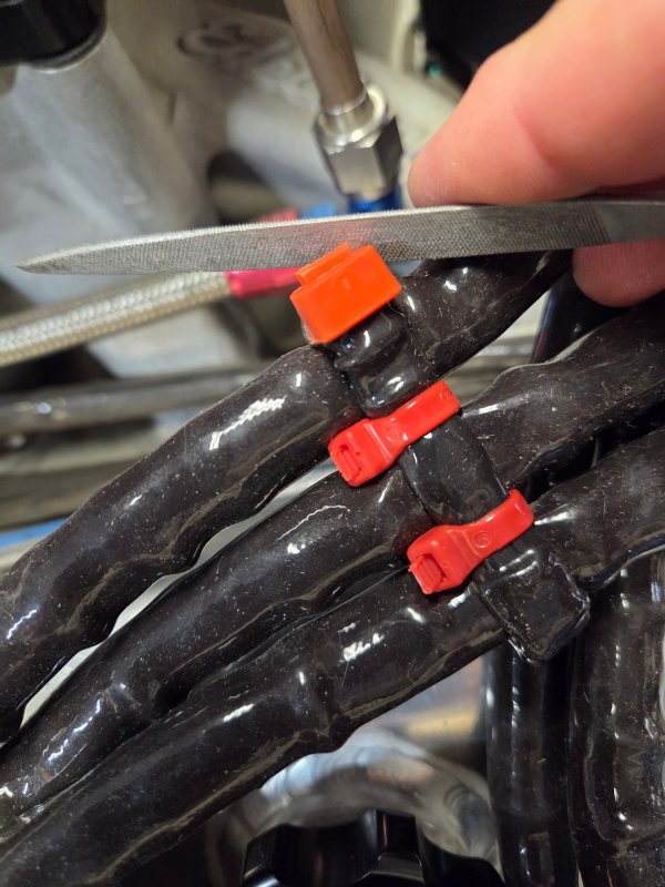

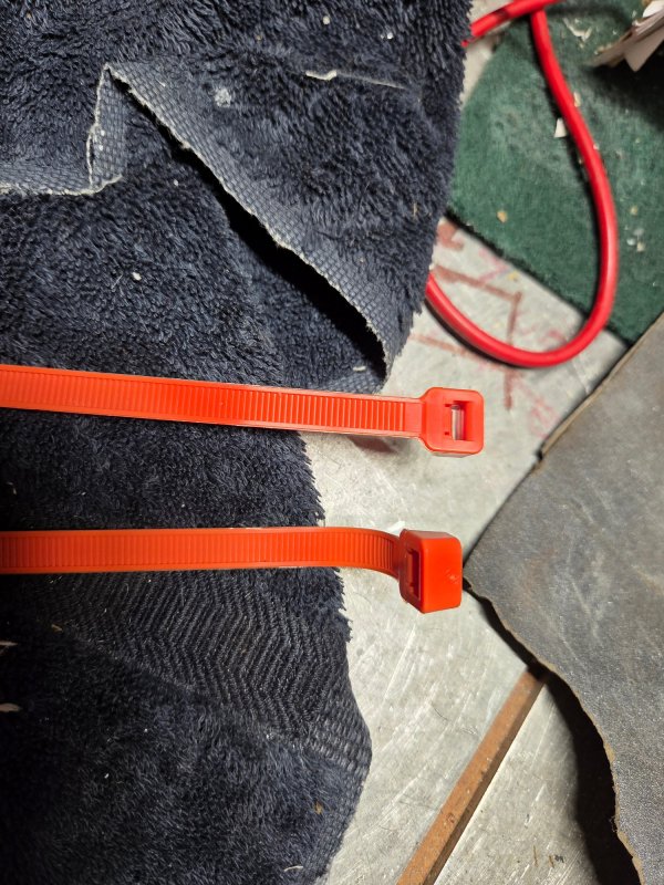

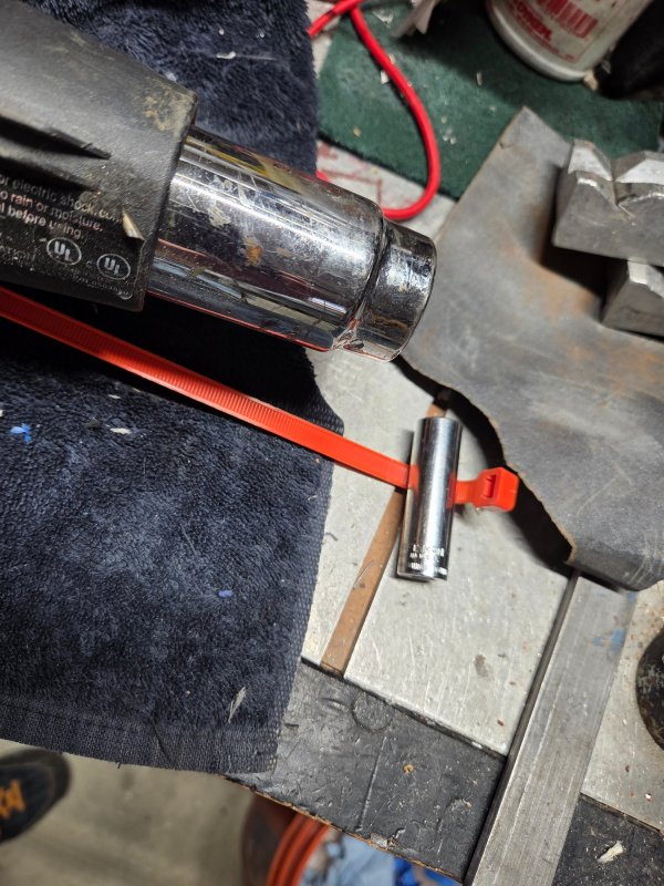

Made up some 'Custom' wire separators out of Ty-wraps. Seems like they will work fine. One KEY think that must be done is to file the edges of the cut portion or you will be bleeding later.
