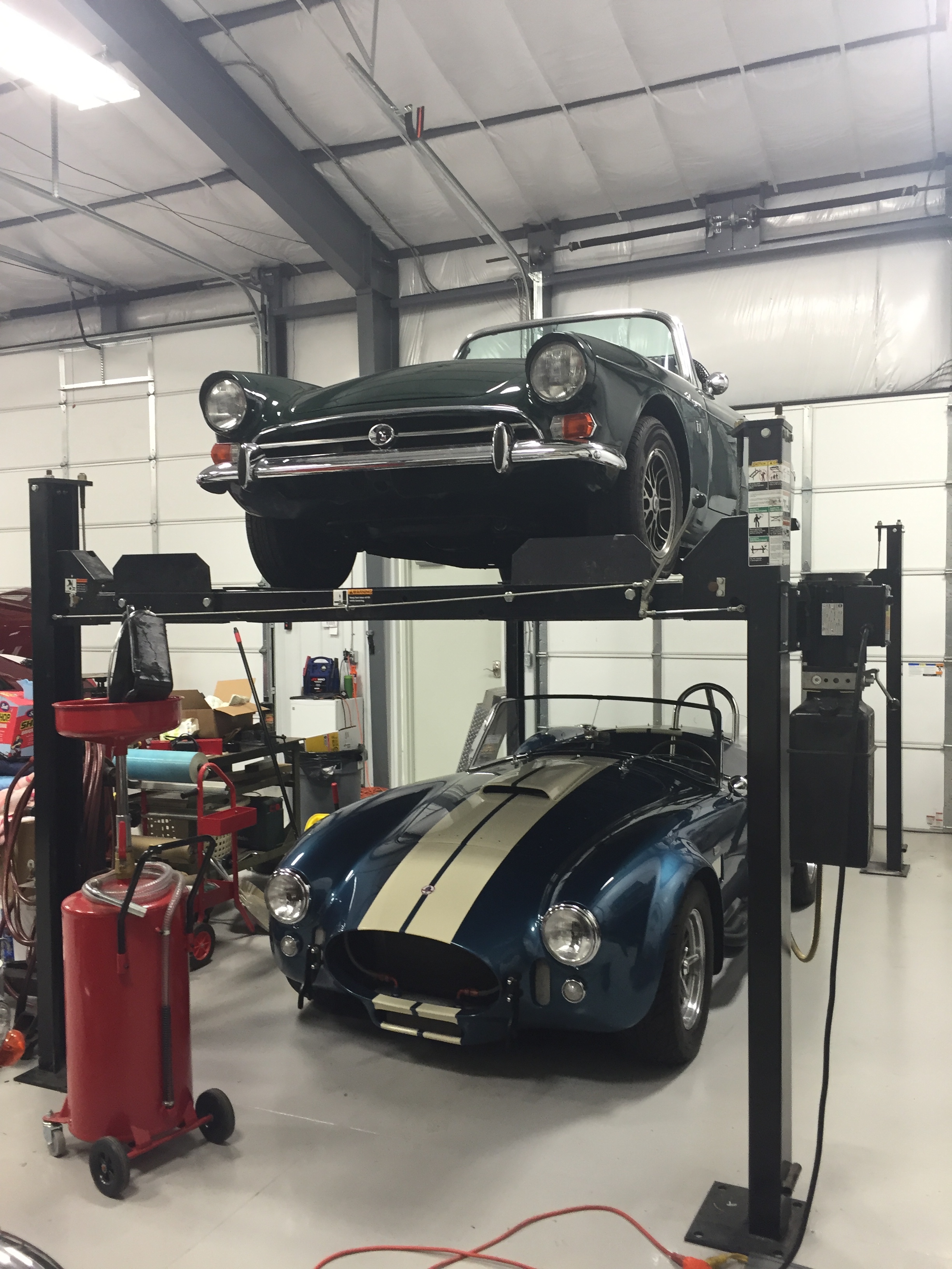

I have a 4 post lift with a rolling or sliding center jack. The 4 post is nice to get all 4 wheels off the ground, but it's hard to jack up the wheels. The sliding/rolling jack is an accessory (extra), but is great for lifting two wheels up. Some people get 2 jacks and lift all 4 wheels up at once. The 4 post is also great for storing cars. (one car up and one car below). The 2 post has it's advantages too, but I've never had one. I got mine a long time ago and company is out of business. Wide variety in prices and quality I'am sure. Cliff
Lifts

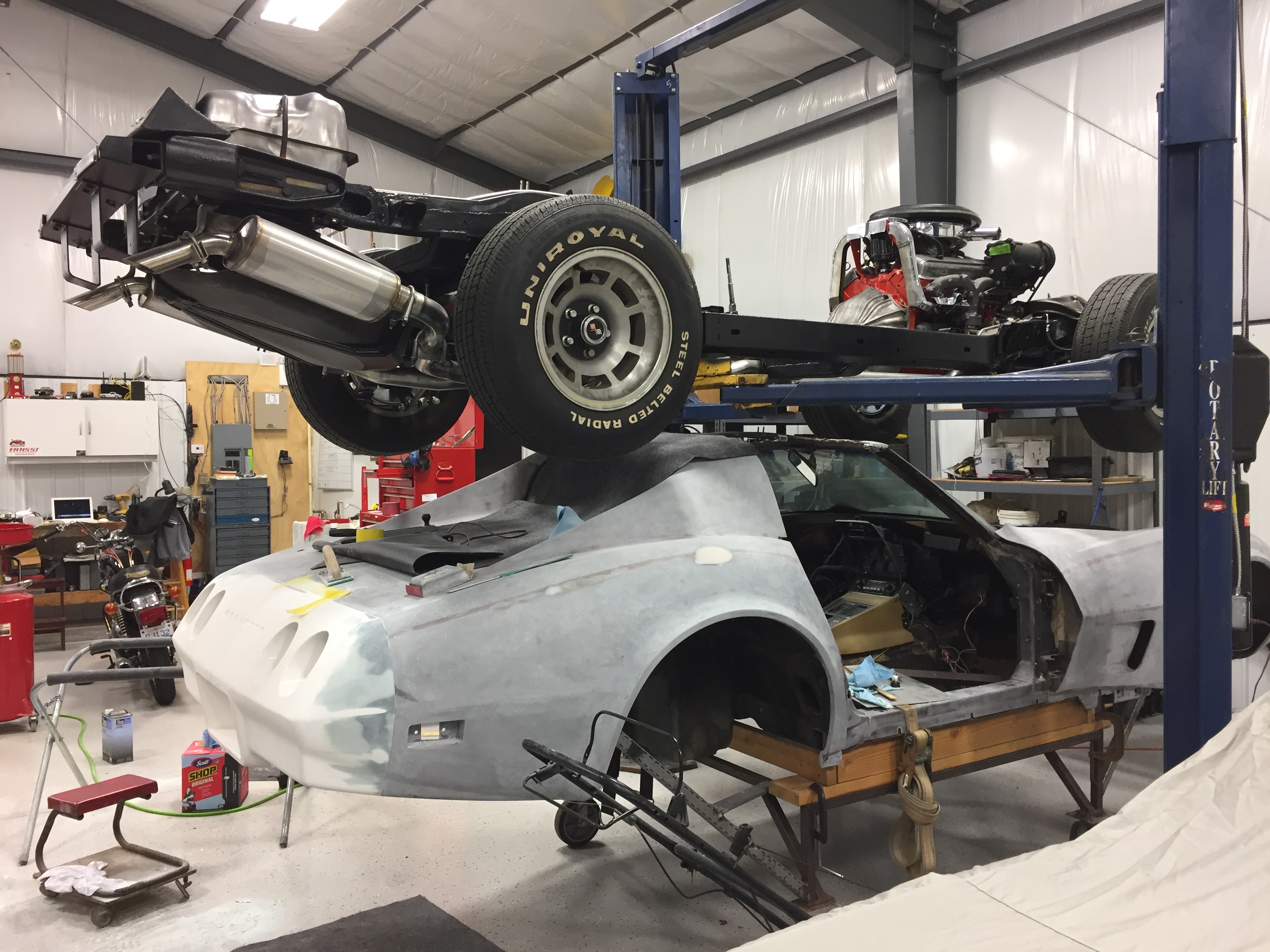

I have a Greg Smith 4 post with the sliding hydraulic scissor jack and an additional jacking tray and a full set of drip trays. It is a very good pice of equipment. I also have a Rotary two post asymmetrical hoist. I use the 4 post for the most part with the Tiger or my other unibody British cars. The 2 post I think works better for me with my older Corvettes which have a proper frame as well as my modern cars. They both have their plusses and minuses, but if I could only have one lift it would be the 4 post.
I acquired the Rotary lift from an Oldsmobile dealership when Olds went out of business at such a reasonable price I could not pass it up. It was a bit of an issue to remove it and transport it to my home shop.

A couple of pictures if this works!..............

We find use for both, BUT, the 2-post seems more versatile for the Tiger needs. Our Cobra pal has a neat set of drive-on scissor ramps that raise the cars to an ideal walk-up working height. Reaching under the dash thru an opened door without gymnastics is a plus.
I'm loving my Bendpak HD-9ST. It is narrower than most lifts because space was an issue for me. I also didn't want to have to anchor it to the floor or have a thick concrete pad.

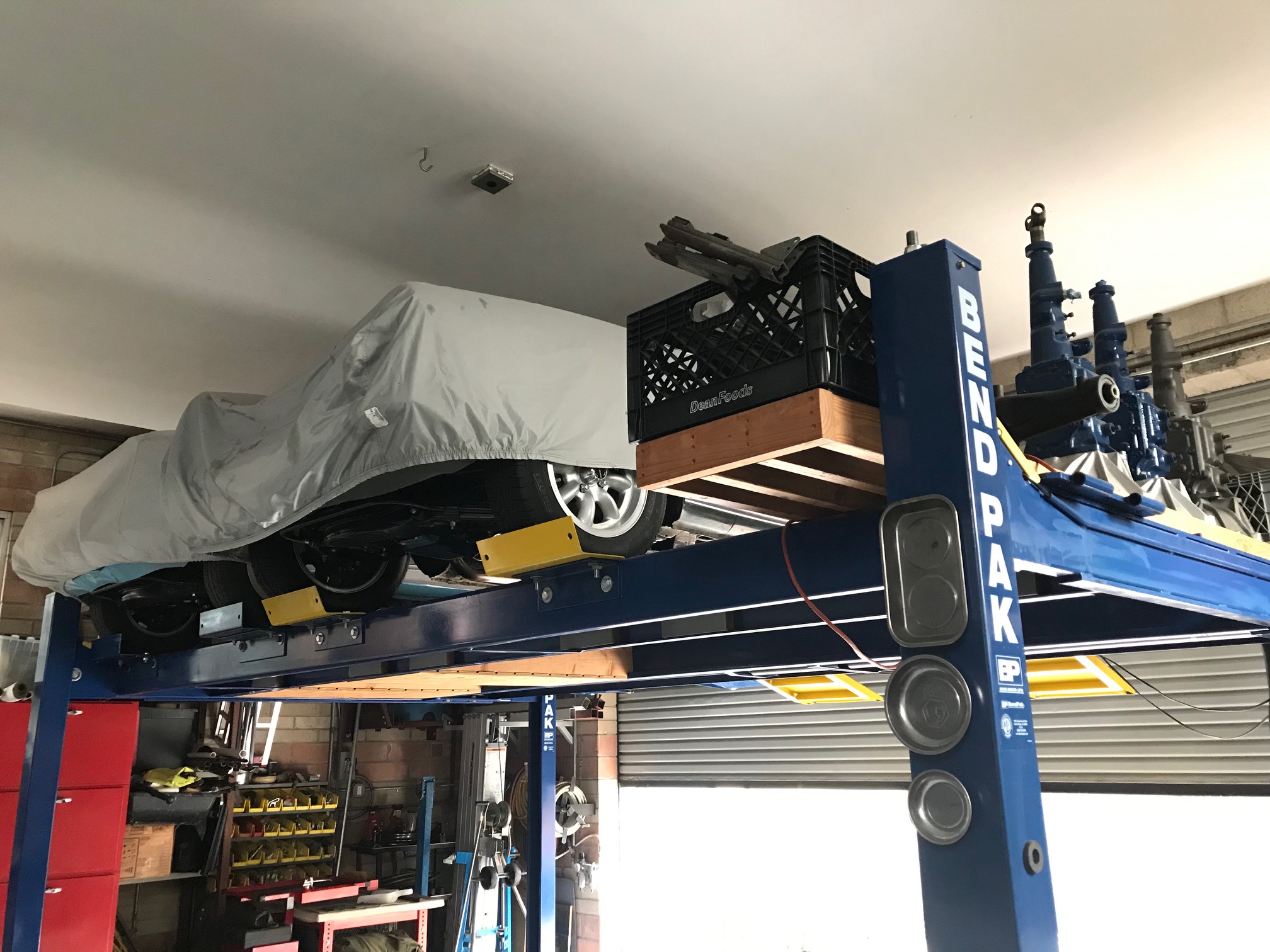

I went with BendPak 4 post lifts through the years. They used to be 100% made in the US, then parts were imported, now the entire thing is made overseas.
my suggestions:
go with the high lift version
get the longest and stoutest one you can afford
buy new, it's of course more expensive but the used ones are generally thrashed
when they deliver ask them to send out the truck with the onboard crane so they can just drop it on you driveway
install it yourself, it's not that hard
bargain on the price. all these garage equipment guys sell the same stuff and they beat each other up on price
that rolling jack is expensive but worth it
if you buy the extra wide, long and tall lift you can store 2 sunbeams sideways with some custom ramp work (thanks Buck for the suggestion)
I've stayed away from 2 post lifts because I live in CA and we have earthquakes here.
Also, type 'car lift accidents' into youtube and all you see are cars and trucks falling off of 2 post lifts. Additionally unless you have a high quality 5" thick slab with #6 bars running 12" oc your foundation will be inadequate.
Lastly I think it has to be a bad idea to have the suspension hanging down for long periods of time if they are used for storage.
