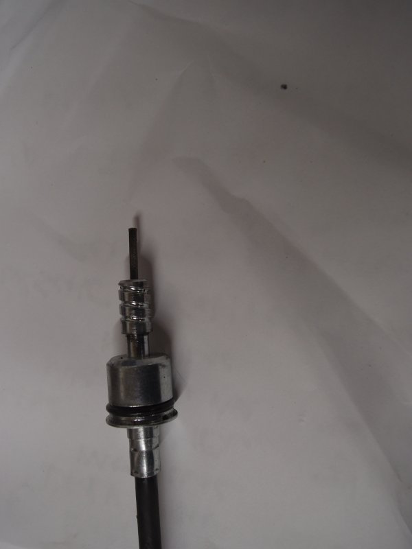

A picture below to illustrate the issue. With the speedo cable inserted into the gauge to it's collar and an o-ring on the drive end to eliminate cable preload on the gauge the cable extends past the gearbox connection by 3/4". The plastic gear for the speedo drive bottoms out on the cable before you can install the gear retaining clip (by 3/8"). If I didn't have the o-ring on the drive end of the gauge the cable would extend past the gearbox connector by 7/8" and the clip position would be off by 1/2".
The gear will fit with a maximum of 3/8" of cable extended past, Anymore and the cable will either bind on the speedo or the gear will bind. Either you'll get a stripped gear, or a snapped cable.
I measured the inner cable and it's 83" long. The outer sleeve is 81.5" long. The cable assembly would work if one of the following modifications were done. The cable was 1/2" shorter, or the sleeve was 1/2" longer. With these dimensions the o-ring probably wouldn't be required, though I'd still use if for safeties sake.
