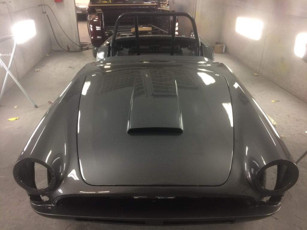

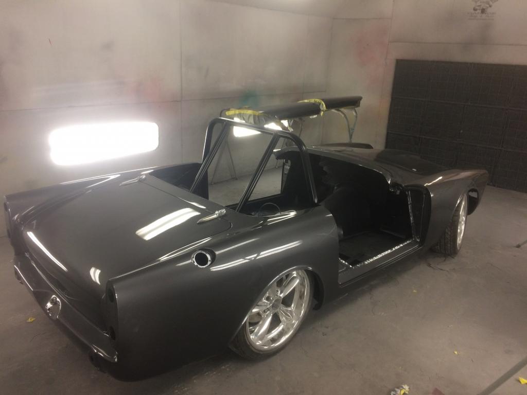

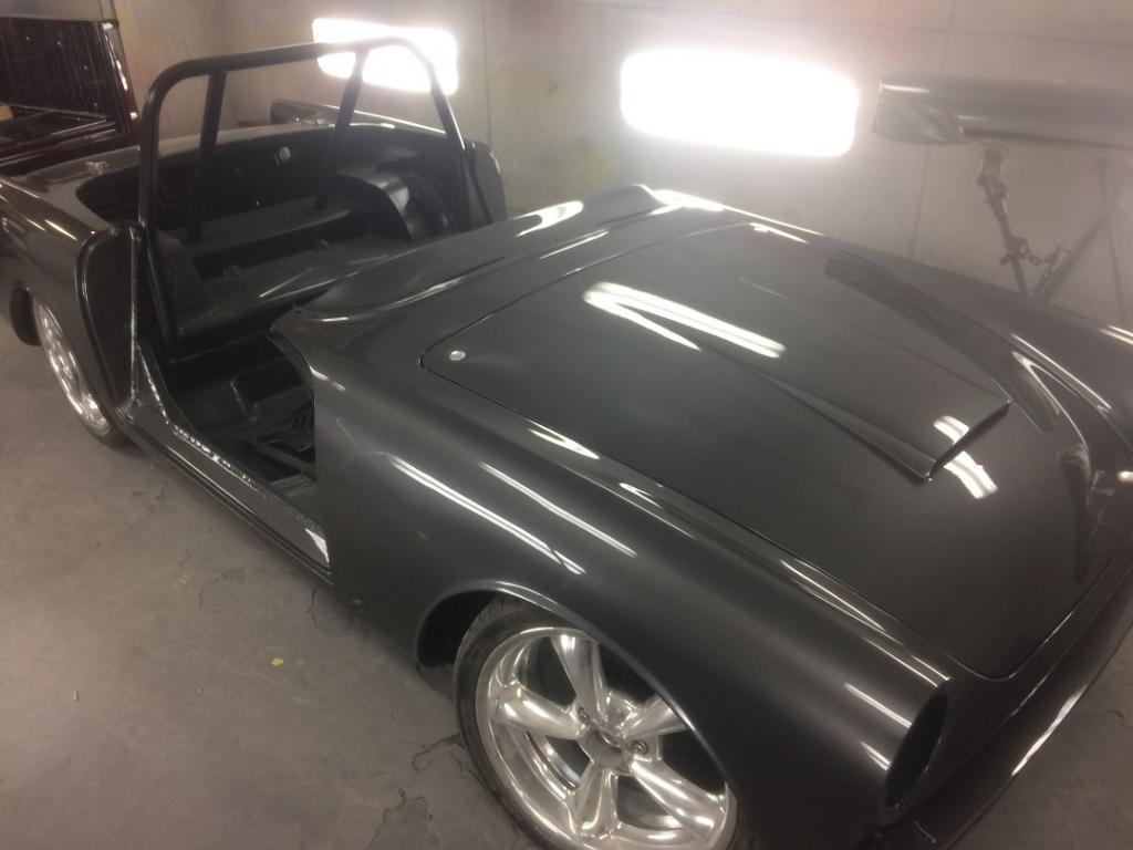

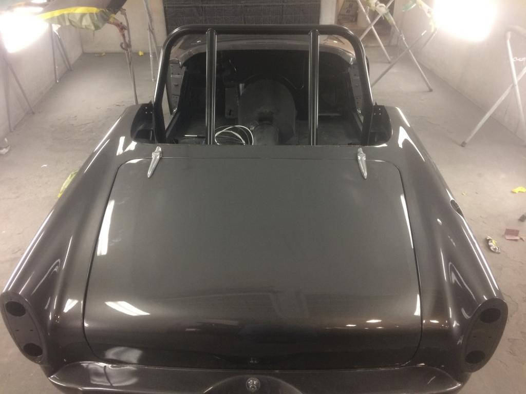

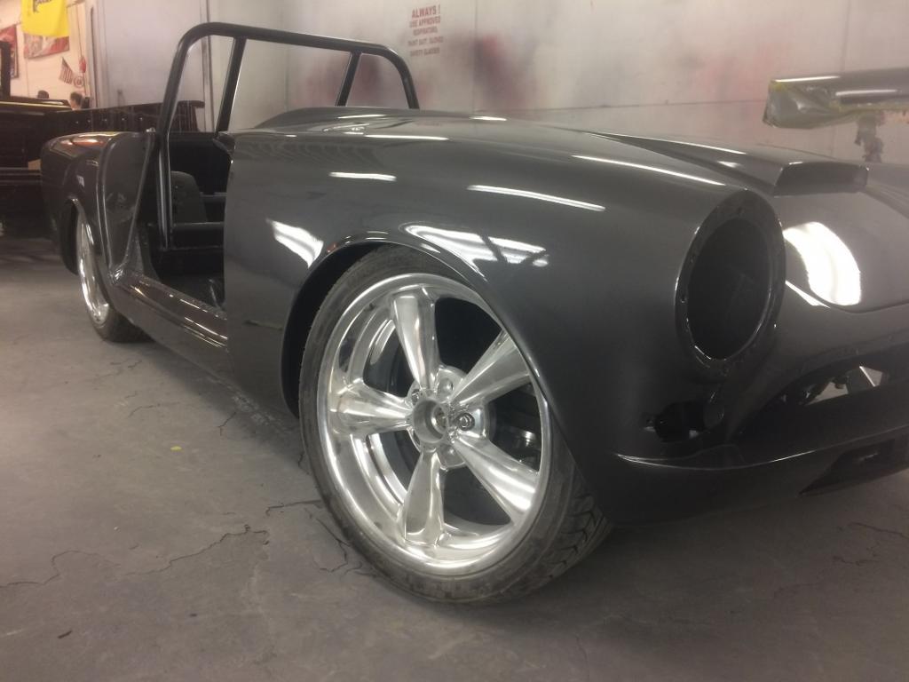

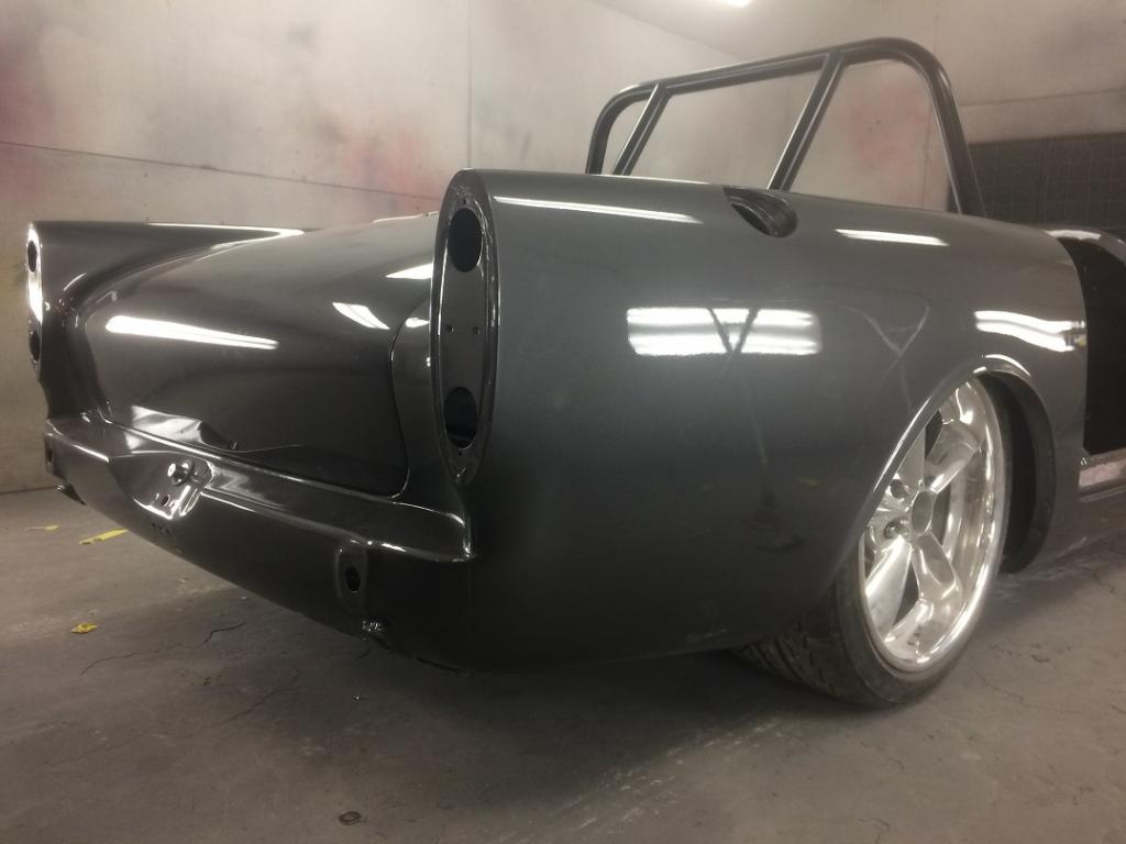

After sitting in the body shop for 10 months we are finally getting somewhere with the Liger build. First round of paint is finished. The color came out a bit darker than we were thinking, but now I couldn't be happier. I really like it and it is different than the car we are modeling. So that is a very good thing.
I should get the car back in the next few days so hopefully this will come together nicely in the next month or so. Fingers crossed.

Beautiful Paint Job
Good to hear that your car is coming along and the paint job looks beautiful. You must be very happy with it! Please continue to update us as the car comes together.
