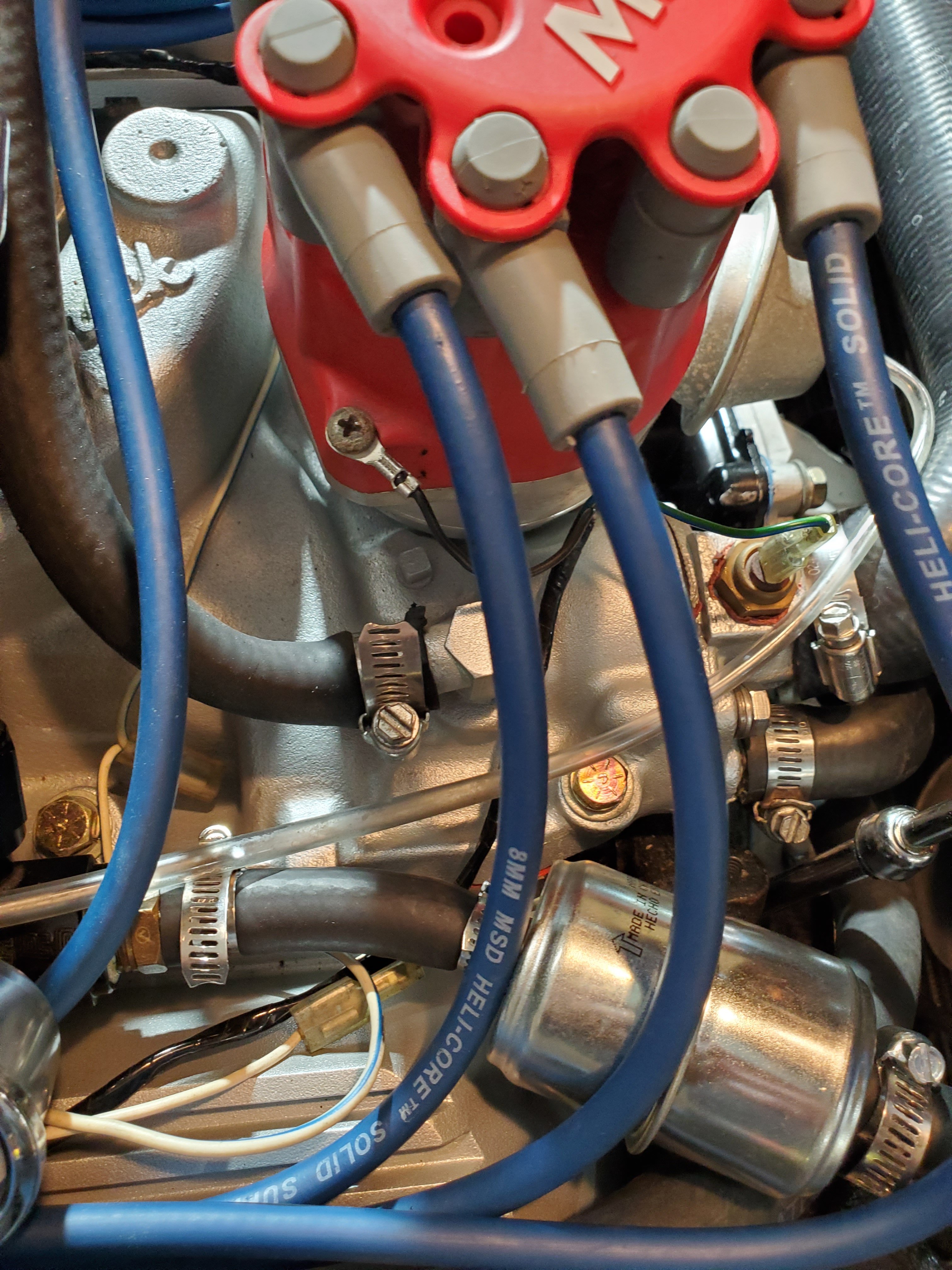

When the voltage stabilizer isn't working correctly, the fuel gauge is also affected and will read high as well. the T fitting on the engine pictured must have a ground wire attached in order for the sender to be able to "communicate" with the gauge.MKI use 1224826 - Housing - Temperature Transmitter between the Carb spacer and the elbow fitting on the intake manifold

I checked the voltage stabilizer and improved the ground. My fuel gauge is not pinned and appears to be reading accurately. So I believe the stabilizer is ok.When the voltage stabilizer isn't working correctly, the fuel gauge is also affected and will read high as well. the T fitting on the engine pictured must have a ground wire attached in order for the sender to be able to "communicate" with the gauge.

The ground wouldn't be needed as the sender is self- grounded to the thermostat housing... the engine is grounded through the ground strap on the left side of the bellhousing to the disused (Alpine) transmission crossmember point.I checked the voltage stabilizer and improved the ground. My fuel gauge is not pinned and appears to be reading accurately. So I believe the stabilizer is ok.
Here is a picture of my set up. The only place I could reach with the ground wire (without cutting and splicing my new wire loom) was the screw on the distributor cap. The distributor has an aluminum housing. The temp gauge does change its reading as the car warms up, so the sender is getting a reading, just not an accurate one. Is it possible that the ground is not good enough and it is preventing the sender from reading accurately?
I got a brand new sender from Sunbeam Specialties, I would hope they knew the right one to send me. That is not to say that a brand new part could not be defective.It's possible it is the wrong sender. Mine was wrong when I removed it from my Tiger.
