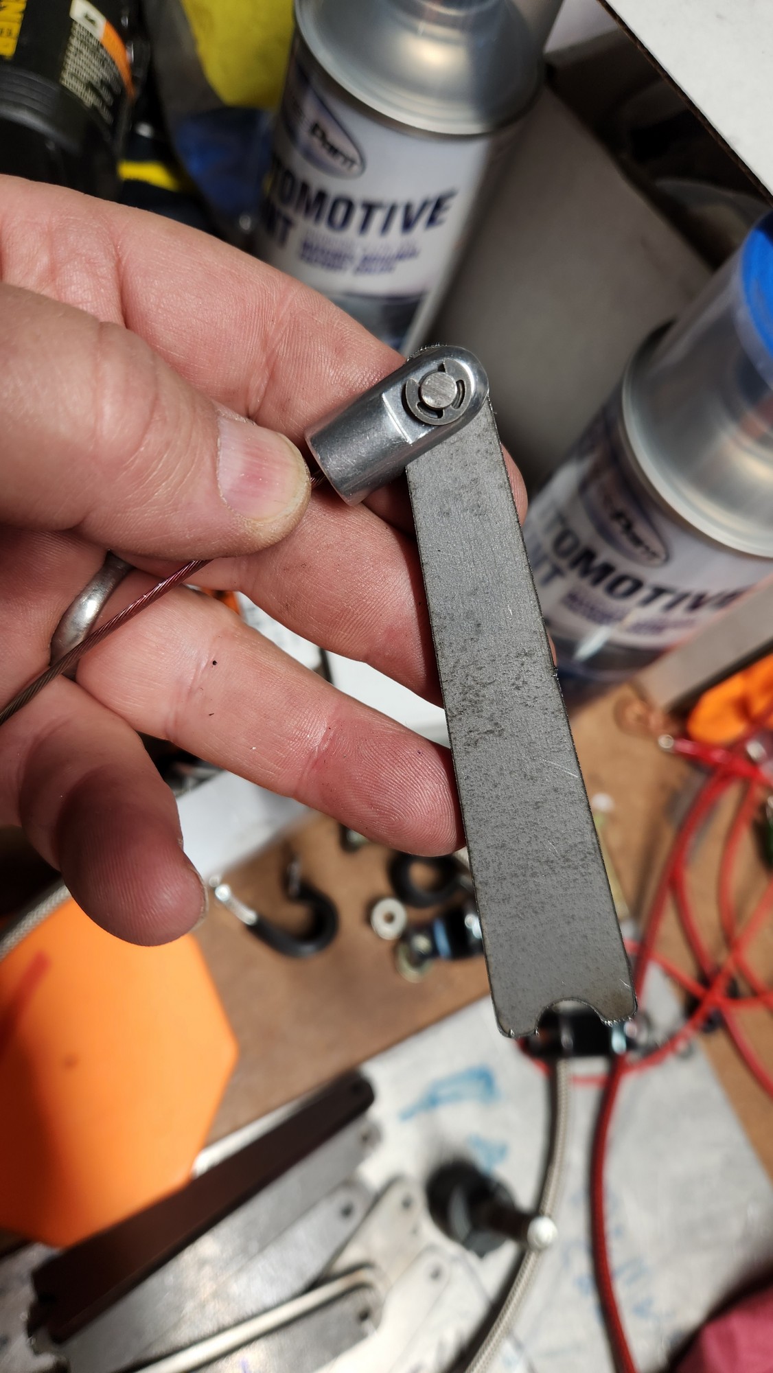

In testing of the modified throttle arm, I found that it still had some movement when just getting to the end of the throw on my linkage set up. Granted I have some stiff return springs and a bit odd angle for the pull on the carbs throttle linkage.

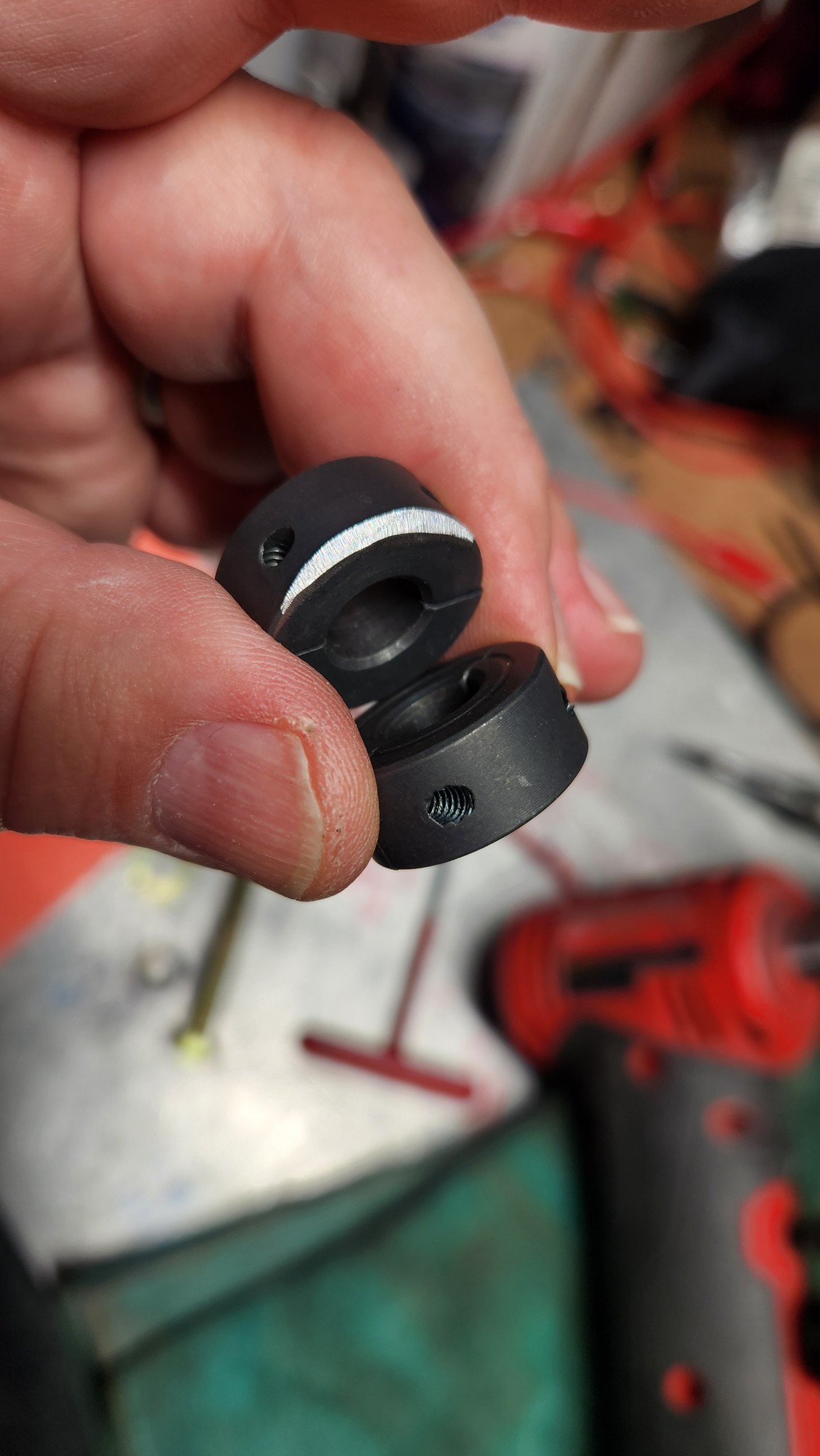

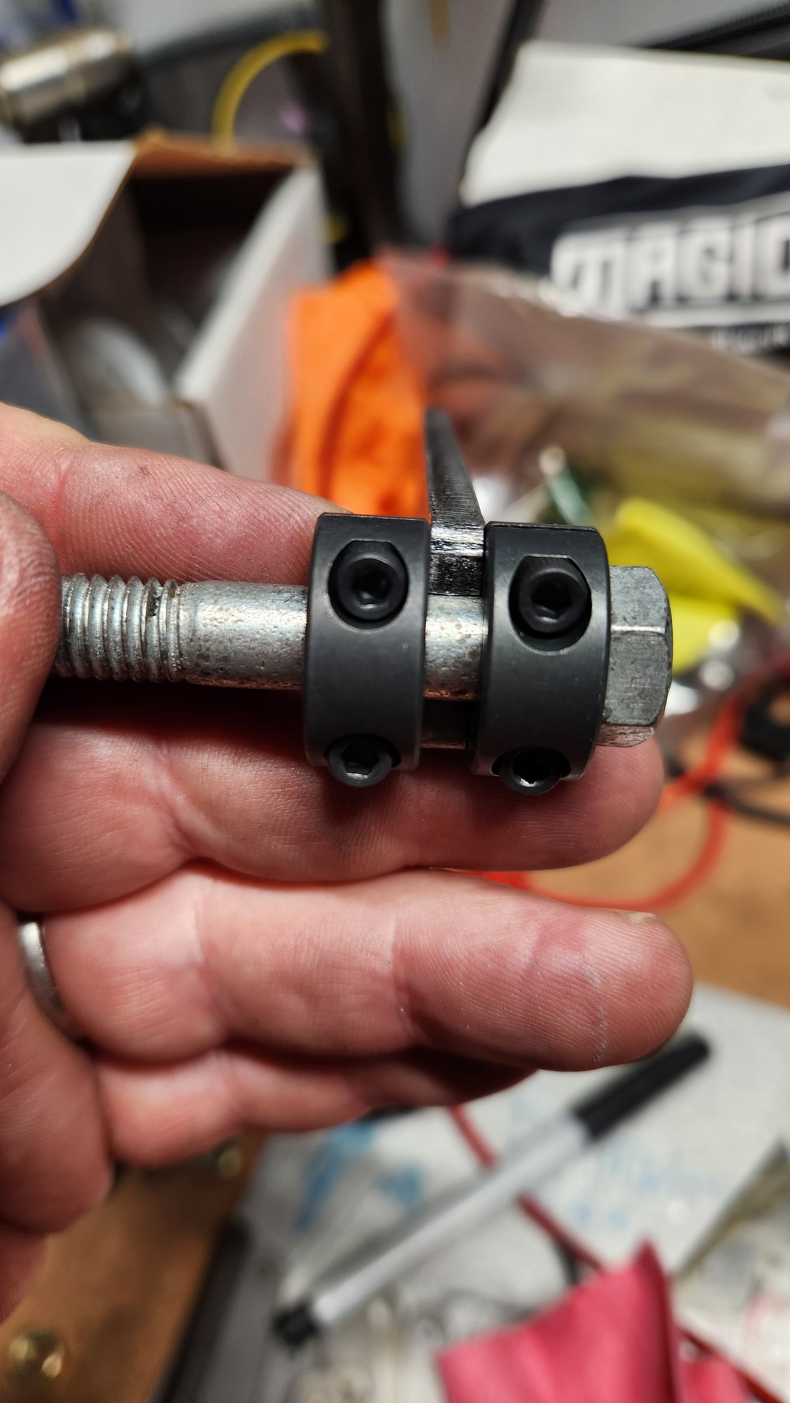

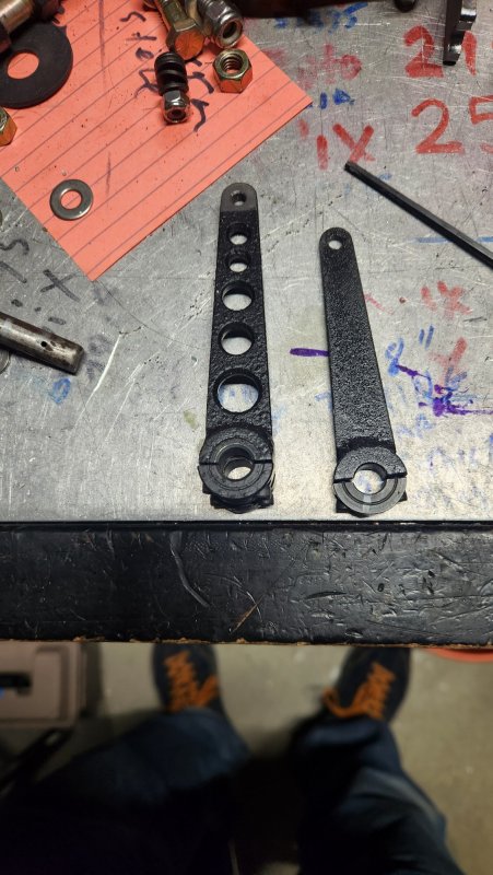

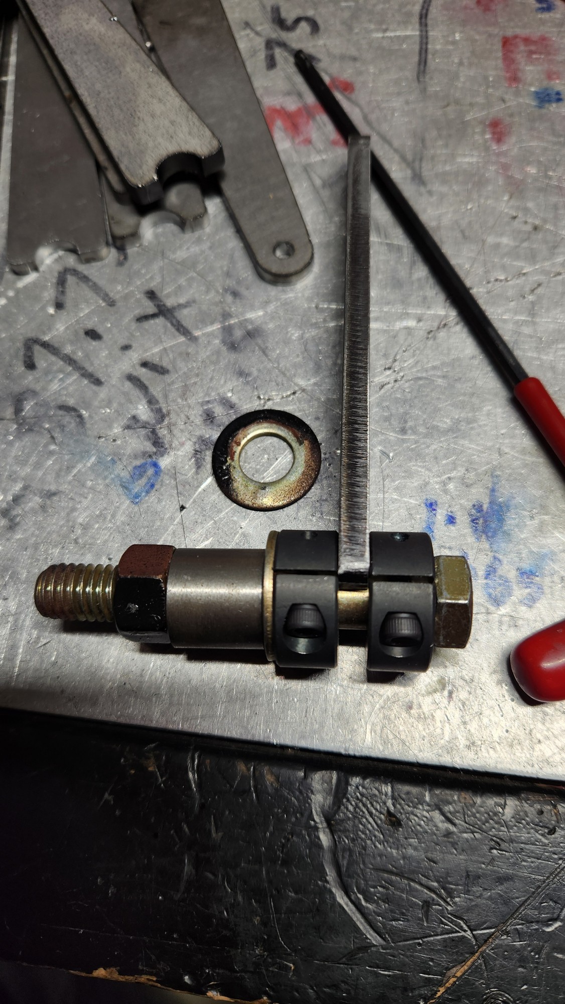

So while thinking about the one that I have from Robert and the way he did it, I decided to modify it a bit and use two locking collars instead of one. The original one had the arm TIG welded to the top of a split collar, where my cutting edge design uses two on each side of the arm.

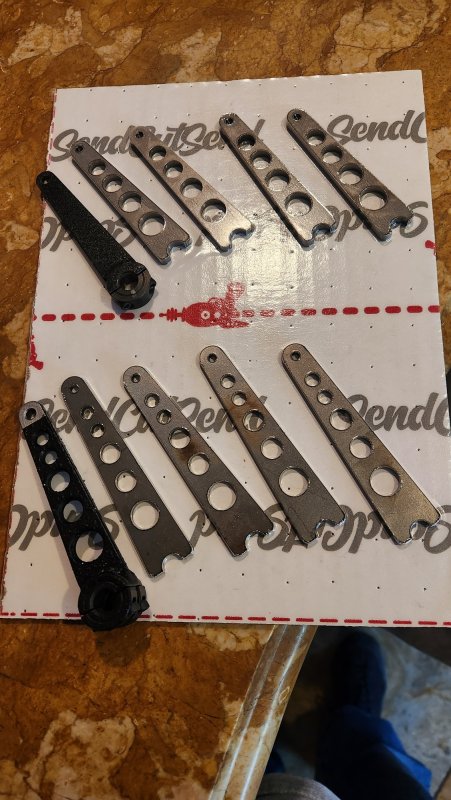

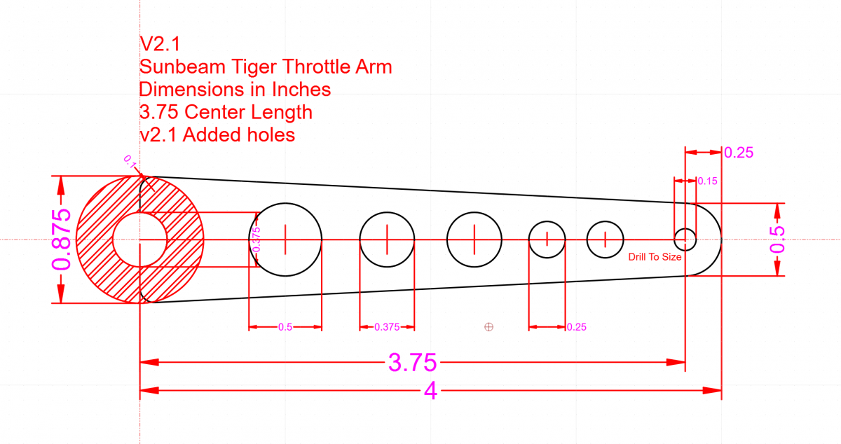

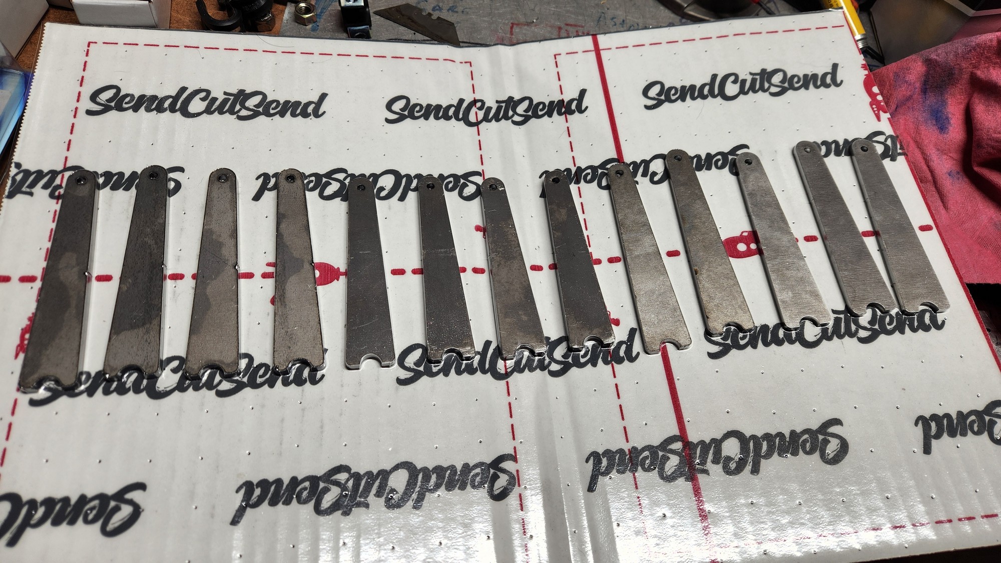

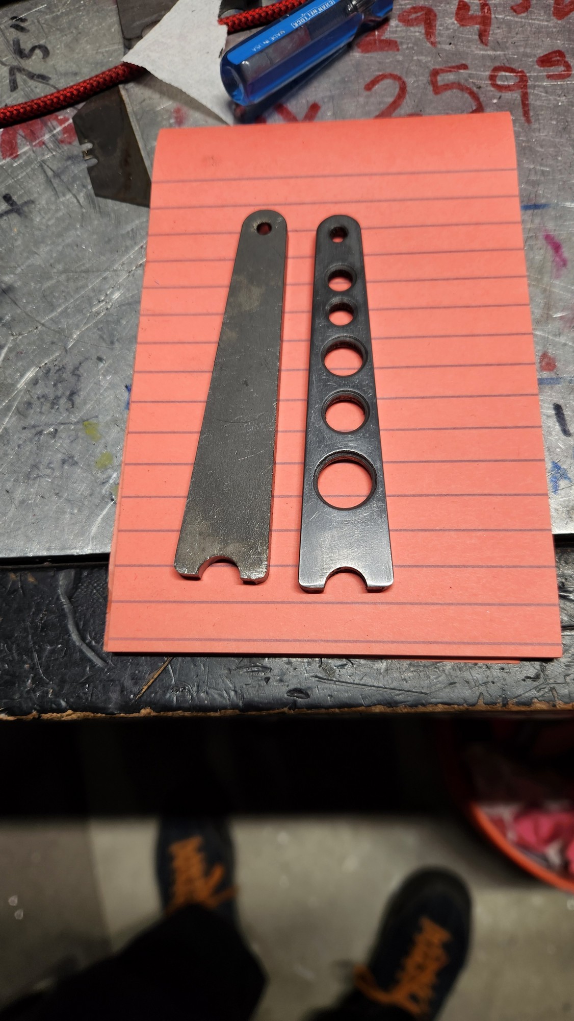

I did some CAD, sent it to SEND CUT SEND and had a variety of arms made just so all sizes and thickness were covered. Also had to meet a minimum order so just made a few in each style.

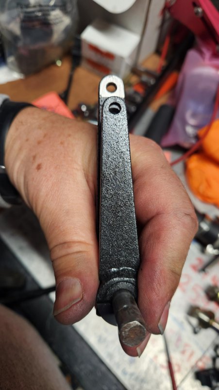

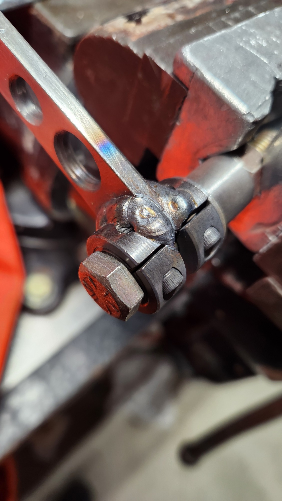

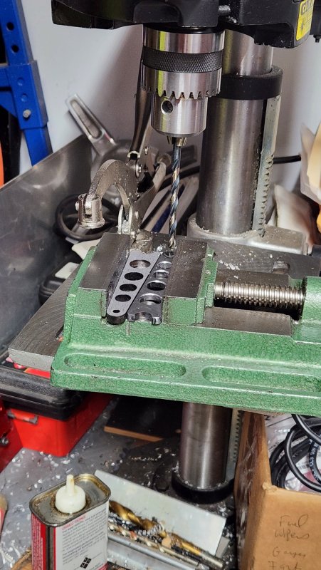

The Tiger's gas pedal uses 3/8" rod, so I made a simple jig out of a long bolt to get things square and aligned properly. Then hit it with the MIG welder, really needed to fire up the TIG but seemed like a lot of work, and I was lazy the day I did this so some blobby welds were in order. I drilled out some holes in my arm just for fun, should have had them in on the laser cut, would have be easier...
Collars were 3/8" Id split collars, with weldable steel and from McMaster.

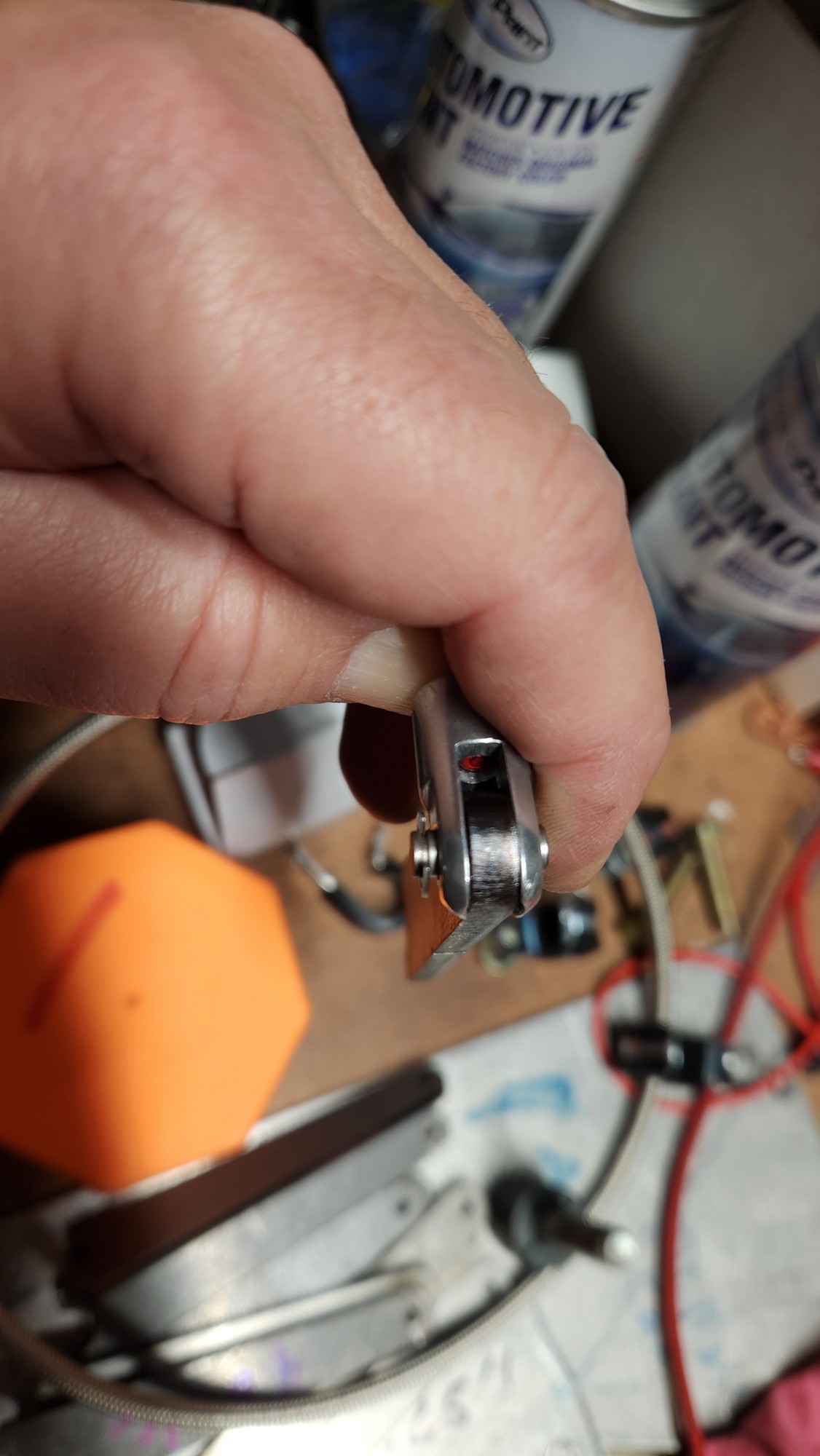

My carb is connected with a Lokar cable that has a 3/16" clevis on the end so I used a thicker arm that fits a bit nicer then the thin ones that were also made.
I have a bunch of spare arms in both thick 0.188" (3/16") and thin 0.135" with C/C lengths of 3.75" and 4", send a PM if anyone needs one, limited supply, while supply lasts, and I reserve the right and all that...

I did this mod, using a single collar a couple of years ago, and if you have not seen the entire assembly, Sandy had pics on his site

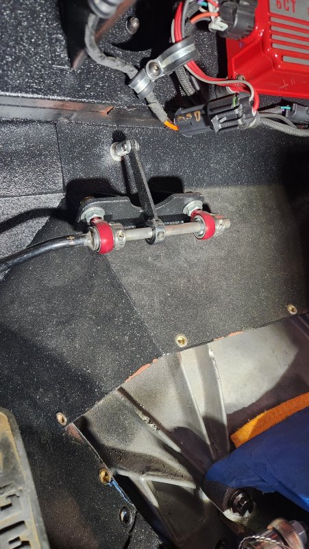

So getting back to work on the Tiger as I was on hiatus while the car was outside wrapped up so I could sell another car.

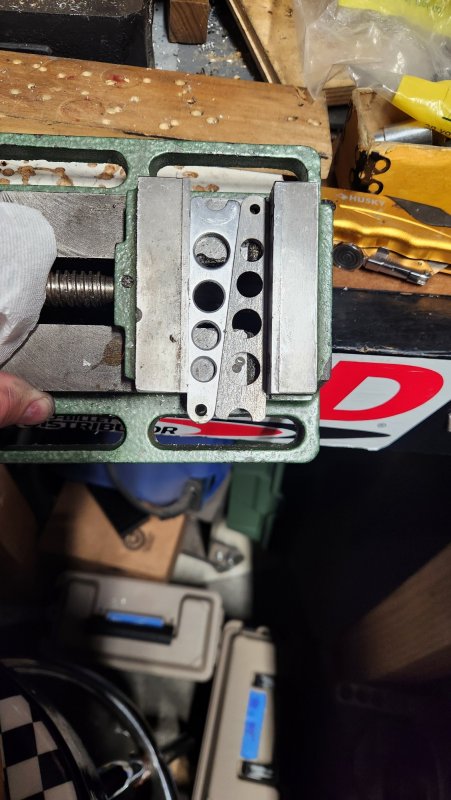

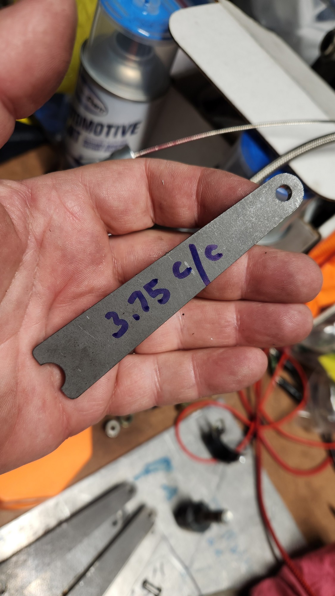

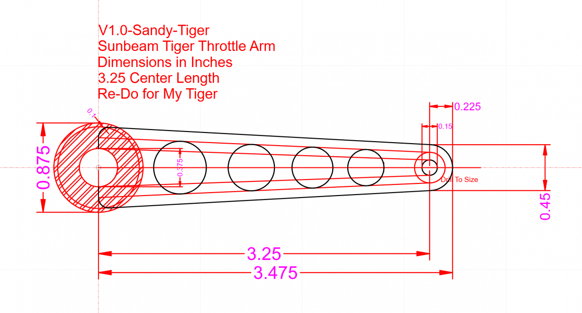

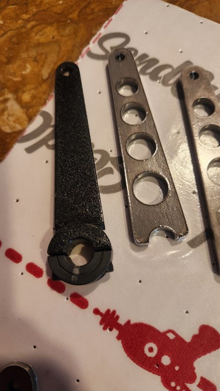

Decided to install the new throttle arm, and guess what. it's not the same length as a stock one. The fabricator that did the firewall must have shortened it a bit to clear the support bracket that he made to tie the car together. Never thought to check it. The stock Tiger has a Center to Center length of 3.75" and the one I have is 3.25". So it seems another order to SendCutSend is going to be done. To make the minimum order I also made some new stock length ones with the holes pre-cut. I have plenty of arms in a couple of lengths now (4.0, 3.75, and 3.25). If anyone needs one shoot me a DM.
This also changes the throttle ratio so using the Top hole on the carb lever would be a long pull, this now makes some sense why the second hole seemed better travel with the shorter lever. All in a days work as they say.

Sent out the CAD to SendCutSend on Thursday, had it back on Monday. Getting it ready for welding...
