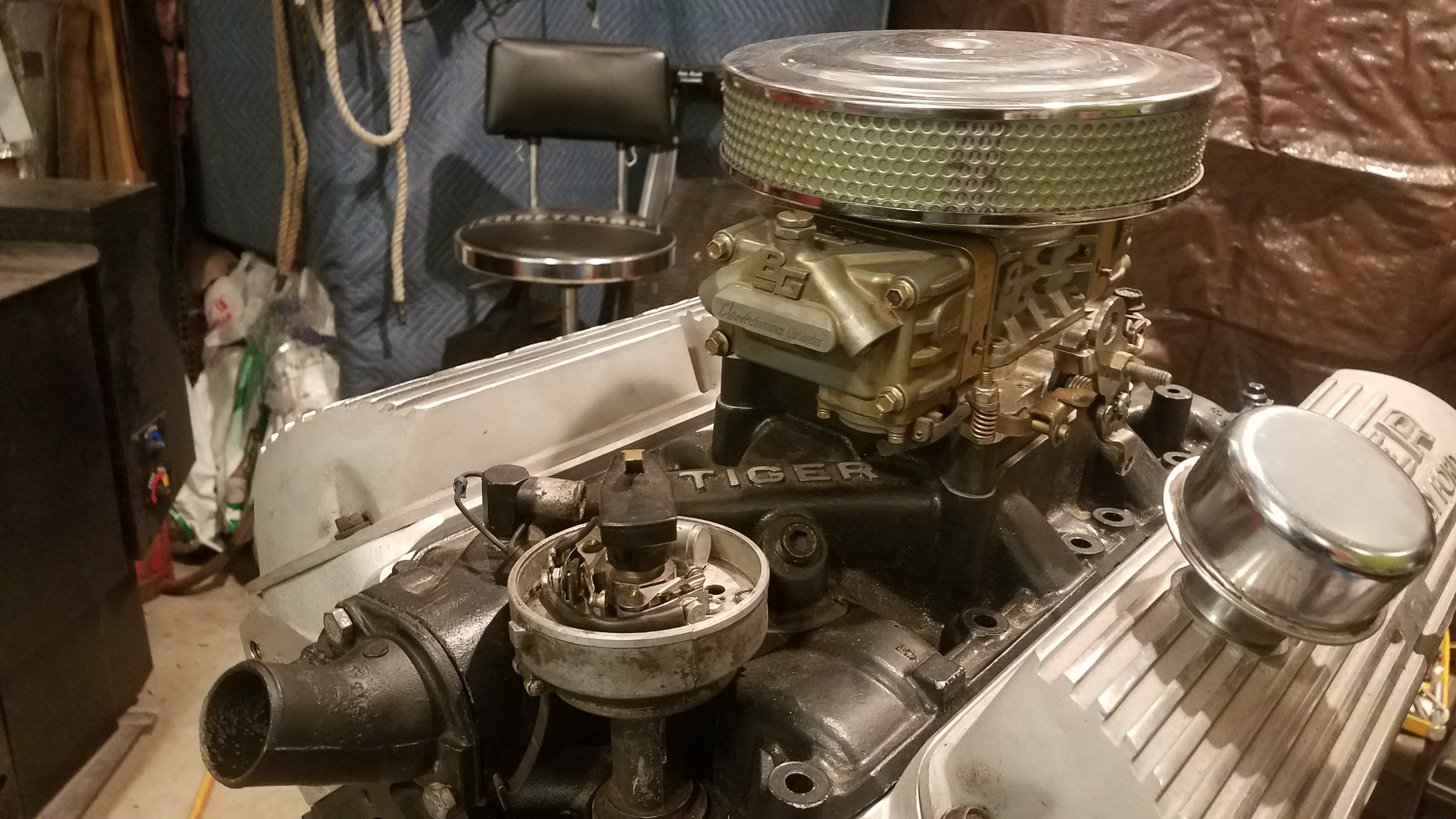

With all the manifold talk and using spacers had to do a mockup with my Tiger low rise using a 1-inch spacer,
with the spacer the carb sits higher so you can read the tiger script before the carb would be in the way
Nice and clean looking, here is one in the car with hoses…. I have a breather for you if your interested.
