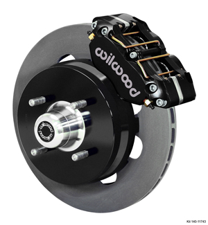

Cost me about $400 at the time but as Michael said, the RX7 guys are on to it and parts are hard to find and much more $$$ now. Four years ago I had trouble finding the parts. I might be talked into selling this conversion this winter so I can buy a Dale A wilwood rear disk conversion.

With the Wilwood or any other disc brake upgrade should the master cylinder be upgraded too?

The piston(s) volume requirements dictate that the pedal must move enough brake fluid to satisfy the needs plus some safety factor. When adding pistons & volume needs, the upgrade to a tandem master cylinder makes sense because it's moving the same amount of fluids X 2 (or nearly). At the least, a higher bore on a single line system thru a booster works well also. 1-1/2 cents

I have the Wilwood front and RX7 back with the OEM master. ONCE all of the air is out of those Wilwood calipers (takes some time), the system works great. I think the pedal feel is perfect. I am also running a Lockheed booster.

It's less of a problem than what you would think...I have a NOS master cylinder and a brake booster( MK1) rebuilt by Bill Martin. IN the front on Dale's front end I have huge six piston Wilwood calipers and rotors that just fit inside 16" wheels and four piston caliper Wilwood in the rears. I have to be very careful that I don't launch my passenger thru the windshield on a panic stop...

I have an early Wilwood single master installed in 1999 while the pads and the Fiat X 19 rear calipers work about 25% better than stock. No booster. The rebuild kits are available from many vendors including S.S. and there is a You Tube video how too which is great. Lots of choices on boosters that are less fickle than stock ones.
