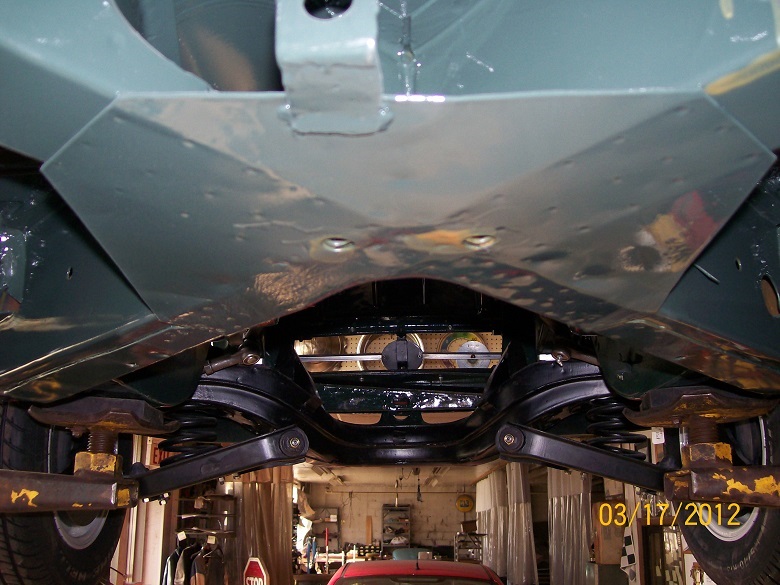

This is a photo of how the undercoating was done by Doug Jennings to one of my cars. This was done after the underside was painted. The brown is where the 3M undercoat spilled out of the inside of the frame rails, etc. It was cleaned off at a later date.
