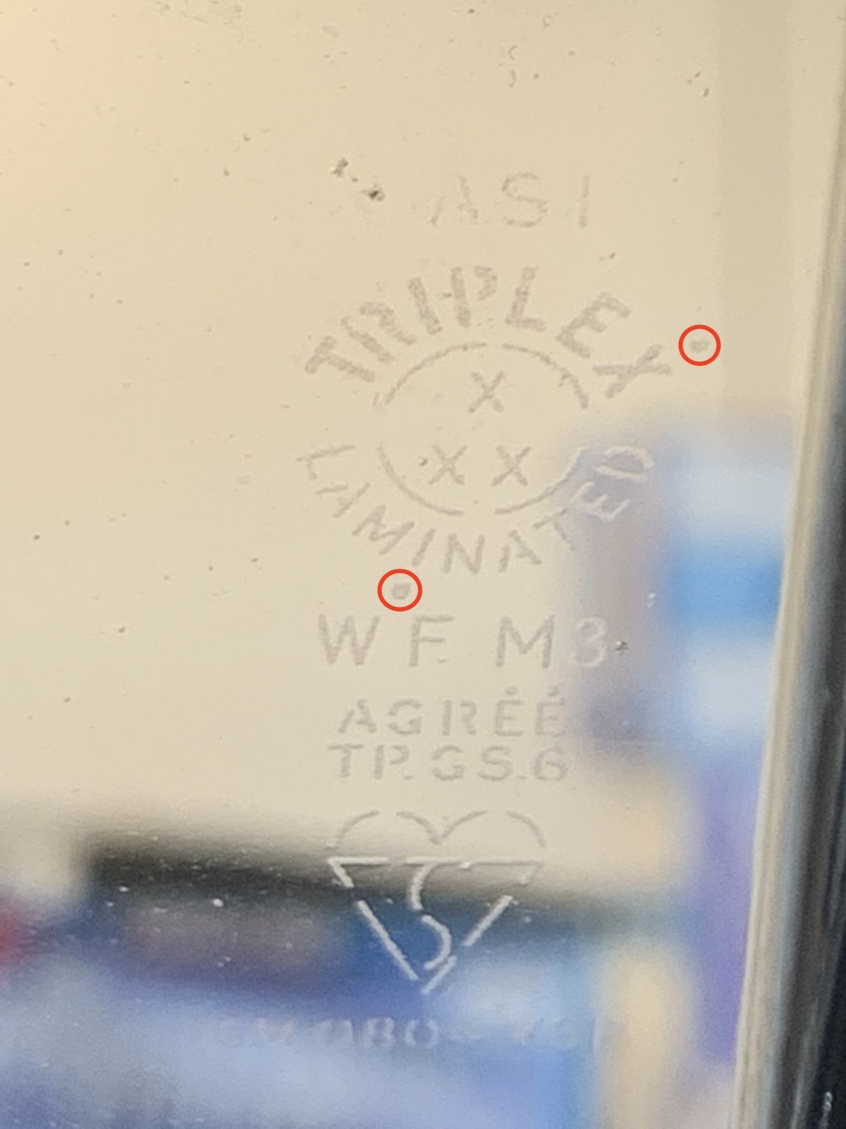

Assuming my glass was made in the 60's, my windshield was made in Oct-Dec of 64, and doesn't look too bad for 55+ years old. My right wing and door glass are Apr-Jun of 63. Left wing and door are are Jul-Sep of 64. The windshield has "LAMNINATED" and the others have "TOUGHENED." Car was born in Dec 1964. Pic of windshield logo:
