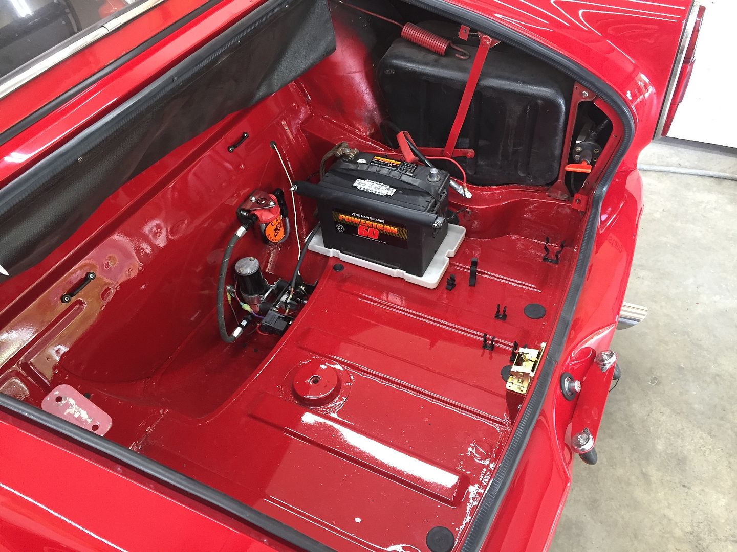

Trunk being restored.
Duke Mk1a
1,673
Going from this -
To this (still in progress) -
Question about the tool roll strap? Which way does it mount? Buckle to left or right. Left seems to make sense but this is a British car.

You were asking about the correct size for the wood piece under the battery a while back ( and it got answered by Moondawg ) but didn't see any size on the piece that goes on the side between the frame and side of battery ... Any idea on that one ?

Ohhh heck no. Figure I might as well put it in as was original. Looks like the buckle is down.
I have the wood piece that goes between bat and frame.
yup, South North
Buckle towards tail end of car...
black piece inverted to show rivets.
Were the MkI jack and handle in a different position? If not mine are in wrong.

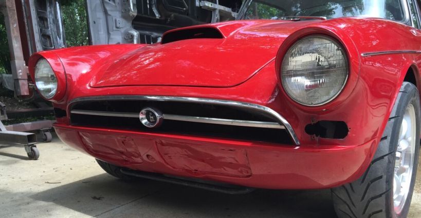

The trunk is all out of my pocket. The front is getting work too from when it fell off the floor jack.....again. :mad:
Front is looking good again, why don't you do the engine bay while this was getting done? Iirc from YouTube it only takes you 3mins to get the engine out ...

When I painted my car a while back, I sprayed some 'European texture' paintable gravel guard all around behind the tanks... in retrospect, I wish I'd just done the whole trunk, floor and all :( Those Brits sure like to gob on the seam sealer :confused:
