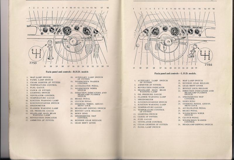

Actually, your turn signal switch being on the right is "factory correct" in the ultimate sense! They all originally came that way. Given the symetrical design of the column cover, etc. most of us moved it around to the left side of the column where we are all accustomed to it being on American cars. I am an original owner and that is what I did. For further confirmation, check out Section N (Electrical Equipment), page 31 of the Rootes Manual WSM.143. The pictorial of the dash area shows a left hand drive configeration with the turn signal switch on the right side of the column.

For whatever it may be worth, I looked closer at my shop manual and noticed two additional things. One, it is a first reissue version and was issued 1967. As such, it covers both the Sunbeam 260 and 289. Also, in Section J (Steering), Page 5, there is a Direction Indicator Switch section that begins with a two sentence Description. The second sentence says "The lever points to the right hand side of the car and the striker also secures the slip ring to the inner column." Interestingly, this sentence has a little vertical dotted line on its left hand side. That leads me to believe it was an addition or possibly a change from the earlier version of the manual. Anyone have an earlier version of the manual that would say something different for the 1966 production cars? Regards, Gene :)

This is right out of my Sunbeam 260 Handbook
I know its hard to read. If you zoom in, check out number 22 for the LHD and RHD
