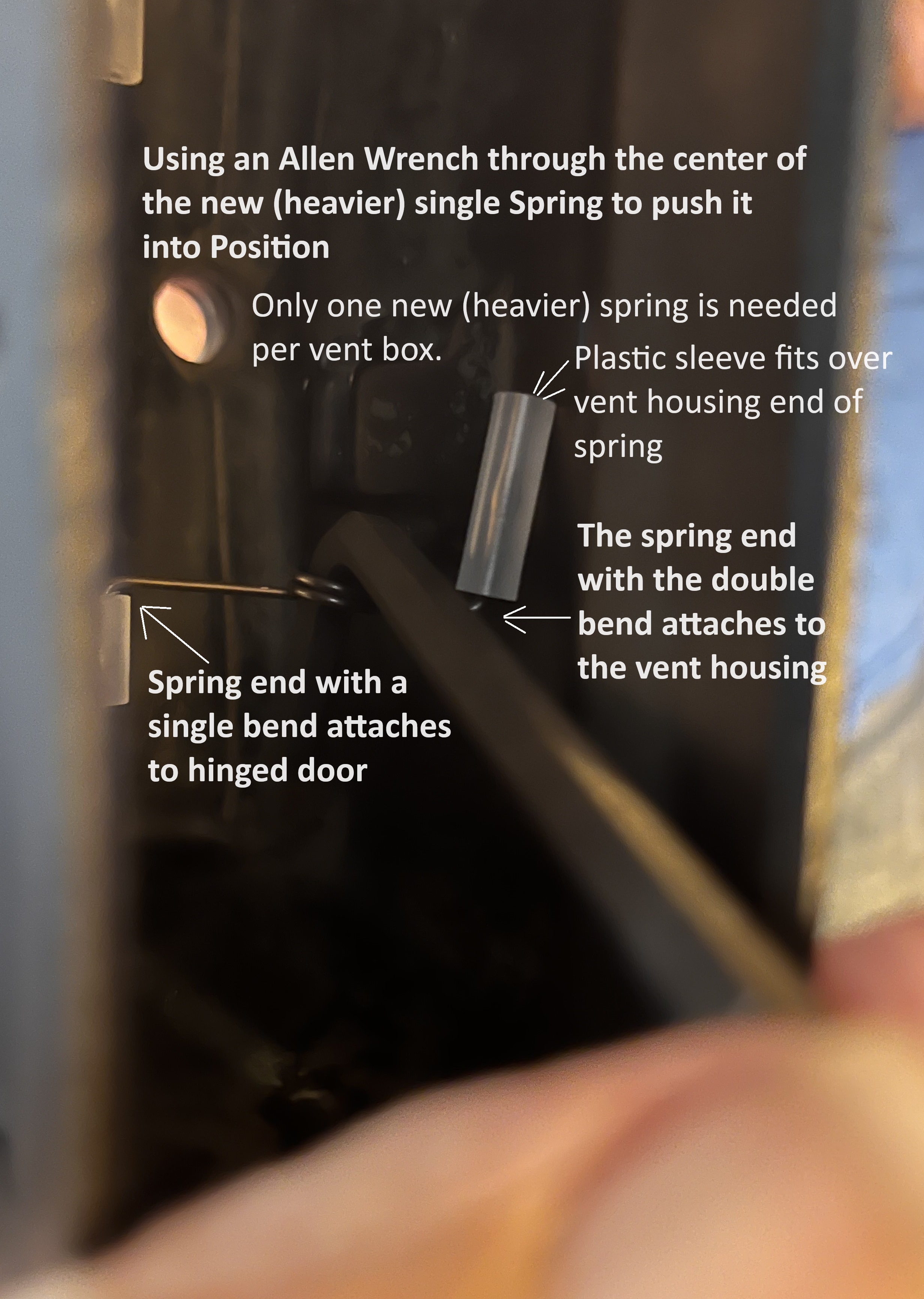

I used an Allen wrench to help install the spring.

One change is that today's kit has a heavier spring so that only one spring is used in each vent box instead of the original pair. Since the spring is a few thousandths oversized you need enlarge the hole in the boss on the flapper door. (I manually forced the steel spring through the plastic hole a number of times which opened the hole nicely.)
To make it easier to insert the spring into the boss on the flapper door I filed a slight point onto the end of the spring. (pictured)
