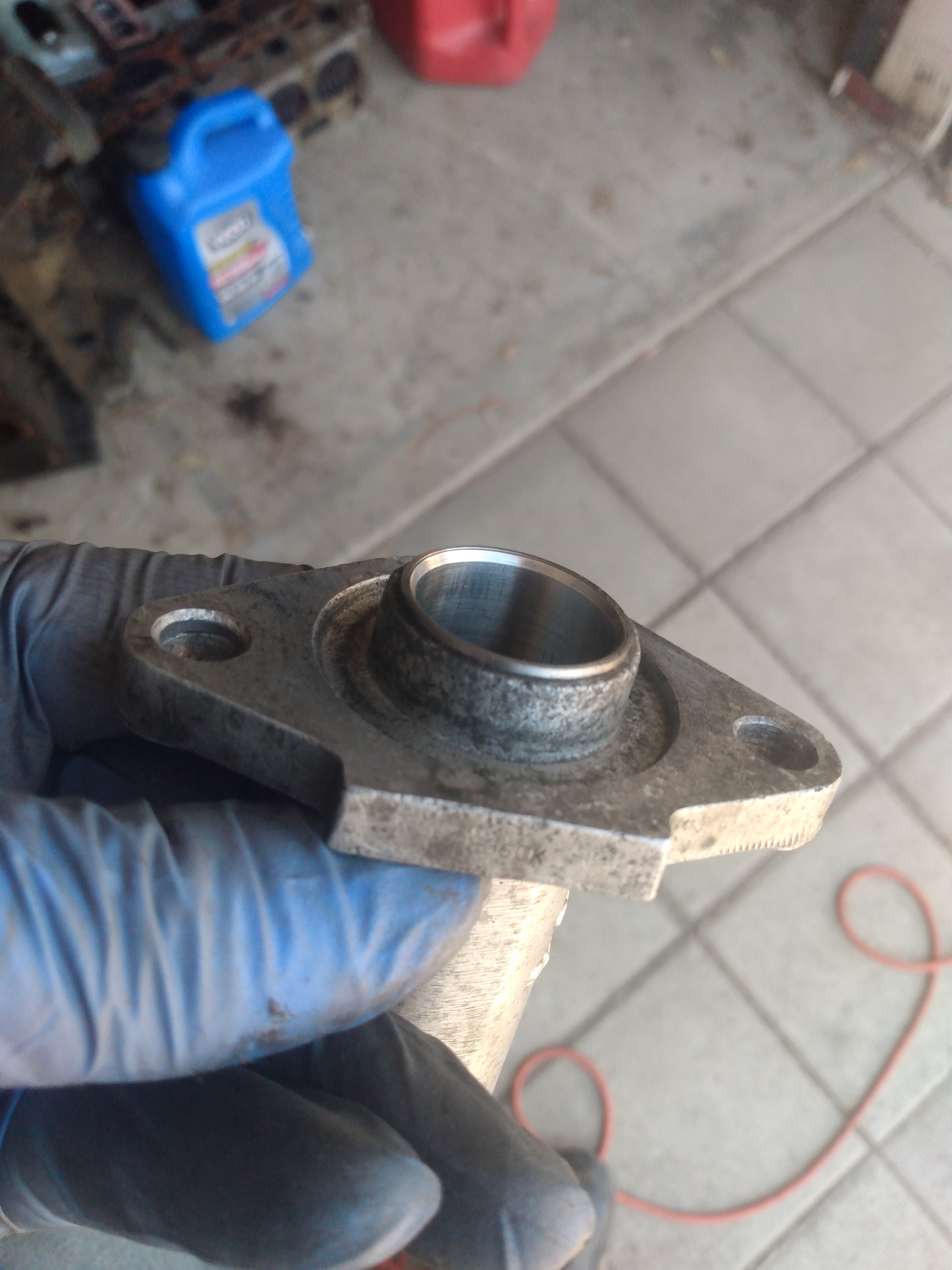

BTW, I have bored a few slave cylinders from 7/8" to 1"
and I AM concerned of long term durability.
The bored out slave cylinders are quite thin walled.
So, boring and sleeved to 1" size is NOT suggested.
The picture has a 1" OD SS sleeve.
