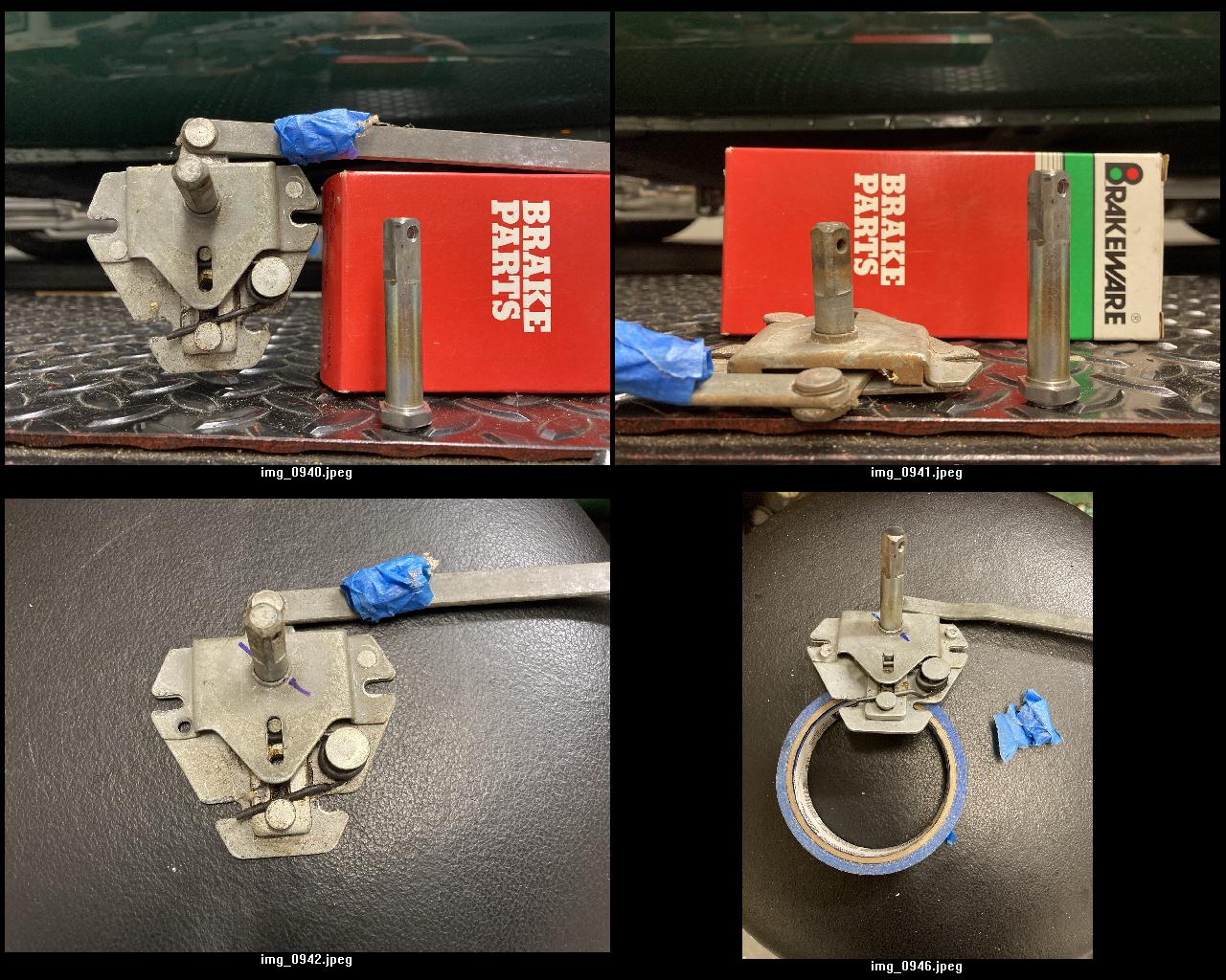

I need a right inside door release mechanism for a car with GT doors - the part that the handle goes onto. I have two right side parts, but both have a short square shaft for the door handle, and it doesn't protrude through the GT door panels far enough to affix both the door handle and the black plastic escutcheon.

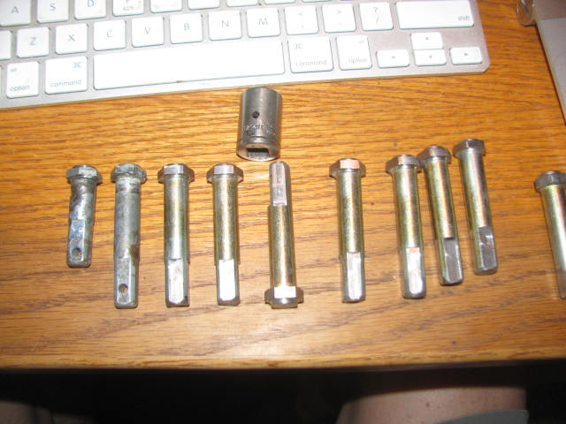

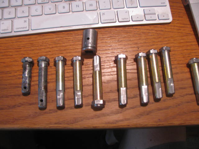

woody6- I have GT left hand only- I made these some time ago when I needed to repair mine- to repair yours you have to drill the rivets and use a rivet squeezer-to reinstall-- the socket used to drill your new hole for the door handle pin--the new shafts are grade 8 bolts- Never got much interest in these- took a lot of mill time-- also in pic left side are originals--Bryan

I do have serveral r/h ones with the short shaft- I can replace the shaft to one of my long remake- shipping will be more because of length of the arm--my l/h is an orginal one- the new ones fit both sides-Bryan

I have made the longer shafts for the gt interiors- you can remove your shorter shafts and replace with these- I do have some compete door opening rods- but with short shafts-- are you missing some our all parts will have to be re-reveted

Thanks, Bryan, replacement was a breeze. I used a small file to put a tiny bevel on the edge of the hex, then tapped it into the place of the old one. I also found it easier to release the bottom of the tension spring while riveting the front and back together, then re-hook the spring.
looking good- thx- I'm made these years ago- never once someone asked about these longer shafts- I have a few left- also takes a few hours to make on a bridgeport-- plus Grade 8 bolts in that length of shaft is not cheap-
