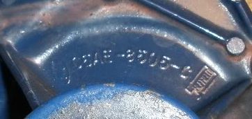

I go thru this constantly with the variety of motor configurations guys can come up with. For the stock damper & crank pulley location, the agua pump hub face should be 3/4" from the shaft tip.
Gene a member of theft um gave a measure mention of 4.75 inches from the timing cover. Mine is 5.25 inches. I will try to press the hub further on the shaft if the snout behind it allows. If that doesn't work I will have to order a new water pump from a Sunbeam supplier. Thank you for the photo. Bill
Here ya go, OEM pump off of my 260 -
Wow should have proof read my last post- typos. Oh well thanks Duke much appreciated. Bill
