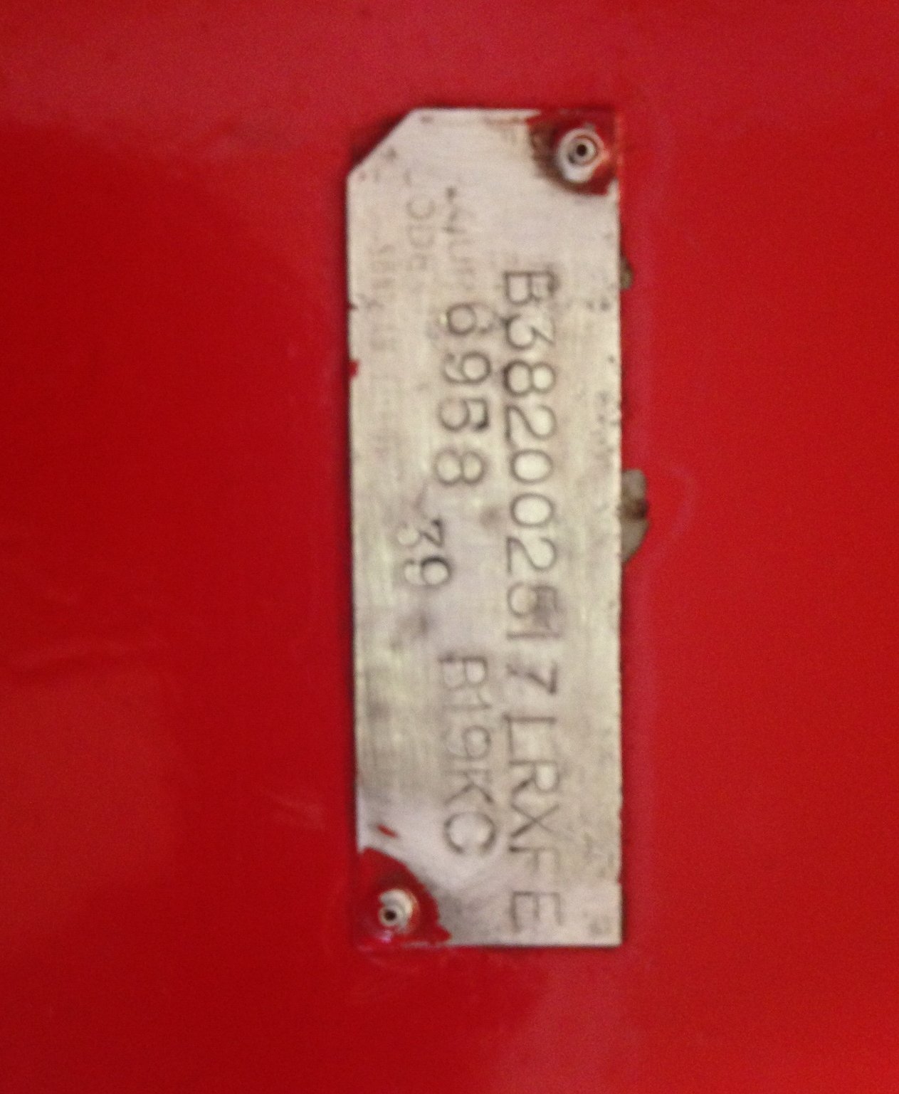

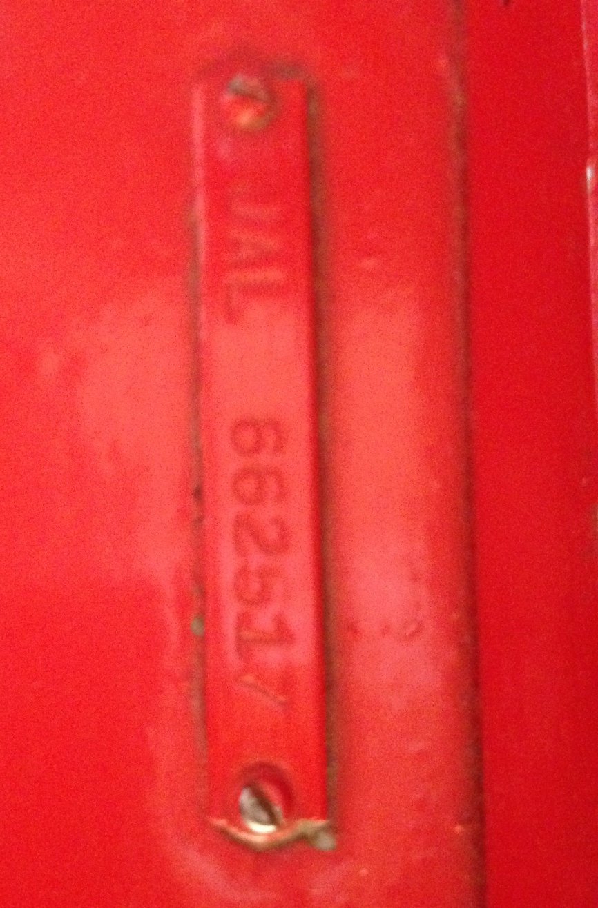

never seen jal tag matching vin tag numbers? Runaway
It's clearly an Alpine. No JAL tag sequence begins with the number 1. Should start with"56" for a 65 MK1 Tiger. Also, no provision in the hood hinge panel for attaching the radiator fan shroud (riv-nuts).
I have!! Norm told me there are precious few of those but they DO exist... as far as the rest of that car... ???:rolleyes:
These pics are from a pretty original ( but rusty ) car
1,392
Most of the cars in the chassis number range have JAL numbers 300-500 lower than the chassis number. They're not even close to the chassis number. This is because of the difference in the JAL sequence .. The Mk1 cars start at #1, but the JAL numbers for MK1's include "55" (1964) prefixed cars, "56" (1965) prefixed cars and "575" (GT cars) prefixed cars....

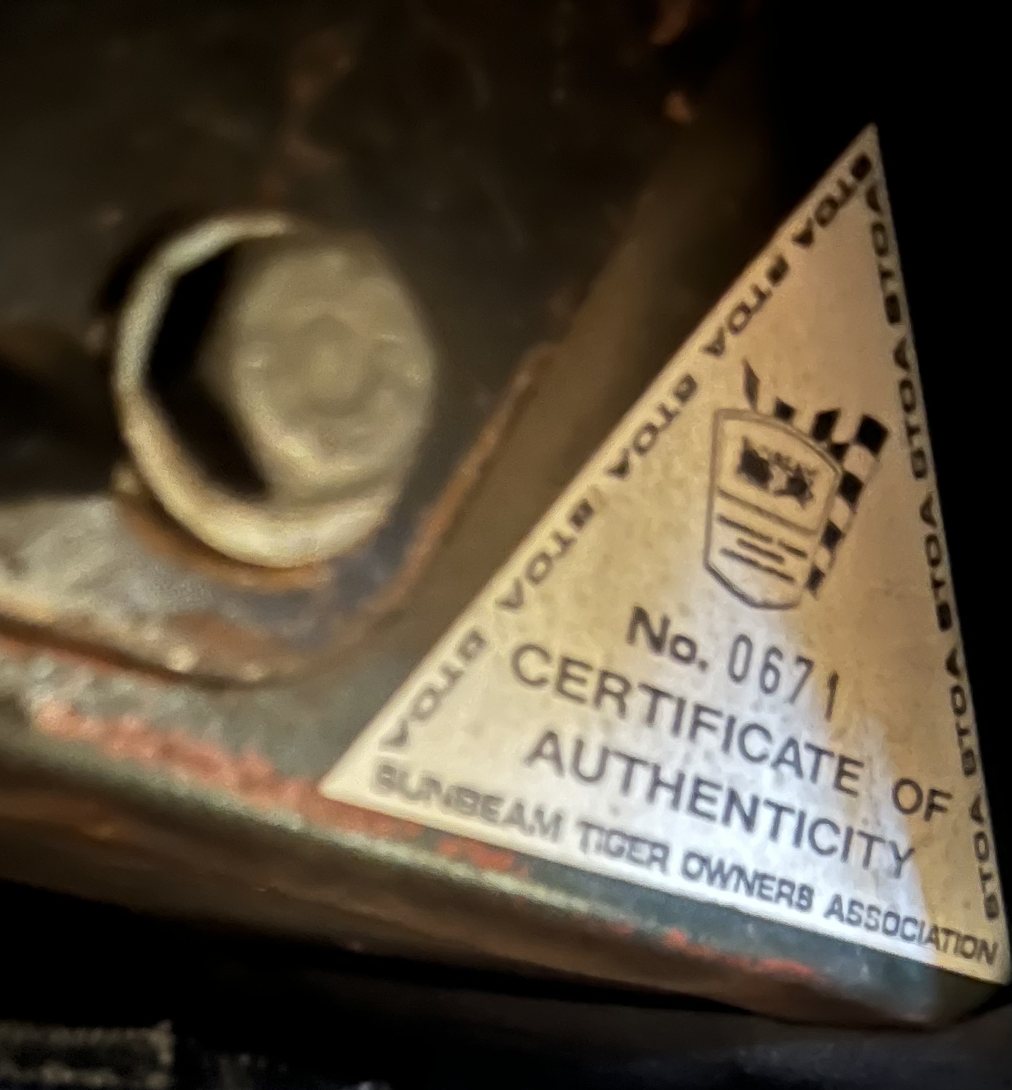

The TAC cert numbers of the folks who inspected the car are fairly low. It makes me wonder if the car was inspected some time ago. The owner/seller may have a TAC certificate, but the REAL QUESTION is does the car have a TAC sticker installed in the correct location? It is not inconceivable that a Tiger properly passed a TAC inspection, but later was wrecked and some of the Tiger parts were transplanted onto an Alpine. If anyone is considering the purchase of the car, check to see if the TAC sticker is undamaged and in place. If I had a car with a TAC sticker and it had to be removed for the car to be repainted, I would get the car reinspected. In my view, a car without a TAC sticker or a damaged sticker may or may not be the same car that passed inspection previously.

Who is to say that the certificate is not fake ? I am sure if a tiger can be faked then so can a certificate A certificate along with the TAC sticker would be more likely it is a Tiger with its original chassis

In another forum I raised the same issue... The car had some notes on the TAC re the JAL..was listed as non original riverts .was listed as painted white ..
This was in 2006.. Almost 20 years ago .. I asked if the TAC sticker was still on the car.. that would be a first check... If so...a check of if it's the proper sticker .. because the body as it stands ( battery box and engine bay ) raises concerns.... And I would question if it passed TAC as it stands today....

The tac certificate that he has lists the same incorrect JAL number the certificate is #683. The car was inspected on Oct, 15, 2006
1,243
Don't trust just a certificate. As Tony said, need the sticker along with the cert.

As far as I remember when mine was TAC’d, they just write down whatever it says on the tags and don’t comment on ‘originality’ as they’re really only looking at the ‘shell’ I was told that the sticker is made in such a way that it could never be removed without destroying it 😆
