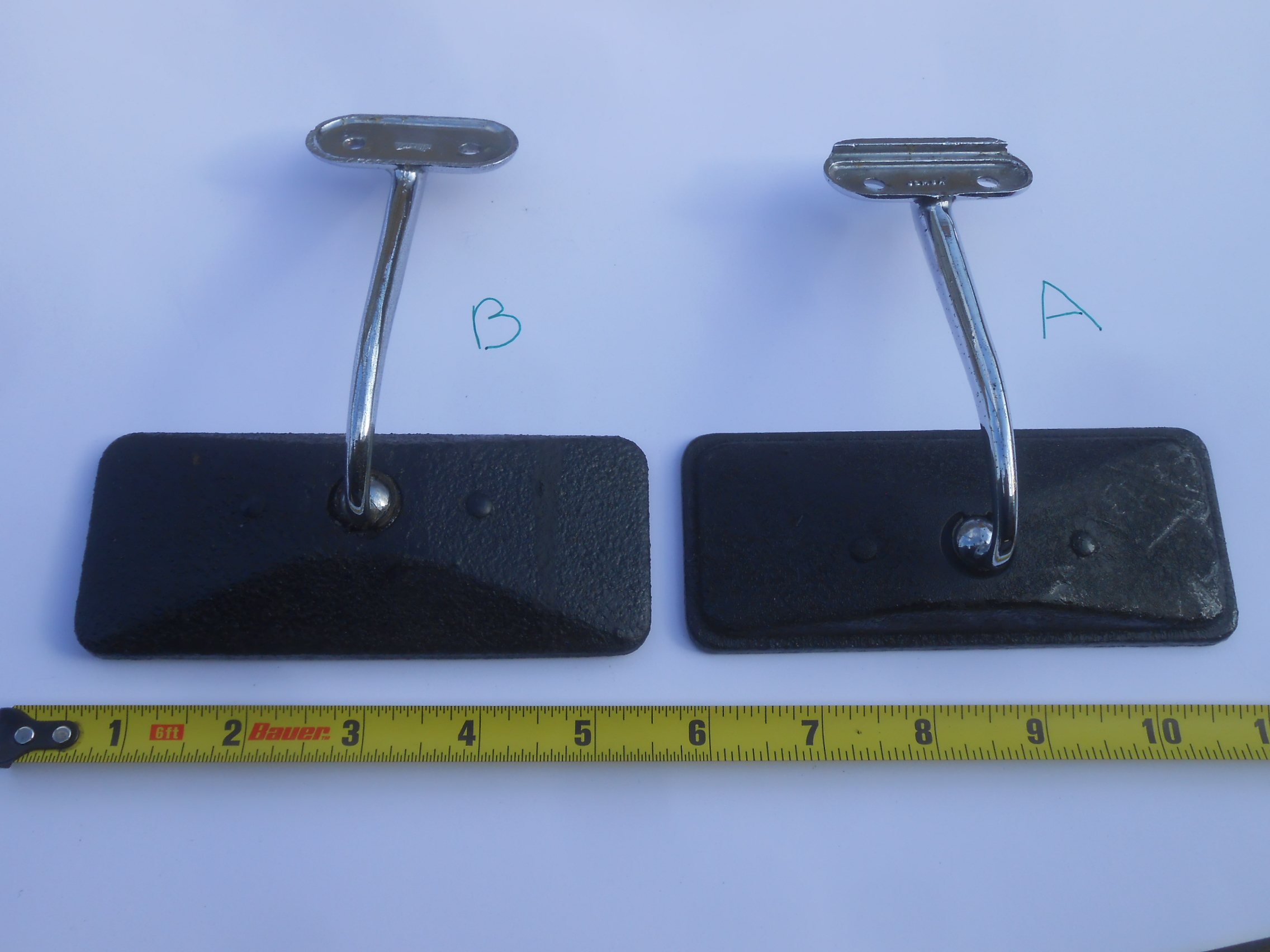

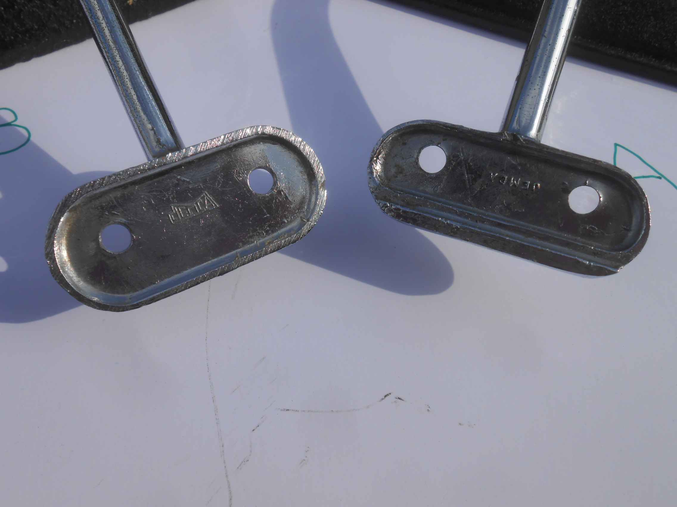

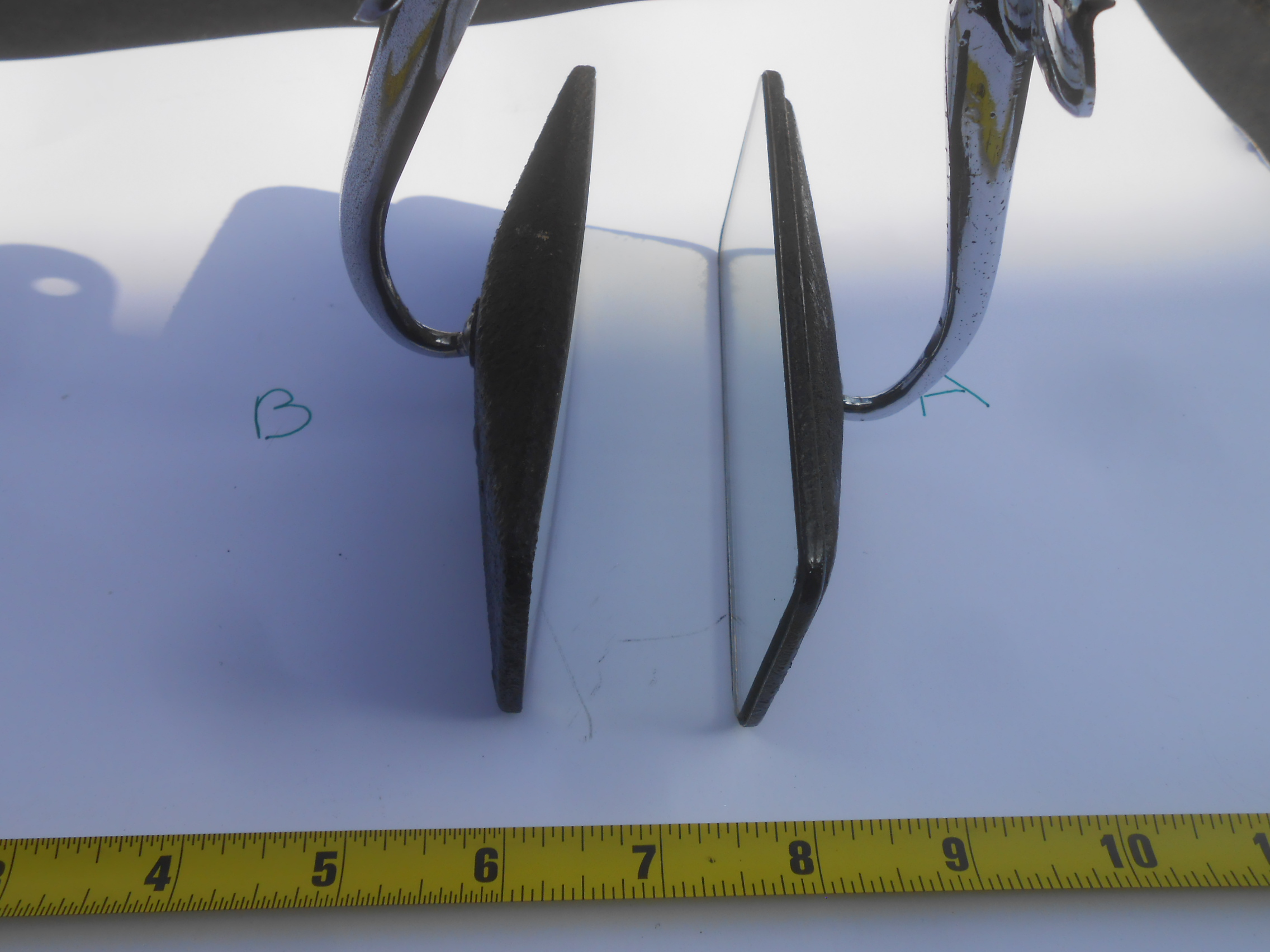

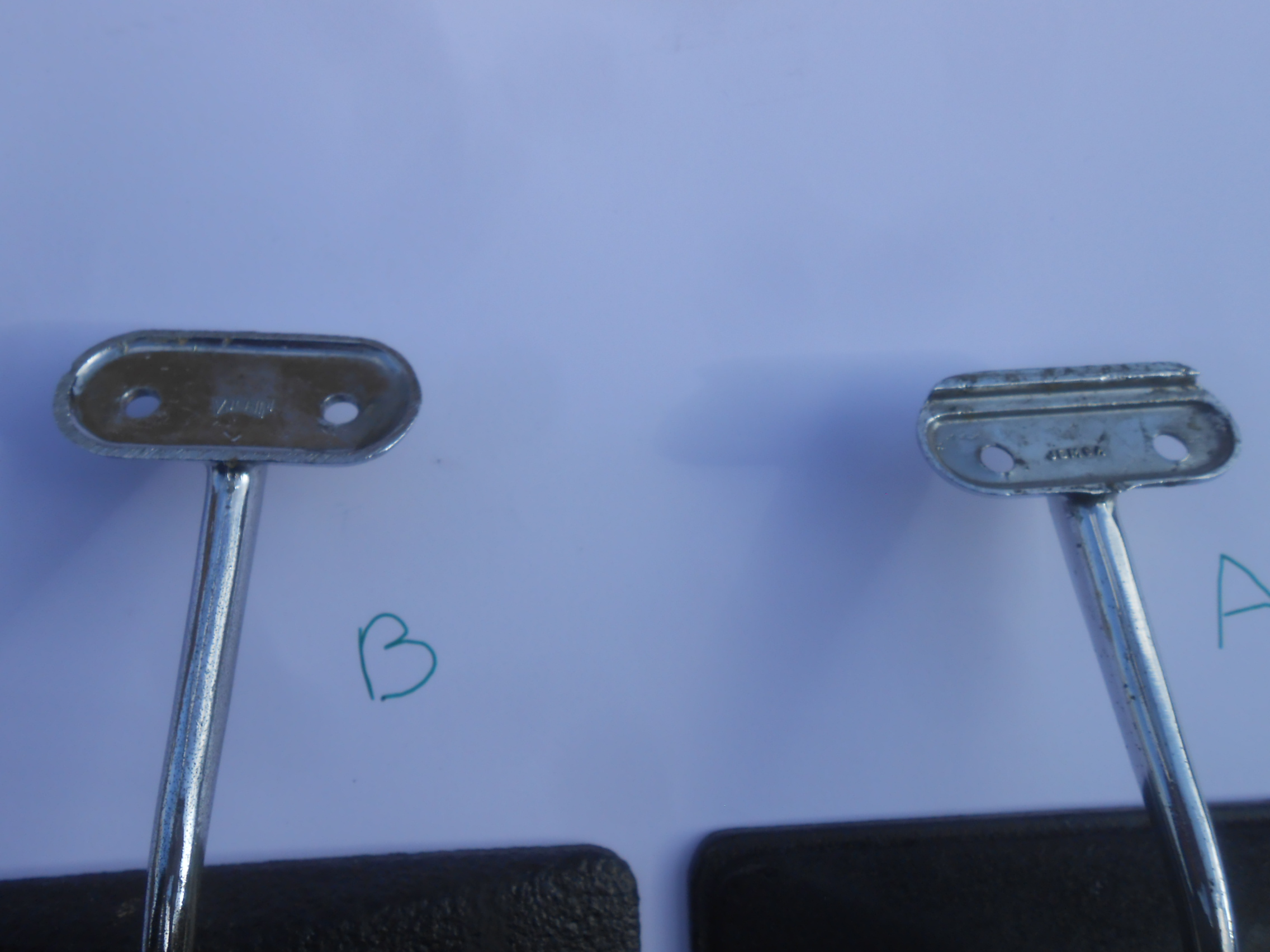

Which is the correct Mirror for my 65 Tiger, I have three curved mirrors (B), I think this is correct, But I also have this flat mirror (A)

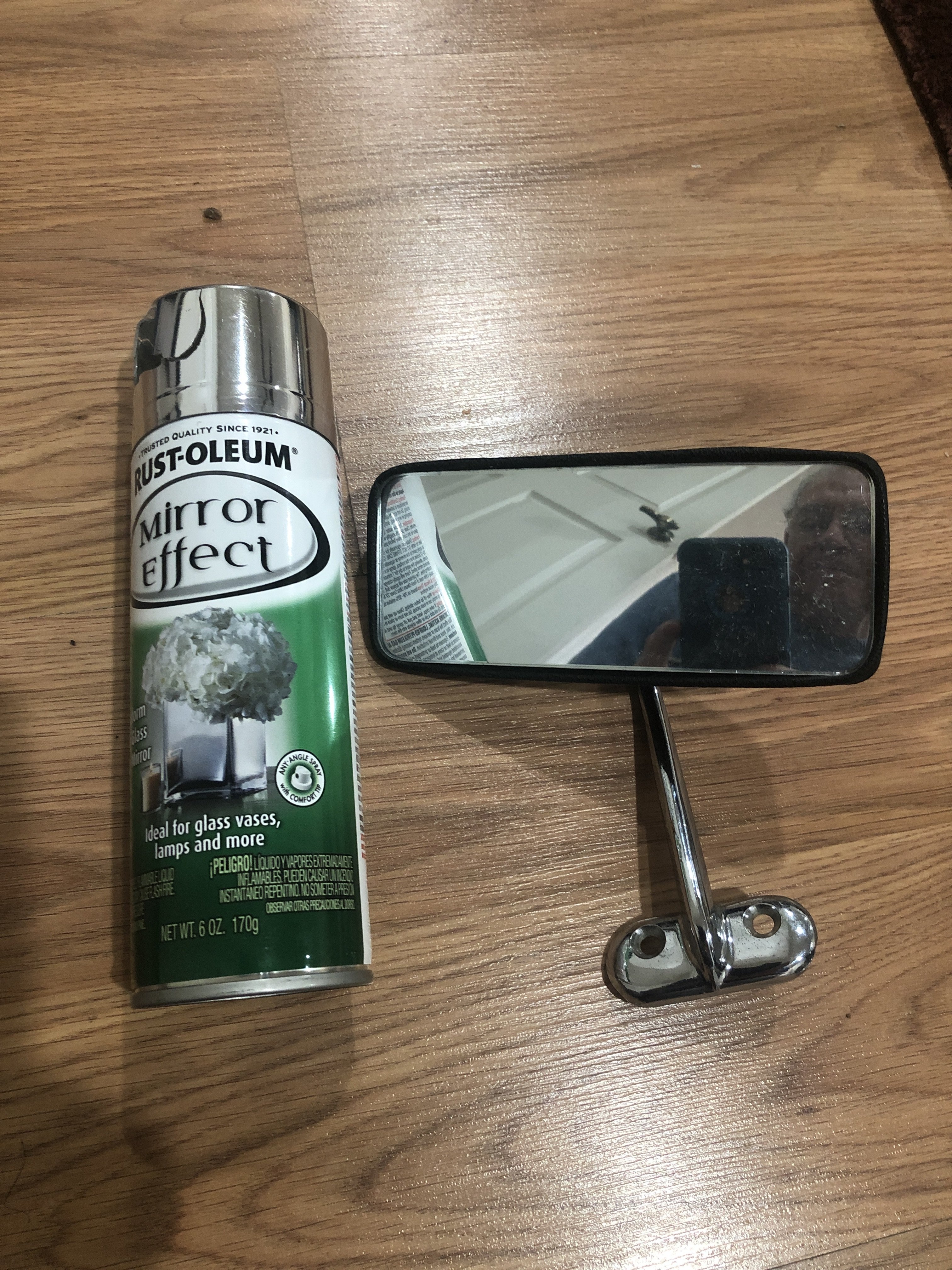

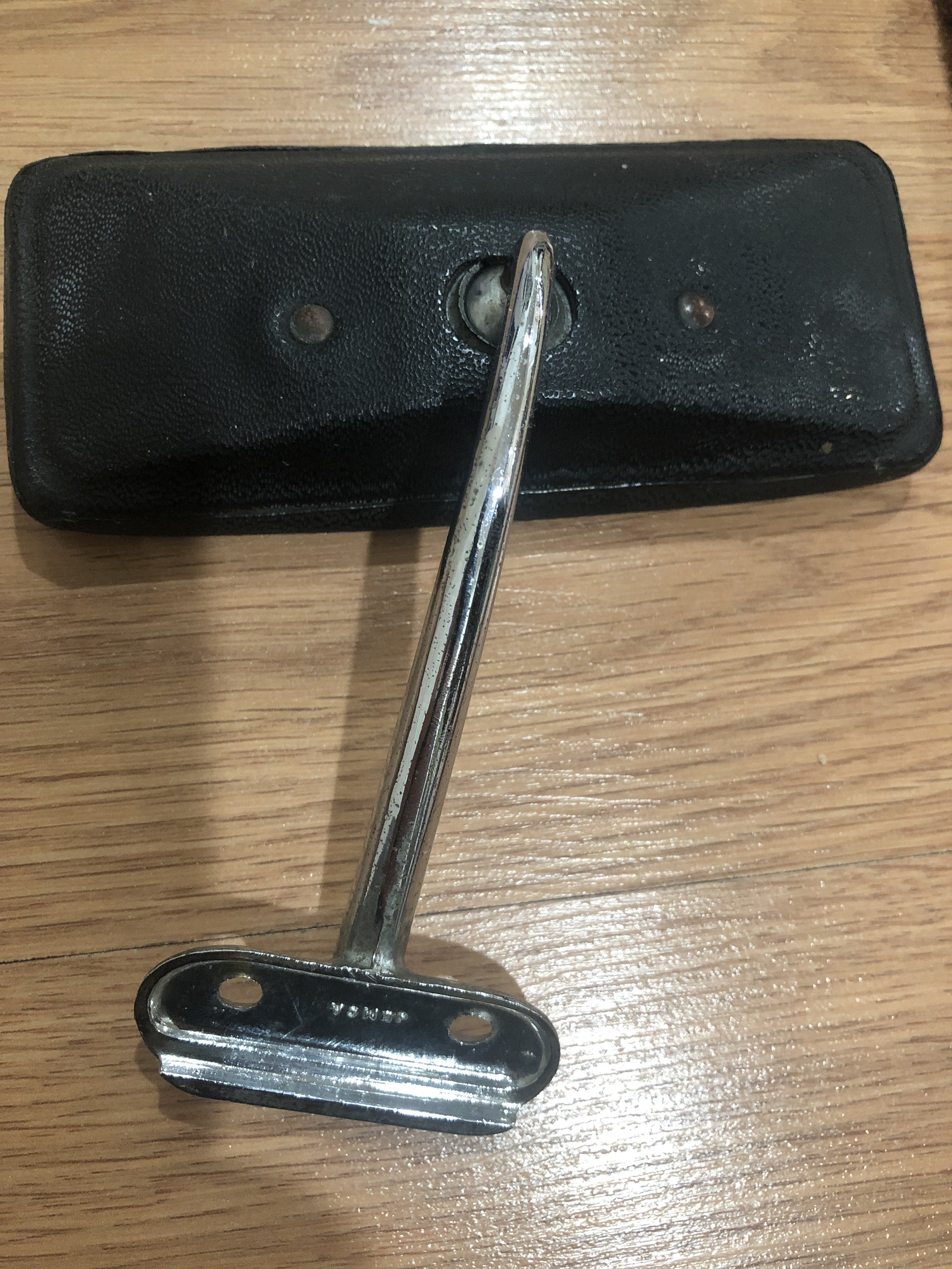

Looks like A is the correct one. My attached photo is from my 9471369 Tiger 9471379

The old silvering needs to be removed first. As I remember I used paint stripper on the brownish red coating then metal polish removed the silver coating, this left the clear curved glass which I wiped with alcohol then applied the spray finish
I did buy a used sunbeam mirror which had only a slight curvature to it and found its reflection very different to my original one. Kind of like the difference of a passenger door mirror and a driver side door mirror.
Bear this in mind when you replace the rear view mirror
I am happy with the results of the re mirror finish from rust oleum and would rate as good as 90 percent and kept the original mirror
The finish is an aerosol can and about 5 coats are sprayed on about 1 minute apart It then mentions to spray a mat poly over the 5 layers of silver but I did not do that.
Concur with the A mirror. I have a pretty nice B style that's better than nothing for someone.

If you take a new razor blade and using your thumb and first finger to set the blade at 1/8 inch you can run it tightly against the glass and outer plastic casing making sure it remains against the glass This will free the glass from the casing I found the remaining adhesive was not a strong bond against the glass and separated easily. The casing edges were a fairly tight fit to the glass and after re silvering the glass it kinda popped back into the casing enough hold that adhesive was not needed between the glass and casing only on the edges

While you have the mirror out make sure the swivel ball is smooth by scraping any pitted chrome and I lubricated it with a silicone grease. I believe if it is not smooth and lubricated it causes stiffness and stresses the mirror stem to the point of breaking and original replacements are hard to find I guess I am glad I inspired you to restore yours
