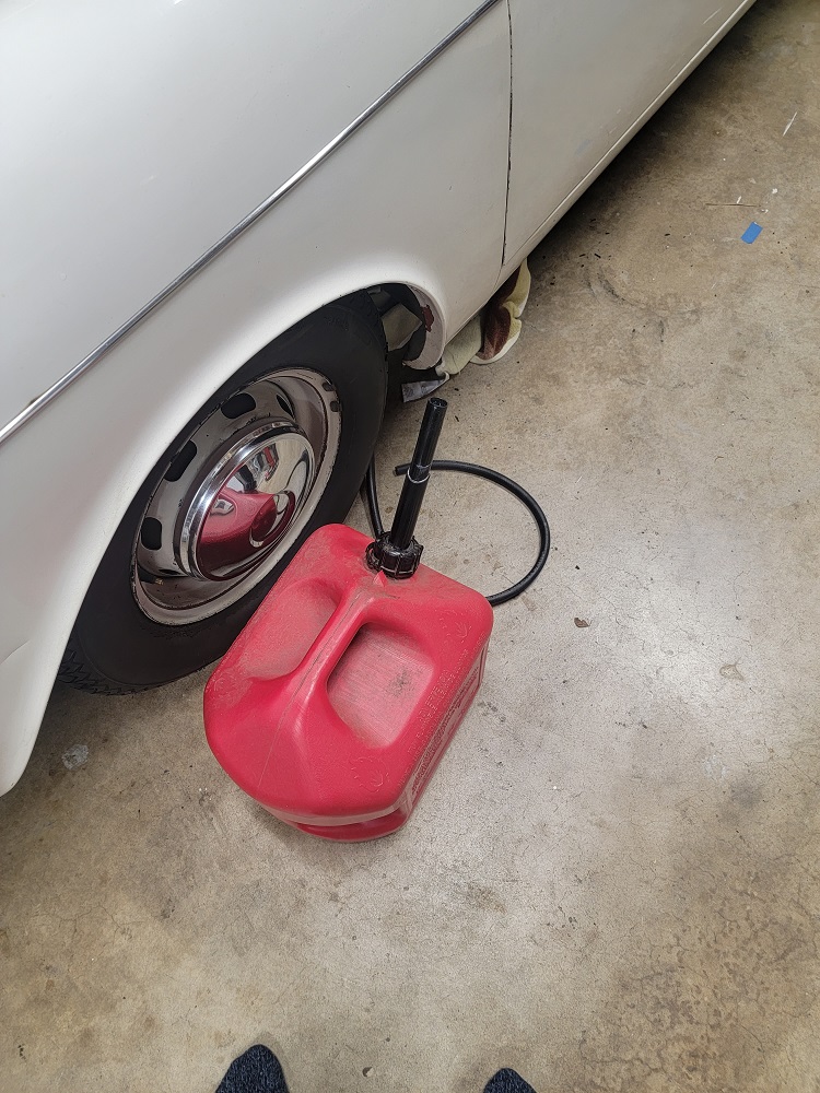

Since I know the tank to fuel pump line is clogged(tried blowing air up the line) We tried a line from gas can to pump inlet. Pump made a lot of noise and shook a bunch just like it was trying to draw off the plugged line, but same result. No fuels to engine.
As we have time we will continue to eliminate if it's a line issue from front to back or a pump issue. I may skip a few steps and just wire in a spare pump I have to the filter before the carb. I want to hear it run, and I feel confident it will, just need to sort out the other little issues to make it work as intended. Stay tuned.....

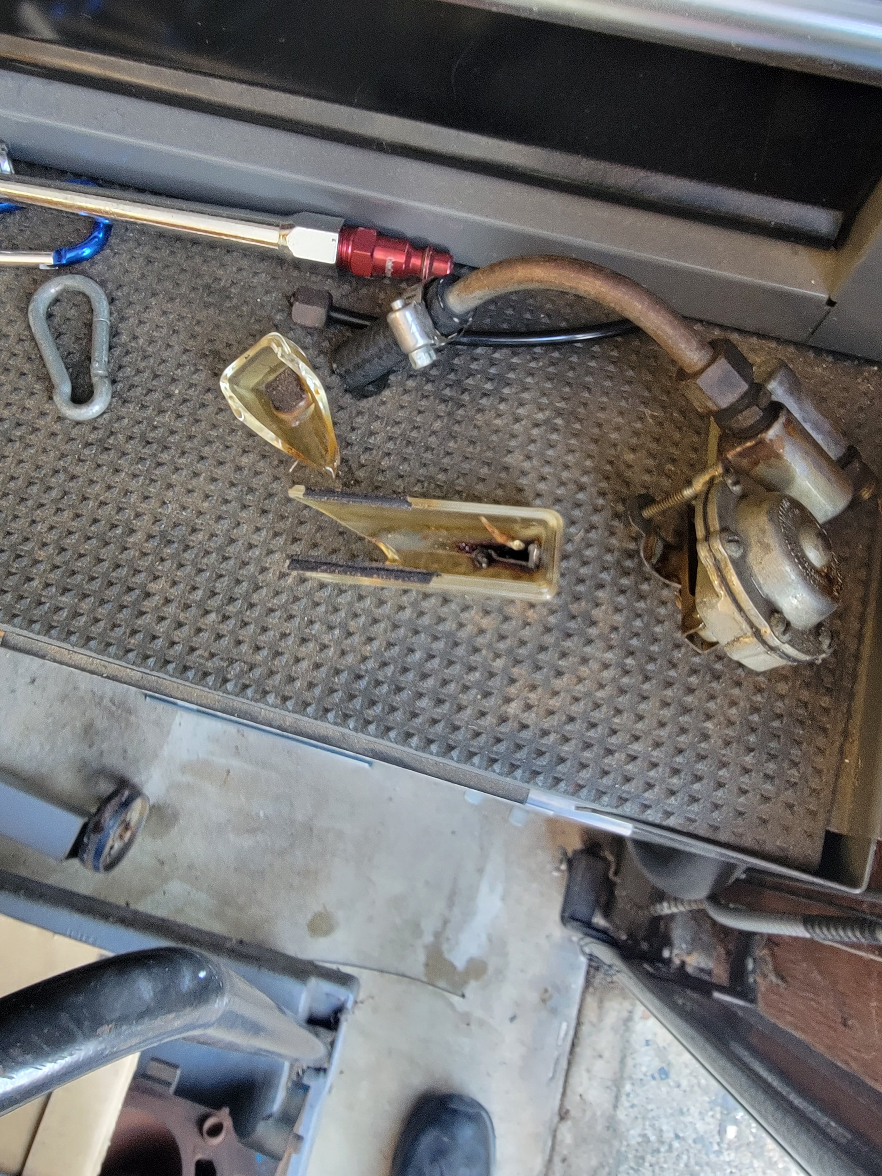

Pump is definitely toast. Going to wire in a temp electric holley I had in the bronco before going FI. Also took out the Miles Master Pressure regulator that was installed in the engine bay and replaced it with rubber fuel line for the time being. The glass bowl was cracked and brokenso I'm pretty sure it was going to leak. Blew out the lines from the carb to the pump and they were a bit gross, but clear. Going to spray some carb cleaner in them before putting in the temp pump. Hope to have motor running (probably poorly) tomorrow or Sunday depending on what my wife has planned for us this weekend.
In the picture is the broken Miles Master and a piece of the broken oil pressure line I need to replace. The top of the lower box is my current boneyard for broken parts.

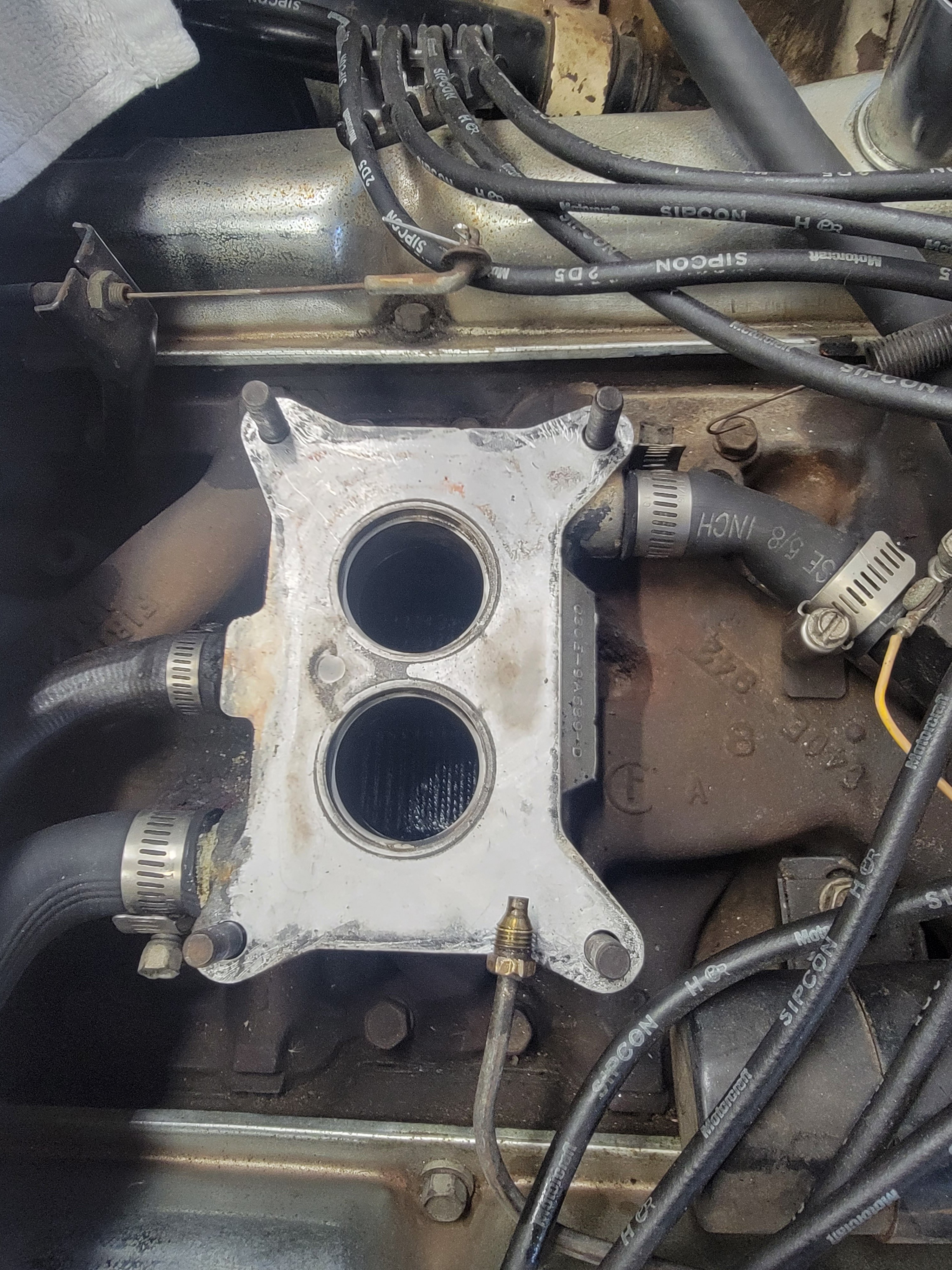

Float was stuck, so we took the top off the carb and got it working, cleaned it out fairly good and got it to stop puking fuel everywhere(I had the same issues with the bronco when it was carbed). Fired it up and IT'S ALIVE. Smoked for a bit , and wouldn't idle then eventually sucked something we must have missed while cleaning out the bowl and plugged the jets. But it ran, fairly well for about 45 seconds to a minute before it died. Tomorrow is carb rebuild day and perhaps moving under it's own power.

So after a carb rebuild, it actually runs pretty good.

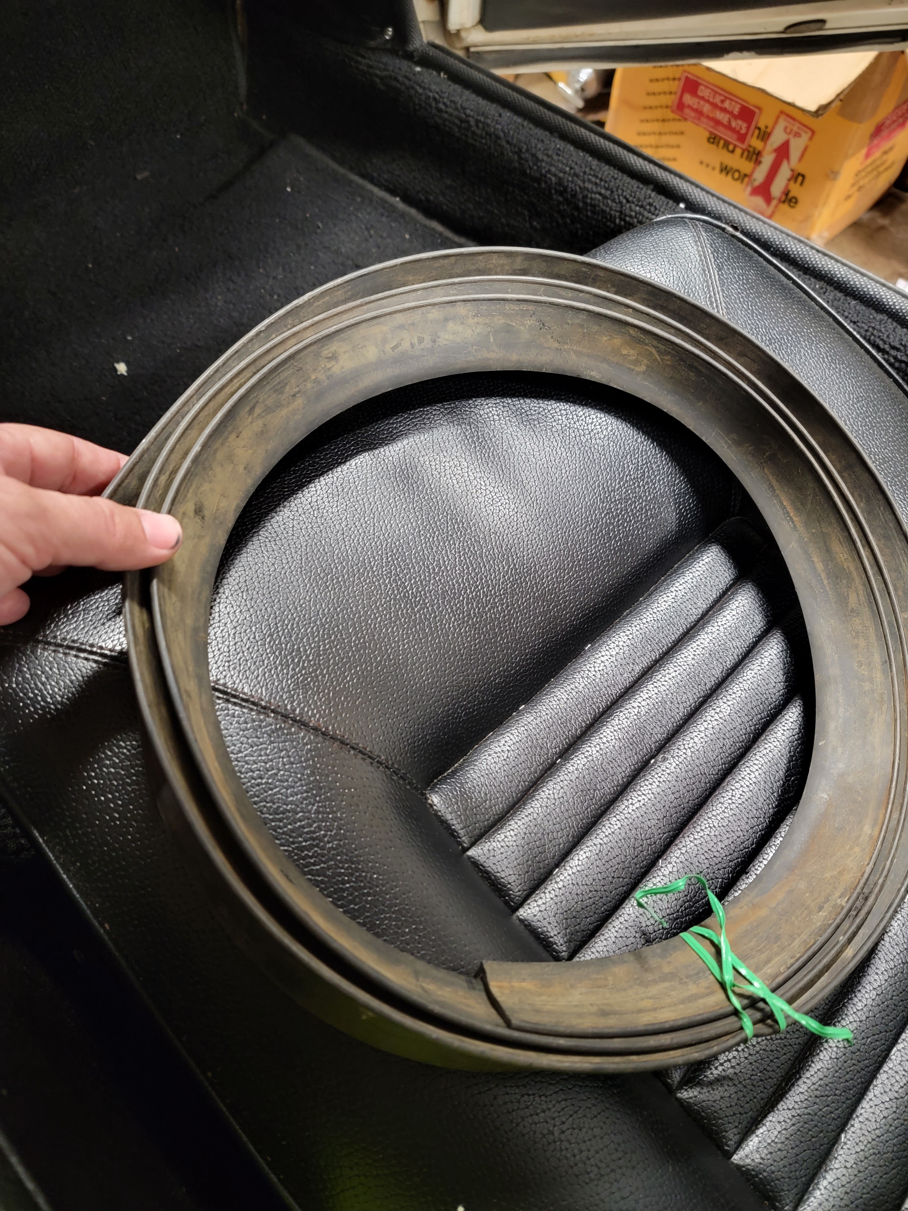

Anyway, as we went through some of the parts, we found a brand new headliner for the hard top, in great usable condition, as well as this rubber gasket in the same bag. Without taking the top off, I am guessing this is the rear top to body gasket? Confirmation would be appreciated. Oh and if anyone know how to post a video, we have video of it running on it's own for the first time in about 40 years.šŸ˜Ž

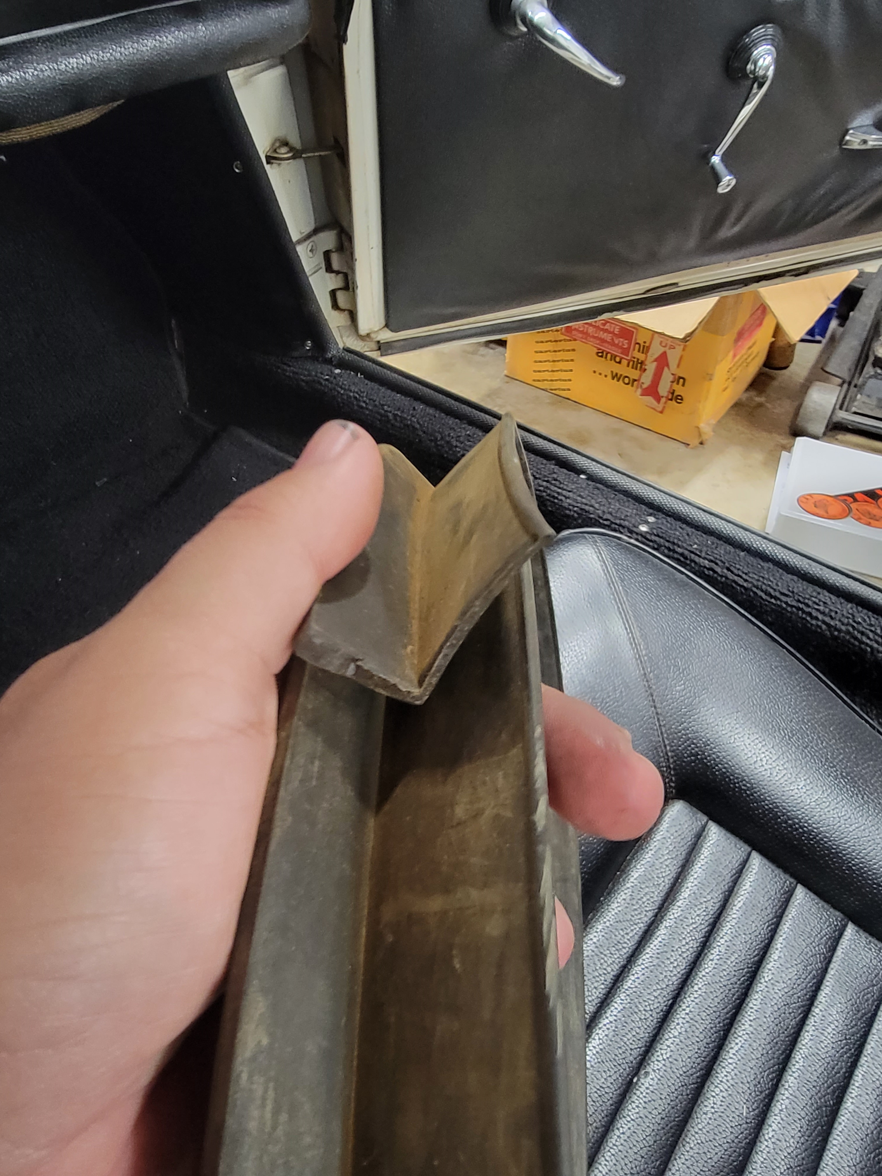

So after 2 trips to SS, we think we have the right interior kit. We purchased one on Monday with a bunch of other parts, and when we got home and pulled it out of the box we realized something was off. A little more research and a couple emails later we confirmed it was wrong and that we would need to drive back down to exchange it.
By the time we got home today and needing to get ready to have family here at Christmas we decided to just tackle a couple small items this afternoon. My wife replaced the under hood rubber seal and then, with some assistance from me, the hood bumpers/buffers. We adjusted each of them and the hood closes nicely and should make for a rattle free drive. We also drilled out the rivets and installed a new spec plate as the original was missing.
We both have the next week off, so after Christmas we will work on rebuilding the brake booster and the spare SU fuel pump that came with the car, which I am guessing to be the original. It still has the "U" bent portion of line attached.
I also would like to add that whatever material the original gaskets and seals for the boy were made from turns into the finest powder I have ever dealt with, I think it's already plugged up my HEPA filter(n)
Boring picture...
