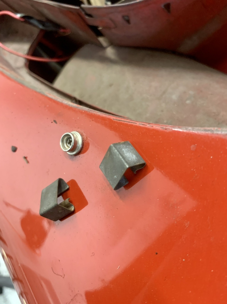

I photographed these parts when I dissasembled the car. I have no idea what they are for. Does anyone recognize them?

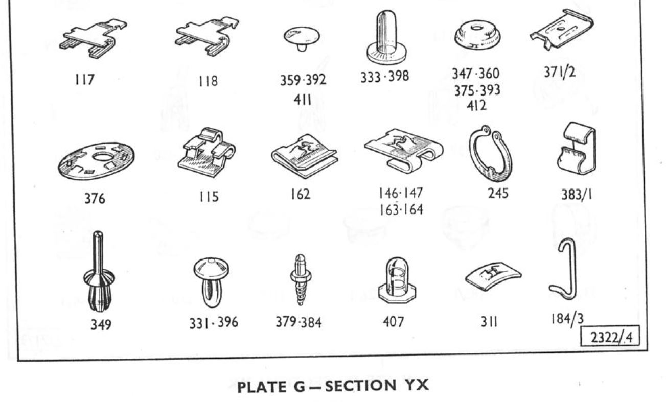

I pulled out my Rootes Alpine Parts Manual and found what looks like your clips.

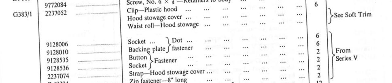

383/1 looks like your clips. Here is the part description for 383/1:
Unfortunately, I could not find a diagram showing exactly where and how these clips are installed.
Good luck!

Iirc they hold the extendesmd soft top flaps that hang down onto the drain channel on the lhs and rhs to ensure water runs into there not the car.

My car had no soft top when I bought it, and I think those were laying in he bottom of where the soft top goes.

There is a drain channel that runs around the rear valence where the softtop goes. It then finsihes in the B pillar. It clibs on the thin edge of the channel

If the clips are laying down in the body you'll find that the clips tended to get pushed off when stowing the soft top. The other problem is that depending on the condition of the soft top frame it's possible that when lowering the top you could catch the top material on the clips and tear or damage the fabric. I've seen that happen. The original idea of using the clips was a good idea but I doubt that there are many cars out there that have the clips.

SS sells clips for the top connection to the drain channel, but they look nothing like the original, which is why I was so confused. I can see now how the originals work, but they don't stay on very well. I used glue and the SS clips. Thanks everybody. Sorry to keep asking.
They are not a mystery any morešŸ˜Š
