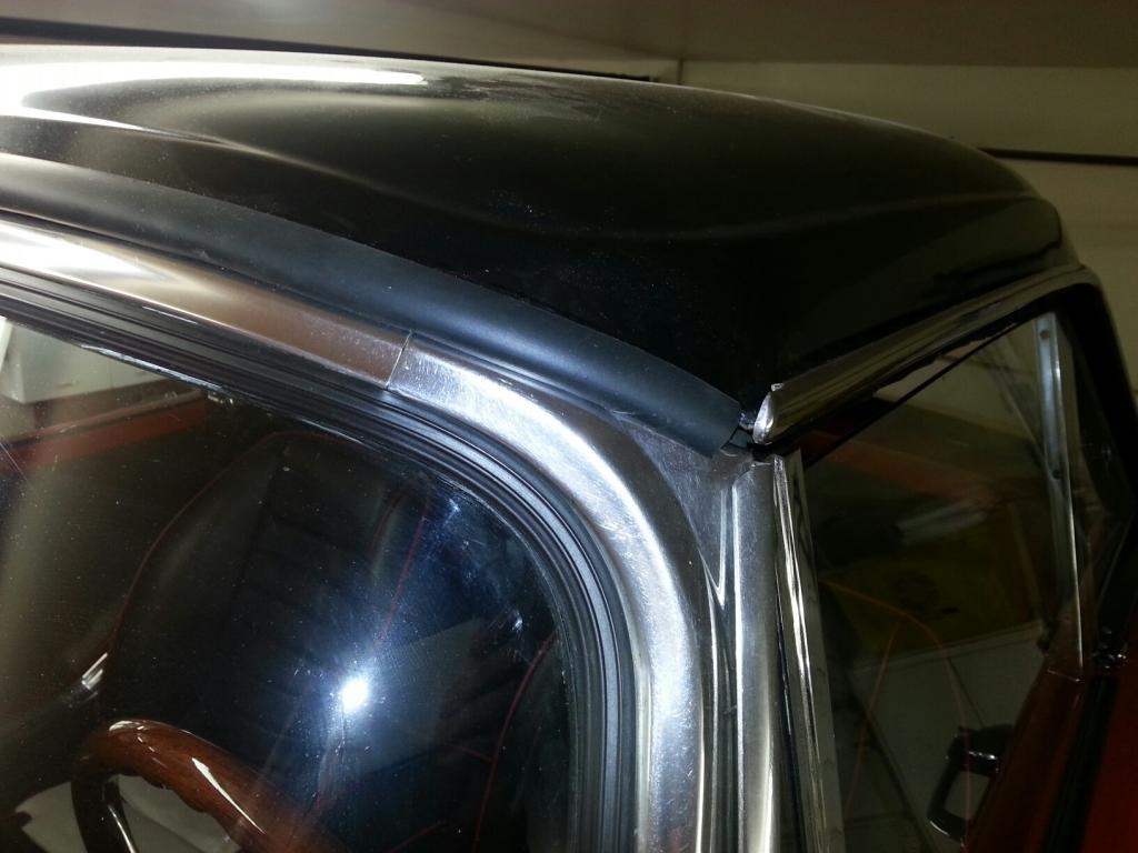

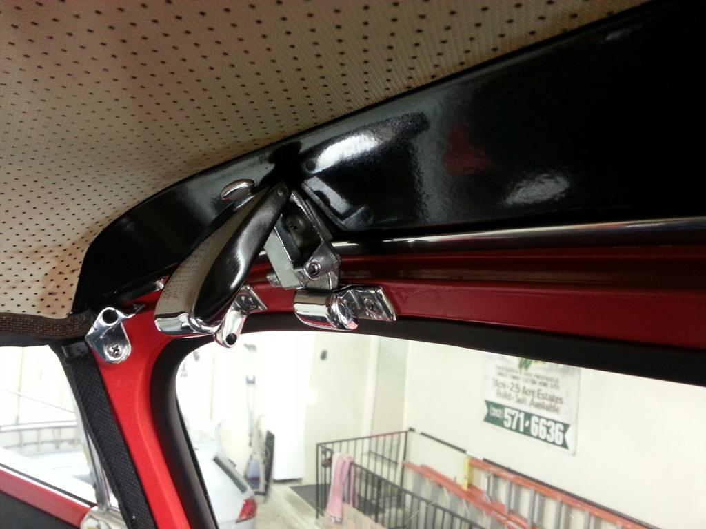

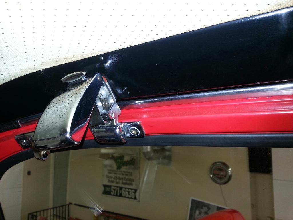

Gentlemen, Thanks for the help. First off I do apply pressure downward on both the hard top and soft top from outside while trying to latch and both tops are almost impossible to close. I am interested in the spacers, how they work and who sells them, Cat or Sunbeam Specialties. I have attached some pictures to hopefully show alignment.

Tou have the clamp shims ( wedges) ...i can see them behind the clamp in your closeup photo of the clamp. As i said its likely the thicker seal has lifted the clamping point so loosen the clamps and re position accordingly.

When I installed my new soft top with new front seal, I had to push down on the soft top front frame piece while I pulled the seal lip in front of the windshield frame. In the 3rd picture you posted, it appears that the seal lip is pinched between hardtop and the windshield frame. If so, this would inhibit the clamps from closing. I had to do this for some time until the seal naturally took the shape of the windshield frame.

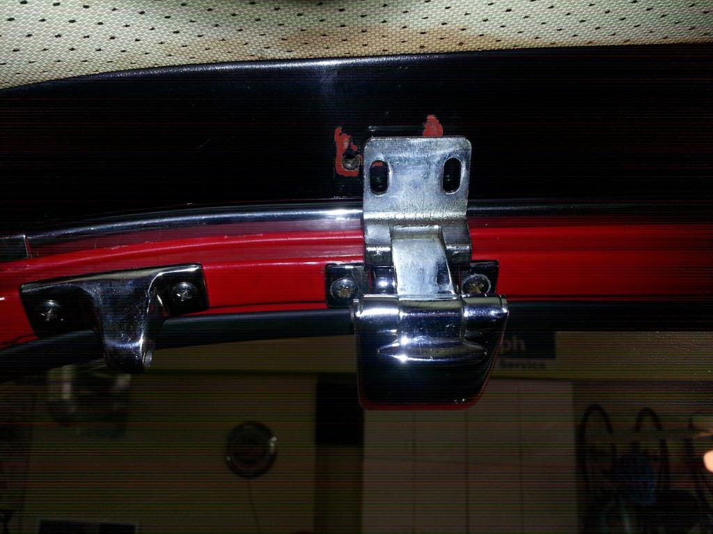

Well the plot thickens. I indeed do have the shims but the latch don't look like they are in the optimum place. I took the latches off and with the top in its natural position this is how they would need to line up (see picture). Question is can I remount by moving the slots over on the latch? The holes are threaded and fixed.

WHAT ??
Well, have never seen that issue in all the decades we've been beating on these critters. You have something really wrong there and it's best to start measuring everything several times before making any cut-to-fit decisions. . .
Just sayin' :confused:

To second Randy... Huh????
Did you have the top fitted before replacing the seal? Difnyou just restore the top or do any screen frame adjustment / work.. A seal would make it sit higher pr proud...not offset

The top went on before the new seal but not easily and probably not well, just doable because of the shot and compressed windshield to top seal. It was disintegrating. The new seal has likely magnified the problem. It is a really nice hard top in great condition.
I agree with you guys. I am going to start with taking the front seal off and looking at the alignment without it in place.Should be easier to see gaps. Then I am going to look at the pin and pin receivers in the back, the side latches and the front latches. I want to get this right. I will be able to work o it this Sunday and report back.

Looking at your picture it looks like the rubber is rolled under the front edge of the hardtop. I believe it should be over the windshield trim.
