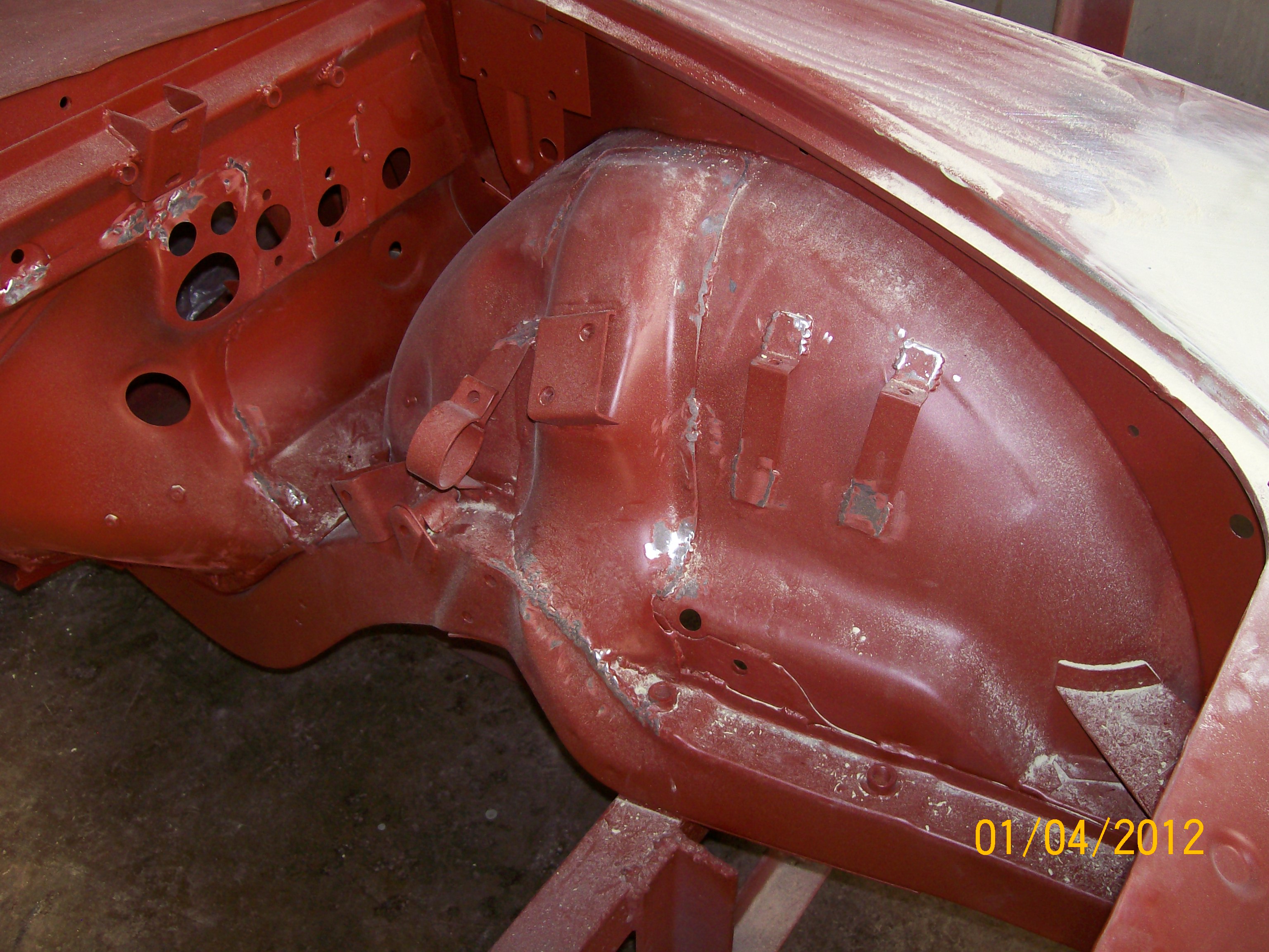

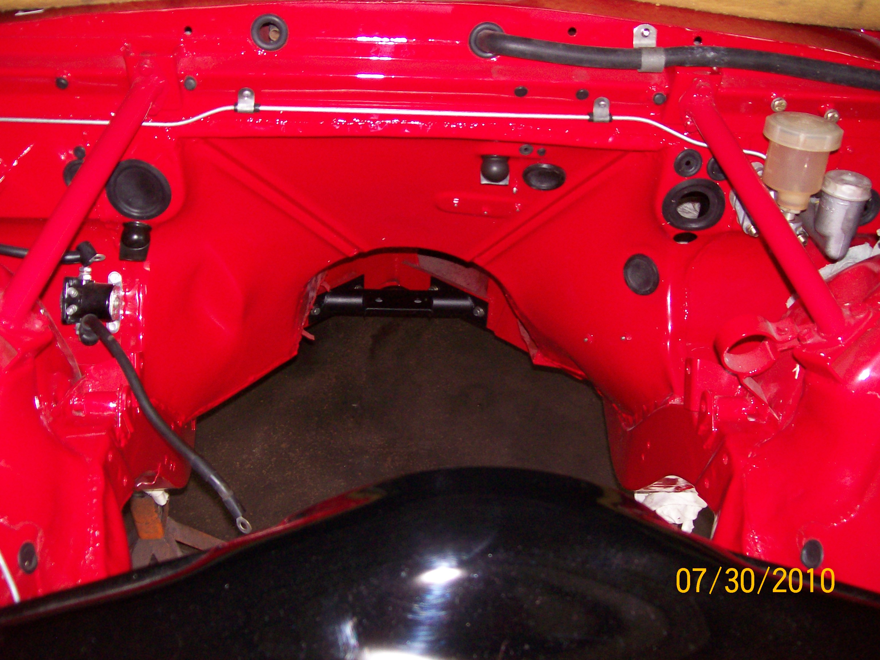

Besides the obvious things, like square corner panels and fresh air vents, (which can be changed/altered/added) there is one obvious difference between a MK1 shell and all later variants (MK1a transition, Mk1a (series 5 type shell, and Mk2). It's also one that would be virtually impossible to do cleanly. Mk1 inner firewalls/bulkheads do NOT have a relief for the steering column. All later Tigers and series 5 Alpine do. Checking this will instantly tell you what the shell started out as regardless of how the body has been re-skinned/changed.
The red car in image one is a Mk1 in the B9470900 range and is a Tac'd car with known history. The white car is a transition bodied MK1a in the early B38200 range

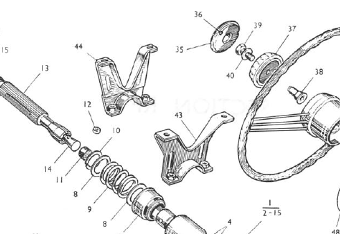

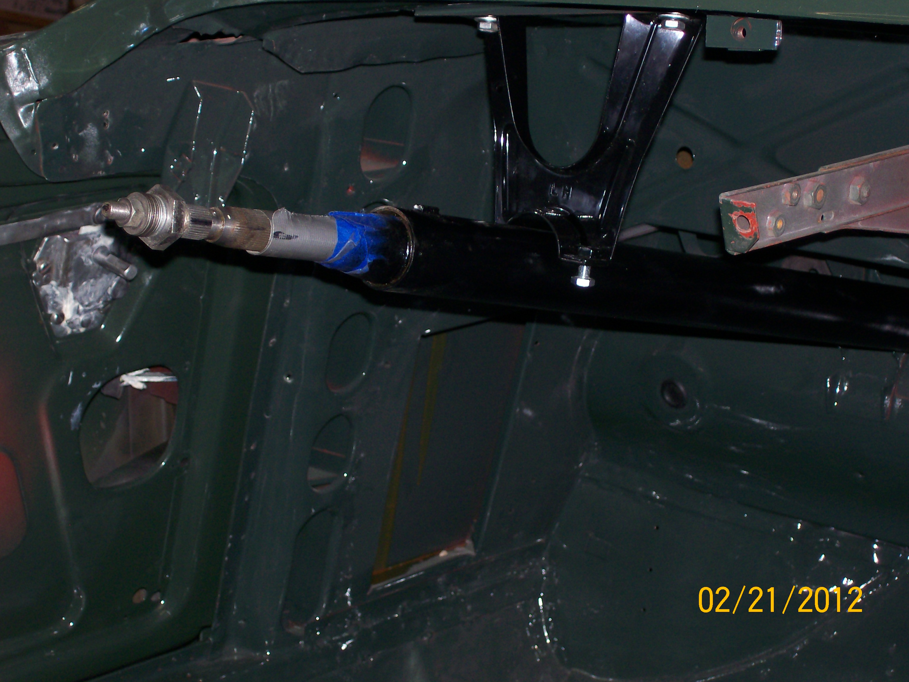

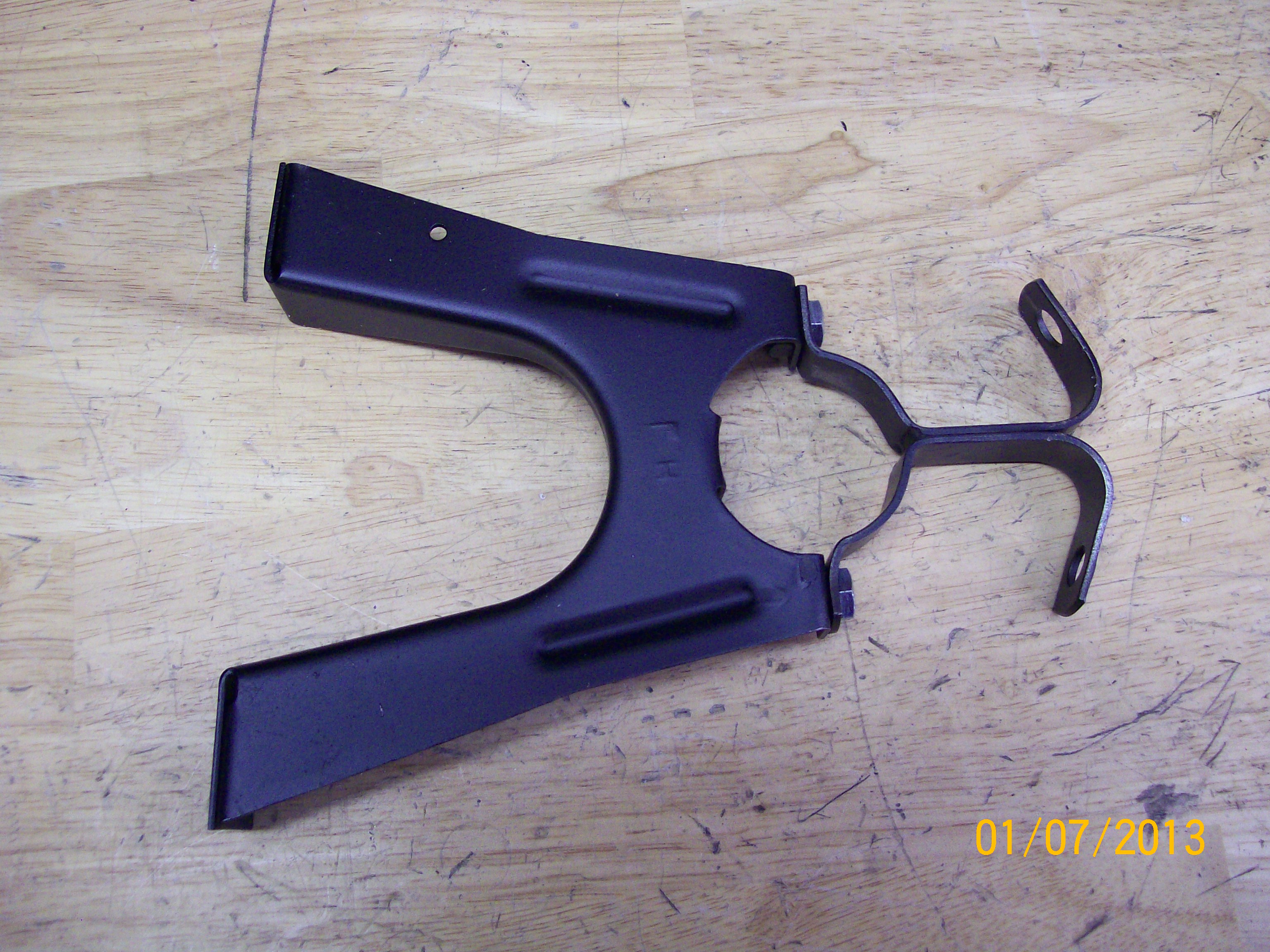

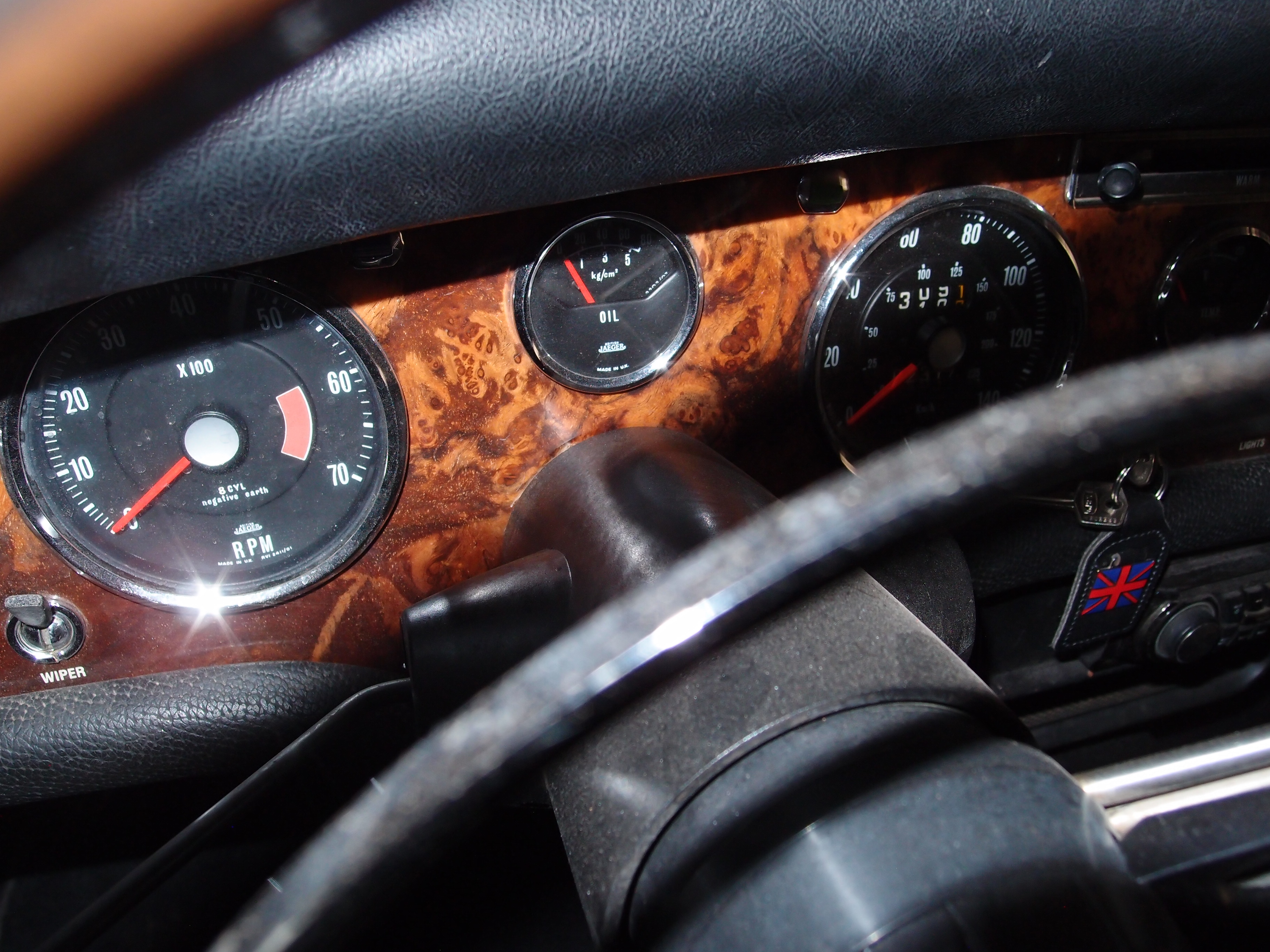

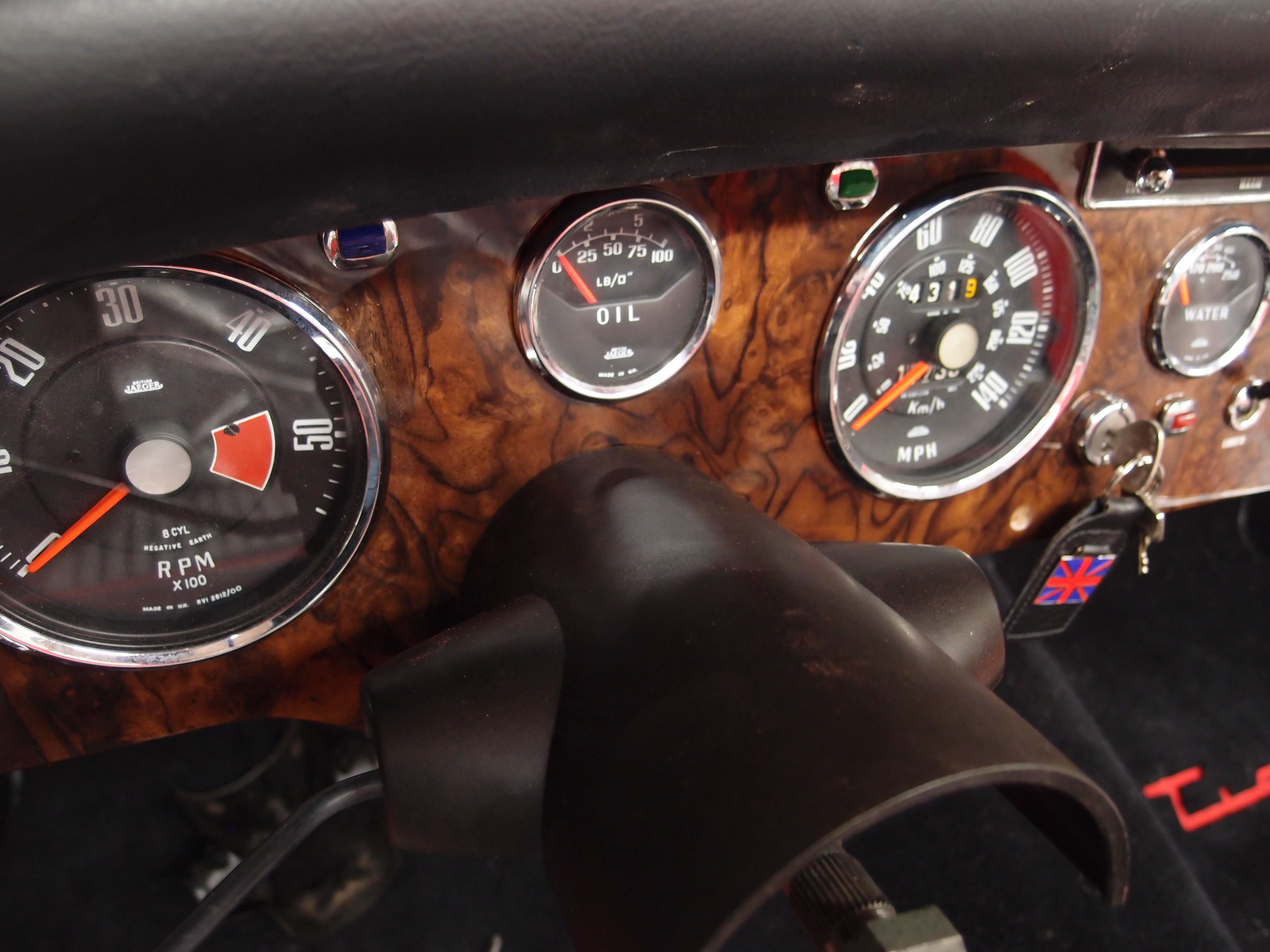

I have an early steering column bracket and the 2 piece one illustrated in the parts list. They are different in that the 2 piece bracket is 1/4" shorter. Later in the series 5 and Mk1a production the bracket reverted to a one piece design. Pictures below is my Mk2 which I know to be original. There is just over 3/8" between the oil gauge ring and the steering column cover. Below that is a pic of a Mk1 in the 900 range (chassis number) and it is just a touch over 1/2" between the oil gauge ring and the steering column cover. The 3rd pic shows the 2 brackets.
There is less than an 1/8" difference between the steering column height between the Mk1 Tiger and my Mk2. As I said, the difference in negligible.

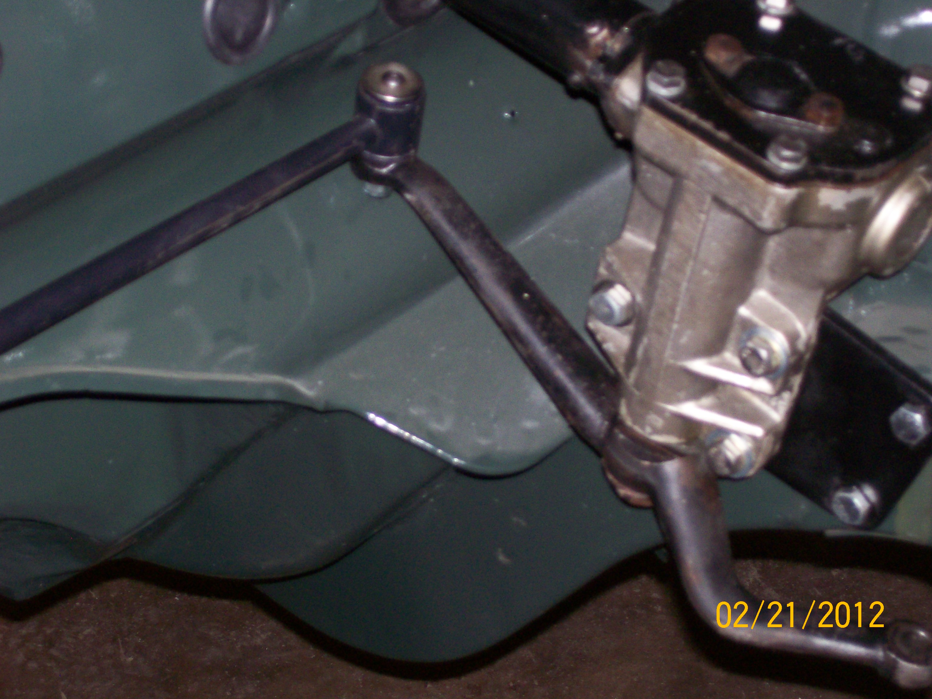

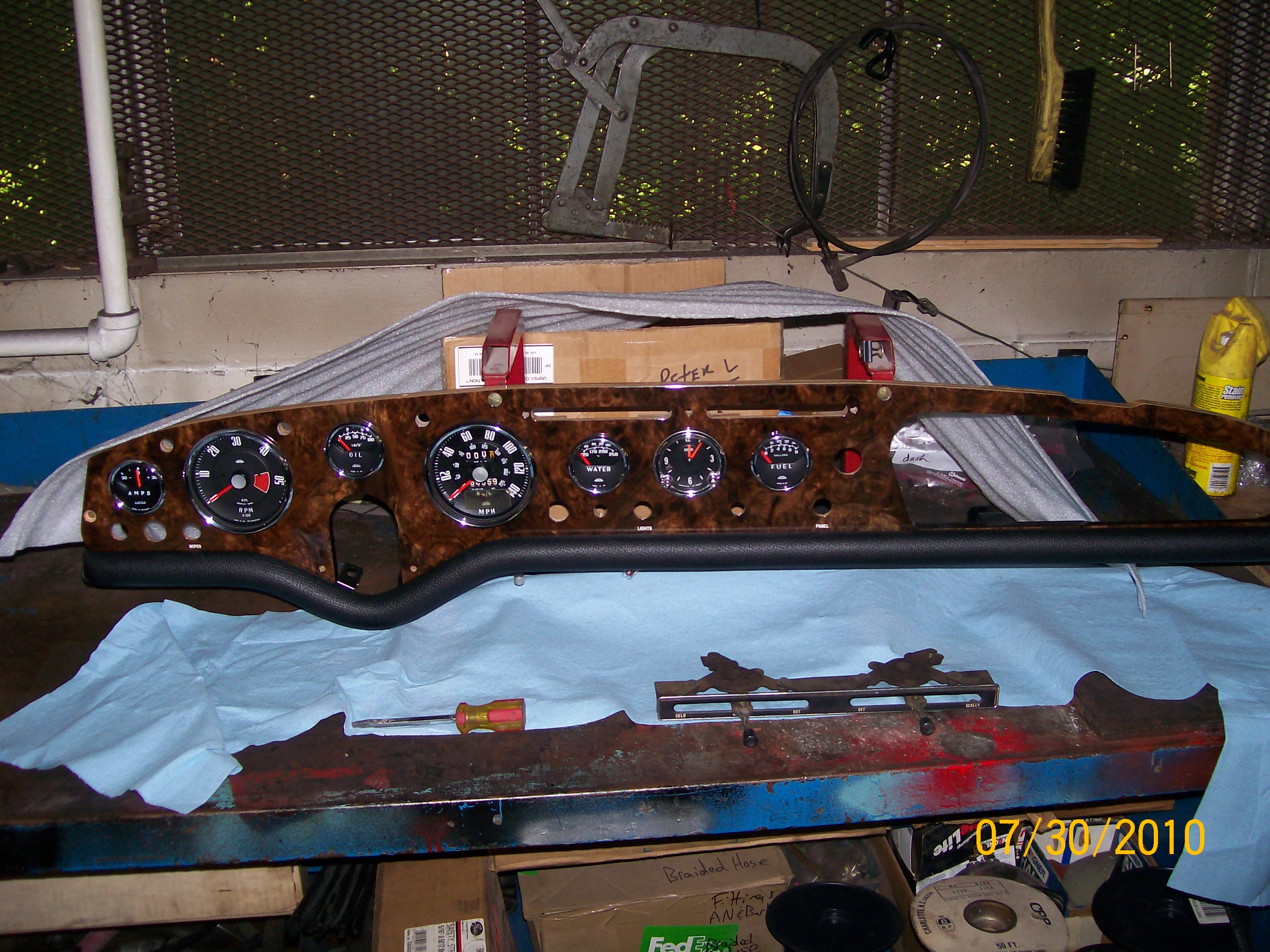

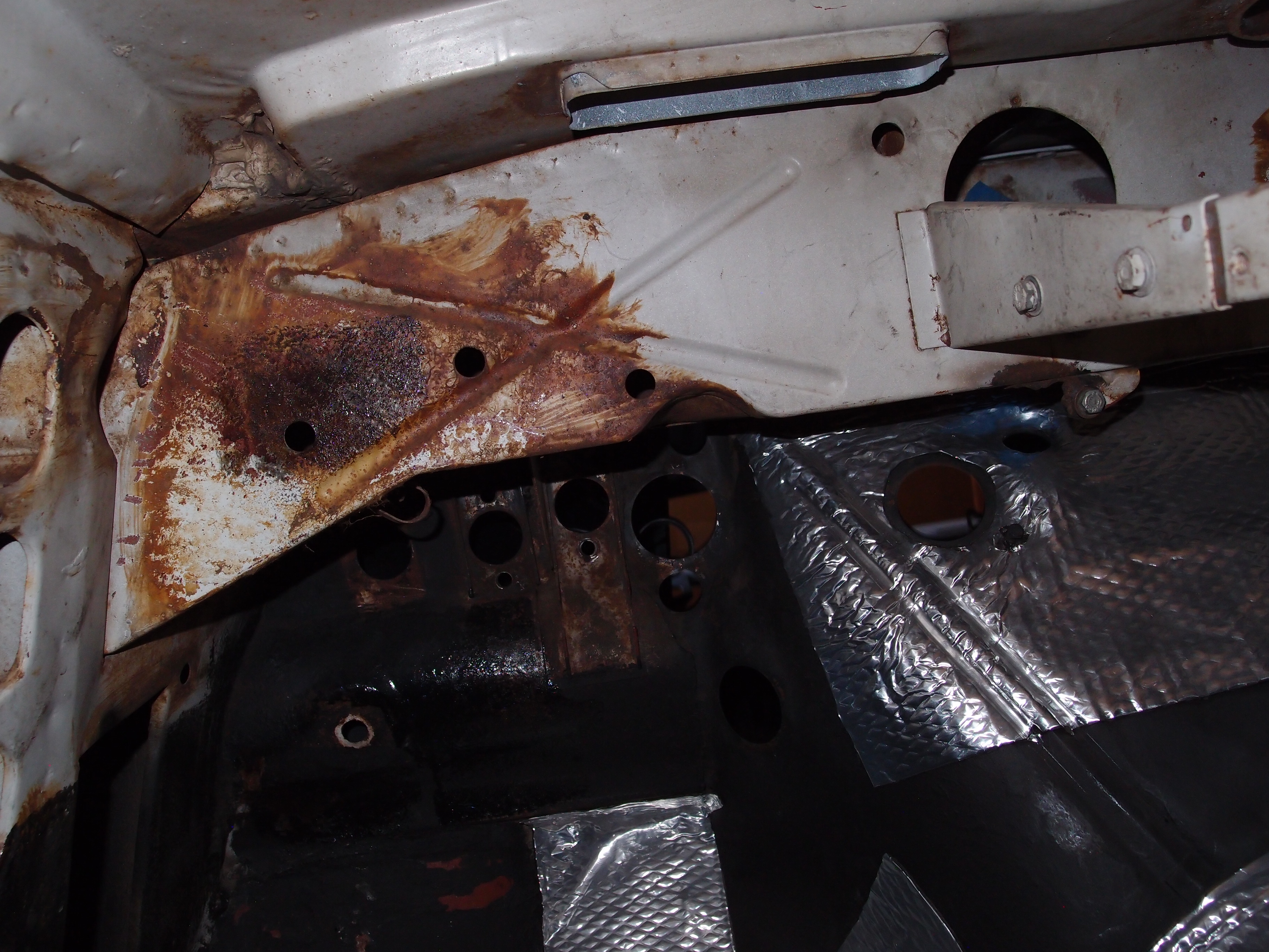

There was a change made to the Steering column and bracket when the adjustable column came into use with the series 3 Alpine. Prior to this change the steering wheel set farther out from the dash. The tube of the steering wheel column diameter was also changed. There is a clamp that bolts to the bracket and holds the column in place at the dash. The waist roll along the bottom of the dash bolts to the bottom bracket. The column was also attached to the gear box and it bolted to the frame rail. The brackets for the gear box can be seen under the bracket for the Tiger column. There was a difference between the dash opening for the steering column of Alpines and Tigers. These photos show some of the differences
