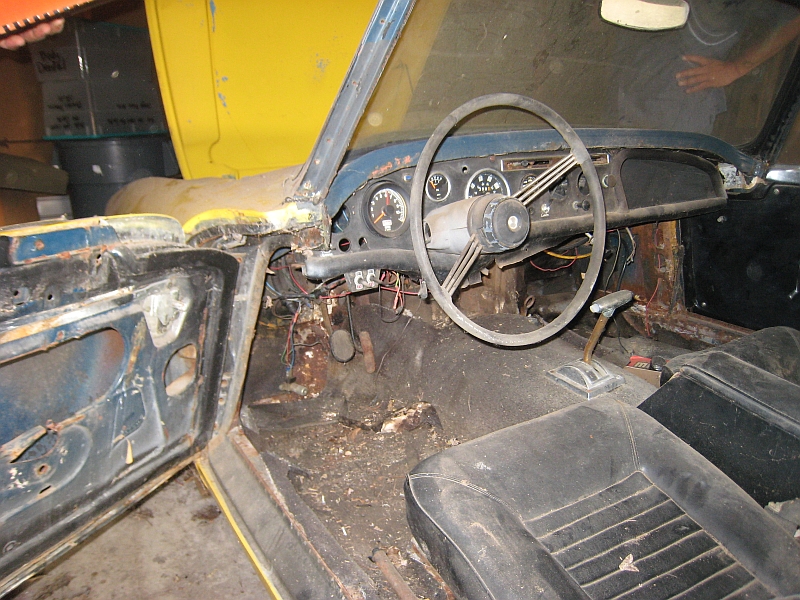

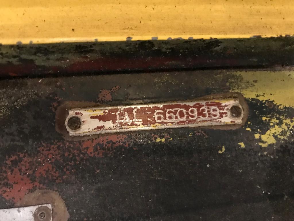

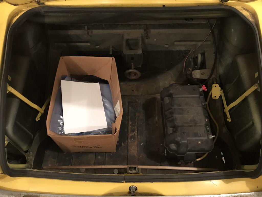

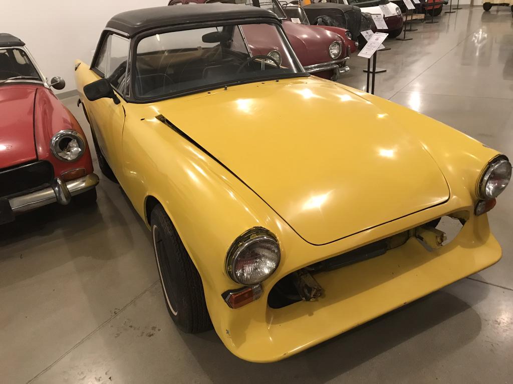

I was wondering what this car is.
I uploaded 4 photos so I hope I did it correctly and they show up once I’m finished.

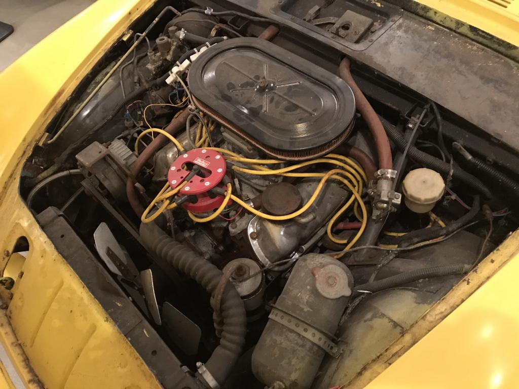

Extra help in figuring it out.
I hope these will help. I think original color is a lighter blue

Get under the dash and look for white paint. Also remove the cover for the heater core look for more white paint. So much has happened to these cars over the years. The boot says maybe not and the supports too under hood. TIROST has the car in Il. in 2003. Please get more pictures and look to Norm's site for the other well published areas to shoot for us. Be advised that Norm's site only says that someone reported the VIN in 2003 and possibly the trans and rear end number. Welcome
B382000934 tiger

The nose cowl bonnet hinge support lacks the two press-in nuts that hold the Tiger rad shroud. Photos need better light & clarity, etc. Just sayin'
