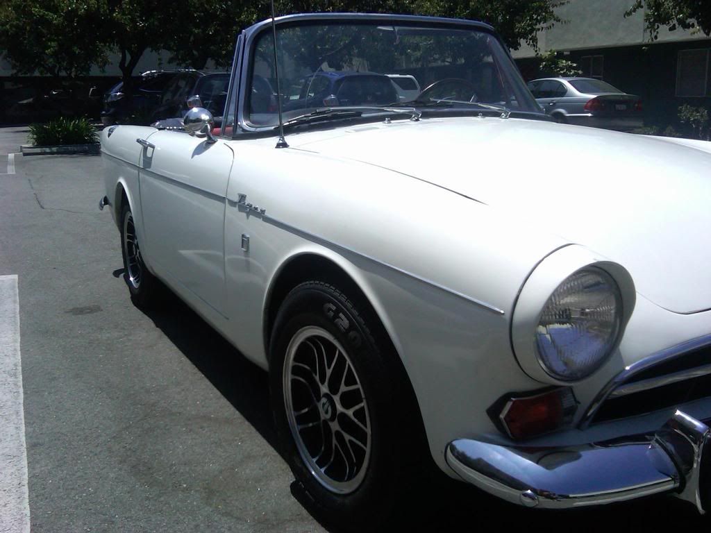

New Tiger 1a owner. I'd like to put an interesting mag wheel (15") on my car. Maybe something vintage. Has anybody had success with any vintage style mag wheels on their Tiger? Thanks.

Here are my Cosmics finished a bit differently and with Cosmic center caps...just for info (I really like the Tiger center caps BTW). Every once and a while I see them on e bay although adapters are needed as the bolt pattern is different. If you want the model number, let me know...I have it somewhere. You can also find them more readily in England...FYI

That said, not much to add to what Growler said. My Cosmics were on the car when I bought it a few years back. I am not sure if they actually make cosmics anymore, but you do see them on ebay. I believe there is a company called JBW wheels in the UK that make a modern version. OBTW I have stock hubs/lugs and do not require an adapter.
