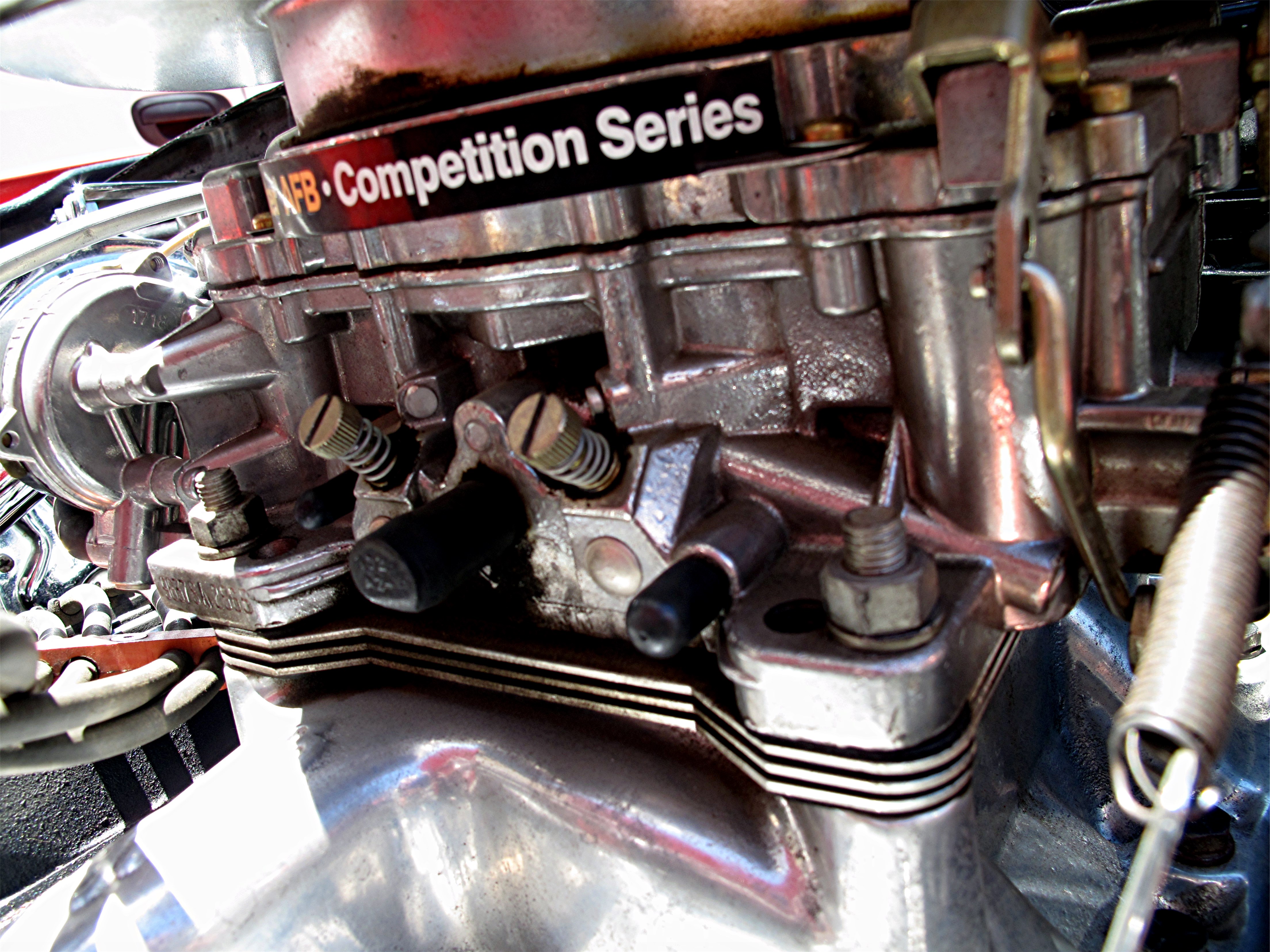

What kind of carb spacer do you have?

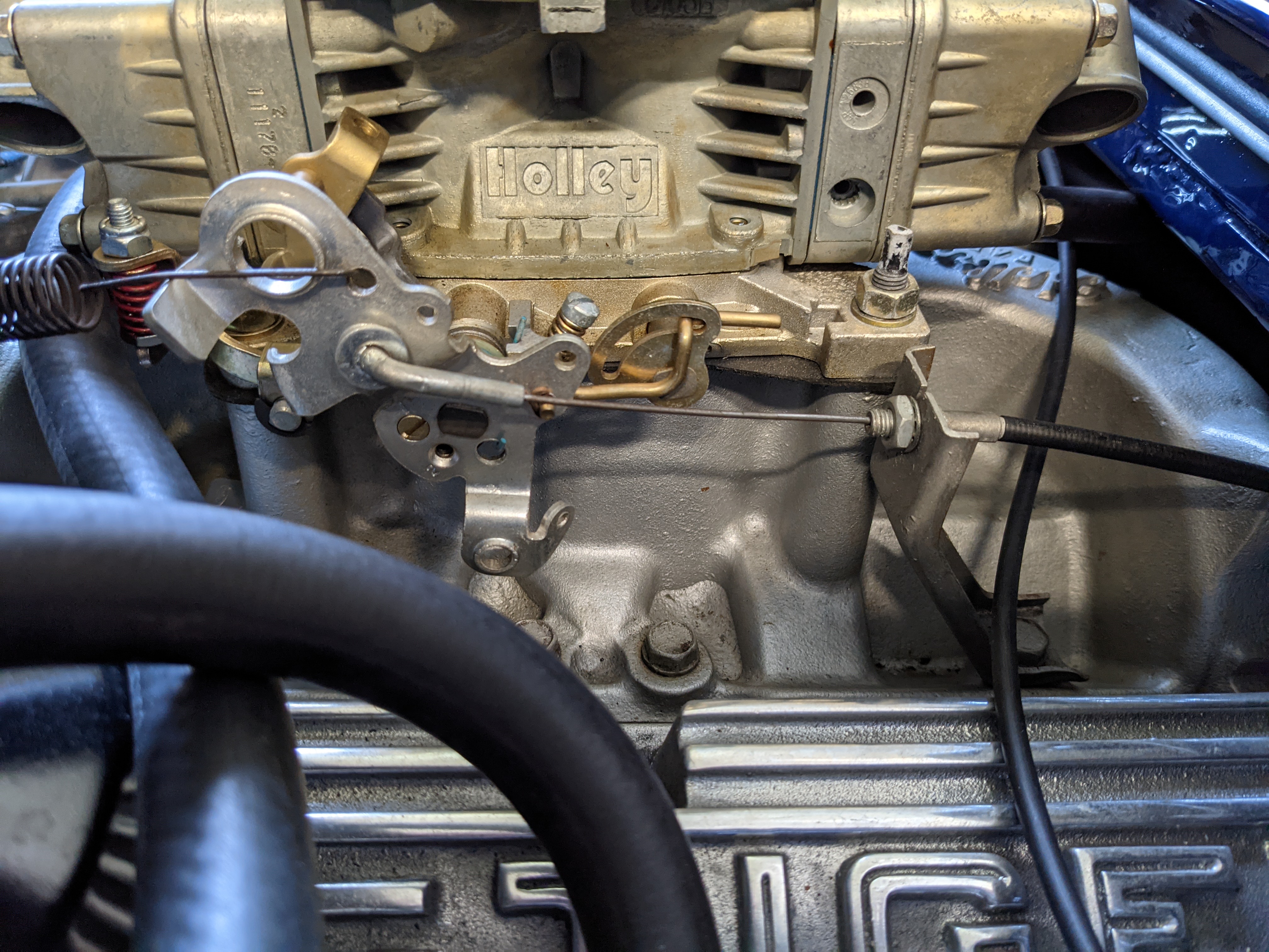

No spacer. Carb sitting atop F4B manifold.

You might want to consider a spacer. I had this issue back when my MK I was my daily driver. There's a real possibility that the warmed up engine is boiling the fuel in the carb bowls and causing starvation. I was running a Holley straight on top of an F4B then.
Check everything else - fuel pressure, spark etc. after it has warmed up to eliminate them first.

A phenolic spacer did the trick for me. Mine is only 1/4" so doesn't interfere with hood spacing.

You can add these gasket/spacer combos until you run out of head room- serves as a heat shield and adds a little ram effect:carb plate stack 001.JPG

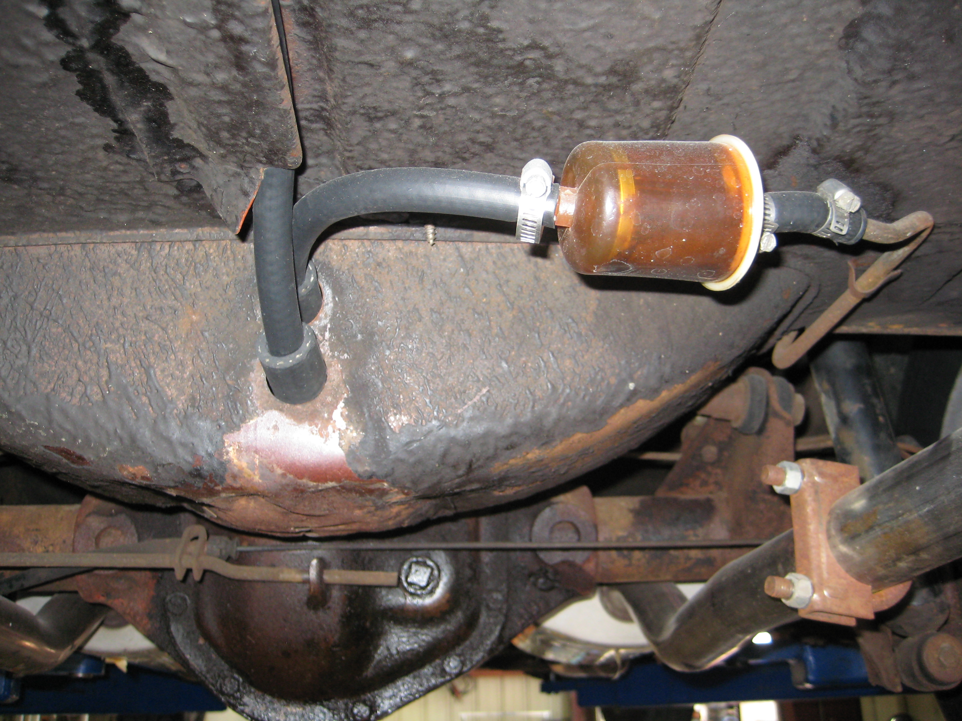

The MK2 fuel filter location is under the rear of the car by the spare tire bulge. It's a mess to change being at a low point on the tanks so be ready to get soaked.

Here's how they put the filter on at the factory. There was a stock plastic Fram there . If you are changing things having the filter on the intake side of the fuel pump makes sense. I fashioned a super fine screen on the intake side as I wanted some pump protection and the correct but questionable stock appearance.
When it's having it's out of fuel problems is there visible raw fuel from the accelerator pump discharge tubes. I would also think of a big filter like shown as a nice way to maintain pressure.

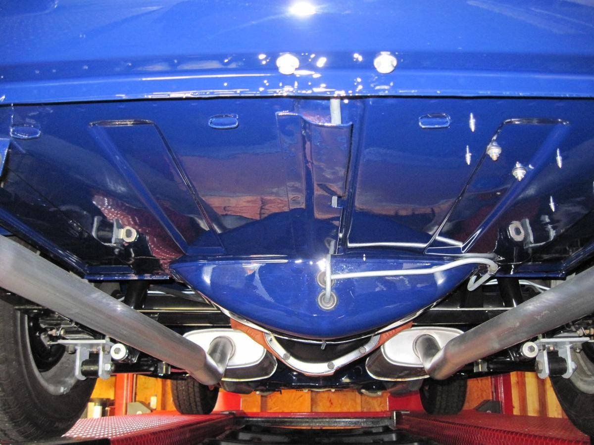

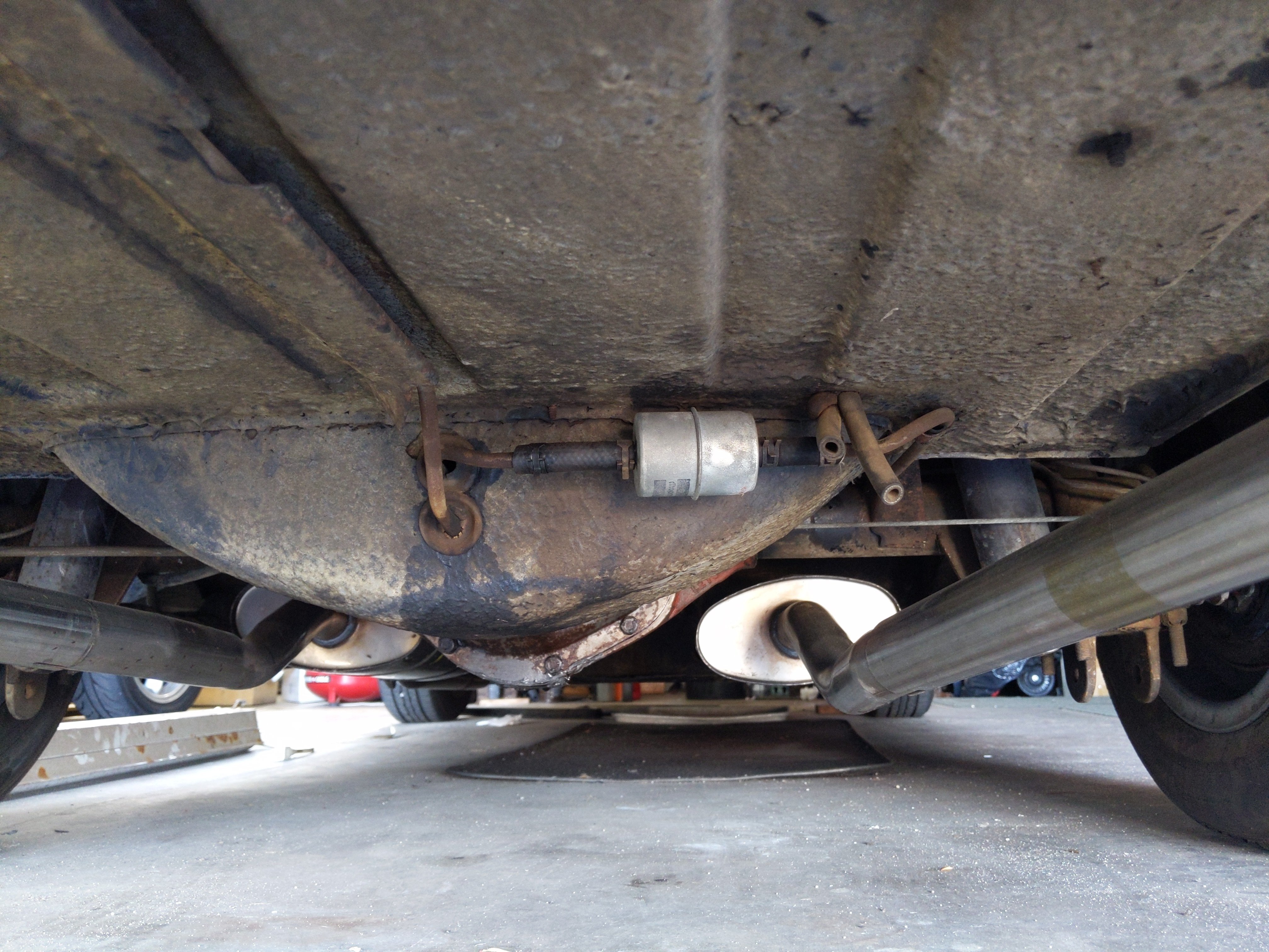

Nah, it's in the 50's/60's as the high. 70ish next weekend. Was almost 40 when we teed off this morning. Don't notice any fuel discharge when it's acting up. Changed Ballast Resistor and went for a ride but not long enough to get very warm. Mostly just to make sure it was functional. Will take it for a longer ride tomorrow while I wait for the heat shield and fuel pressure gauge to arrive. Then I'll place the insulating sleeve on the fuel line, the heat shield under the carb, and the electronic fuel pressure sensor on the fuel line. If the pressure is low or gets low when it craps out, I'll change out the old SU for the new one from my spares box. Pic below is what was there before the resto. I do plan to add a filter back but will have to drain the tanks first.
