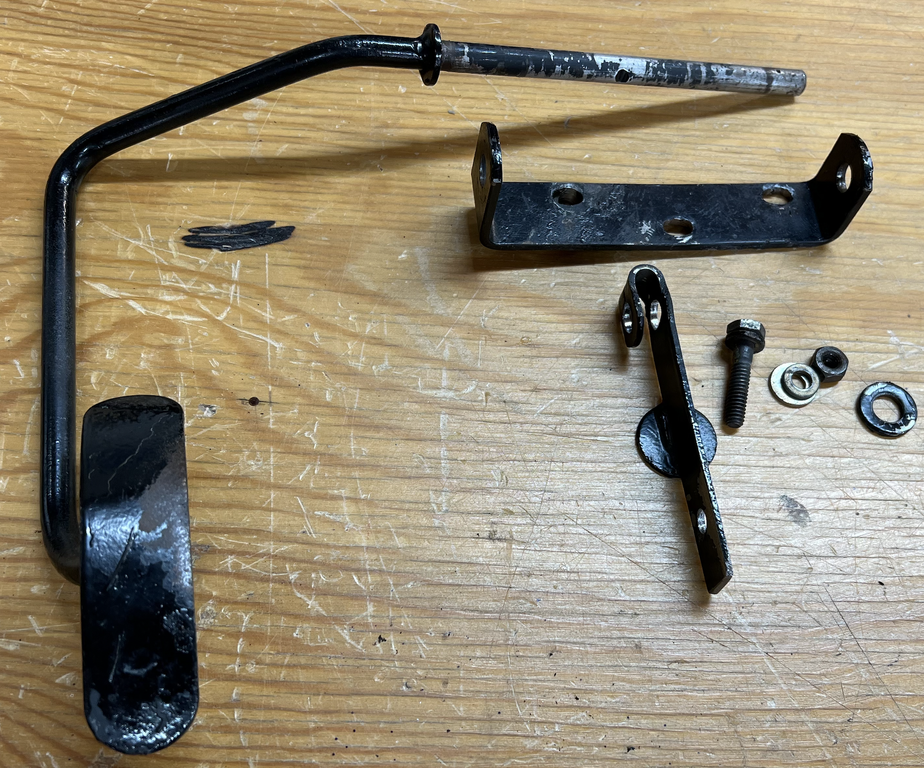

The various pieces:

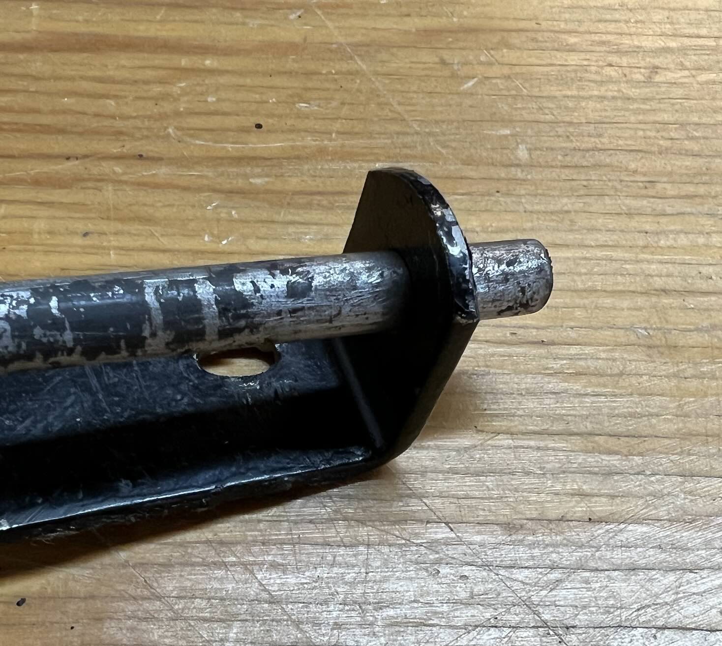

The shaft rotates in the hole; metal on metal:

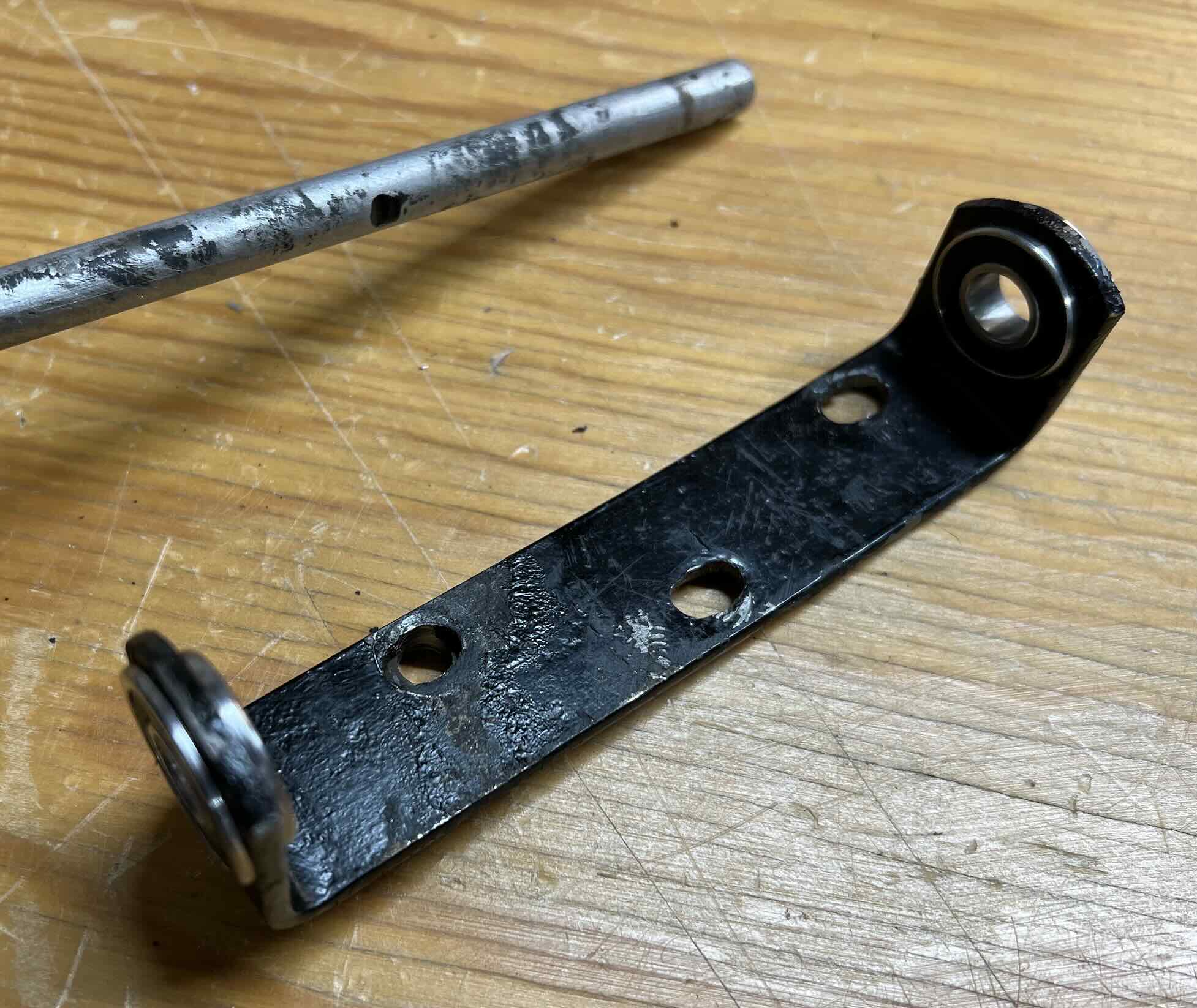

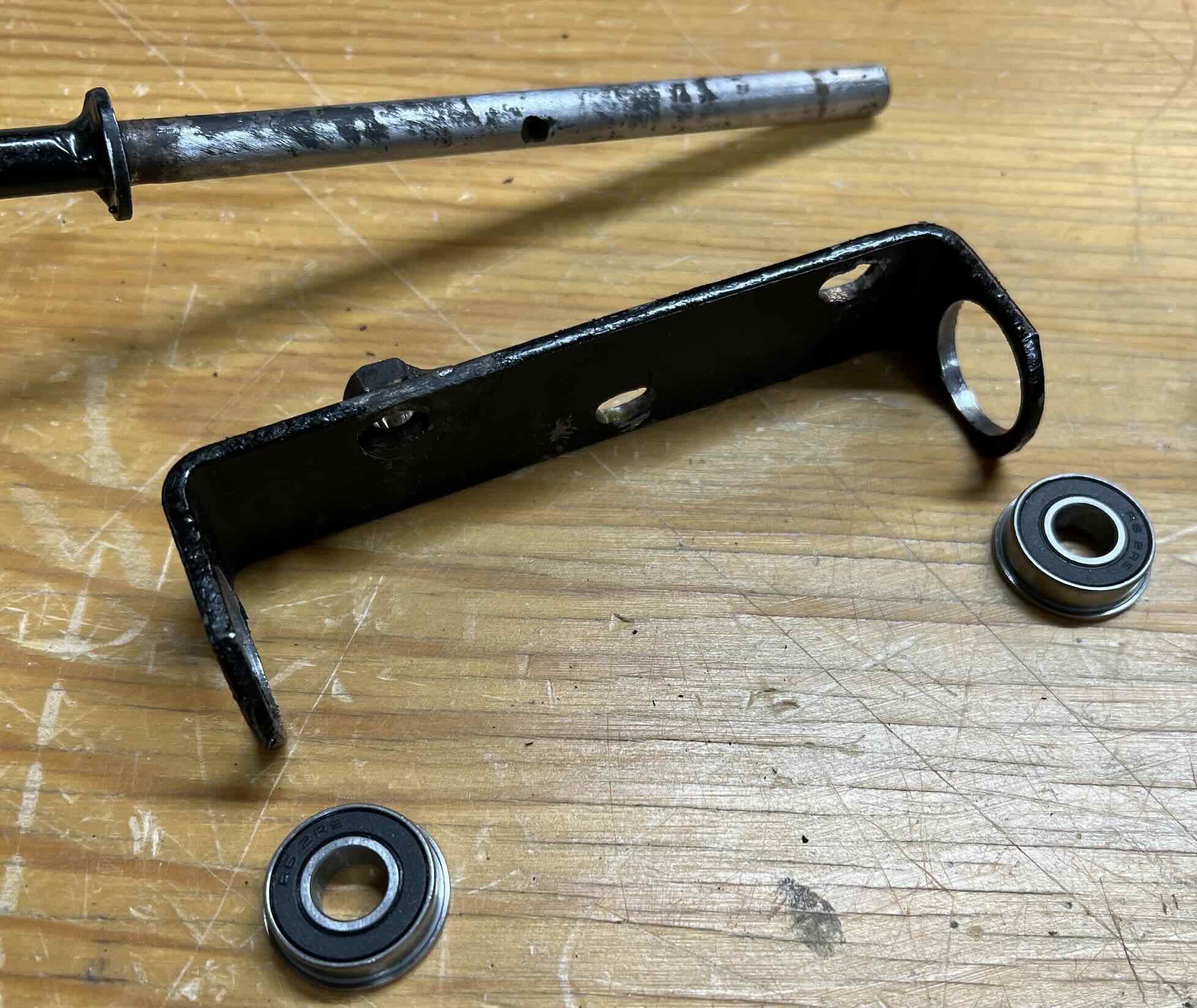

I bored the holes to take a flanged bearing with an OD of 7/8". The ID is 3/8" which is the shaft size. Didn't leave a lot of material around the holes, but with the bearings installed with Loctite it would be strong enough:
Bearings installed:

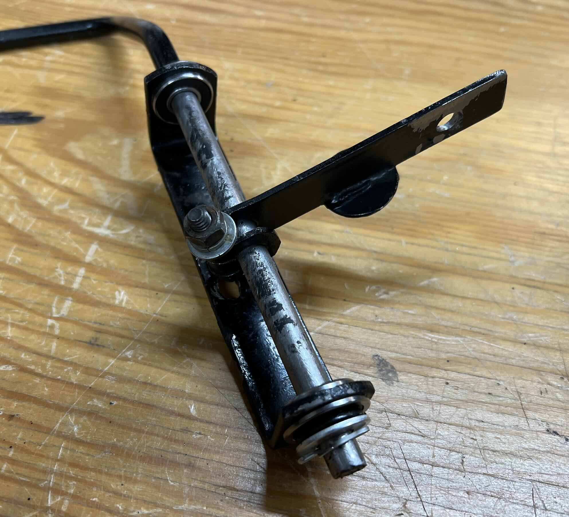

Reassembled and perfectly smooth rotating action with no play:
