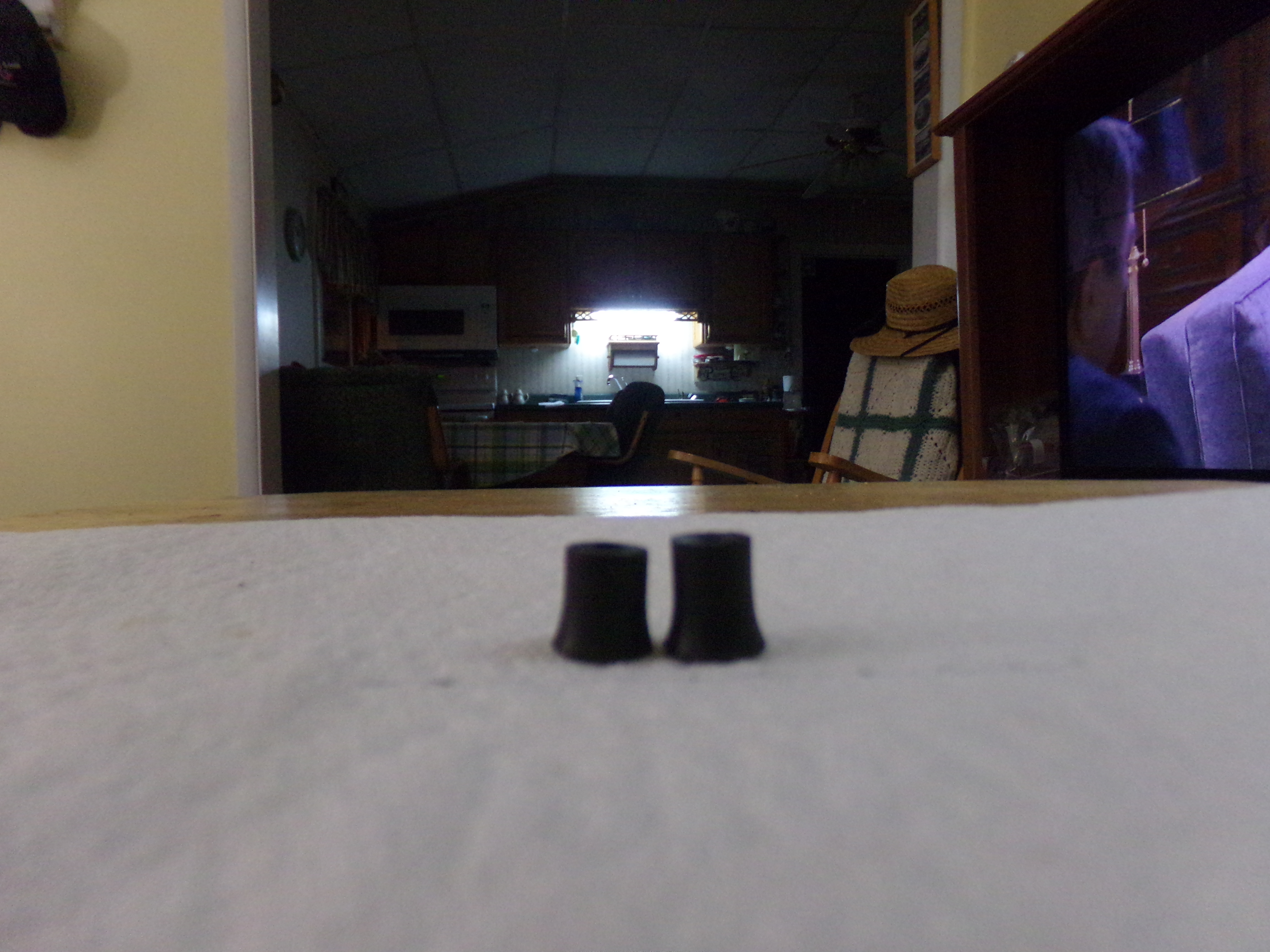

You'll find that some of the reproduction mirror buffers are not the same length as originals. I have several used originals as well as the reproductions that show the difference so with the slight difference in the glass thickness and add on the shorter reproduction buffer length there is a small gap. I used one of my hole punches the size of the buffer base and cut a piece out of a rubber mouse pad and super glued it to the buffer. It's impossible to see in this photo but it sets tight to the windshield and there is no vibration of the mirror.

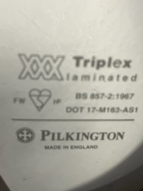

I thought I'd go out and check my MK1a ... Rick's buffer fits nice and tight. My windshield says 'Pilkington' and was sourced by my local glass shop about 8 years ago . I helped them install it and was relieved that the frame was rust free !
The bad news was that I had ordered a VB one on sale a couple years before that and had the glass shop store it. I went back there when it was time to install and they pulled it out of that nice foam filled box and it had a crack coming up from the bottom that wasn't on it when I took it there !!! They did some 'fancy footwork' and my old windshield developed an instant crack:rolleyes: ( only had wiper scratches before that ) and that turned it into an 'insurance' job which cost me the deductable and they would only order from the insurance company's 'preferred' vendor and the Pilkington one showed up

There have been different length mirror buffers over the years. The longer one is SS #IP63 bought 05/95. The other was bought In 2013 when we restored the green car. I write a date on labels of all parts I buy for my stock so I know which part is the oldest if I have multiple pieces.
