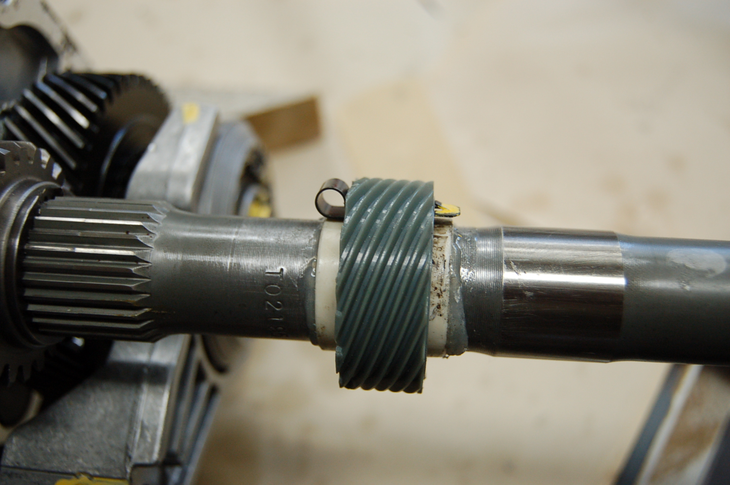

I've done 2 of T5 z-spec/AMC tailhousing setups ... I needed to make a custom shim for tail bushing as the AMC is too loose on the yoke. pretty straightforward after solving the speedo issue which I had help from a guy at PATC . The shim was a piece of thinwall PVC 1" pipe that was just the right size. epoxied on and the clip has a long enough tang to go into the hole in the shaft that I drilled with great difficulty, lol
The speedo housing for the 904 is 'clockable' so that helped in getting the gears to mesh properly. I couldn't get the correct gear ratio for the stock speedo so had to buy a gear reducer box
