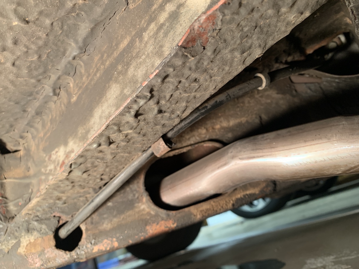

Would anyone have information regarding the routing of the speedometer cable, in particular from the transmission cable attachment to leading under the shifter rod lobes, my second gear and third gear seems to be hitting the cable sometimes causing the transmission not to shift into gear as well as wearing on the cable itself. My first post would be grateful for any response.

Welcome to the site! I stuck my iPhone up under mine to try to get a shot. Not sure what that ring is on the cable, something I need to take a closer look at.

Thanks Ken f, your pic tells me a lot, nice to have this kind of resource at hand.

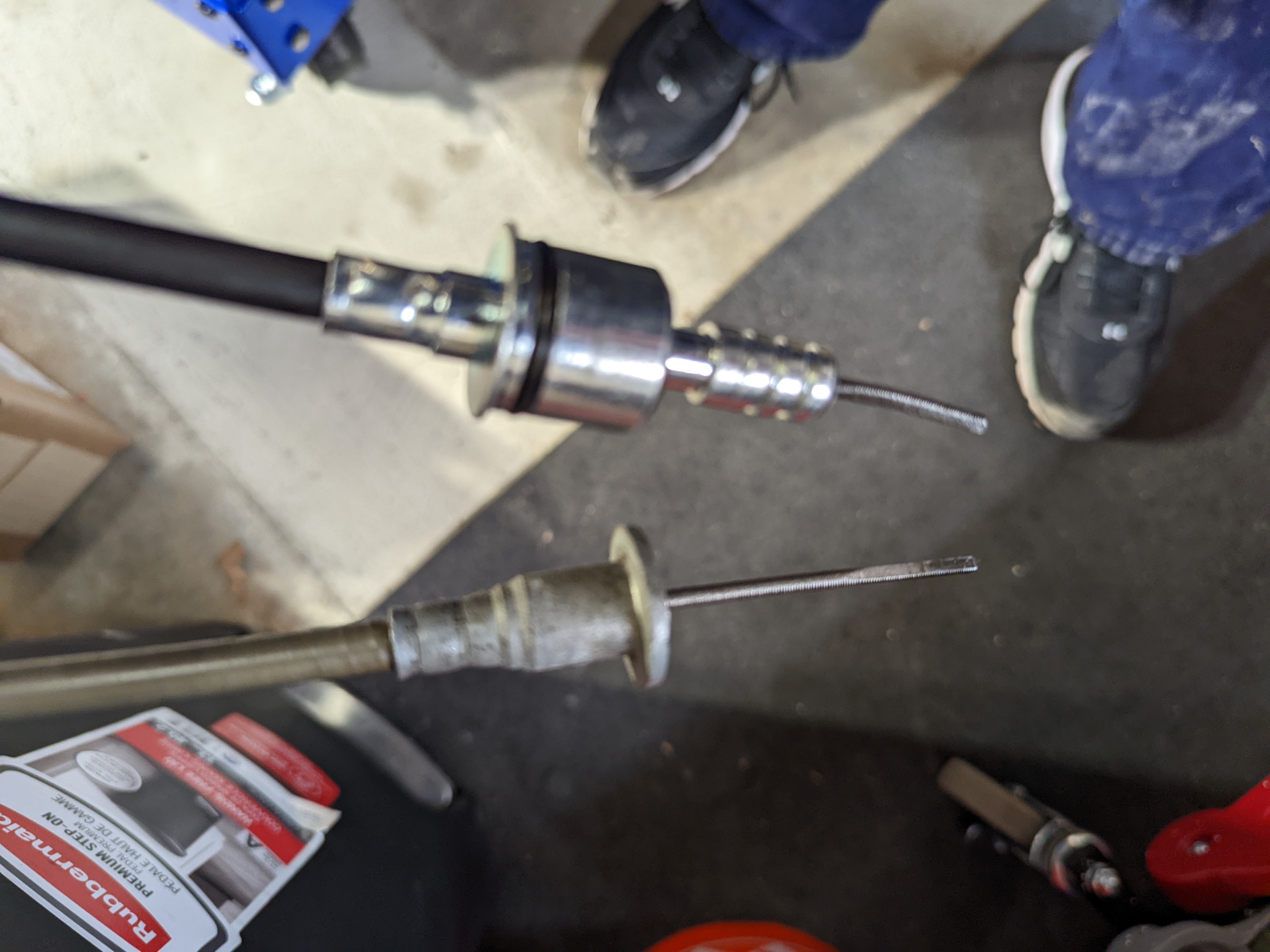

Is anyone familiar with this type of cable. As you can see it is missing the end with the gear attachment. They are brand new, marked as “Tiger speedometer cable” has the hold down on the trans end of the cable but no gear.

View attachment 13317Is anyone familiar with this type of cable. As you can see it is missing the end with the gear attachment. They are brand new, marked as “Tiger speedometer cable” has the hold down on the trans end of the cable but no gear.
YUP, once upon a time there was this end piece that held the driven gear w/clip. The cable is correct if you have the other part. The later cables are one piece ends all inclusive with an "O" ring seal.

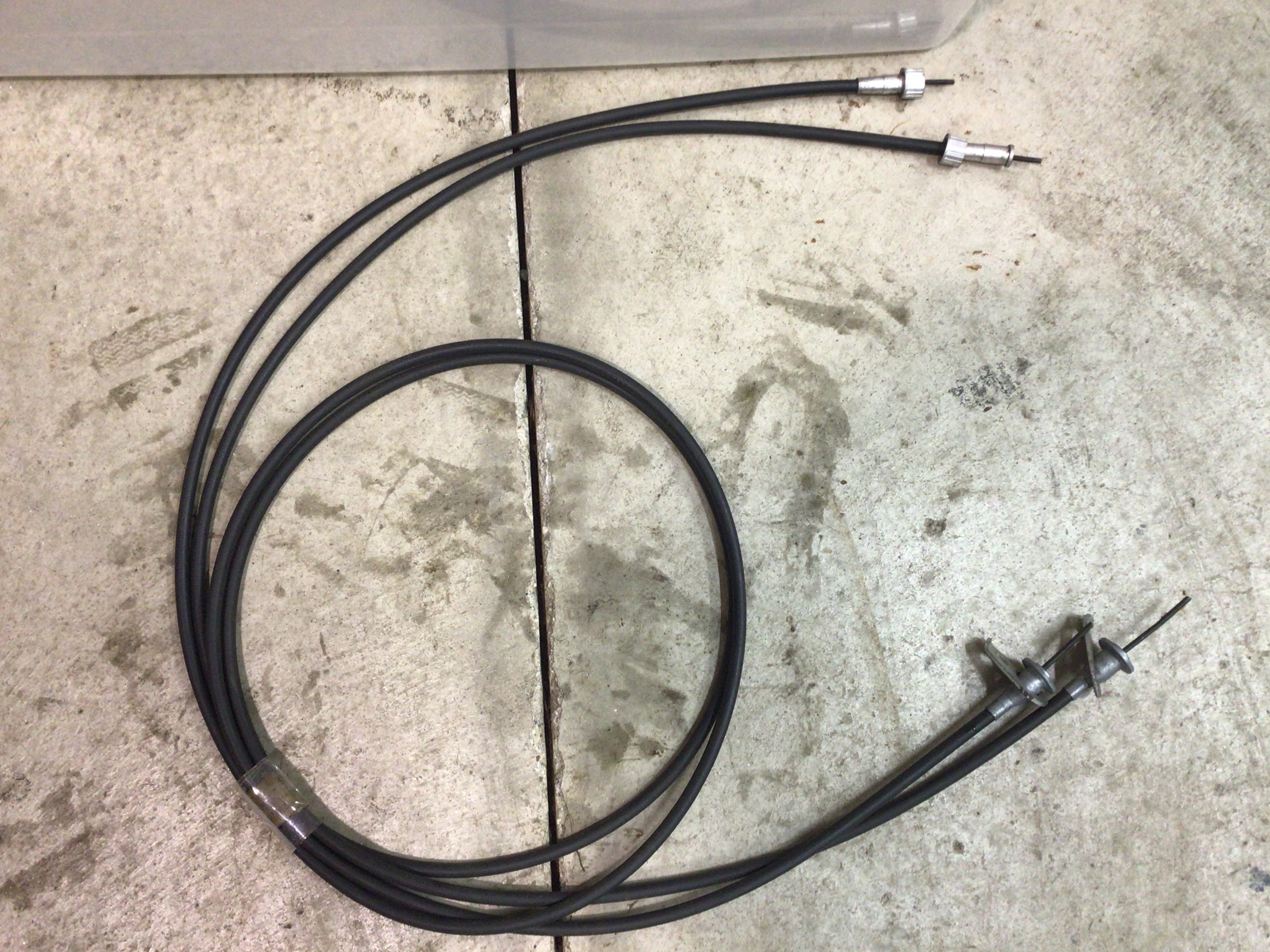

Mystery solved, turns out it fits a MK2. Joe Ciapetti showed me one that was on his MK2 that matched. Checked mine and found the same head in the trans. However cable is 90” compared to the stock 76”. With 107K on the old cable and some breaks decided to change it out. No more fluctuation even up to 100mph (on the lift)

I believe I still have the other. Routed it along the steering column and made a more gradual bend. Since I couldn’t find a replacement this one worked. Came from Bill Jennings estate sale in Mn have no idea where he might have got it from Was tagged as Mk2.
As stated “However cable is 90” compared to the stock 76”.
