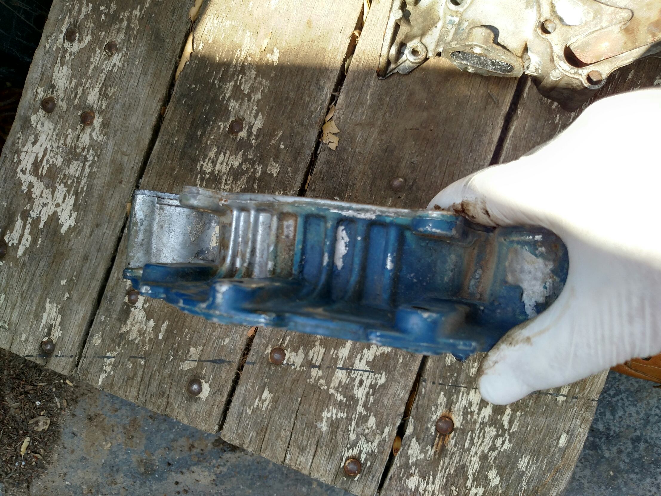

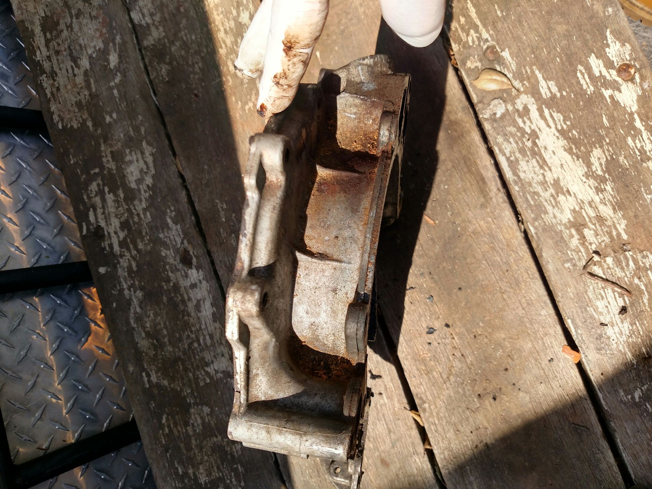

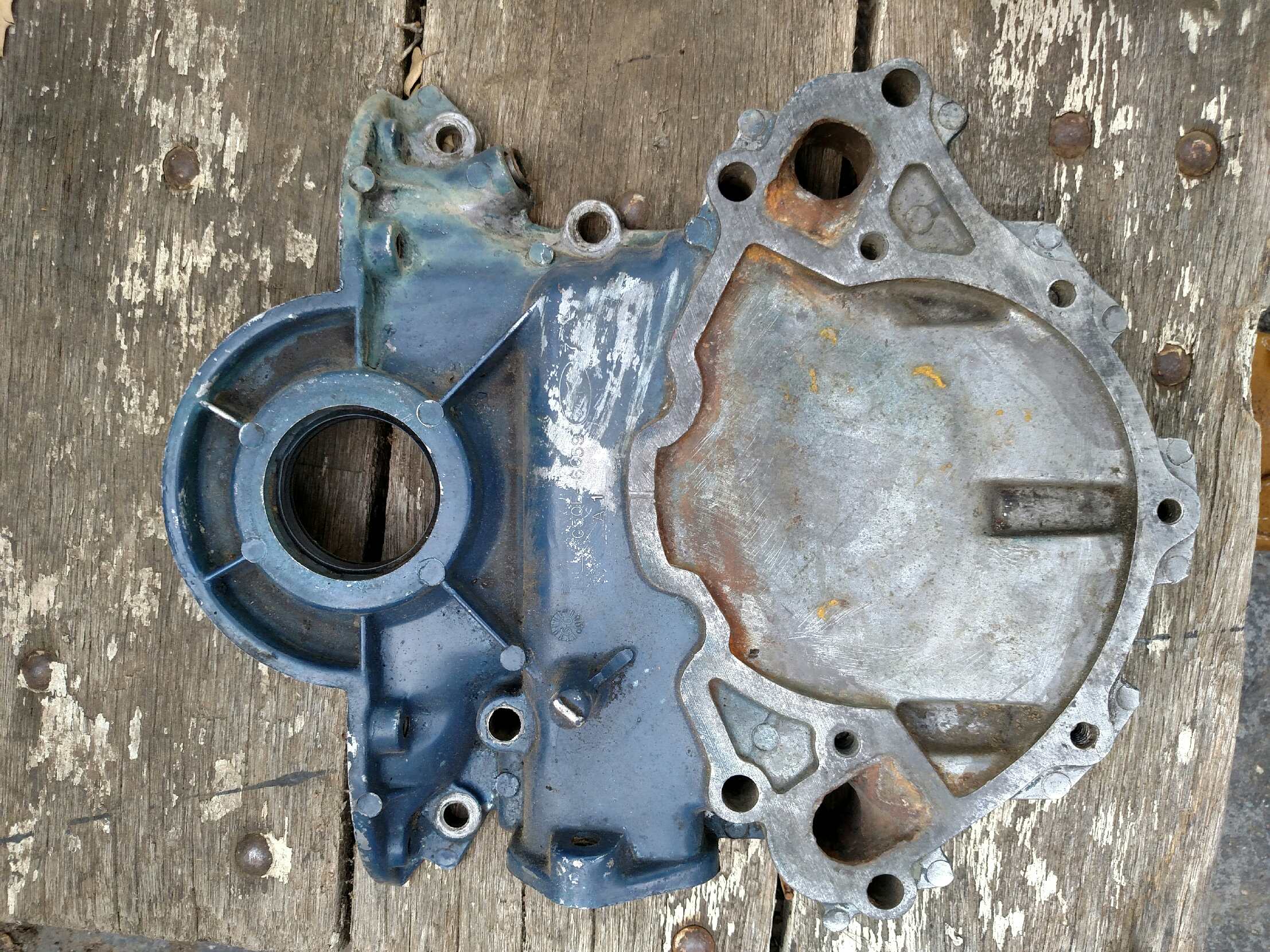

One is ribbed or not ribbed for a 260 in stock class. I have one that's a C4_____

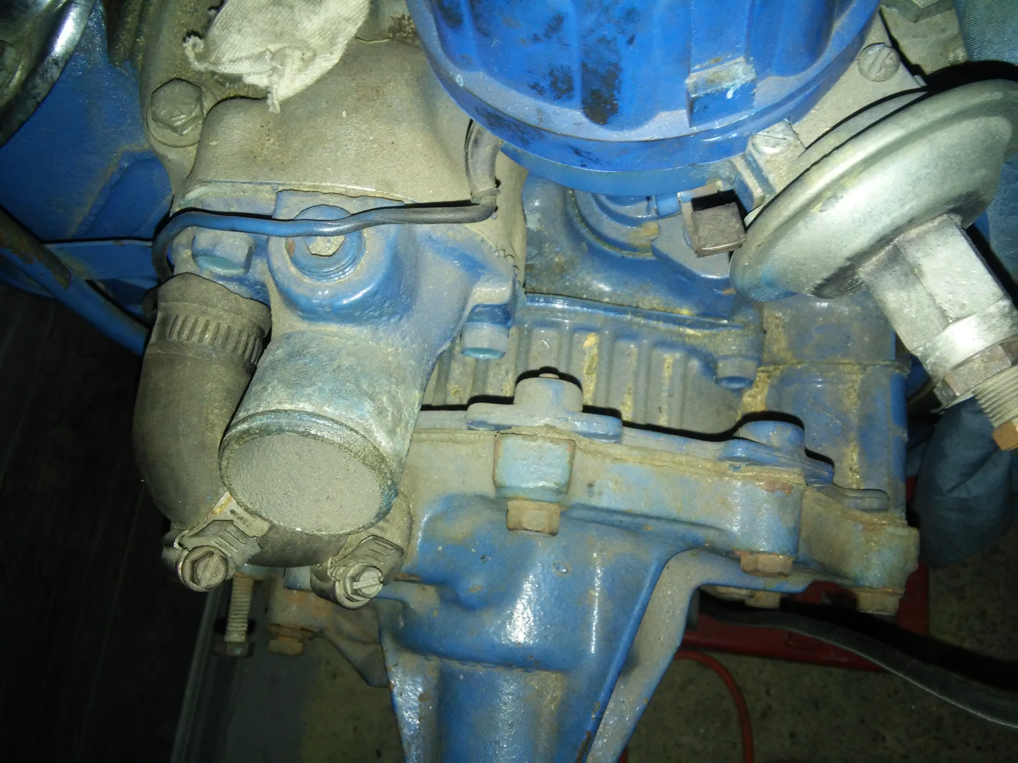

A C5______ and one I can't see the P/N on as it is still installed on an 289 5 bolt.
It's one of those I have just been asked to sell one and I realized I sold one but not sure how many ribs that one had. I guess it's the idea of dressing a 289 5 bolt as a stock 260, not that I'd ever do such a thing:rolleyes:
The blue one is the C5 other C4.

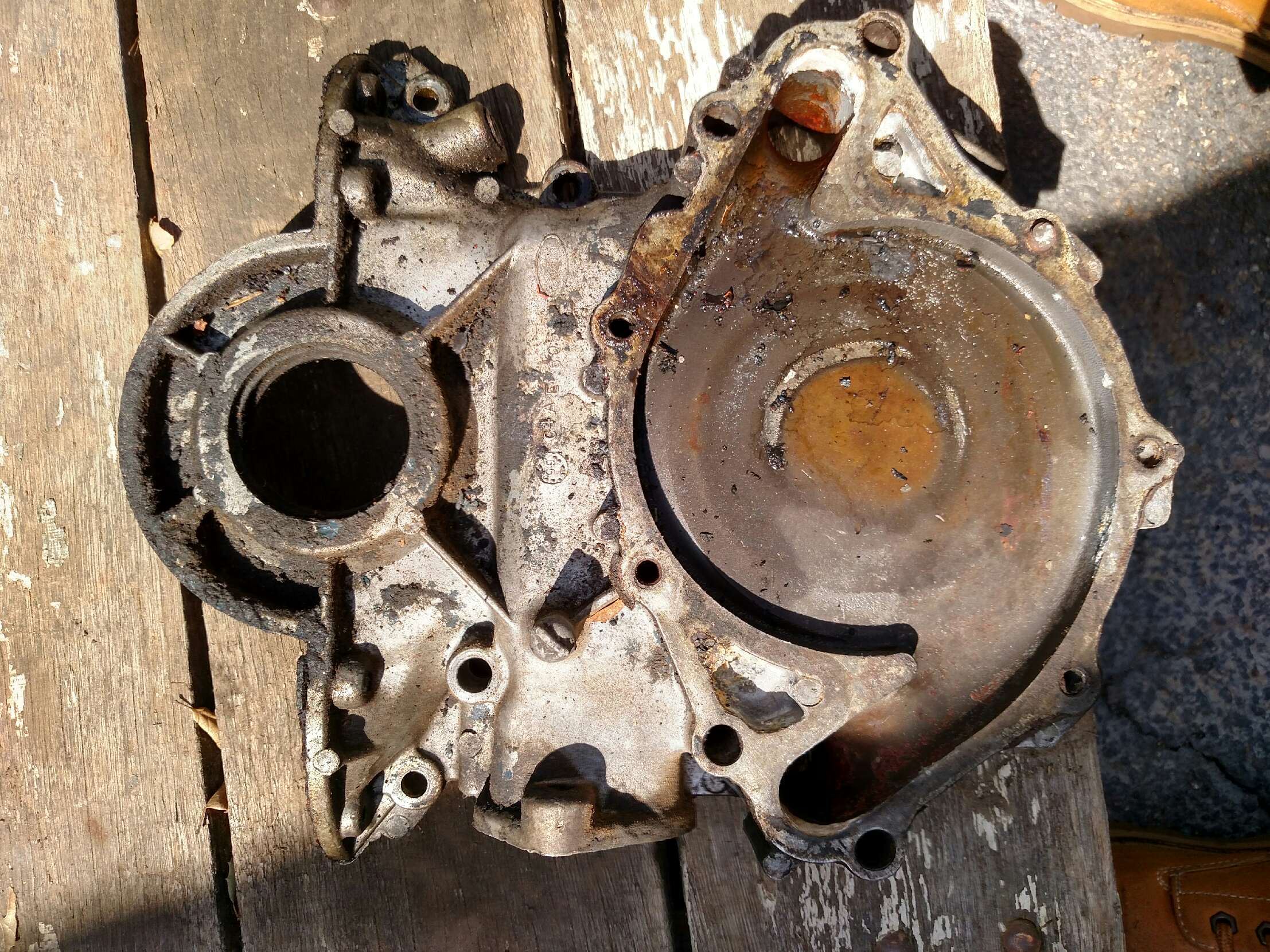

Here what I Have in my cave
First picture No Ribs , Aluminium water pump ( 260) Water pump no back plate deep Timing cover . for the Impellers of the water pump
Picture 2 Ribs , stock 289 ( MKII) steel water pump back plate on the water pump .
Hope this help !!!!
