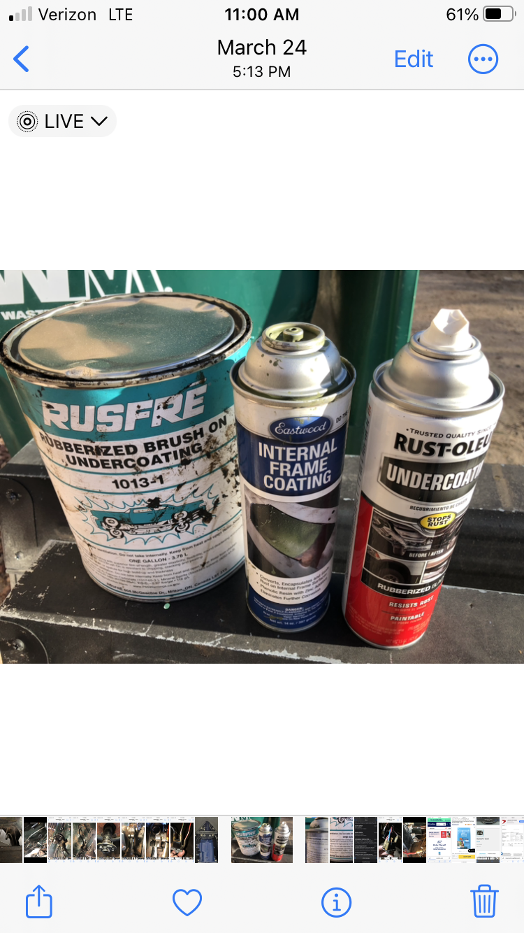

these are the 3 products I used The Rusfre Is a great barrier and sound proofer The other two are really just cosmetic but gives a smooth finish. Mine was also very rust free with the original red primer and factory under shield which was standard. I did use a propane torch and scrapers to remove the old stuff. I used the Rusfre in the wheel arches and other areas that get a lot of road debris thrown at it It does not look as pretty as the painted bodywork but is weatherproofed and gives sound deadening benefits and was originally coated. I did use Delhi seam sealer in some of the areas where the rails met the floor panels. But the Rusfre can also be put on thickly to fill voids , brush on or use a putty knife and put out in the sun to make it more runny before applying. I like the results and the even black look.

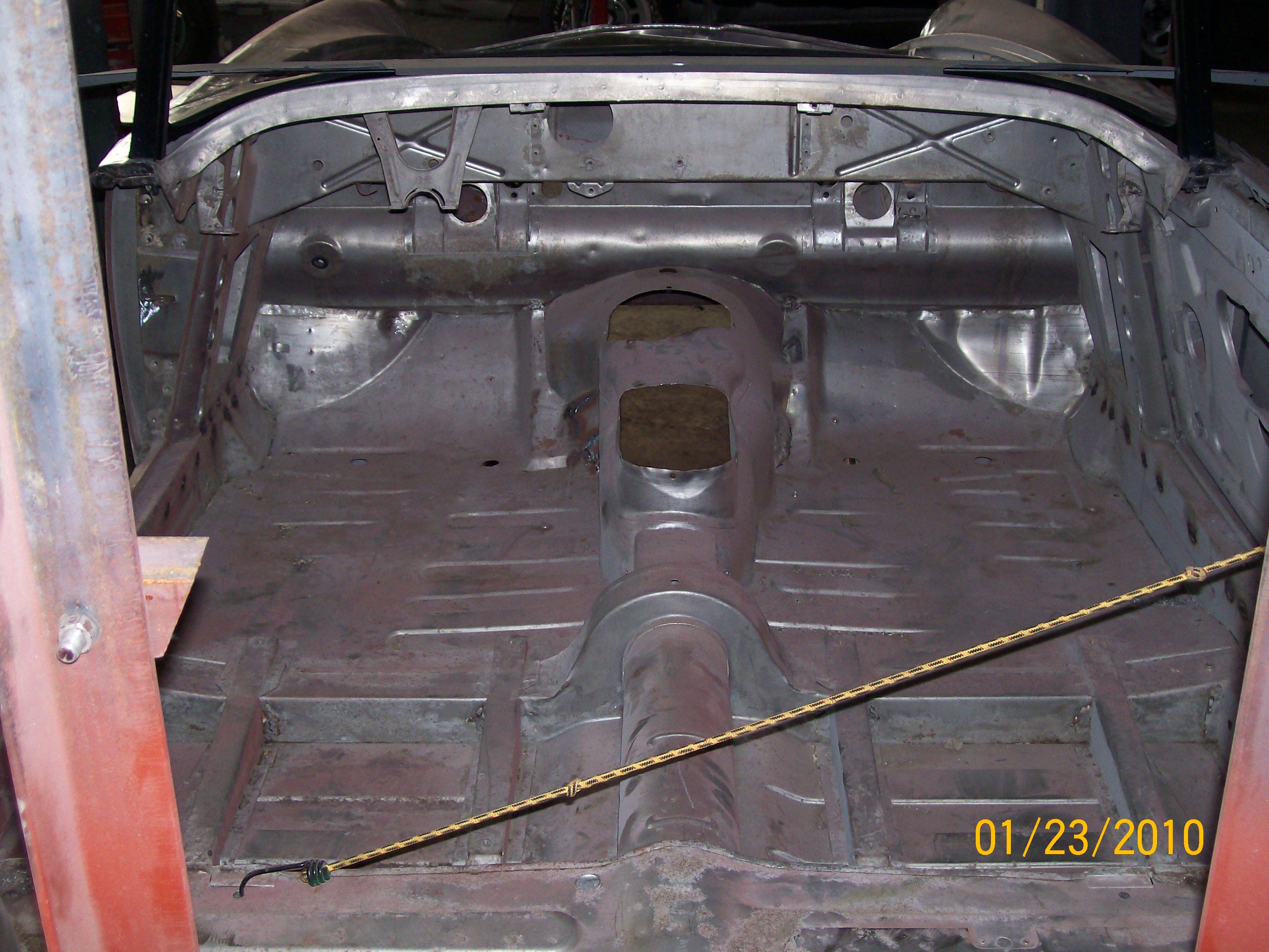

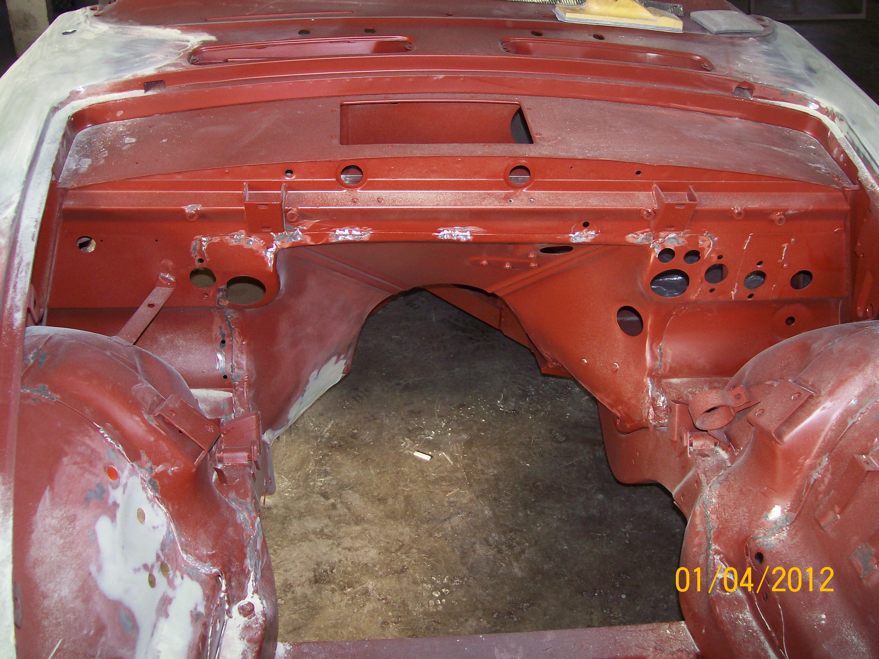

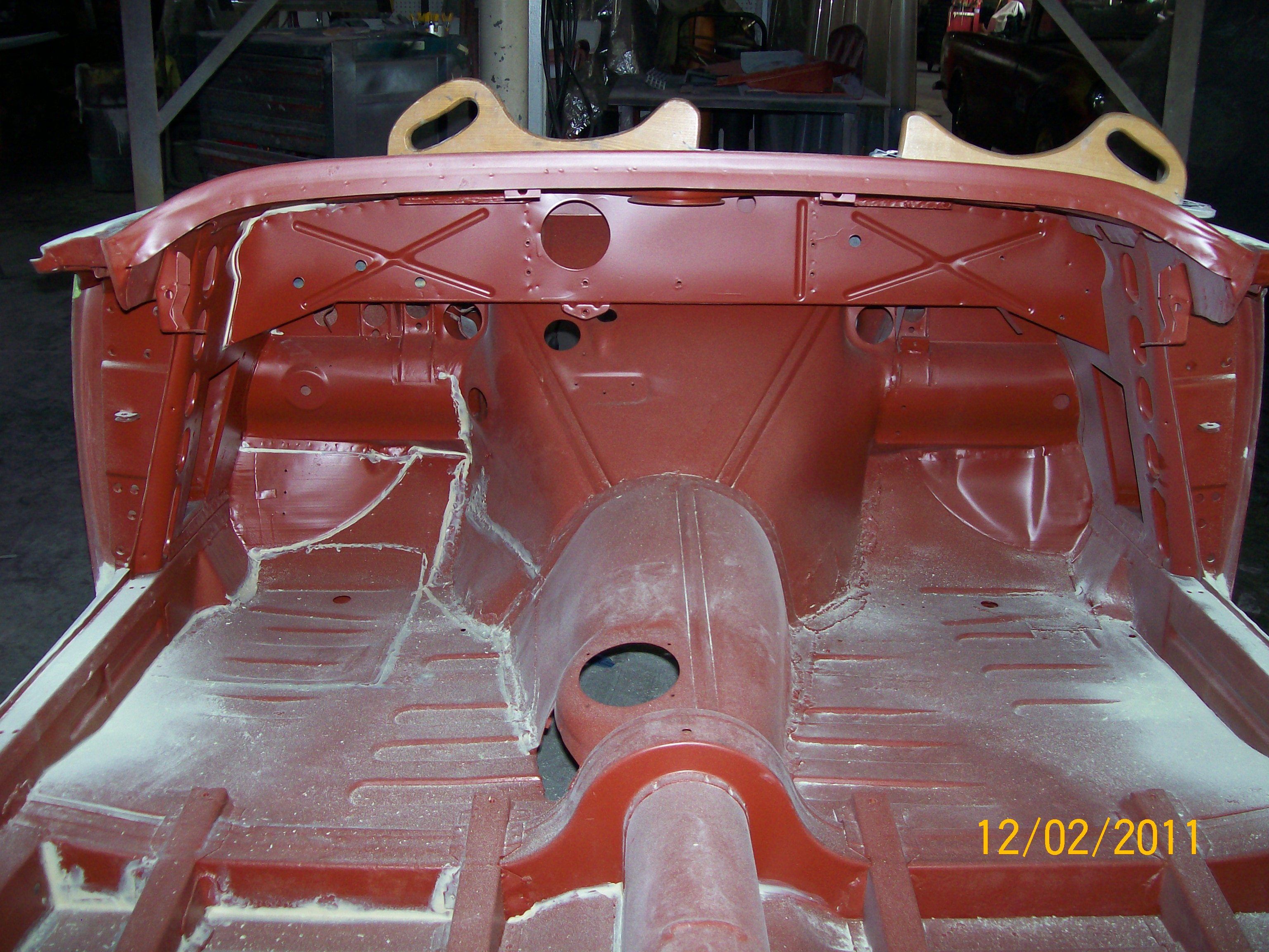

Yep, I'm aware of that including things like triangle brackets and maybe a tab. These photos show a good comparison of the bulkhead area of an Alpine versus a Tiger. Both of these cars are now Forest Green.
