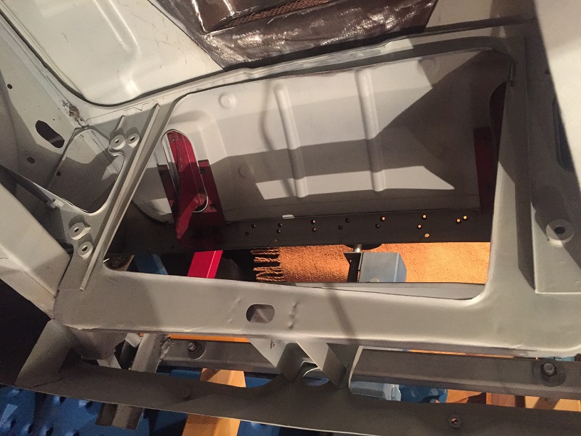

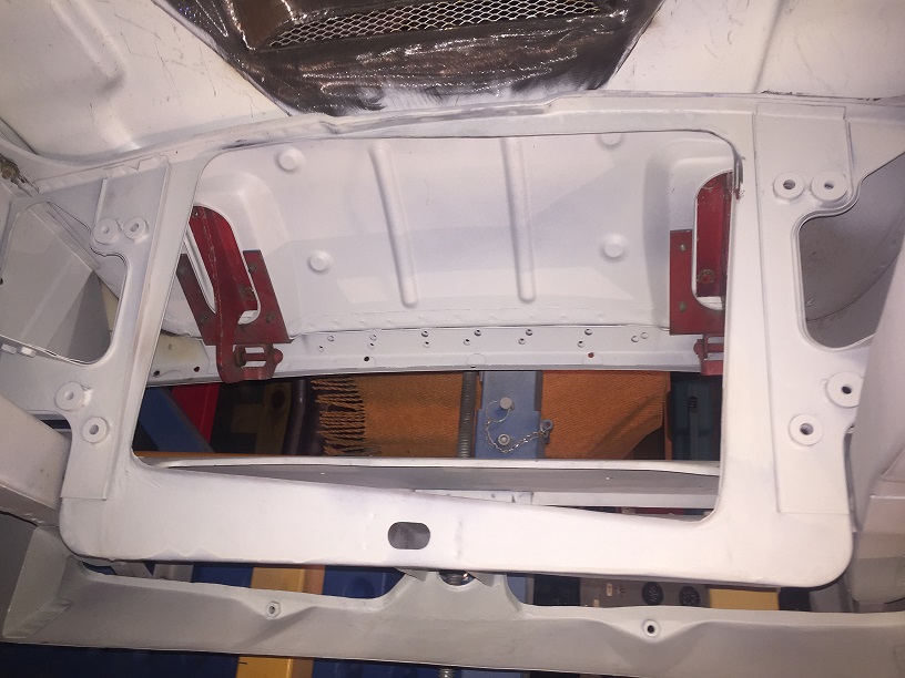

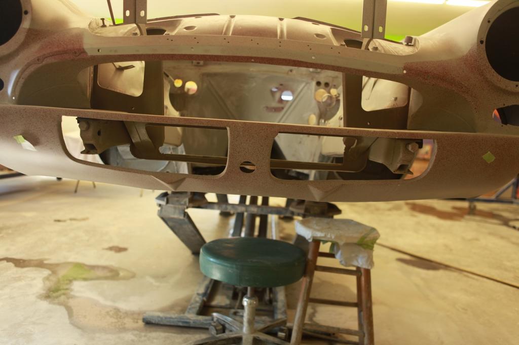

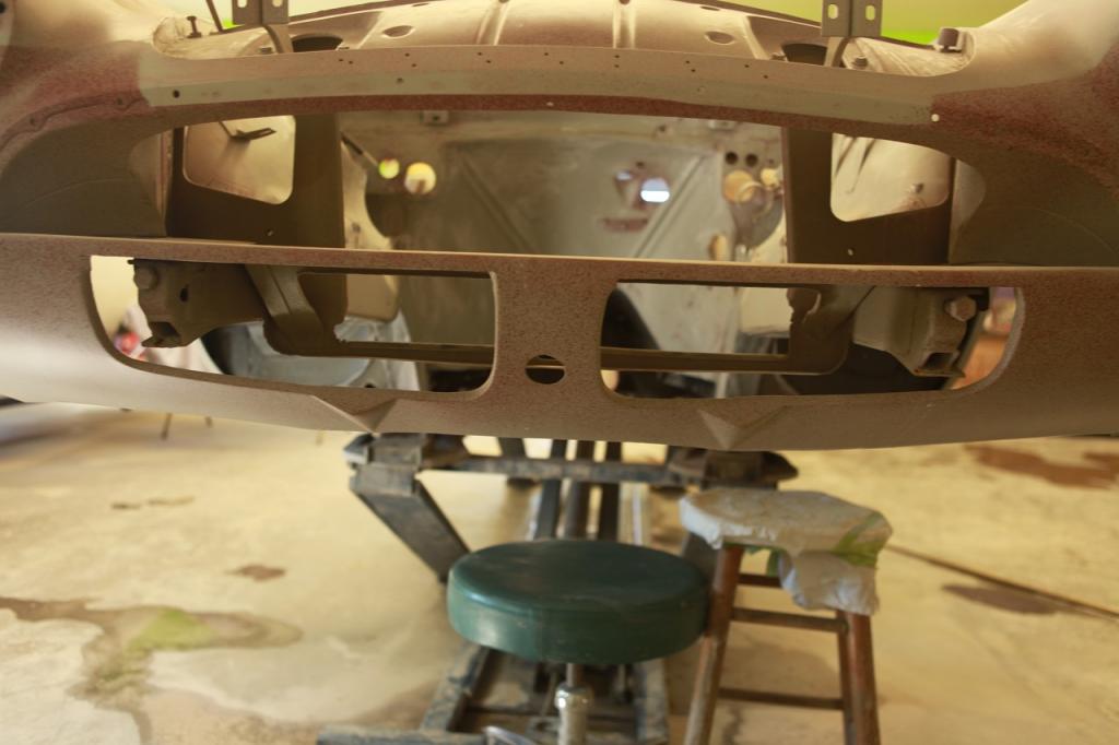

Hello all,
I am to the task of detailing the engine compartment and repairing the mangled lower valance panel. Included below are some pictures of the radiator support panel and what’s left of the lower valance panels. My plan is to try to straighten and restore the valance panels, but I’m not exactly sure what parts are missing where the upper part of the valance panel connects to the radiator bulkhead or whatever it’s called. I know that on the alpine there is an oil cooler mount in this area, but what did the Tiger look like? Does anybody have a Tiger that has the front still disassembled that can show me some pictures of what is should look like? Please let me know!
Thanks! - Kevin

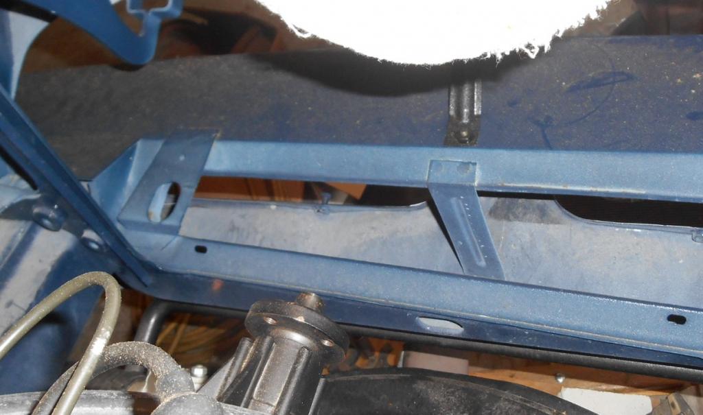

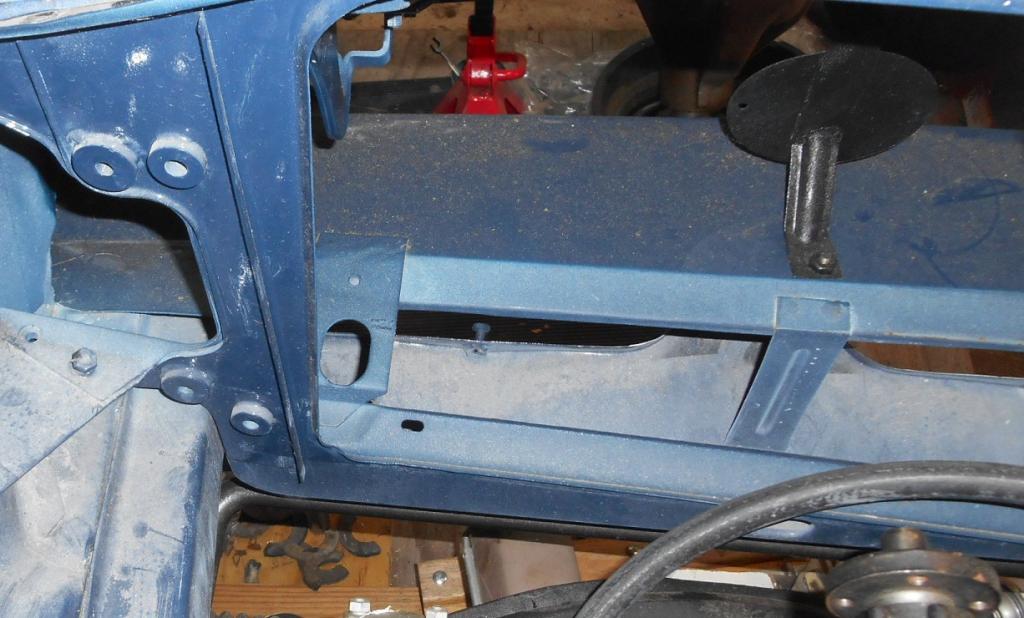

Maybe these will help. Cliff

I guess I should have mentioned that this is for 9471488. december 1964 production date.

I took another look at the rad support to see what Randy was saying about cut and fold. After looking at the pictures that Brian sent me, it was very clear.
I'm very curious what is missing at the corners at the upper valance. I'll add another picture below.
Cheers! -Kevin

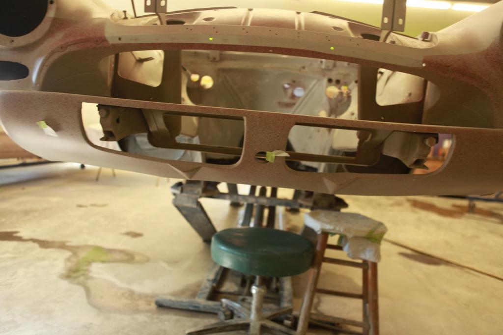

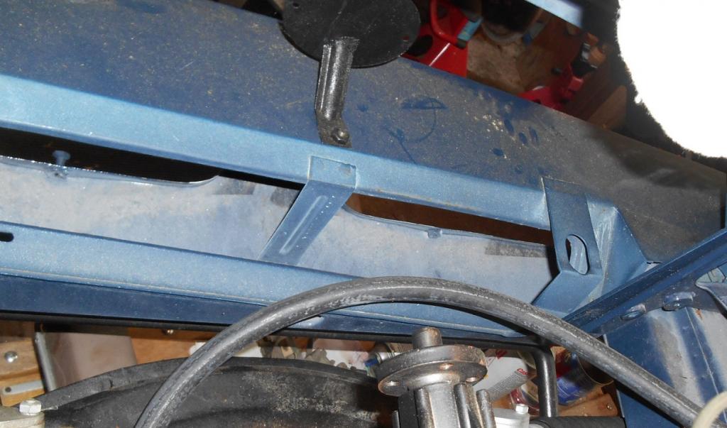

Kevin - these might offer some pointers. Excuse the small support brackets - they are a personal addon to provide some rigidity to stone tray
Rgds, Tom

Thank you Tom. I think those brackets are an excellent choice!
-Kevin

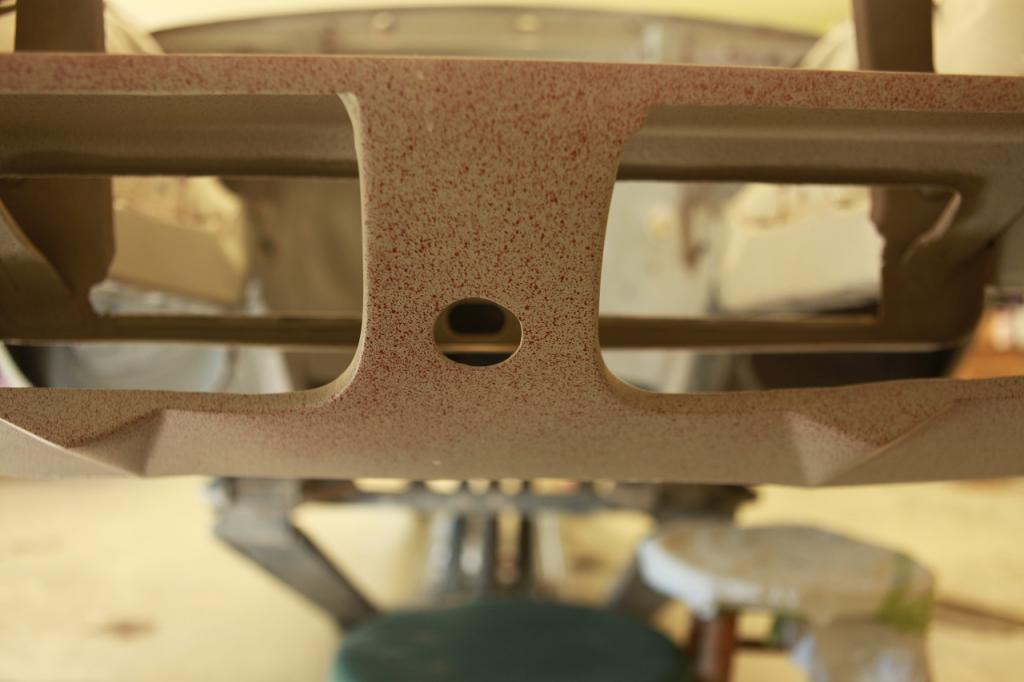

Here's a few from one in the shoppe . . . .

Looking at all of the images that have been posted, it seems that there are two possibilities for the radiator support. I am looking for what the cut and fold variation looks like. I like how Tom’s car looks and it would be very practical to make mine look that way, but I want to make sure that it still fits in with the correct look for my cars vintage.
Thanks again for all of the uploaded images!

Another angle
Hi Kevin
Inserted myself into engine bay for a couple of other shots. The lower section of the rad support was hacked away when car acquired, so this is an approximation of what we believe to be "close". Not much to work with as far as reference material was concerned I'm afraid. HTH.
Rgds, Tom

One of the things we often do is to replace the lower cross support you've shown with a 1/2" pipe to promote better airflow without back-draft effect. The welded ends of the pipe need to be flattened flush with a straight line so that the pipe can sit forward and not obstruct radiator installation. It works fine.
