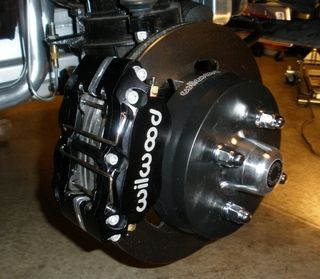

A question for anyone running the 11.75" Wilwood brakes up front... is the hub to hub distance the same with the Wilwood installation as the stock set-up? Just wondering if the front end tracking changes at all. Thanks a bunch.

Same
IIRC you will be using the stock spindles and wheel bearings. I have not upgraded from stock brakes.

The forged aluminum hubs that are included in the Wilwood kit do not change the track. If you are interested in a kit give me a call, as I'm a Wilwood dealer. I sell the brake kits for $1150.00 including the brake hoses.

Thanks a bunch Rick and Dale. Exactly what I needed to know. And thanks for advising price and availability Dale. All indications are that it is a great upgrade.
