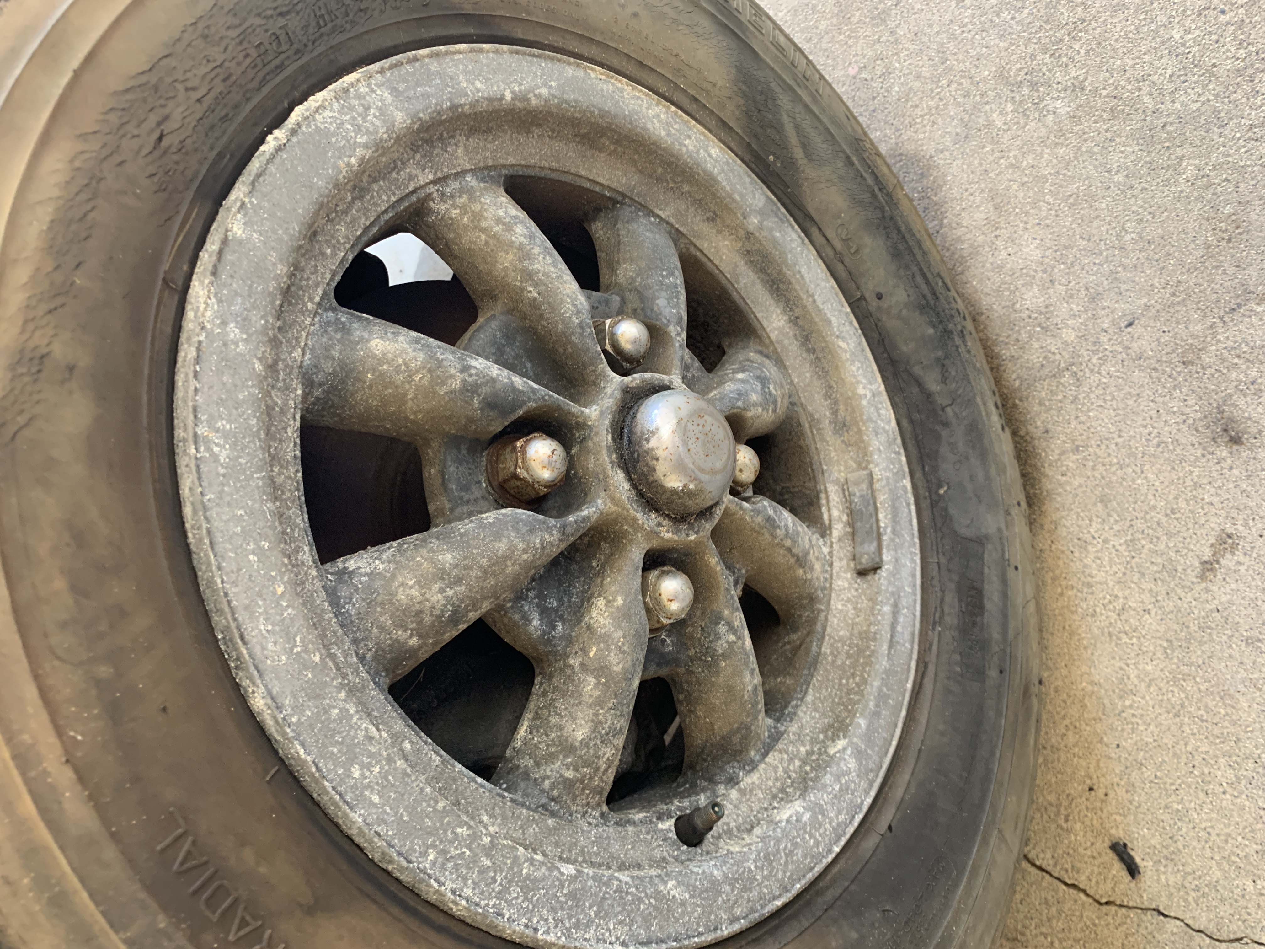

The american racing mags look like the top shelf magnesium ones given the reactions and markings on them...great wheels but warn him to be very careful... Its likely the magnesium has degraded and could crack a rim

He's got the set of unmounted steel wheels, but I didn't see any hubcaps. The spare has an old 1" whitewall mounted, maybe one of the originals. Someone has told him the wheels alone are worth 3K. They do look pretty crusty, but maybe crack free. Car has 86K miles and still has the generator, although it doesn't have the Ford markings, probably a rebuild.

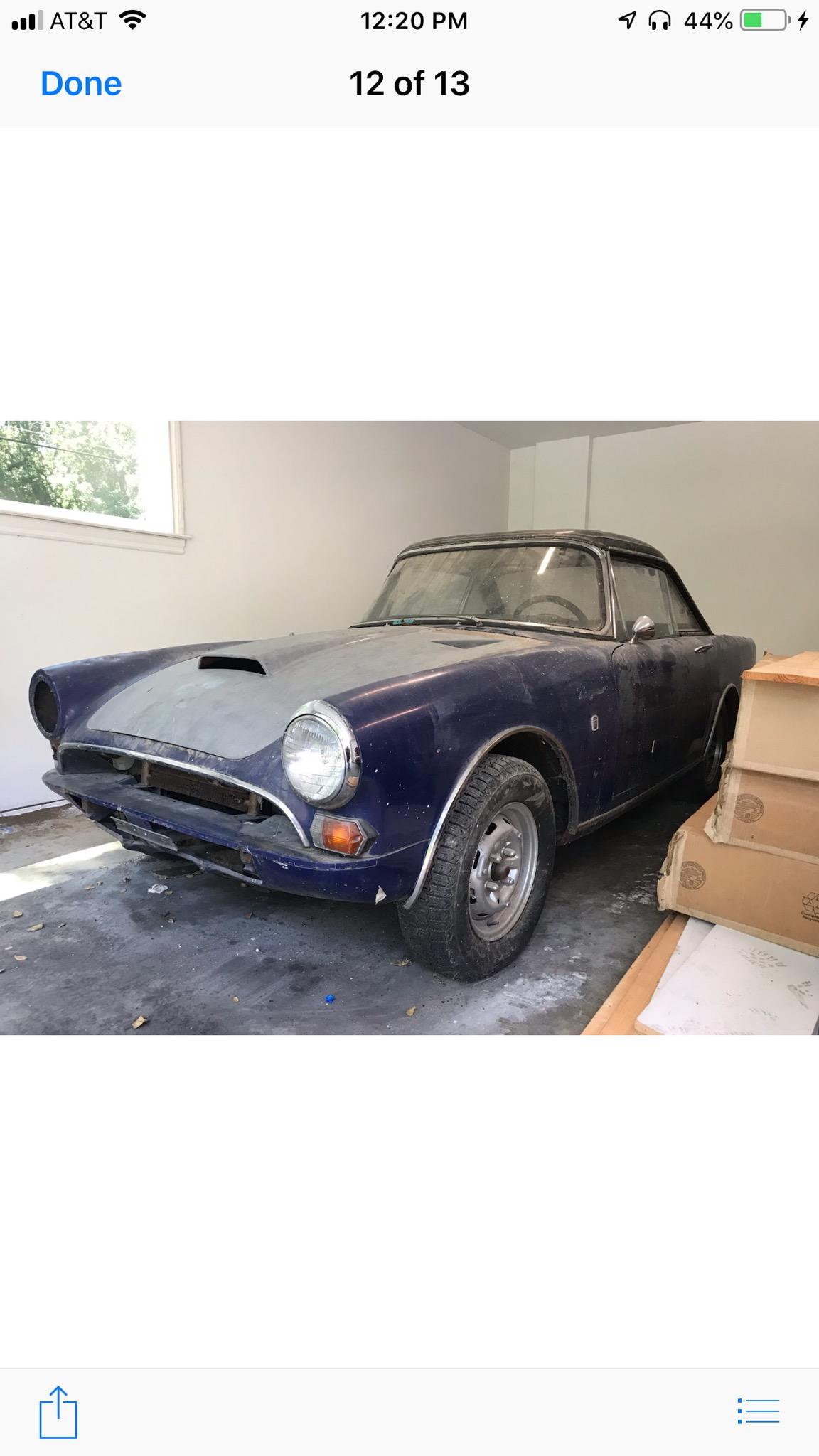

Well, my neighbor says he'll take $35K. I need to take a closer look at it today and crawl under it more. Any tips on what issues to look for?
Obviously it's not TAC'd, I'm pretty sure it's a Tiger, but I'm a novice. Any specific pictures I can post to get some feedback? Odometer shows 86K miles, maybe 1 repaint in its past. It is missing the grill bars. Spare tire could be one of the original tires. Neighbor just installed right fuel tank with new rubber, I need to check his work.
Any advice would be appreciated!

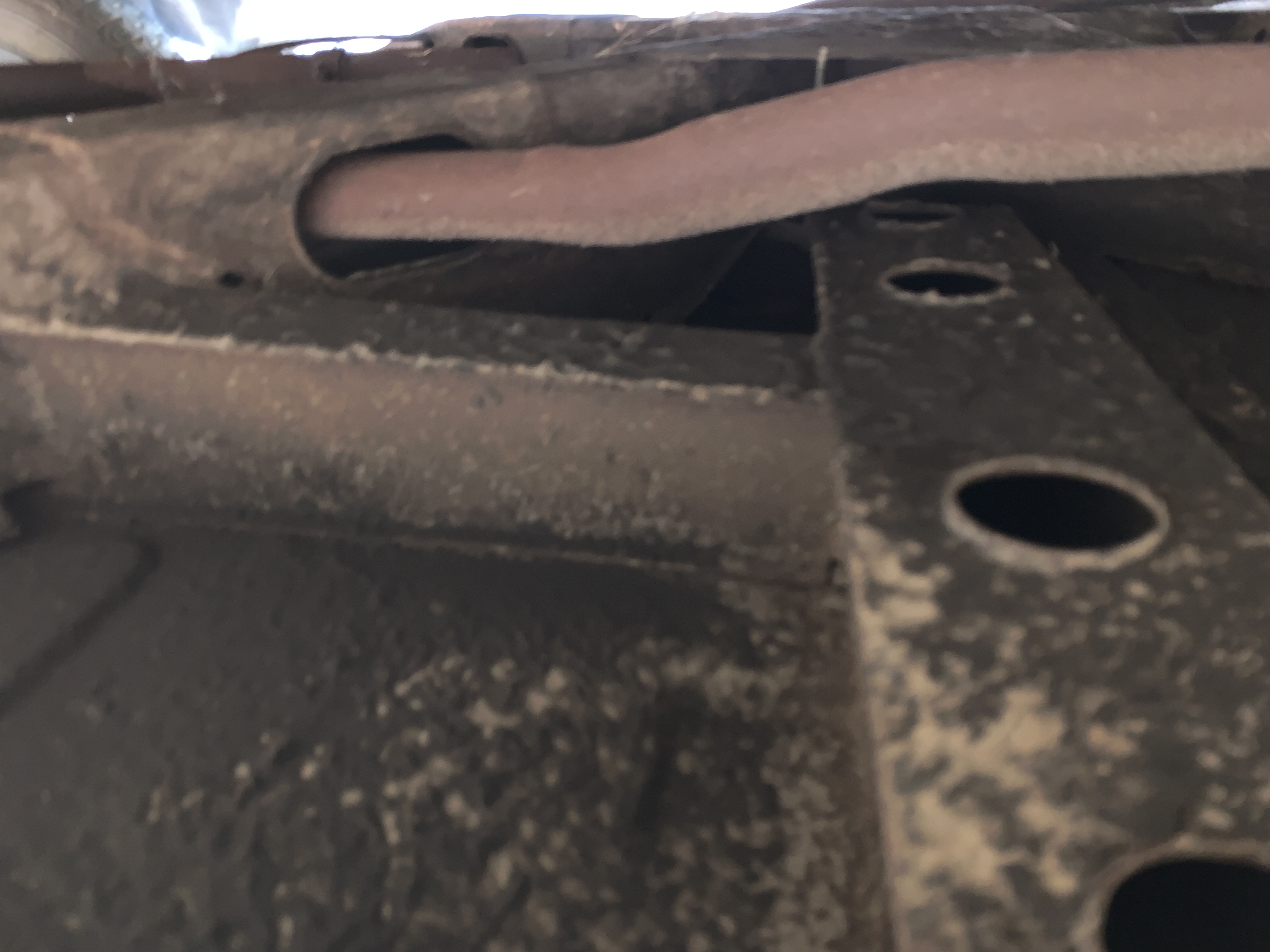

My suggestion to you would be to do a thorough inspection of the areas where Tigers are known to have issues. Here are a few areas you might want to look over:
1. The openings where the exhaust goes through the frame members. Quite often these factory holes are enlarged for larger diameter exhaust systems or to prevent the pipes from knocking against the frame (bad motor mounts). This weakens the frame members.
2. Check the front cross member for any signs of cracking, especially around the shock towers. If those wheels are real magnesium wheels, it is possible that a previous owner might have driven the car hard, either on the street or on the track.
3. If the car has or in the past had the traction bars with the mount welded to the car, check the car around those weld-on mounts. The metal quite often starts to tear in those areas.
These are just a few areas. I am sure others will chime in with other areas you might want to look at carefully. If you are worried that the car may not be a real Tiger, you might want to look into getting the car TAC inspected.

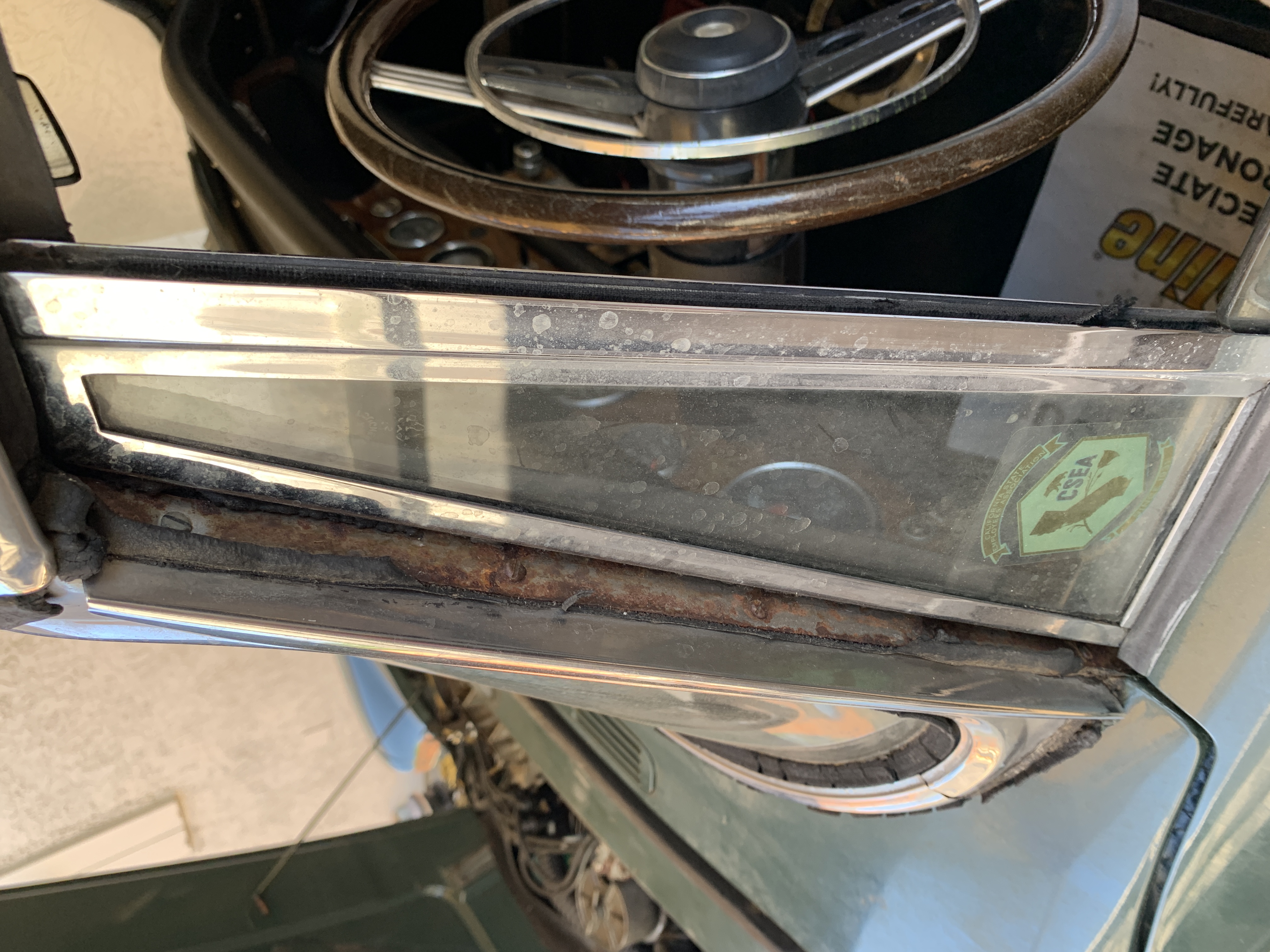

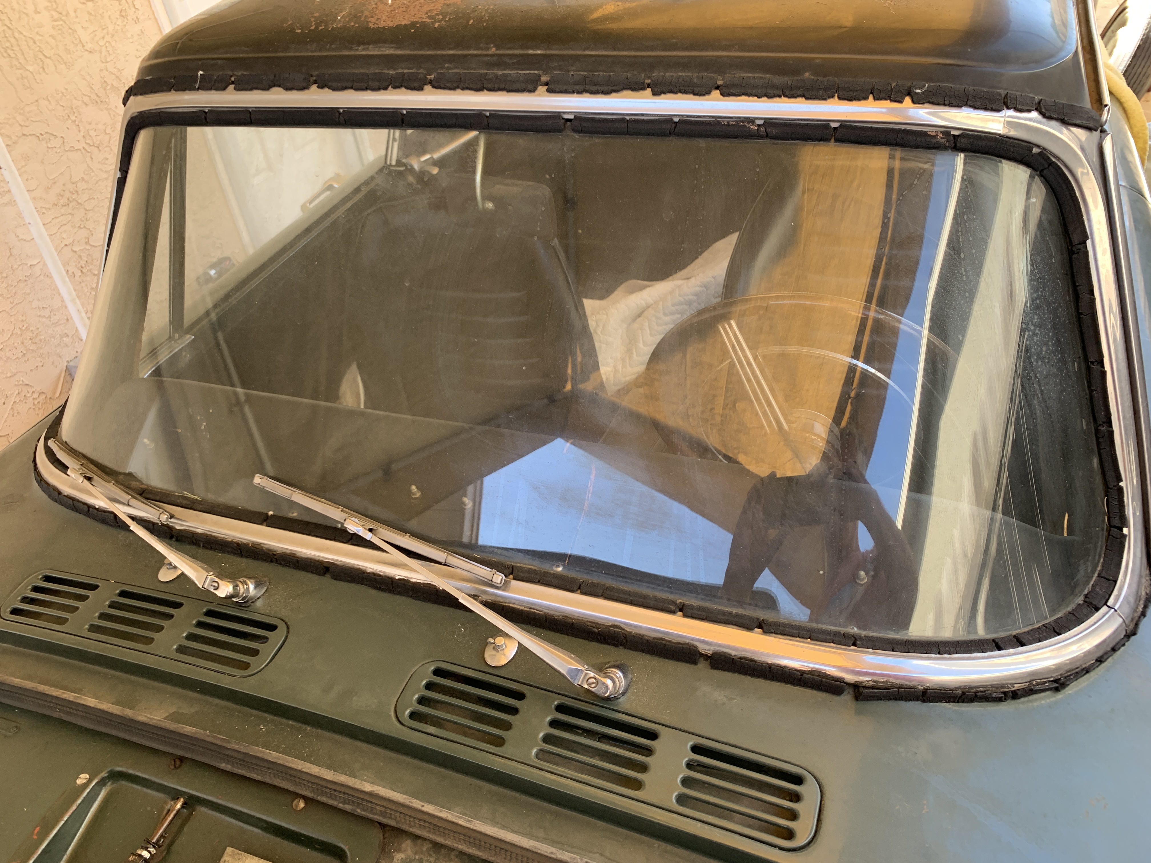

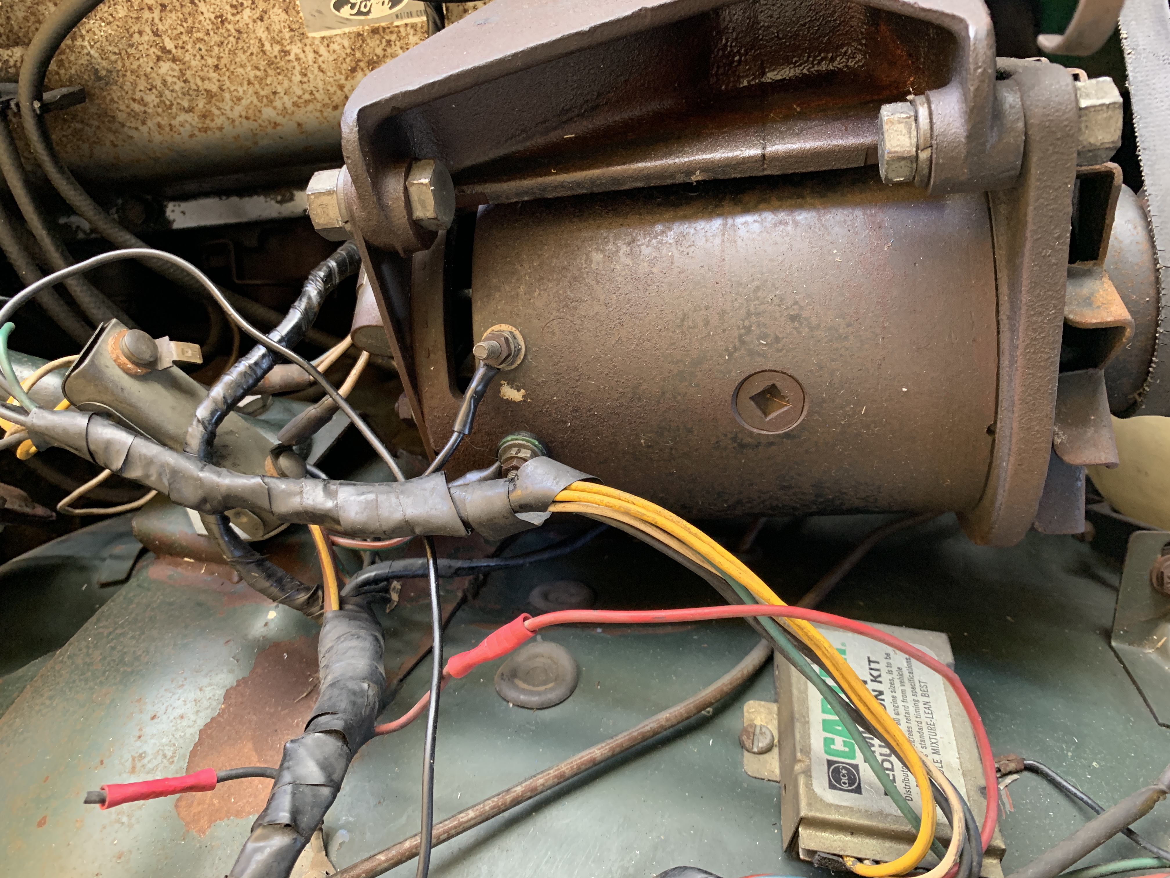

Looked a little closer at it today and took more pics. Floors look solid, the battery area is the only rust issue I can see. There is some surface rust on the lower edges of the front and rear valances.
A few questions before I pull the trigger:
- Are the rubber parts still available. Hardtop looks pretty crusty.
- Are the correct oil filter housing parts hard to find?
Thanks!

Yes, the rubber for the hardtop is mainly available. There is an issue with the rubber sitting under the outter corners - it tends to be thikcker than original. There are various vendors (including CAT Parts) that sell some or all of the various rubber pieces.
A lot of Tiger owners have changed the oil filter system to screw the oil filter directly onto the block and no longer need the original system. (You can do the same if originality is not important to you or until you find an original oil filter system.) Do a search for oil filters under Tiger Technical - Personalized/Modified. I believe Sunbeam Specialties sells reproductions of the oil filter hoses. However, I do not think they include the part that attached to the block nor the part that caps the oil filter, but I could be wrong. You could check with them.
Good luck!

I'd press the seller to skip the fuel tank messing about and run a little remote tank and run it thru the gears on stands. With that tall of mileage I'd say she was stopped by other than the usual hydraulic failures. I'm with Kirk and the and a little more positive on the Tigerish call. In an open forum most will not discuss what makes a Tiger a Tiger. But other questions are...
