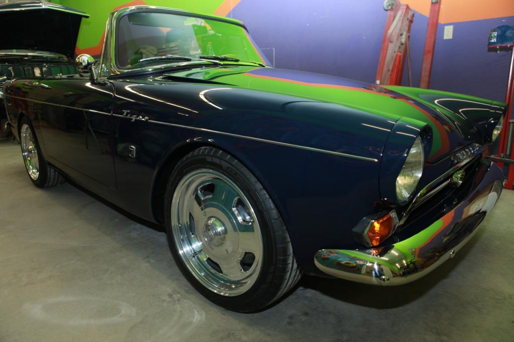

Well, another "stinkin opinion." I have built my Tiger to be a "Modified" Tiger, which to me means keeping the best part of then Tiger and modifying the parts that are not so good. I've got 16" rims because that was needed to clear the suspension parts (using Dale's front end). The problem you have with the Tiger is the front suspension is wide which, when using larger rims, requires a deeper back space to keep the wheel within the fender. Dale's front end is just as wide as the stock front end which continues the problem of needing a deep back space. Mine is 5", which for a 16" wheel is a lot and severely limits you to only a few available rim choices. Here's a picture of my wheel/tire combination. I don't think it looks particularly odd. I've just finished the car, so I haven't worked out all the ride adjustments. I am not convinced that 16 inch low profile tires automatically make for a rough rider. My 2002 Corvette has 275 x 40 18 inch tires, and has a very soft ride. So, I suppose one question is what can be done to the Tiger suspension to have a comfortable ride using low profile tires. Anyway, 16 inch rim and tire combinations have a limited choice for rim styles and tires. Cliff

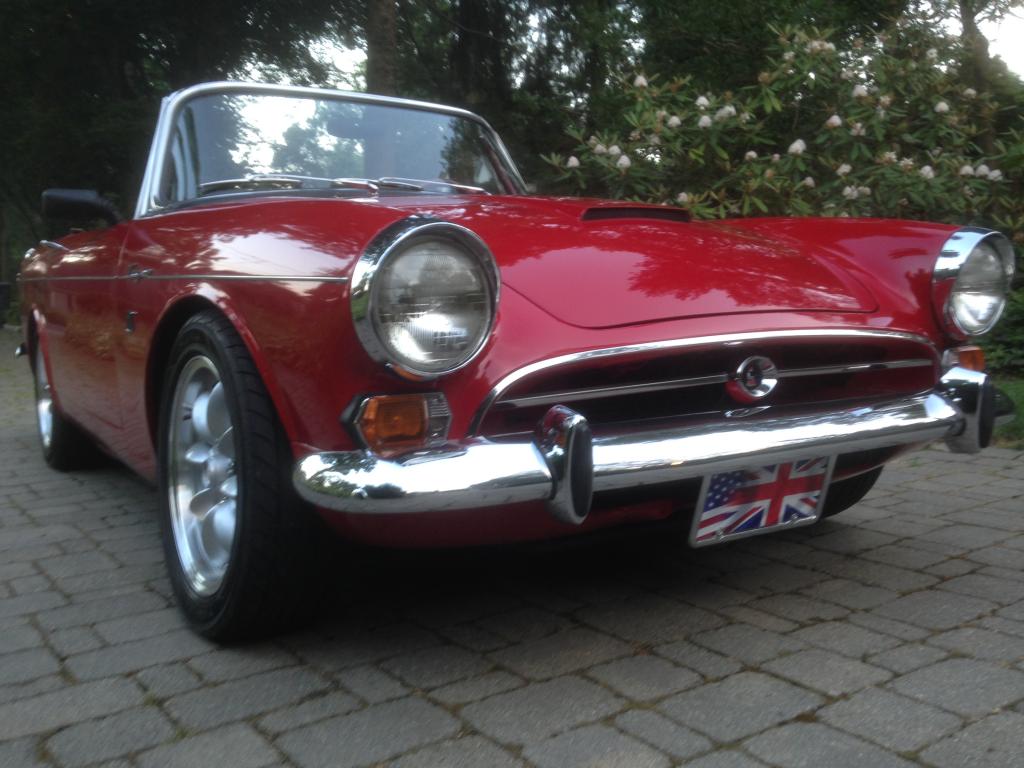

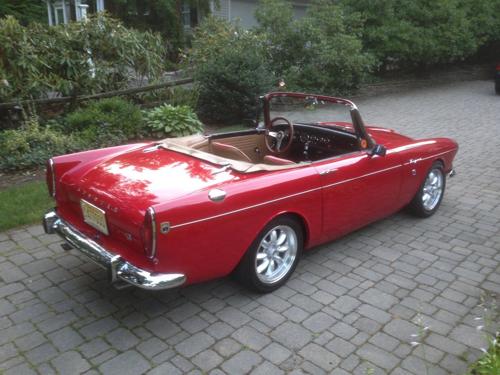

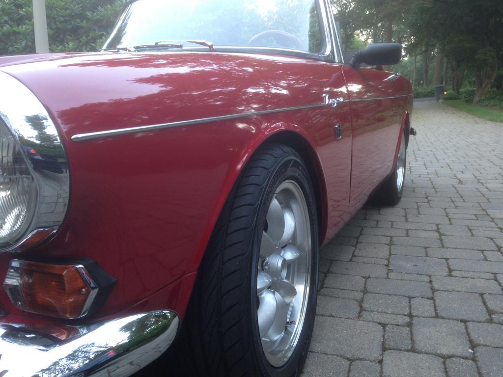

15" still gives a decent ride quality.
Mine are:
Rear 195/55x15 15x7 wheels 4.8 backspace (20 offset)
Front 185/55x15 15x6 wheels 4.3 backspace (20 offset)

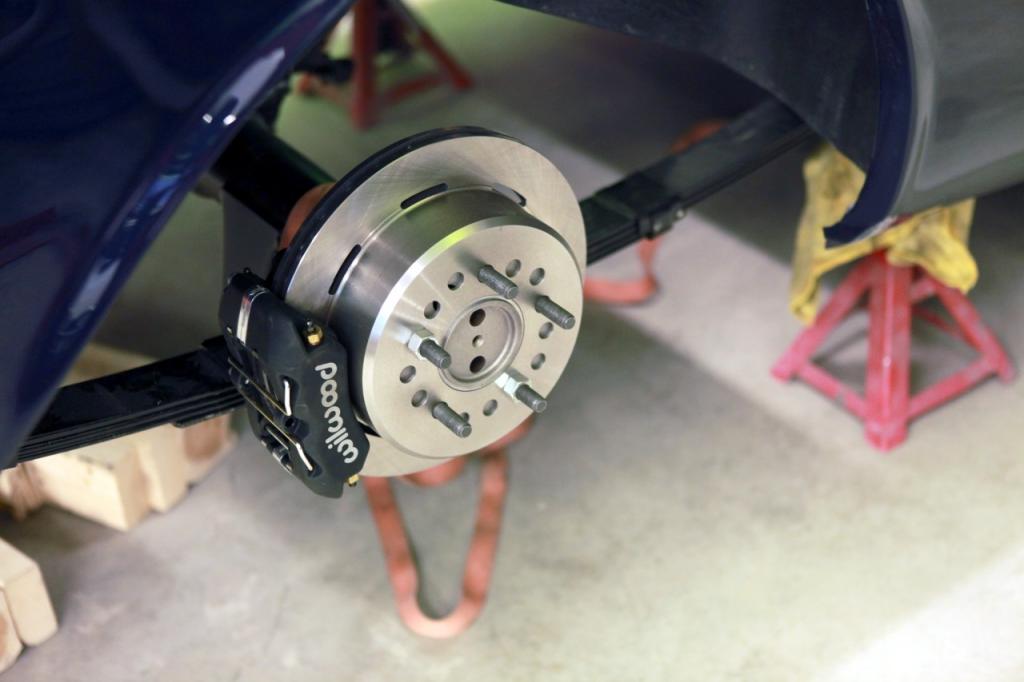

. I've got 16" rims because that was needed to clear the suspension parts (using Dale's front end).. Cliff
Cliff quick question... You say you needed 16" to clear the suspension parts in the Dales aftermarket setup... I assume thats for optional very large breaks? I thoght dales front end worked for all wheel sizes just depended on size of the discs used?
CLIFF_MK1
212
Michael, let me check my paperwork and take a look at the car to be specific about the details. Cliff
CLIFF_MK1
212
My hub and disk are 12" with 5 lugs. The caliper just fits inside the 16" wheel. Dale offers disks from 15.5 up to 13." The 13" my require a 17" wheel as it likely woun't fit my 16" wheel. Cliff
