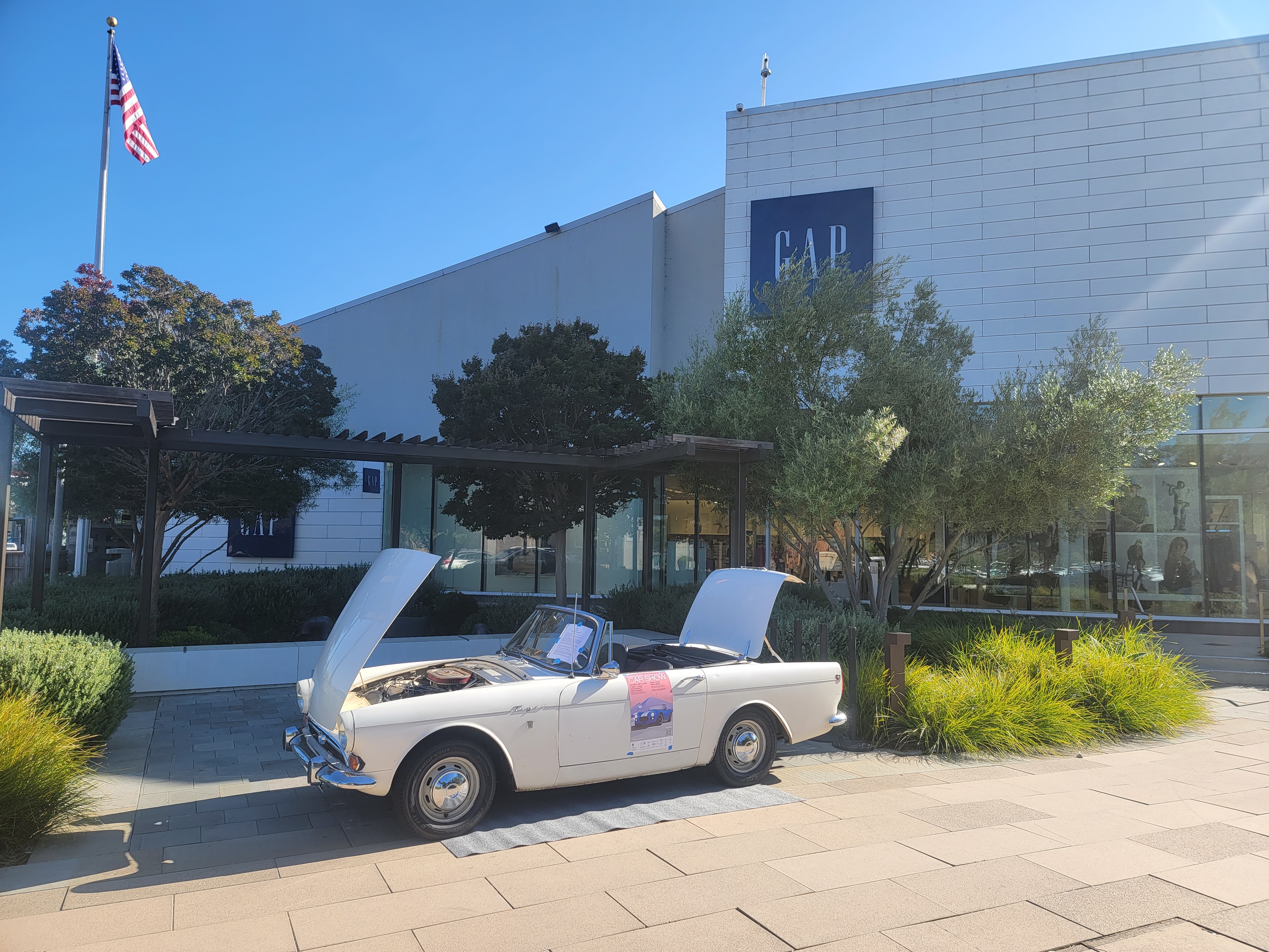

Quick update. Showed the car for the first time back in September. Local Lyons club show. They asked if I would display it at the local mall to drum up interest. We recieved a lot of questions when we were parking it.
Also, even though the QR code used for voting listed us in the wrong category (sports car rather than survivor) we placed third in the survivor class.
