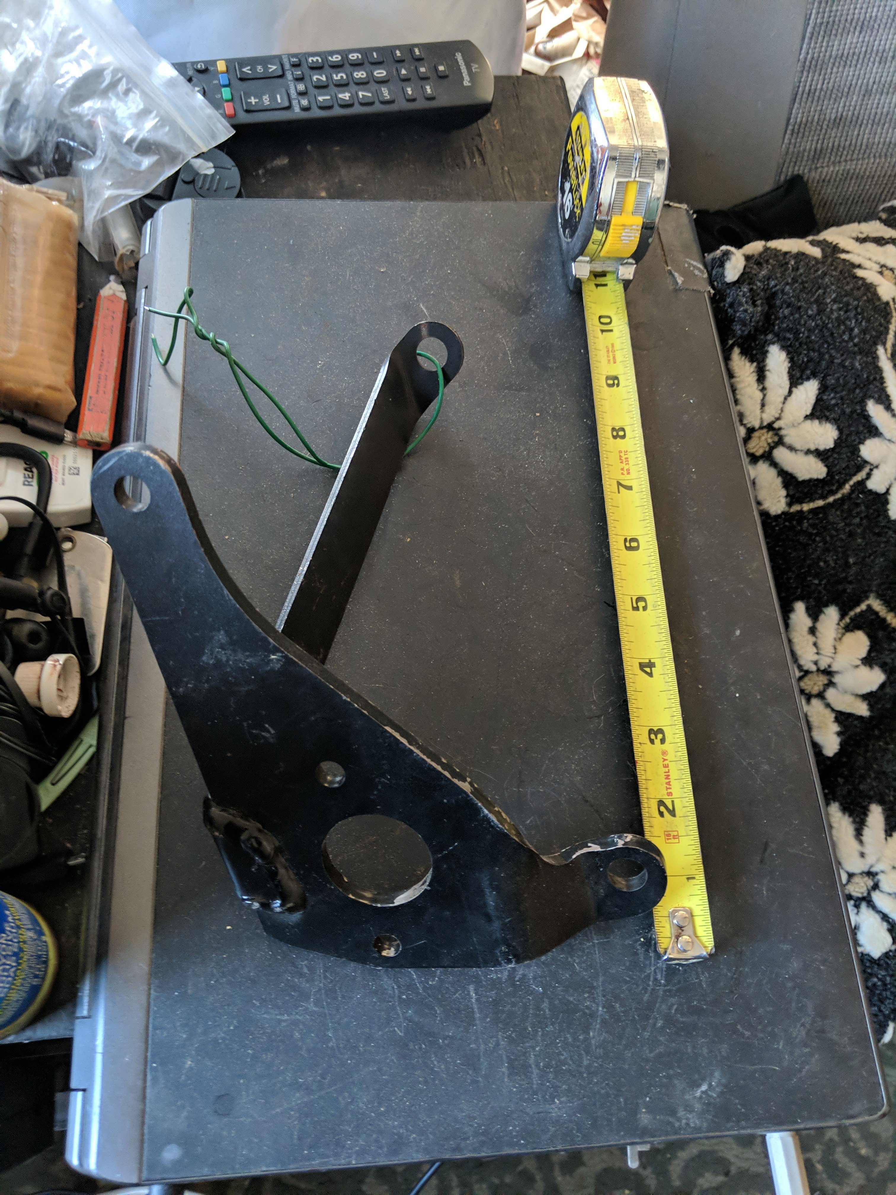

Okay, silly question. I just received the CAT aluminum 6 bolt slave cylinder bracket, which I want to use with an original 289 ford aluminum 6 bolt bellhousing. Does the bracket require minor clearances to be made on the bellhousing ribs, or should there be spacers? Hopefully the pictures below will help.
Thanks,
Woody

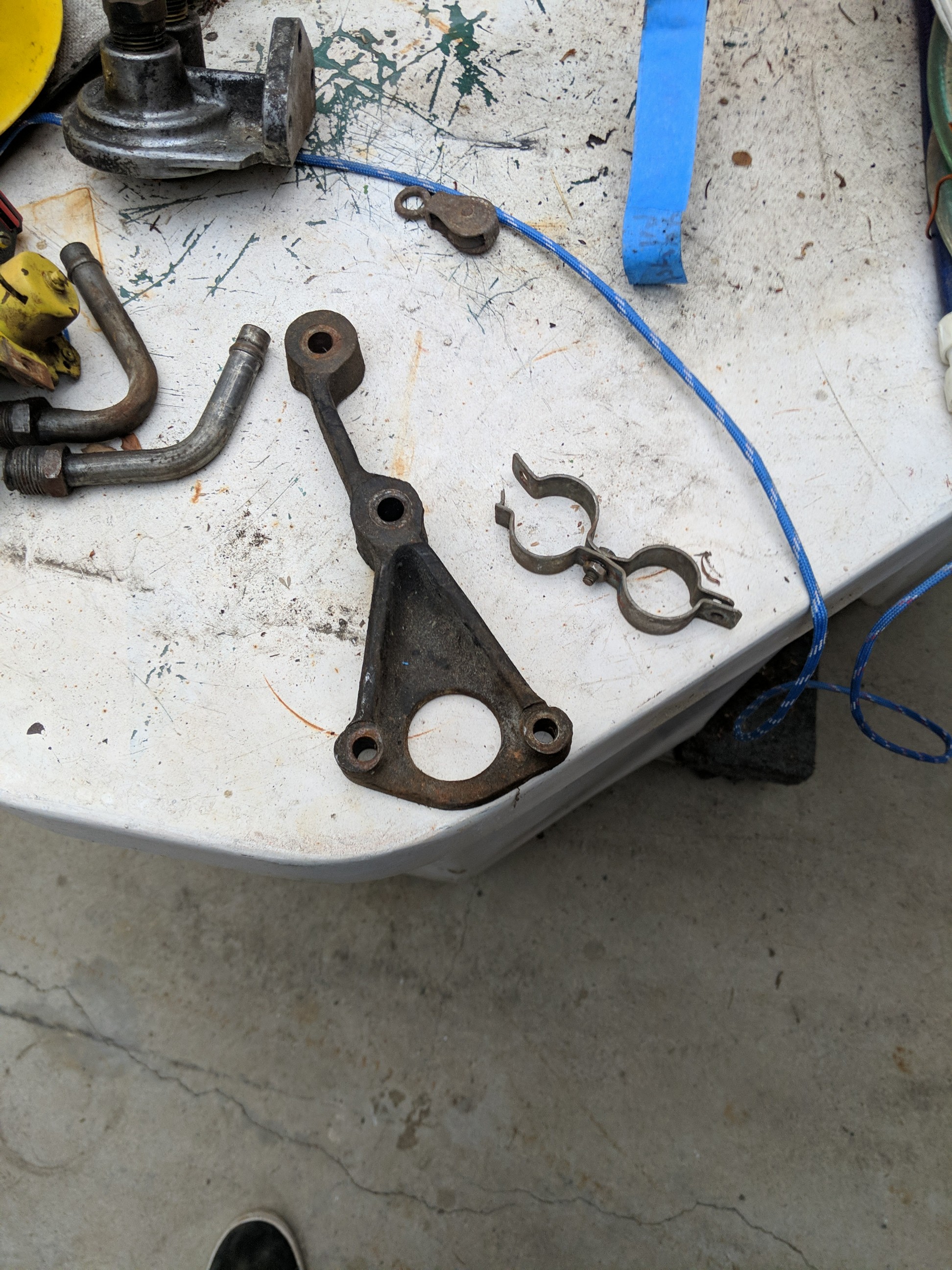

The M2 style or the one on the right? I've seen the cast one on the right have a extended top bolt hole .

I have the welded Mk2 style bracket. Because it mounts with a bellhousing bolt above and below the slave cylinder, it interferes with the headers from Sunbeam Specialties. I considered notching the bracket, but it would still be close to the tubes, and it is steel and will transfer heat to the slave cylinder quite well. The aluminum CAT bracket mounts with two bellhousing bolts above the slave cylinder, so it looks like it will be further from the heat of the headers. The headers are currently at Jet-Hot getting coated, and I may construct a heat shield for the slave cylinder as well. Here are some pics of the Mk2 bracket and headers.

Many thanks. The CAT aluminum bracket is in no way flimsy. I prefer it because it mounts away from the headers, and is aluminum rather than steel. The aluminum should absorb less heat, and dissipate heat better. You can see from my photos above that the steel one is close to the headers, both on the mounting plate and on the leg/3rd mount. I can clearance it, but it will still be close to the header tubes by design. Lastly, the diaphragm pressure plate from modern driveline will not require the pressure of the heavy-duty finger-style pressure plate that I used in the 80's - that one was seriously heavy (LOL, the old alignment shop owner told me 'takes two men and a boy to depress that clutch').
If the aluminum one flexes or fails, I'll own it and post here to save someone else the same headache. I really can't see that happening, because if that aluminum mount won't work for my application, then it probably won't work for anyone.
Headers should be back from Jet Hot in a week or two, I'll follow up with pictures when it is all assembled.
--Woody

Many thanks. I would have worried about buying a 3rd bracket, with the first two each having some issues. Grinding the bellhousing would have worked fine, but as I was reluctant to do that first because it was powdercoated, and second because the bracket is the more minor and easily removed part. Some were concerned that removing material from the bracket would weaken it, but the actual amount removed to clear the bellhousing reinforcing ribs was really minimal. Once done, I was happy with the result, and the little bit of grinding I did is invisible. Hopefully the pics will save someone else some minor frustration.
