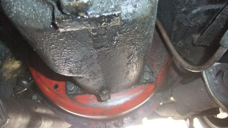

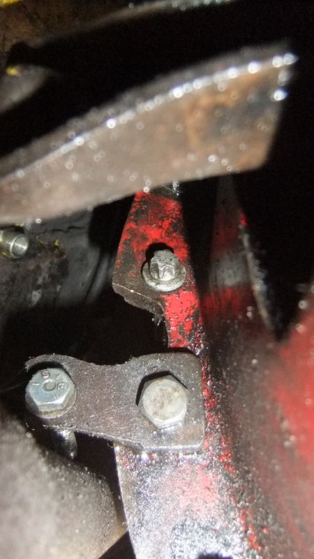

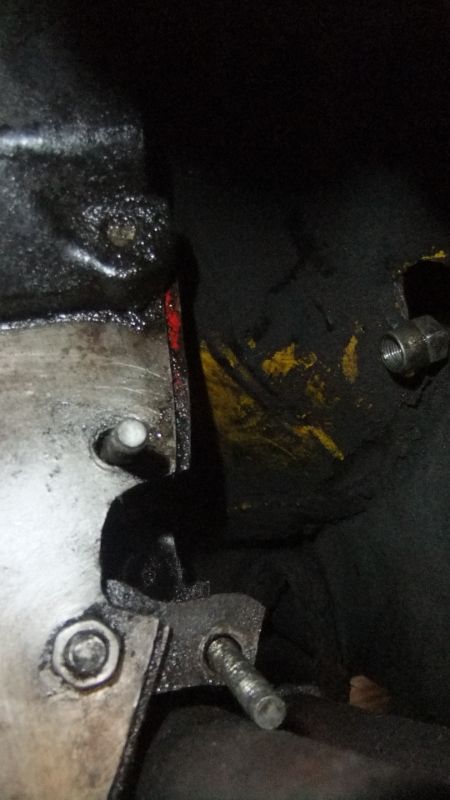

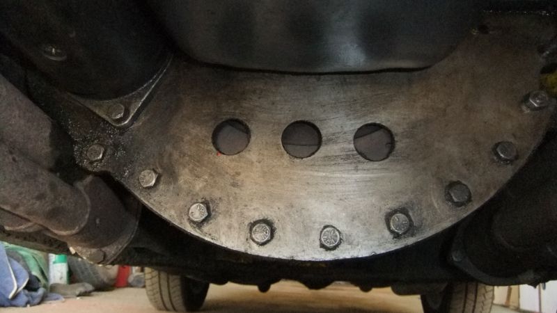

Ok, I've taken some photos to try & show what I've got. Whilst looking at the bell housing I remembered that the person I bought the car from told me it had a scatter shield fitted. I take it that is why my bell housing looks nothing like yours One of Five? Will this affect what slave bracket I can fit?
Apologies for the oily, down at heel appearance of my car; it's a fixer upper! And yes, it shows every sign of having been painted banana yellow at some time in it's chequered life :eek:
I left the bolts in the mounting holes to make it clearer where they were.
Slave Cylinder Mount From Front Of Car
Slave Cylinder Mount From Rear Of Car
Bell Housing/Scatter Shield

OK, now the pictures show the issue. The slave is sitting too far away with the Mr Goldberg bracket set up. Send me an E-mail and I'll return some pics with dimensions for you to modify what's there. A few washers (spacers) and longer bolts should patch it up:).
