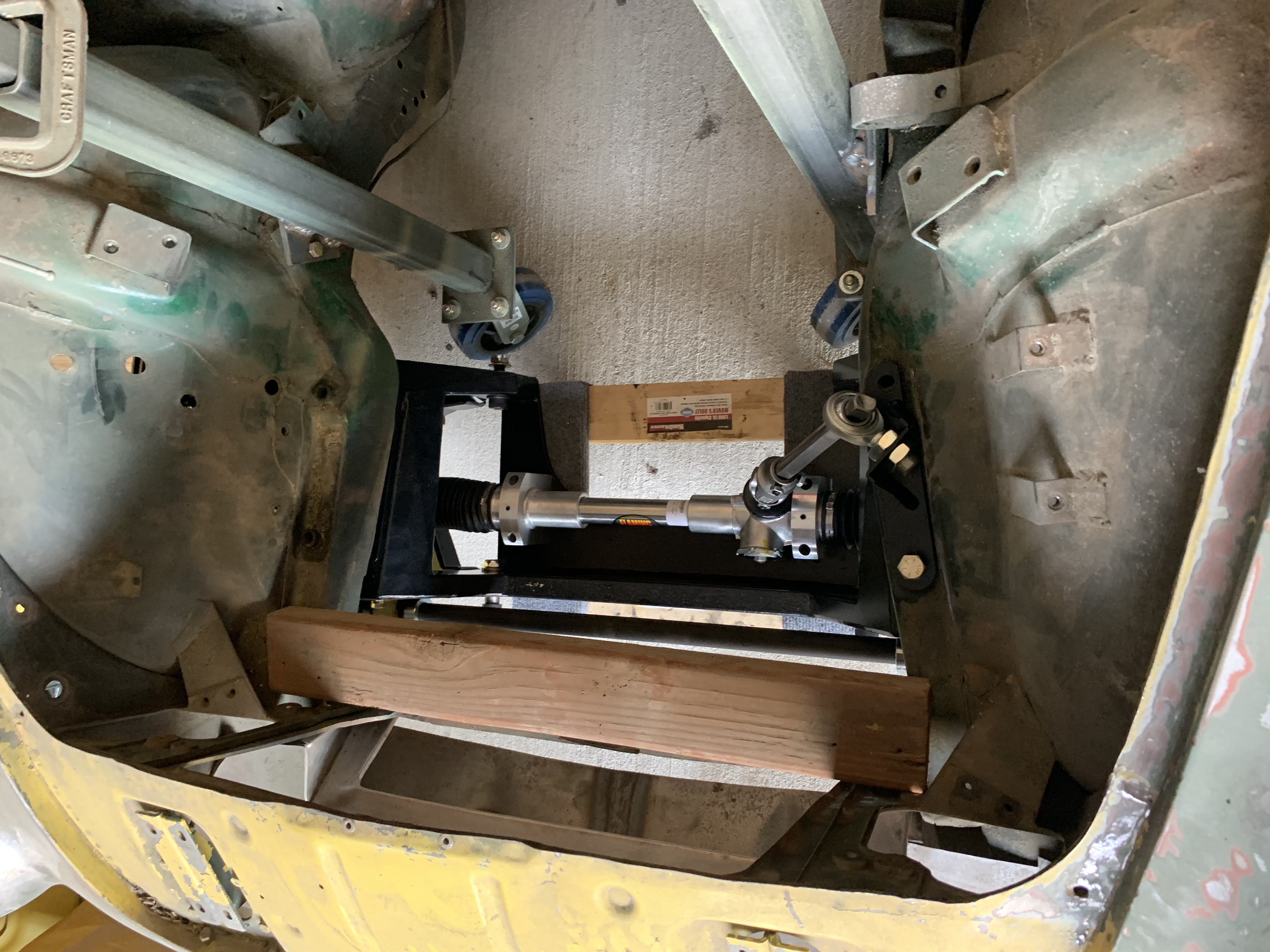

How did you run your brake lines?
I got an early Christmas present last week - one of Dale's front suspensions! I drove down to his shop to pick it up and ducked $400 or so in shipping charges. The parts box has the brake hoses and flared fittings, but I am not sure the best way to run the crossover line. I saw a picture on Dale's website but the mounting bracket seems to be mounted differently. I saw in the picture that Cliff posted that he had connection tee on the left side. I thought about doing that too as I will be putting in a dual circuit MC, but my concern is interference with the oil cooler lines and steering linkage. If you have one of Dale's front suspensions, what did you do? Any tips or suggestions on brake plumbing?
Comments and pictures appreciated!
Cheers, -Kevin
1,243
Dale's Front ENd
Have you asked Dale? I would think he has installed more of his front ends than anyone else out there. Or is he MIA?
Forrest39
406
I have not... I didn't want to bug him on a Sunday, and my kitchen pass was only good for today!.
I was able to bolt the suspension into my project Tiger and that will give me an idea of where to place things. I also learned that I will need a thread chaser to make sure my threaded mounting tubes are cleaned out on the top left side where the steering trunion mount bolts in.
I only hope the crossmember bolts in my driver Tiger as easily, but realistically I am not optimistic.
-Kevin

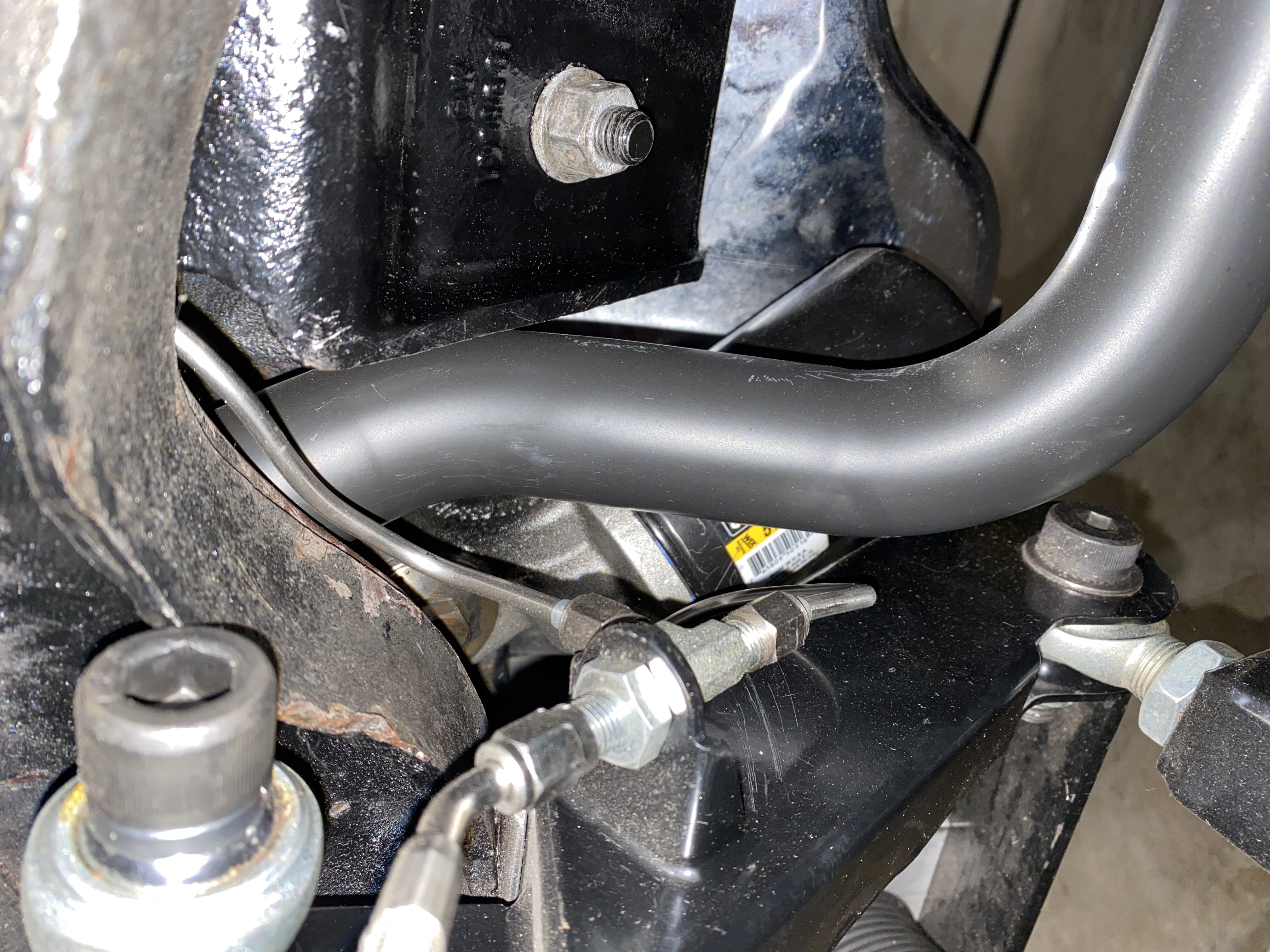

Hi Kevin,
Awesome present! On mine I ran the lines pretty close to the way they are in the picture on Dale's website. Which bracket is different? I have a dual master and ran the line under the frame to connect to the tee for the front brakes. I don't have a cooler but don't think there would be issues with interference. I can take some pictures if you like but since everything's assembled it may be hard to get good shots. You're more than welcome to come look at it if you happen to be in the SFO area. I'm also happy to come down and lend a hand if you need one. My e-mail address is on the first page of this thread.
Edit: I snapped a photo of the junction at the left front. Line is 3/4" away from the header tube. The connection at the right side is similar.
