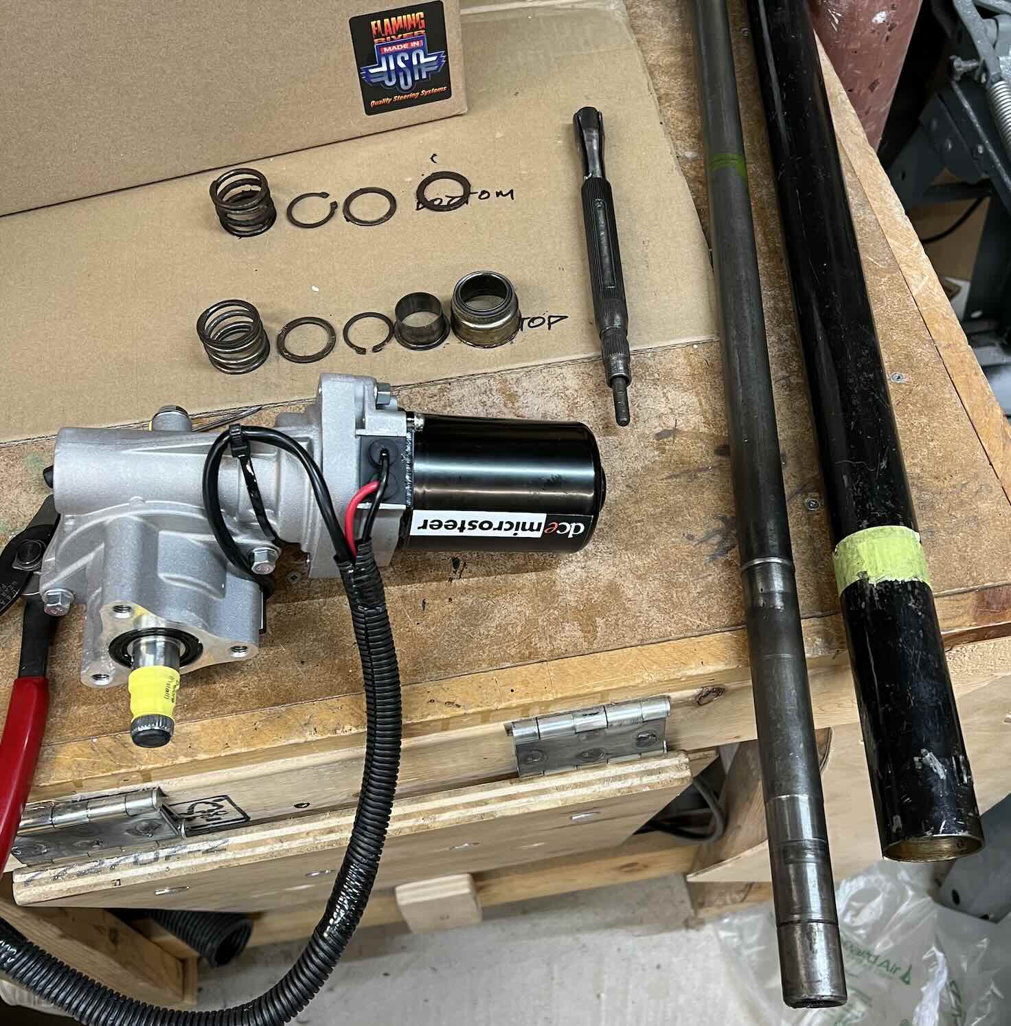

The stock steering column taken apart and the electric PS unit:

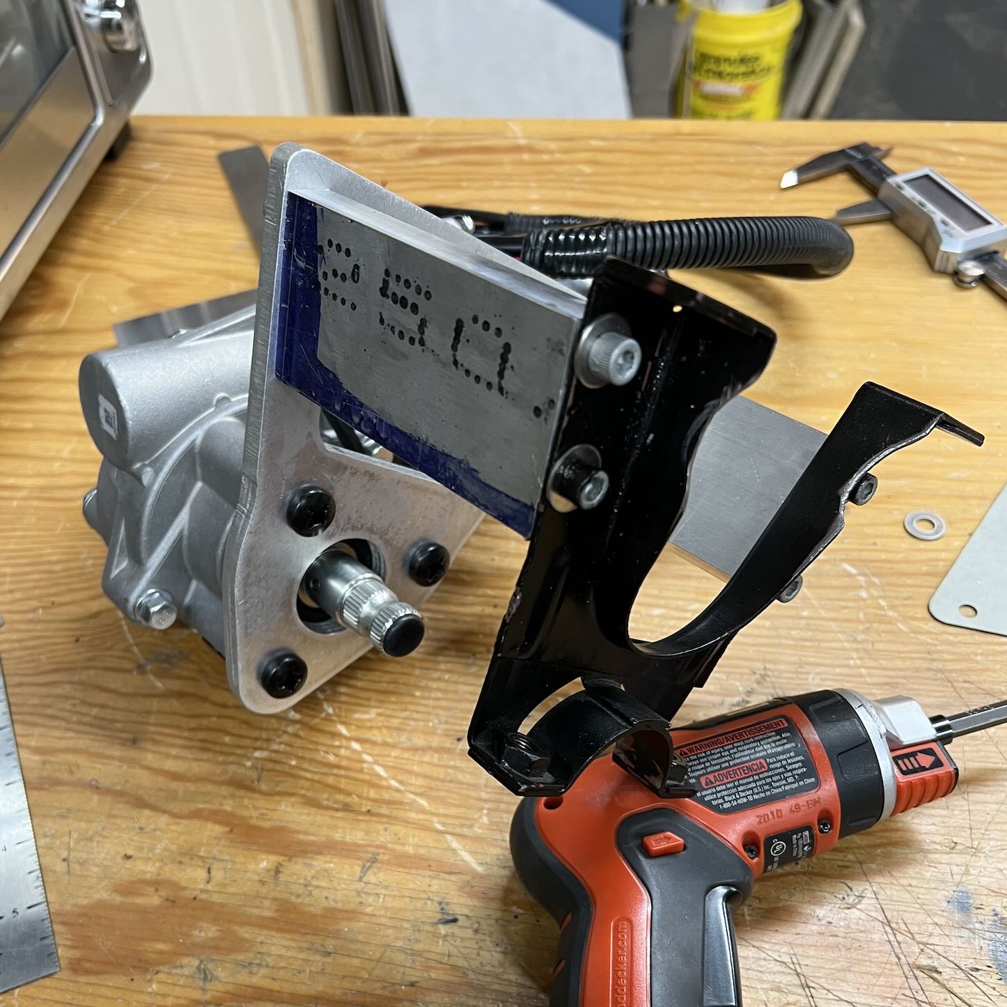

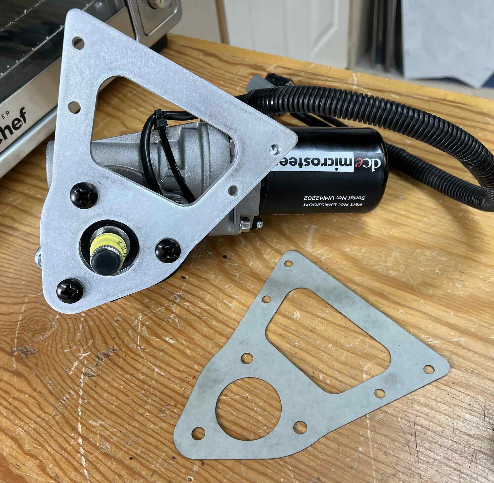

Bracket arrangement for mounting the unit. I'm using the stock column support as the rear mount point:

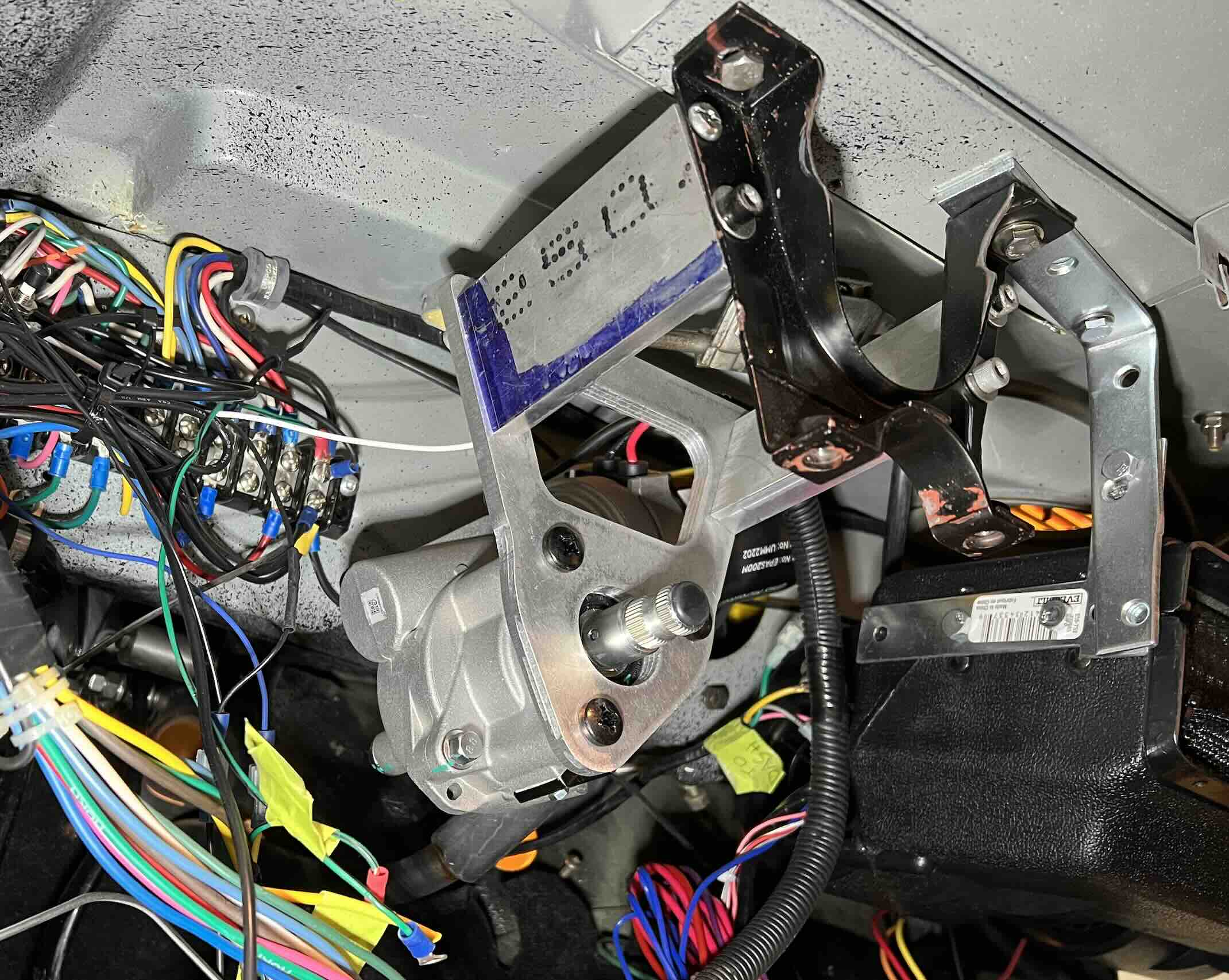

Installed for a test fit. It needs another support at the front as the unit is almost 10 lbs:

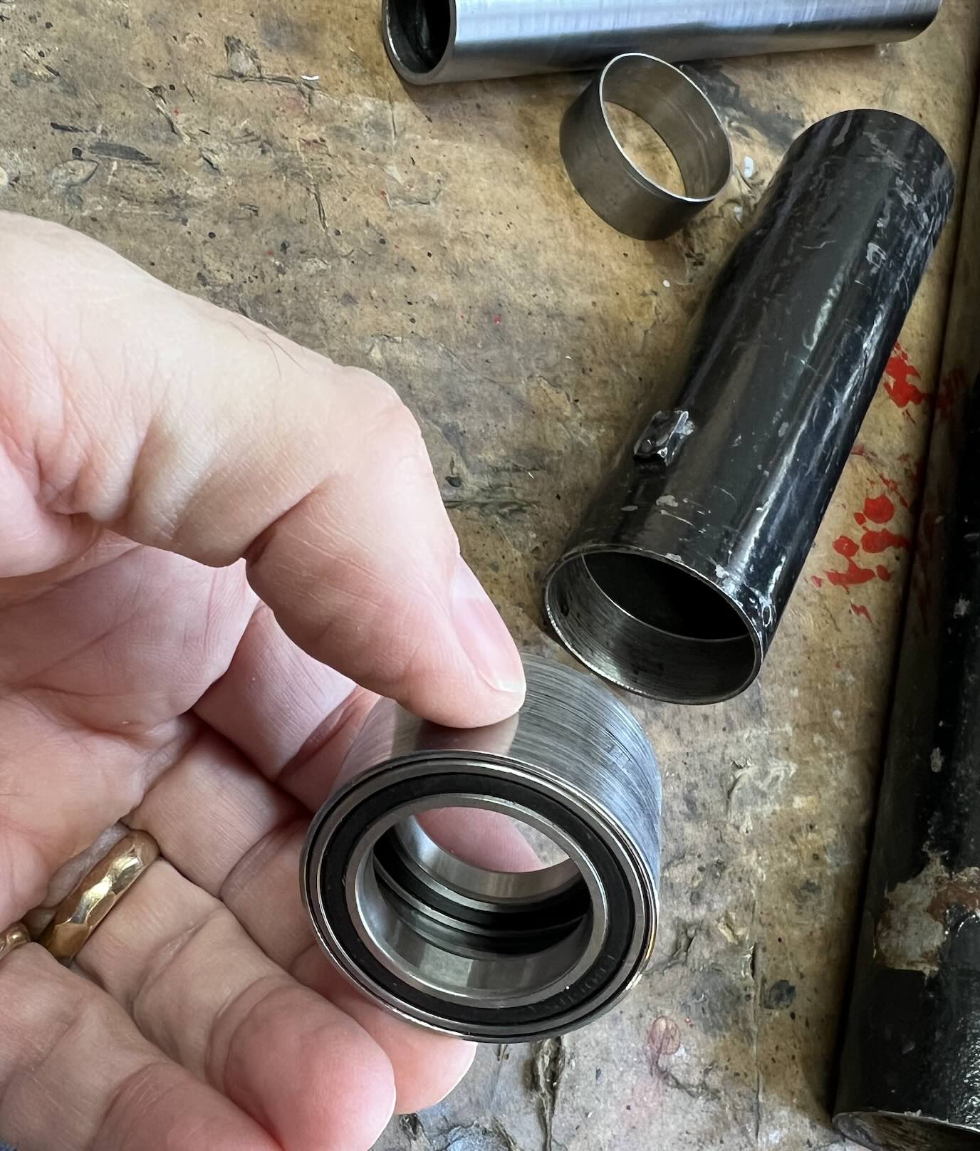

Now that I know it fits, the column needs some serious work. As many have found, the existing bearings in the column are not very good. The description of bicycle bearings is a good one. Since I'm redoing all of this I figured replacing the bearings with some good sealed ones is in order. I ordered a pack of 10 bearings from Amazon, 1" ID, 1.5" OD, .3" thick, sealed deep groove ball bearings. The inner column is just a touch over 1" diameter so a light skim takes it down. I found a piece of black iron pipe that was a perfect size to machine the OD to fit in the outer column tube, and the ID to fit the bearings. This is the upper part of the column. One bearing on the left is not shown. As the bearings are fairly small, I'm using 2 at each location. The circled part is the old bicycle bearing assembly. This is the part of the column that goes from the steering wheel to the PS unit. I'm not using, and don't need, the current spring and spacer hardware.

This shows the sub-assembly of 2 bearings in the new sleeve before being installed in the outer column tube:

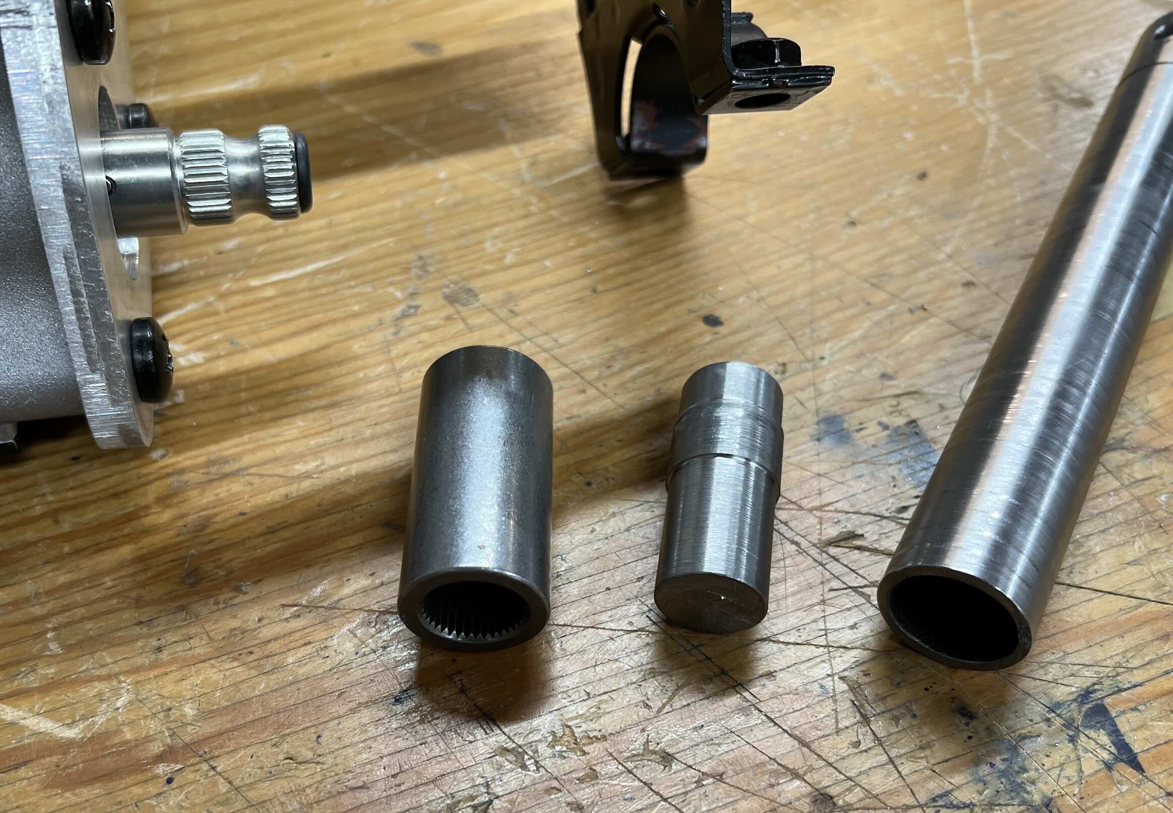

I bought 2 steering column couplers (the piece on the left) that each have an inner spline to match the external one on the PS unit, and a 3/4" dia bore in the other end. I machined a support piece (middle piece) that fits into the inner column and also in to the coupler. I'll slide these together, with Loctite, and then put a cross pin in each section to lock it all together.

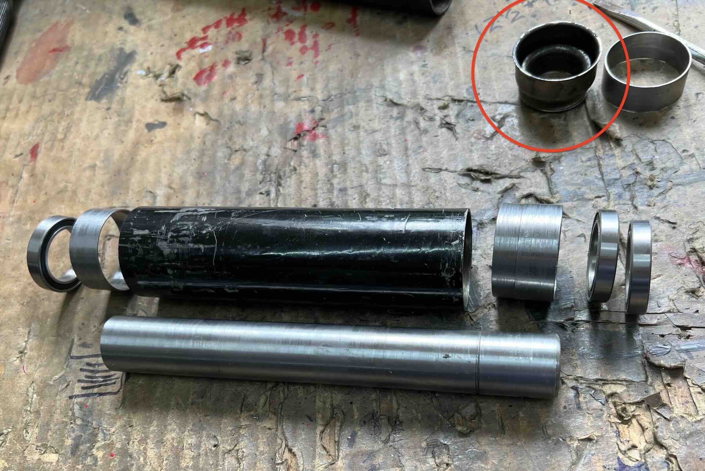

Here is what I have that I'm not using:
I'm going to be using the snap rings. One of the bearing assemblies, not shown, is not usable in any way. The inner race was seized/rusted onto the shaft so I machined it off. But you can have what is shown. I'll send you a PM.

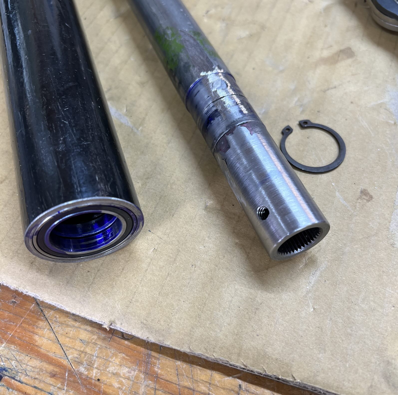

The bearing inner race on the lower portion of the column was seized/rusted onto the shaft, so I machined it off:

It more or less follows the same procedure as the upper column piece. I put double bearings on the lower end with the snap ring to hold them in place:

I cut a new snap ring groove at the upper bearing location. This really just holds things in place while assembling the shaft so the inner shaft doesn't fall out of the outer tube. Once installed in the car it can't go anywhere:
