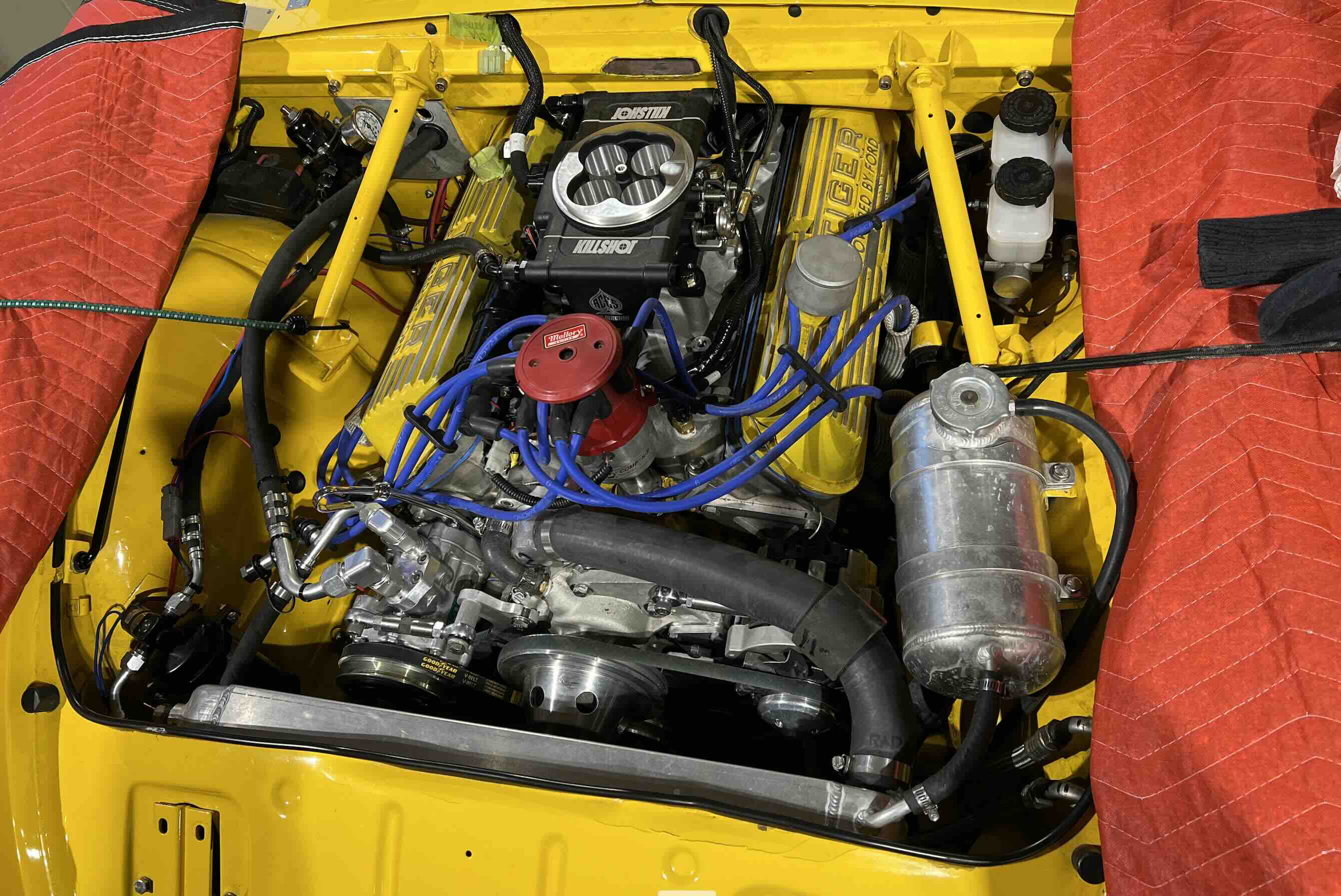

Engine install just about done. Before the cooling system was installed I started the engine briefly to make sure the clutch and shifting worked this time. Drove the car back and forth a few feet....everything good! The clutch released about 2" off the floor, so there is room to play with the pedal ratio if I want to later; less effort if I modify the pedal/pivot point.

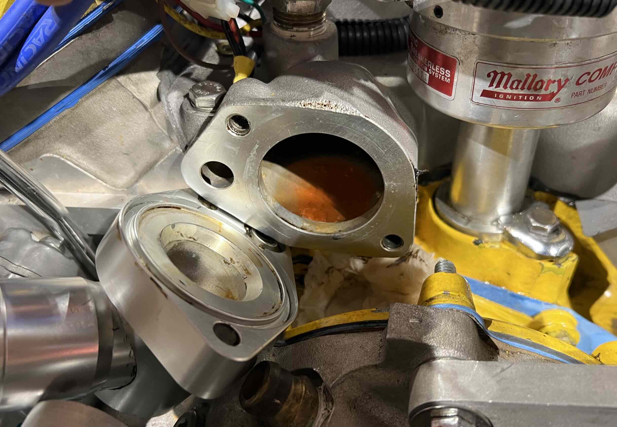

Installed and filled up the cooling system and had a bad leak (that was a little leak previously). It is the thermostat housing. Took it off and saw that the O-rings were very flat and not protruding much from the surface of the housing. Not easy to find the correct size rings for that. Every kit of rings I found has the small one too small a cross-section and doesn't have large enough ones for the larger one. I have some on order that should work.
