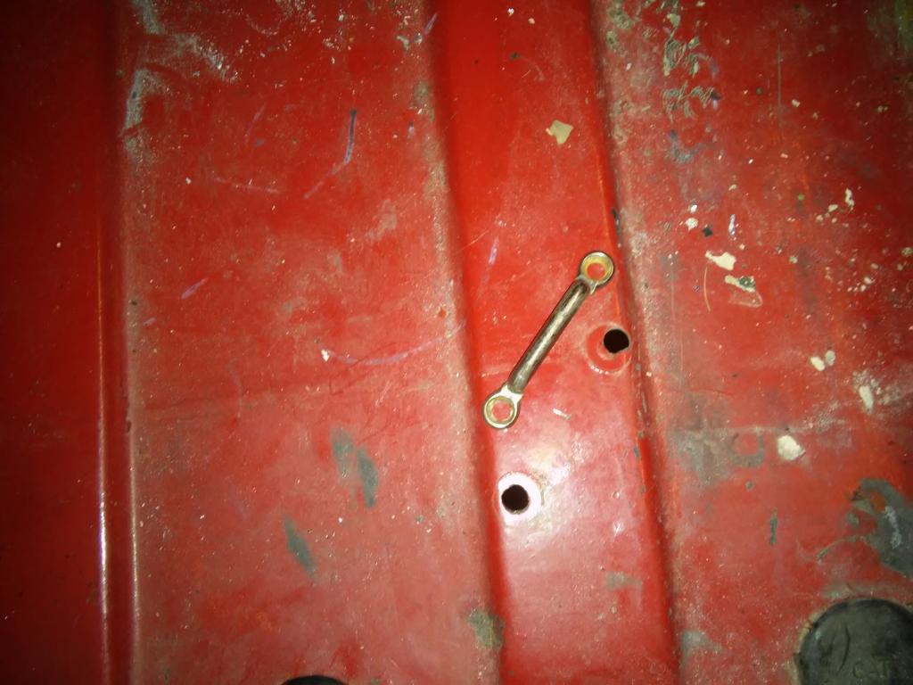

Hi, trying to find out how the 5 footman's loop are fix in the trunk on my MKII
Rick from SS his telling me they where installed will metal screw , If so I have to fill the hole I want to do it before I paint the trunk . Rick told me those black plug are only been use on Alpine.
Just want to confirm !!!!

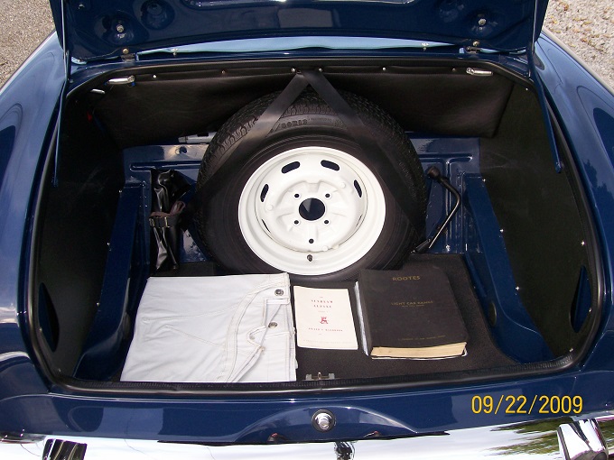

a photo of a series 5 Alpine with the strap holding the spare as Michael mentioned. It's hard to see the strap but if you look closely you can see the strap crossing the left side of the tire and thru the loop at the top and crossing down to the other side.

Nice photo to show how the footman loop was used for the spare tire in a Series V Alpine. The trunk of the car looks gorgeous - always liked that deep blue! Thanks for sharing.

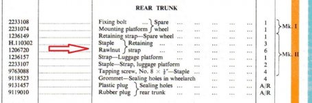

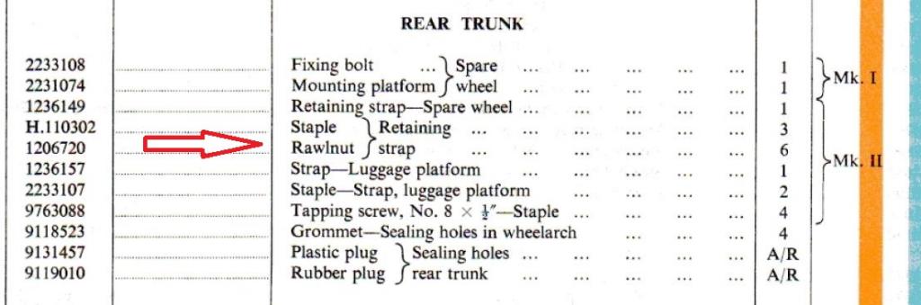

Footman MKII
See attached , I think MKII have 6 Rawlnut to hold the three Footman's loop to hold the spare tire. !!!!

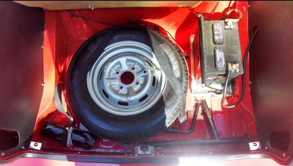

I just installed the footman loops in my MK2. I found the rubber nuts at Lowes in the section where those drawers full of hardware are. They are made by Hillman (nice Rootes name) and cost $1.30 each. They have 10-24 threads. I never knew that these footman loops are wider than the ones used for the trunk tray-I also attached a photo to show the size difference.
1,243
That is a very good find. Thanks for sharing the information about the Hillman rubber nuts.
