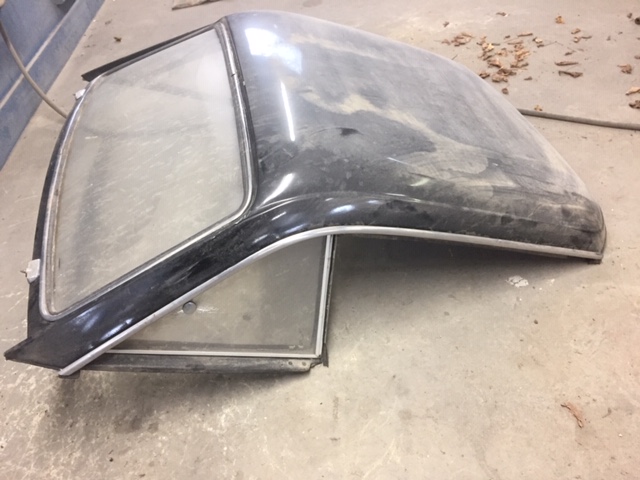

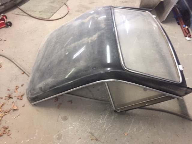

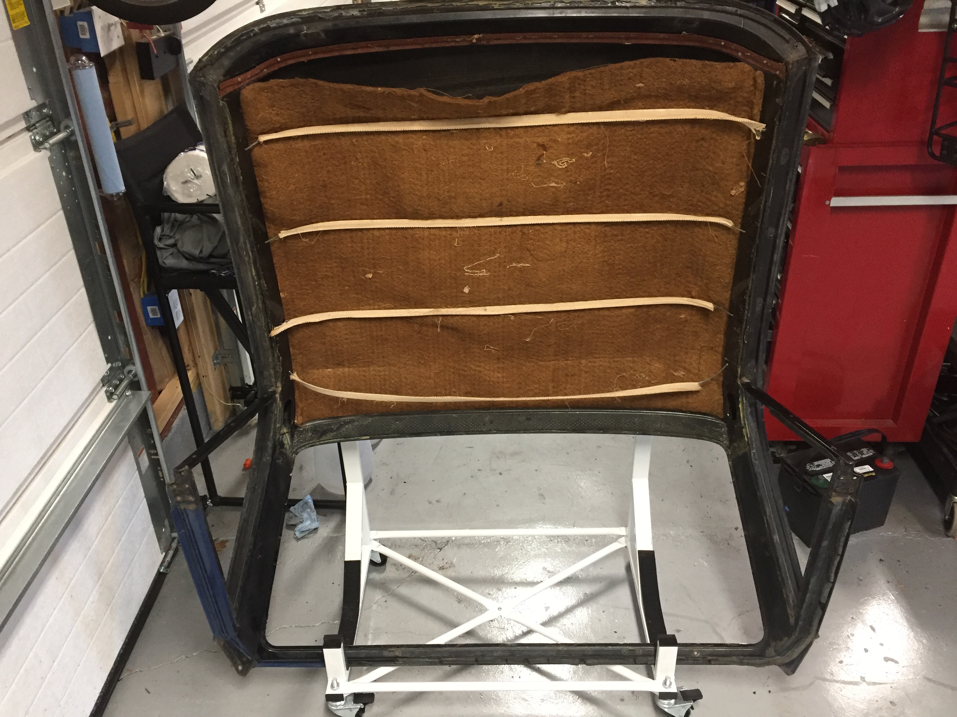

Mission Complete
Yesterday, with the help of DC Tiger, I disassembled my hardtop. I am very glad to report it was pretty painless and took about three hours.
All the fasteners came out without to much hassle, although a few put up a fight but succumbed to penetrating oil. This hard top had seen a previous restoration at some point in its life so the fasteners were not in place for a full fifty years. The only real tedious part was getting the rain gutter trim off. Took about an hour for that part alone, but got it done with no damage to the trim.
No rust anywhere, other than some superficial surface stuff.
Original headliner rods in place and I left them there for the time being.
Now it is time to send out the chrome bits for Re-chroming and to polish up the aluminum trim.
Going with black once I send it out for paint. Asking once again if anybody knows correct shade of black and modern color code.

Thanks for posting this. I have my original hardtop but unfortunately a restorer removed the headliner and lost the rods. Now at least with the picture I know what I'm missing. If anyone knows of a spare set of rods I'd be keen to know.

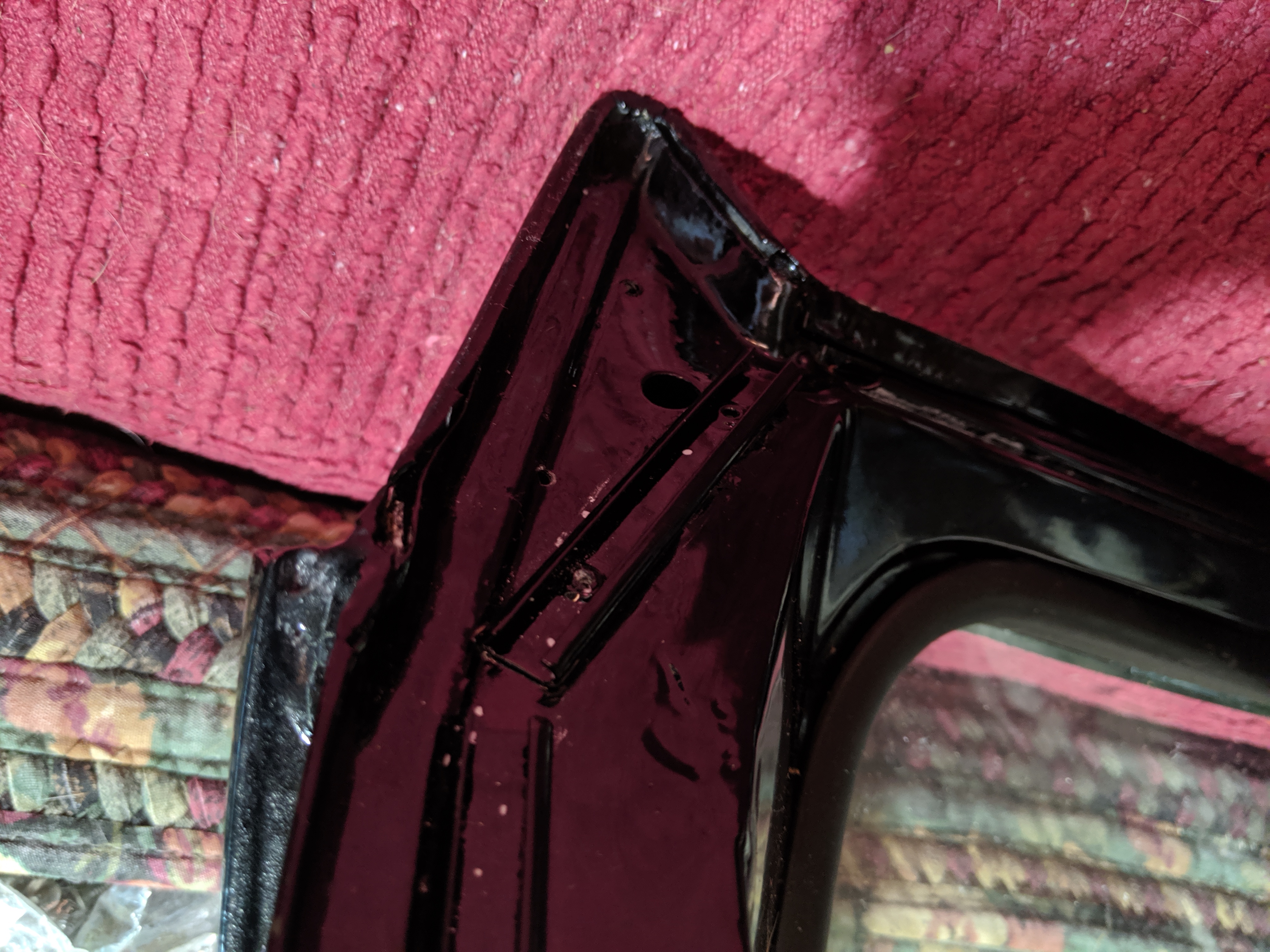

Corner pad
I have what I believe to be a late top and an early top. Both have the annoying channel that is under the corner pad. Rick at S.S. says the channel is specific to one of the tops and is not needed. Question is why is it there and how did it effect the fitment with it there? Was it to allow some weeping area for the misplaced drain hole?

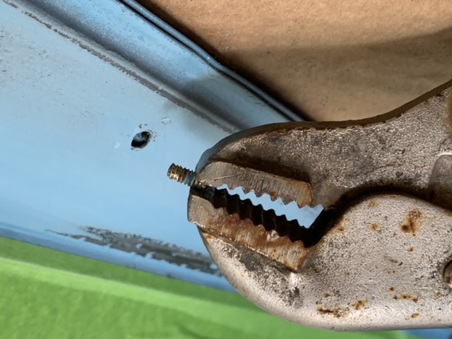

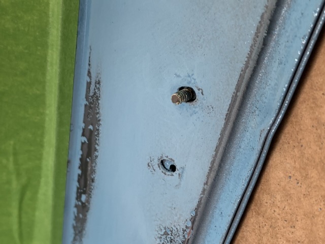

I had the vent screw shear as warned here. This was couple years back prior to mediablast, primer and repaint. So, likely corrosion AND binding paints at screw thread.
So now that im prepping to reassemble, whats the known good process for removal? I attempted to vice clamp, but it wont turn. I tried to locally add pb blaster to threads, but i also need to paint interior and dont want that lubricant on to be painted surfaces. A small extractor is worth a shot, but a quick amazon search did not reveal one.
Since a couple have gone through this, appreciate your suggestions.

Weld onto Stud?
There are others with a lot more experience than what I have, but I have seen where folks have welded a nut to the stub sticking up and then use the nut to unscrew the stud. Of course, one would have to be very careful to avoid damage to the sheet steel of the hardtop while welding.
Good Luck!
Seems like a good idea...alas
Good Luck!
No welder here... Perhaps a super weld / plastiweld / loctite adhesive?
I was just thinking it would be "best" to have gription on as much of the remaining length of the bolt shaft as possible. Adding a new "head" may just shear there and make it shorter still. Those extractors have threads for some length...
Should probably try heat also (but again, trying to do w/o messing with the paint prepared area. Maybe a solder iron on the bolt... worth a shot...
Edit: so the brainstorming worked. Thanks HolyCat. Used pin tip with drops of PB blaster to finely drip near captured nut(s). Let sit. Then hit with point of solder iron for a bit. Some smoke. Could tell was melting some sprayed on paint at threads. Continued heating for a minute or two. Clamped on vice grips and gentle turn. Voila! Sometimes its the smallest victories... lol. Now in need of replacement screw(s).
