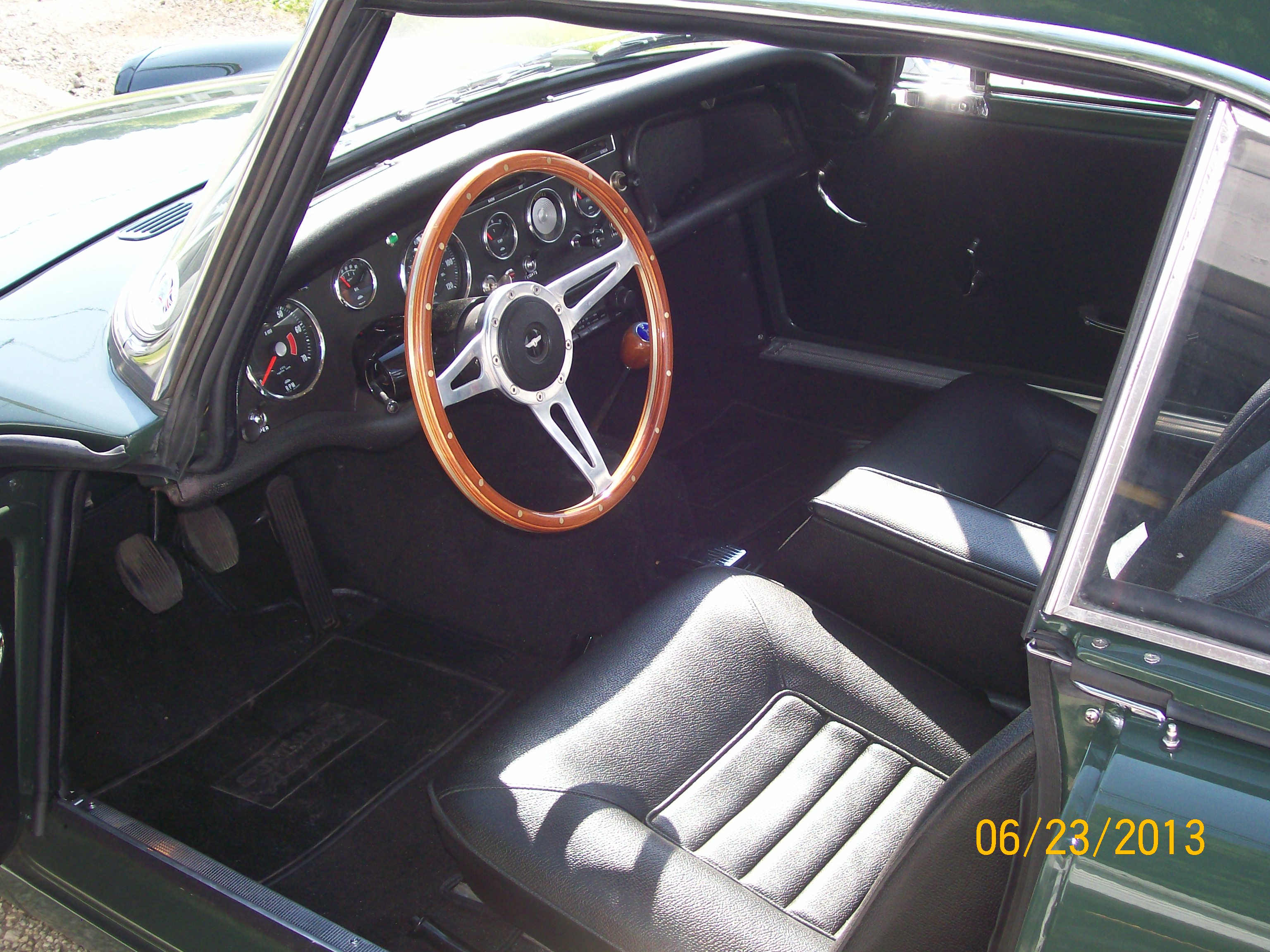

Rick Guest in Texas was making transfers for the bezels. I've used them on two of my cars. You can see it in this photo.
I didn't have to pull the dash to freshen the bezel. I don't know if he still has them in stock.
