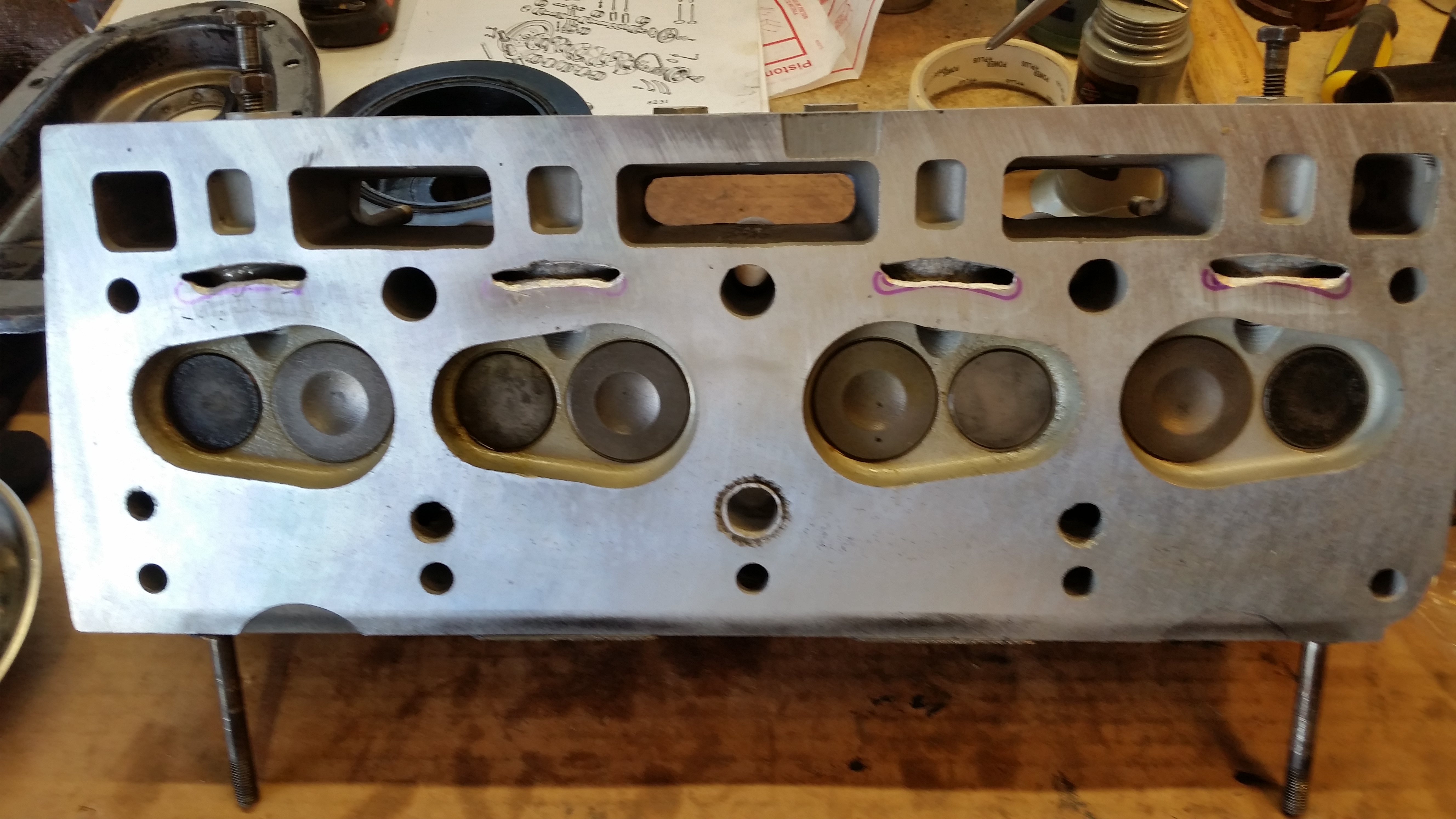

Hello Luke, yes, that is an engine I built. This is a .60 overbore engine. New pistons, Delta cam, can't remember what they called the grind. Suggested for better performance. New valves, guides, bearings. New 60 pistons and rings. Crank was ground, new thrust washers. New water pump, oil pump. block was decked.
I had noticed the colors of the valve cover, which made me think it was mine, plus the guy that bought it was up in that area someplace. That's a standard rattle can color from Home Depot. Don't recall what color until I go out to the shop later.
Anyway I had given the guy a choice of the two barrel setup or the Stromberg twins, but obviously he elected to go with the Weber.
Good luck with the driving. If you decide to keep the 4 speed setup, let me know, I have the original 4 speed from my car from when I went with the OD. Worked great, just wanted the OD. Expensive conversion, but well worth it.
If you're just planning on selling it though, just replacing the 4 speed is a better choice in my opinion. Hard to recover the extra money for the OD.
regards; Jim Jordan

Probably a KB grind on the cam.. Thats deltas usual wake-up grind...nice sports cam by all accounts
