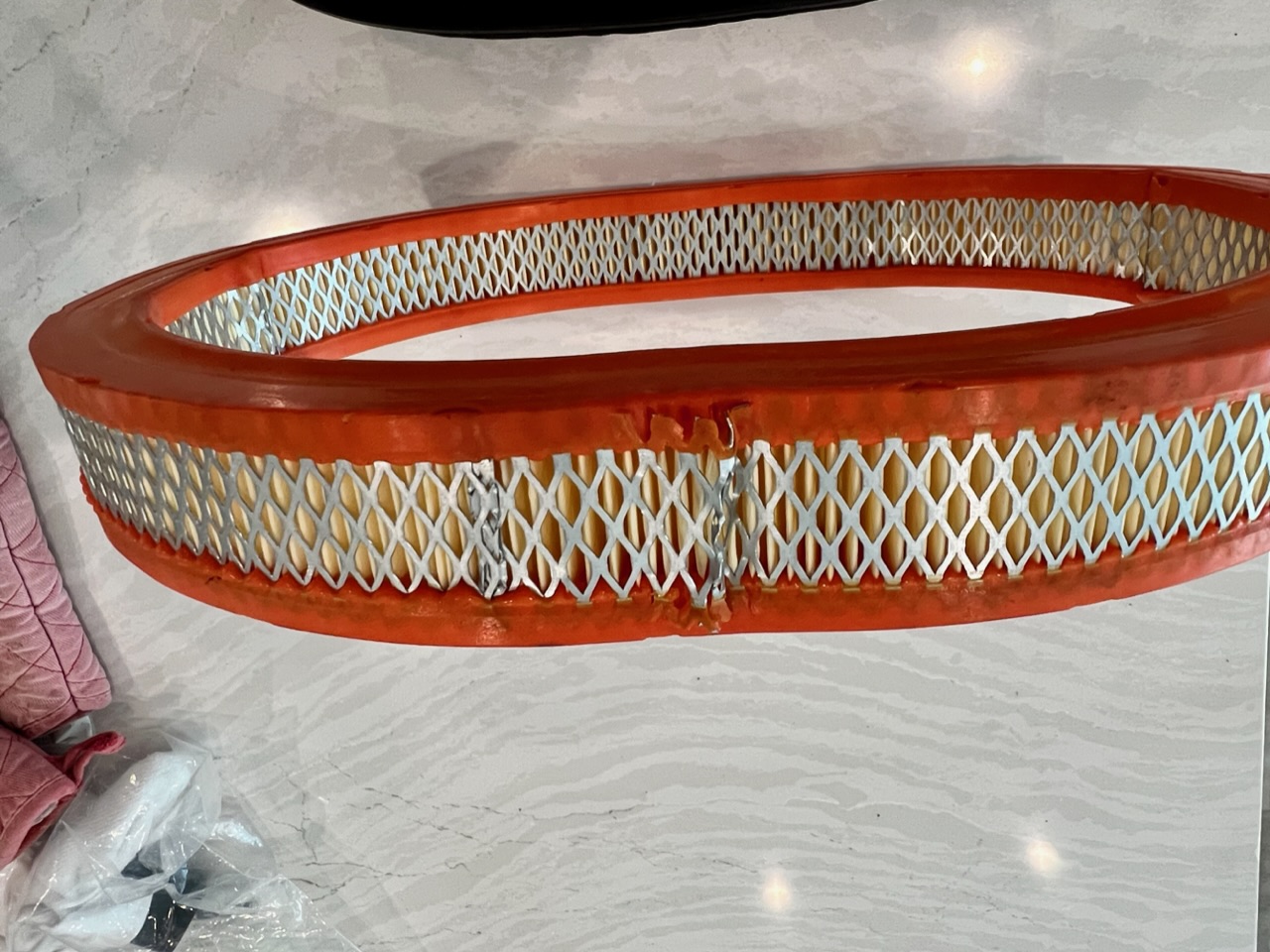

I received the round Fram air filter today. I think it is close to the right size but bending it into an oval to fit the stock housing is a challenge.
Any suggestions?
Any suggestions?

The Fram filter I bought did not work very well. The rubber ring is silicone and I was unable to bend it into an oval very well. Heat did not help since the rubber is silicone which melts at 500 deg and aluminum.
Also, it is 1-1/16" thick vs 7/8" for the stock filter so the Fram filter won't fit the id channel of the housing.
I have given up since I called Rick yesterday and he has on order filters from S&B filter and is confident they will deliver soon. I guess he used to bend Wix filters into an oval with heat, but they quit making the filter he used.
The 13-1/2" diameter worked as far as the size needed to make a 16x8-1/2" stock filter. It was just the bending and the difference in thickness which caused the problem. It is only 1-7/8" tall which is very close to the original.
Ideally if you are bending one you want a fikter without the aluminium mesh.
The silicone is a lot stiffer than the old rubner bases... What about unifilter brand?

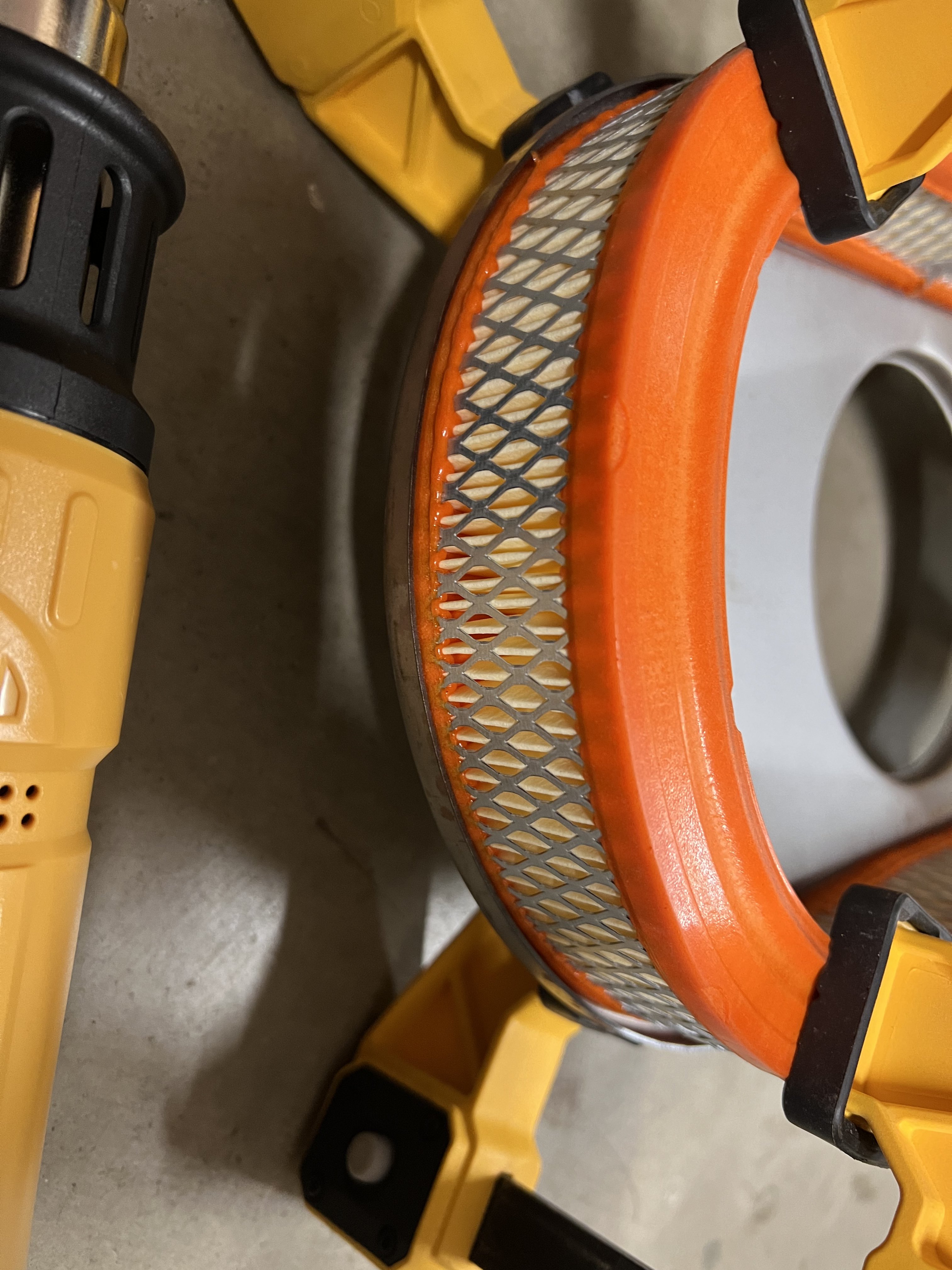

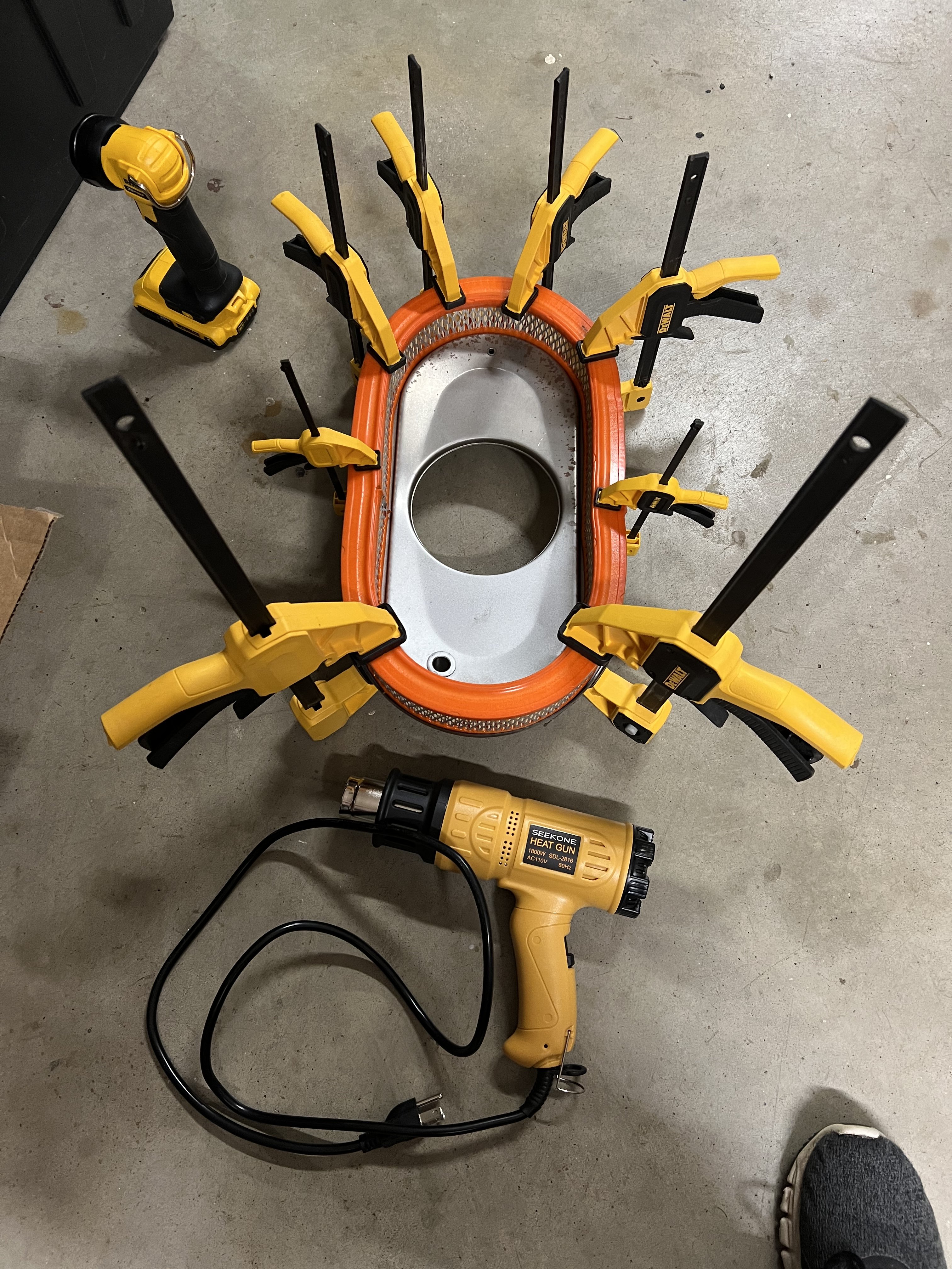

pfreen and jbetz821, good job. I guess now I have another project and just want to confirm that both of you started with the Fram CA3371 filter ? Also I may need to invest in a lot of clamps ;) Curious, once re-shapped does the filter maintain the new oval shape fairly well vs. another two person job to fit it in the AC housing?

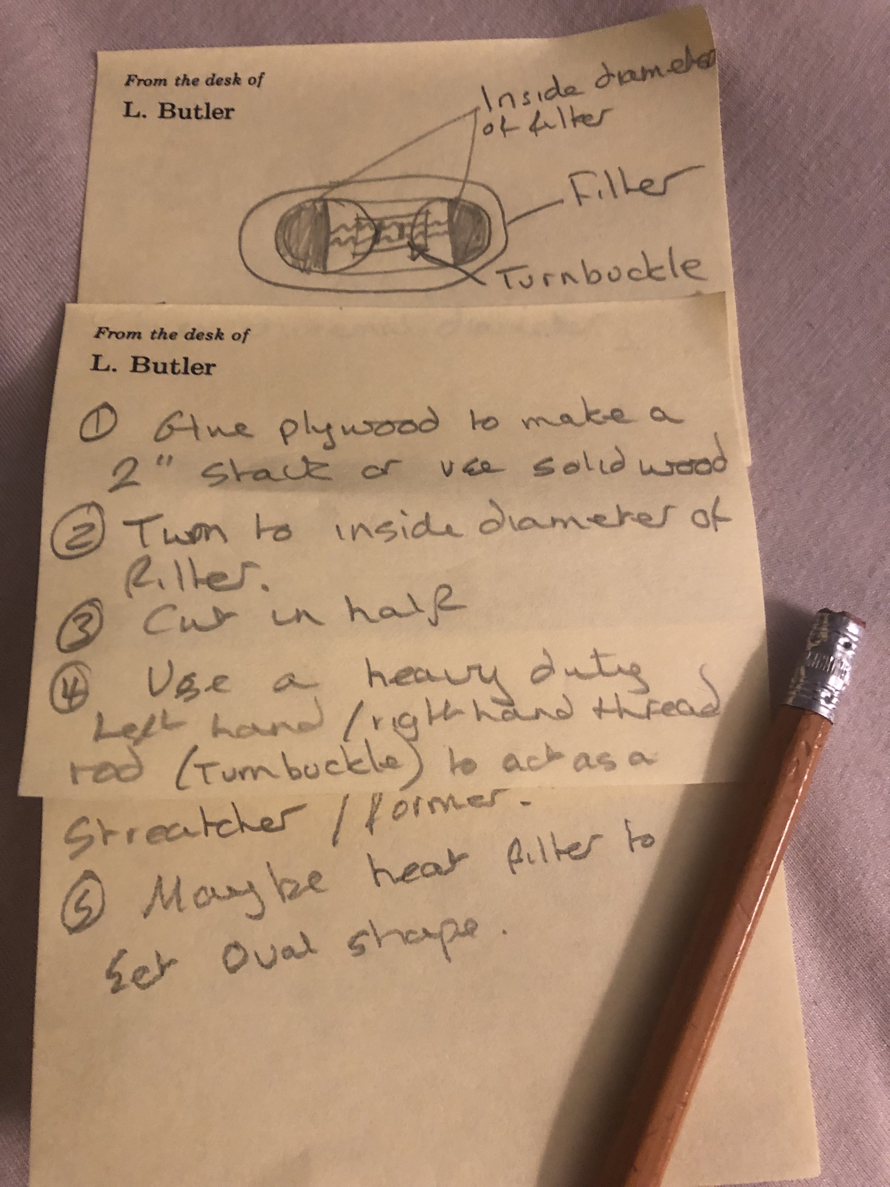

or, Tony Butler, get out my old wood tools and copy your stretcher idea. Amazing how quickly everyone circled the wagons on this air filter issue - appreciate the time/efforts to all.
