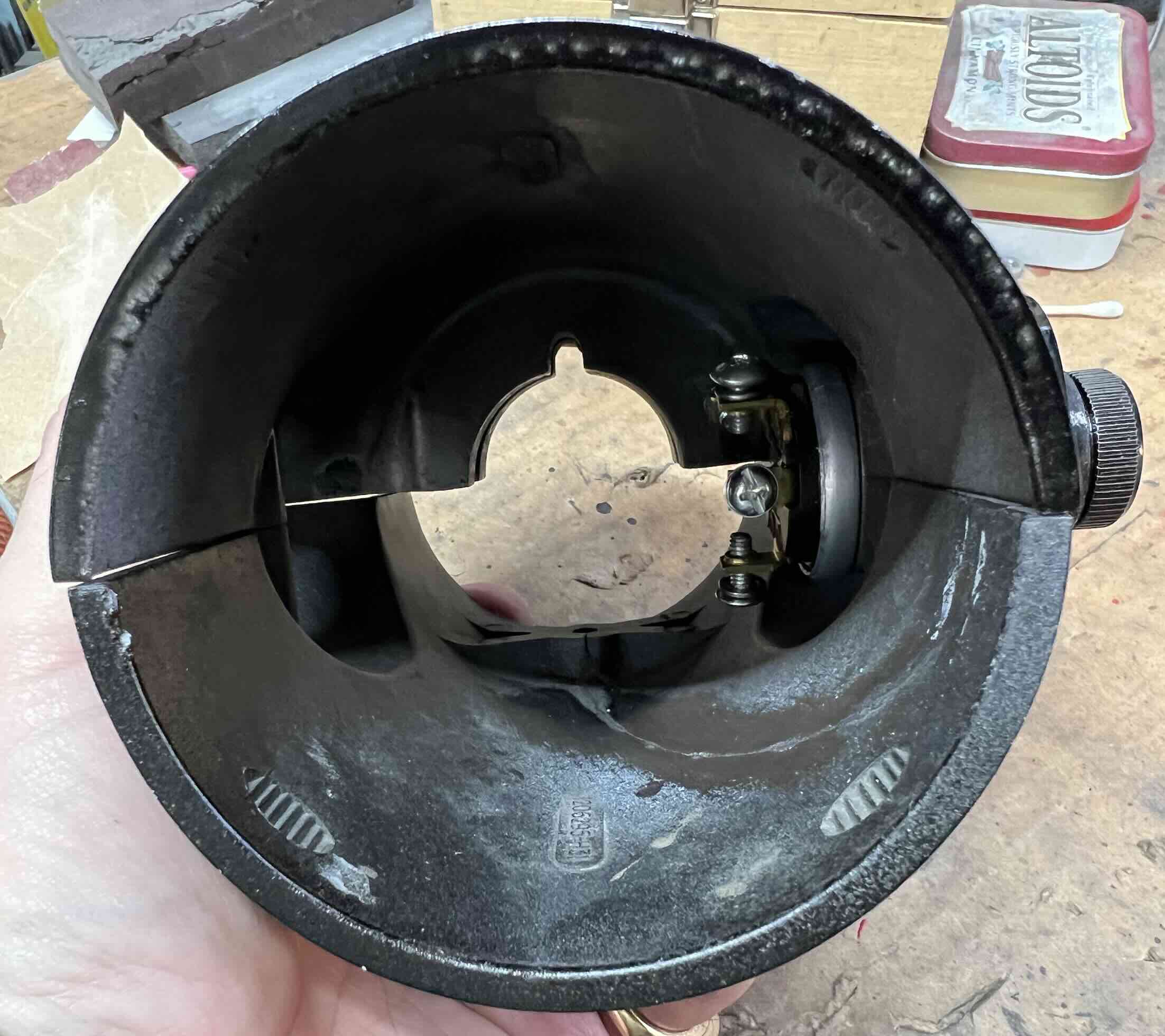

As part of my A/C installation project I'm making a new dash. The dash has to accommodate the A/C vents, plus adding a radio, different switches, and moving things around. As small as it is, I was having trouble finding a good spot for the ignition switch. One reason is that with a key fob I don't want any switches below it as they might be blocked. So I thought putting the switch on the steering column housing might be good.

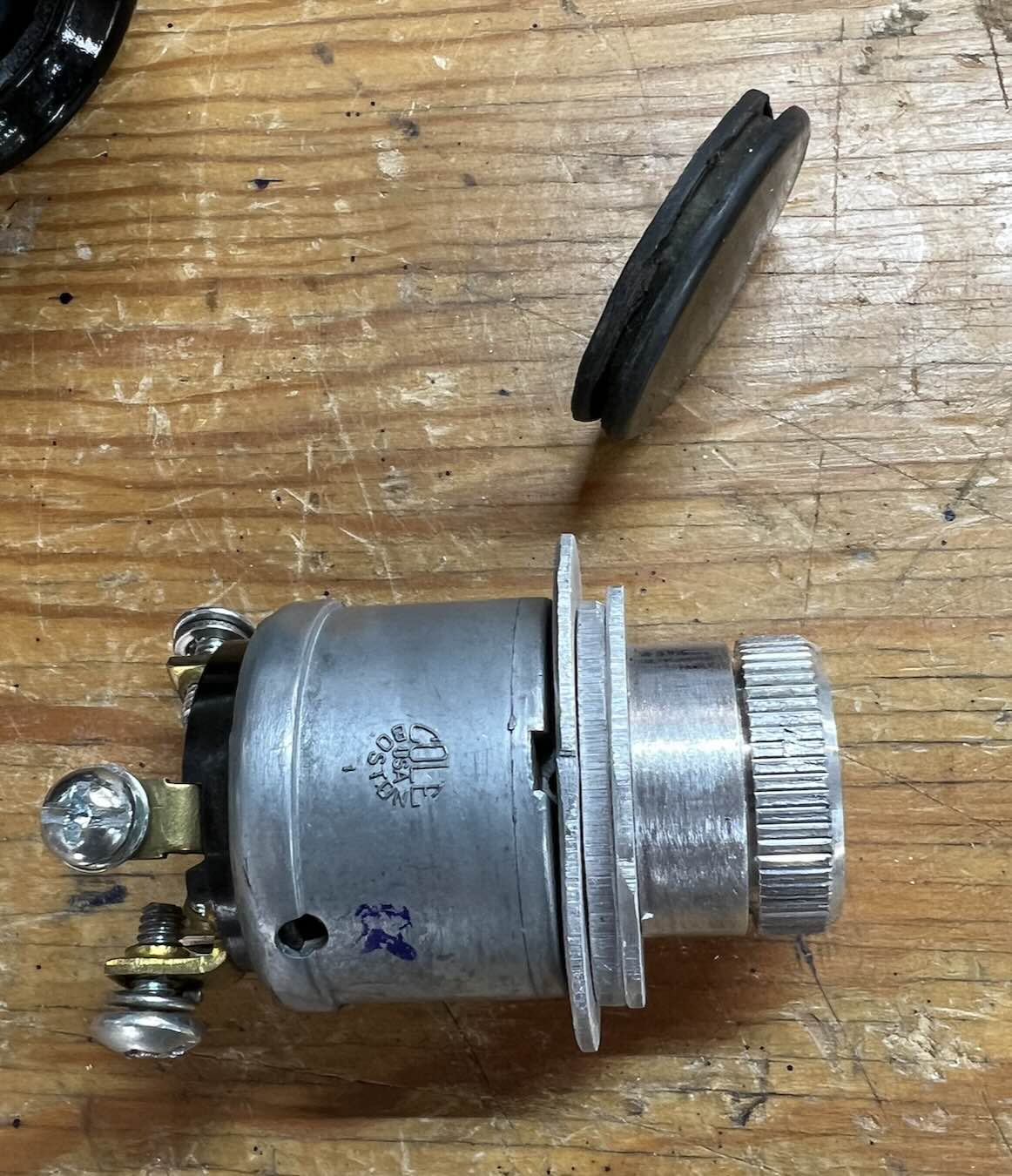

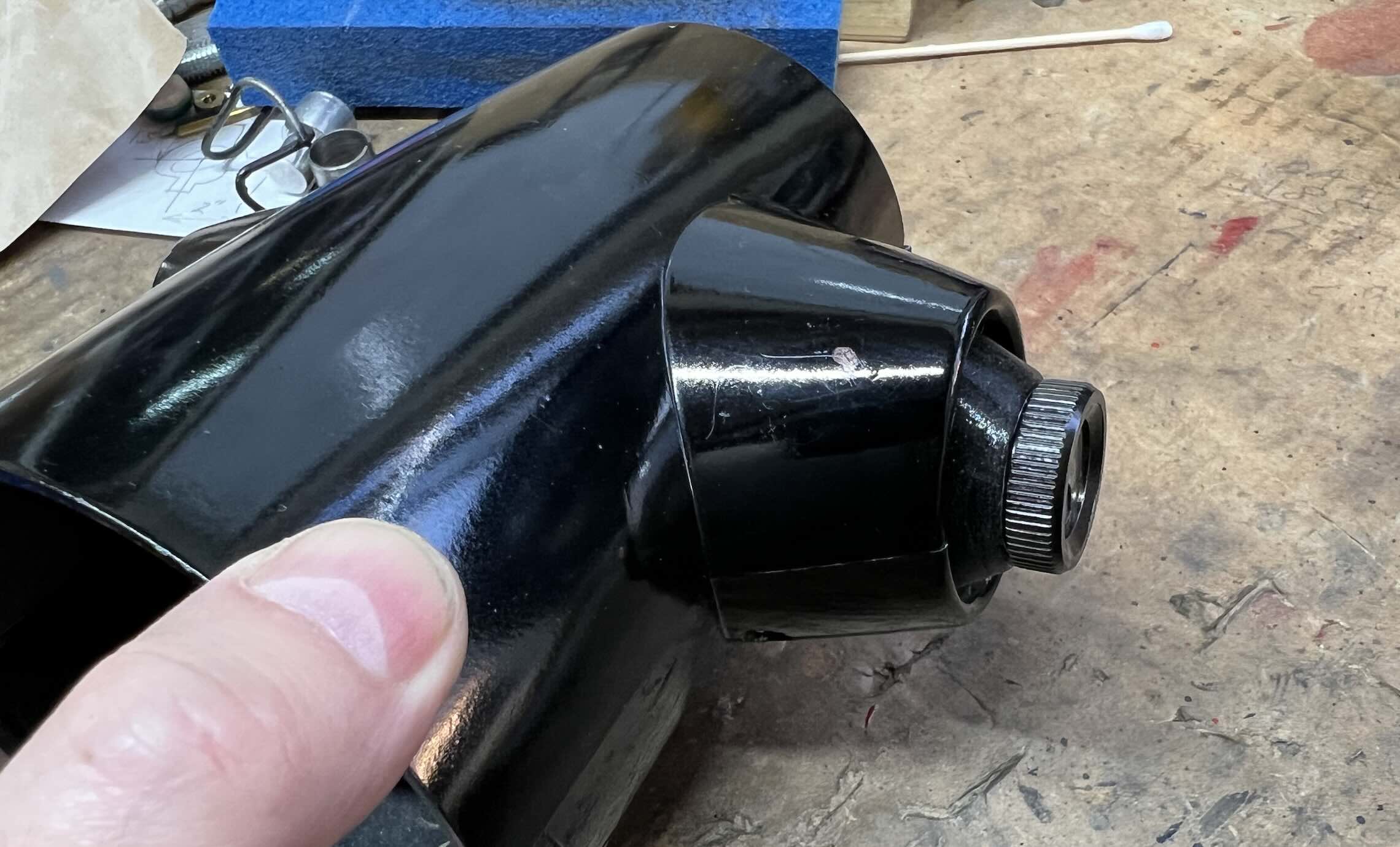

Turned out to be fairly easy. There is a molded feature on both sides of the column housing. One side is for the turn signal switch and the other side is for nothing. I think I saw that there could be high-beam switch or something in that side. Or for RHD cars. Anyways, mine was blank. I thought I would drill a hole in it and then realized that there was a rubber plug in it.

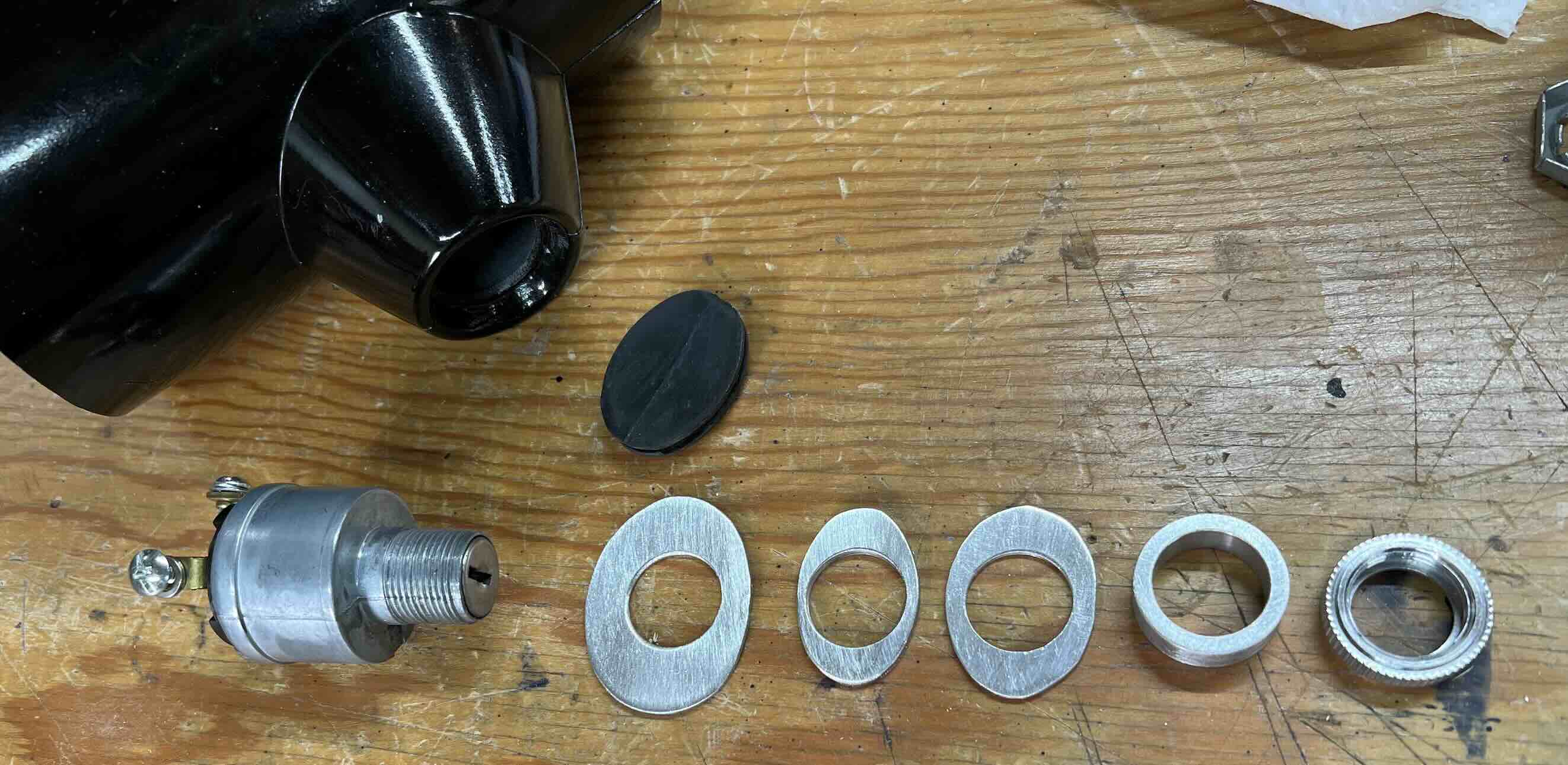

This is the housing with the plug removed and the various aluminum parts I made; just the 3 flat ones, the 2 on the right come with the switch.

This is how it works:
The 3 aluminum pieces simulate the rubber plug to trap the assembly in place in the column housing.

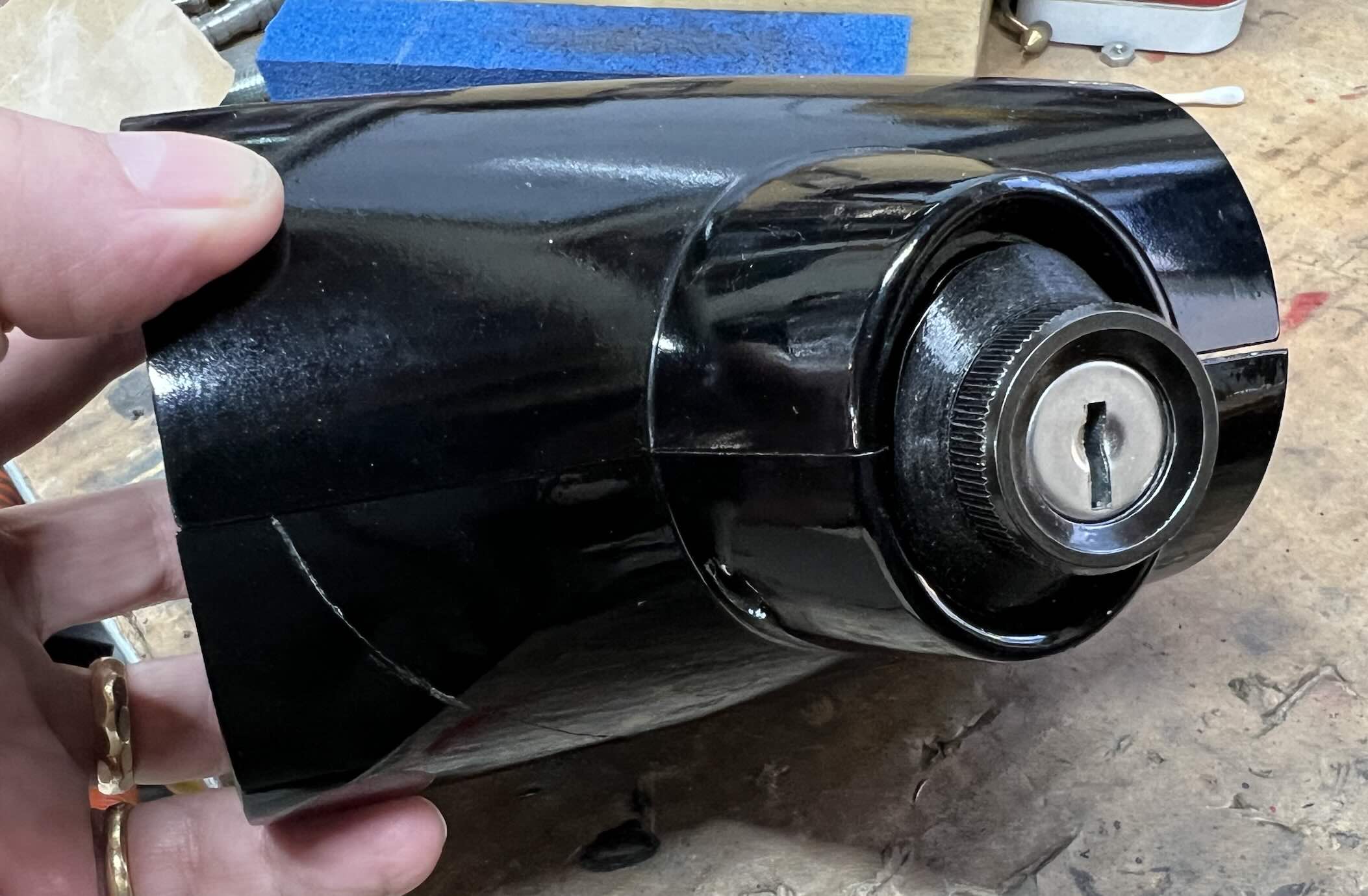

When installed it looks like this. I 3D printed a small piece to add a bit more refinement to it. And there is enough room inside to clear the steering column (which doesn't move with respect to the switch so shouldn't be an issue).

Gets the switch off the dash and adds a slight modern touch.

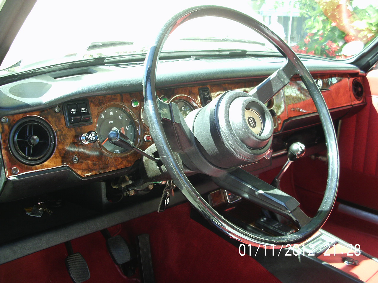

You pretty much copied what Rootes did for the Alpine overdrive switch but for the ignition switch. When the production of series Alpines and Tigers ceased the cars had a steering column mounted switch that also locked the steering column. Your set up looks neat to me! My Harringtons had the rubber mount for O/D but had a metal plate molded in the rubber piece which had a groove to fit over the ridge in the column cover opening and allowed a solid mount for the O/D switch. The LeMans had a second switch secured to the cover for the horn switch since it used a steering wheel hub that didn't allow the use of the horn ring on the wheel. If you decide to use any other switch mounted on the column you might consider doing that. I know of one car that has an on/off switch for four way flashers secured thru an opening cut in the cover. This photo shows how the extra switch for the horn was placed in the cover for the LeMans. When I assembled this car I bent a flat washer to strength things inside the cover for the horn switch.

Sean,
FYI, the Alpine gear lever lock was for the 4 speed transmission. If you look close near the package tray the locking ignition switch on one of my 69GT's can be seen .The key was at least double the length of what was used on Tigers / Alpines. Have you seen this key used on any other British cars? It has no name but does have the code FH 790.

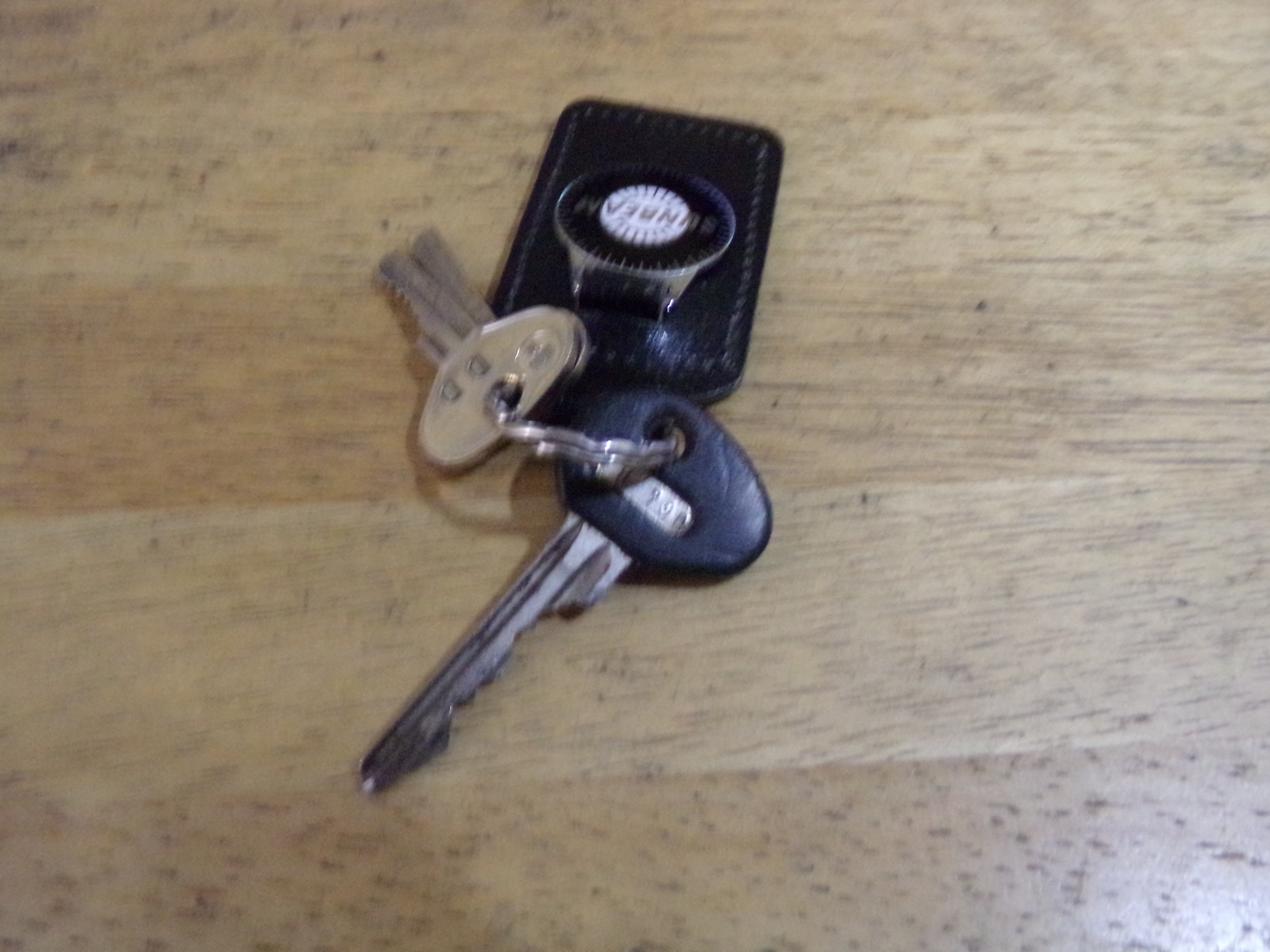

Clearly your late Alpine (Chrysler) has a Wilmot Breeden key. It's similar (but not the same pattern) to the keys used in late 60's/early 70's cars like the TR Spitfire and GT6, or TR6... and the MGB and Jaguar XJ6.
Thanks for your answer on the key. We'll be at several import swap meets in the next few months. Maybe someone at Carlisle will have blanks
