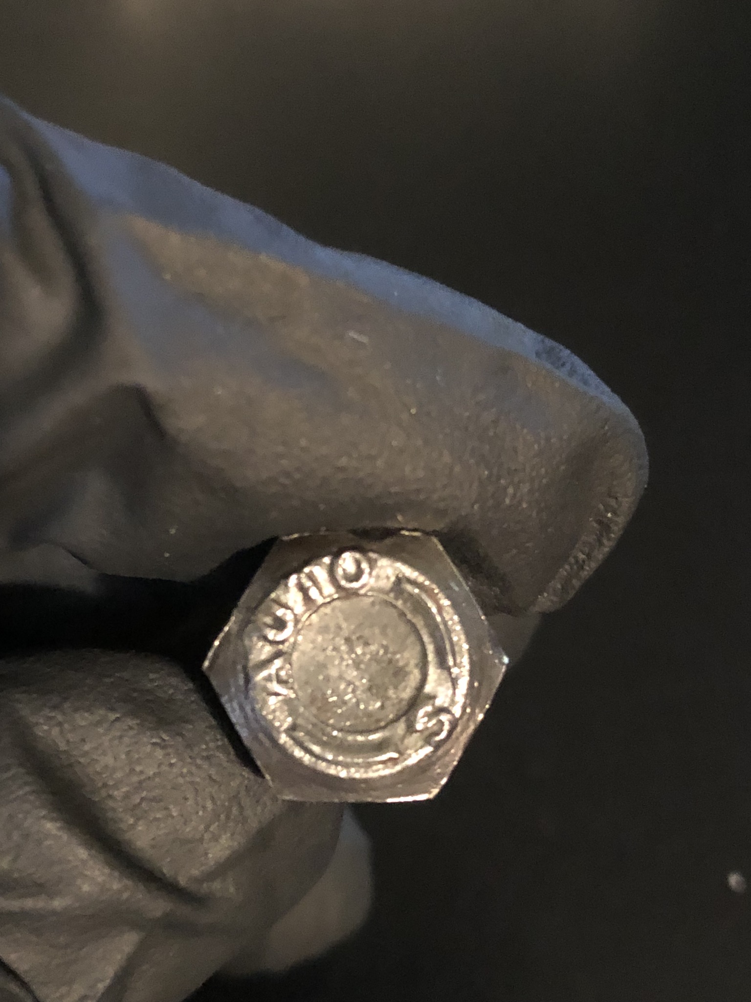

Hi All
I am slowly searching for and installing original bolts in some of the more conspicuous and less stressful locations on my Tiger. I am aware that bolts with the AUTO marking were used on Tigers. See photo.
My question is...Were any other bolts with different brand/type markings (beyond the letter designation for bolt strength) used on Tigers and were certain brands of bolts used in certain locations?
Thanks

That is where I found out about the AUTO bolts. It seems, however, that other brands/types with different markings might have been used also. Hoping somebody might weigh in with some reasonably definitive info.
