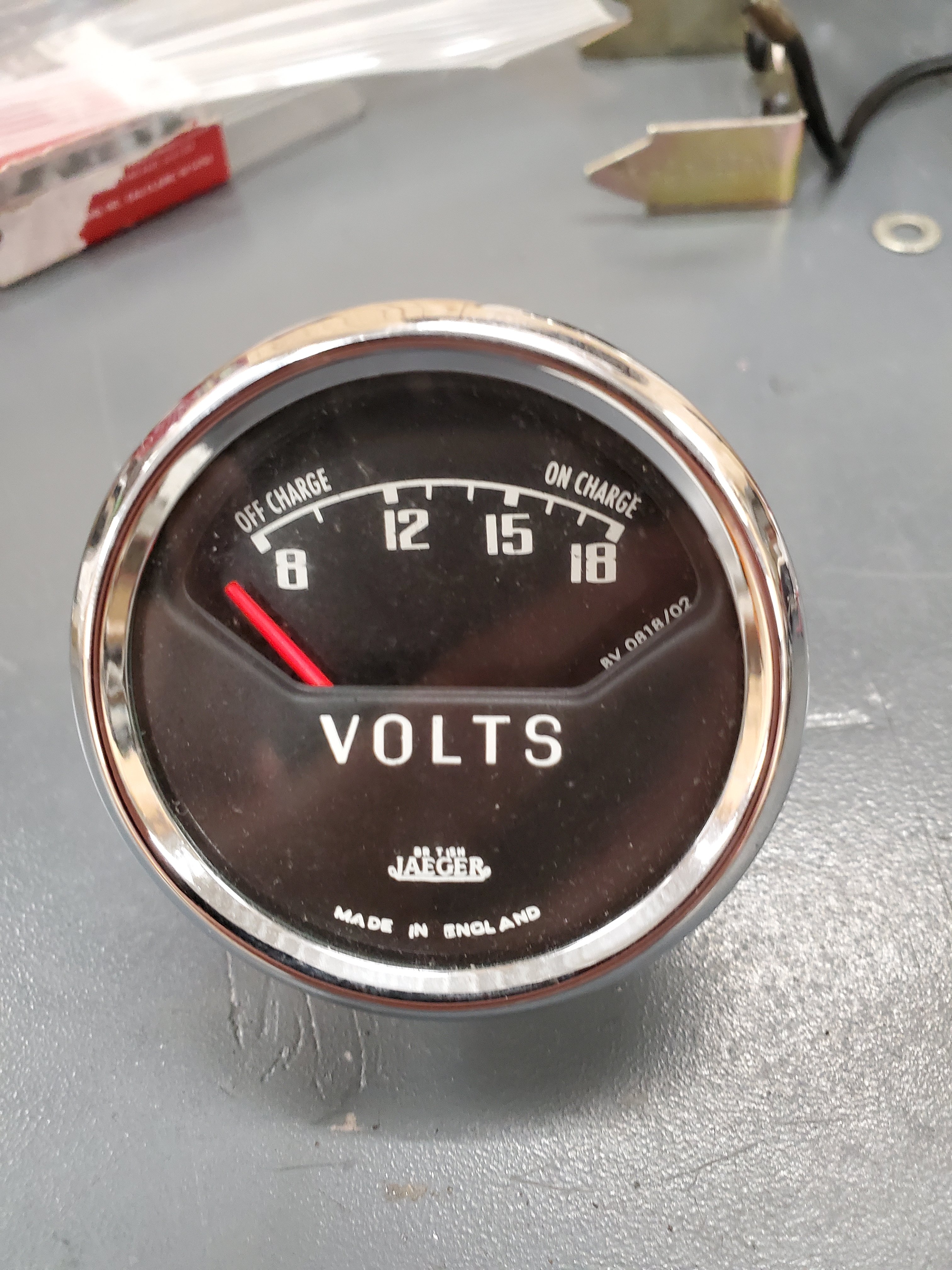

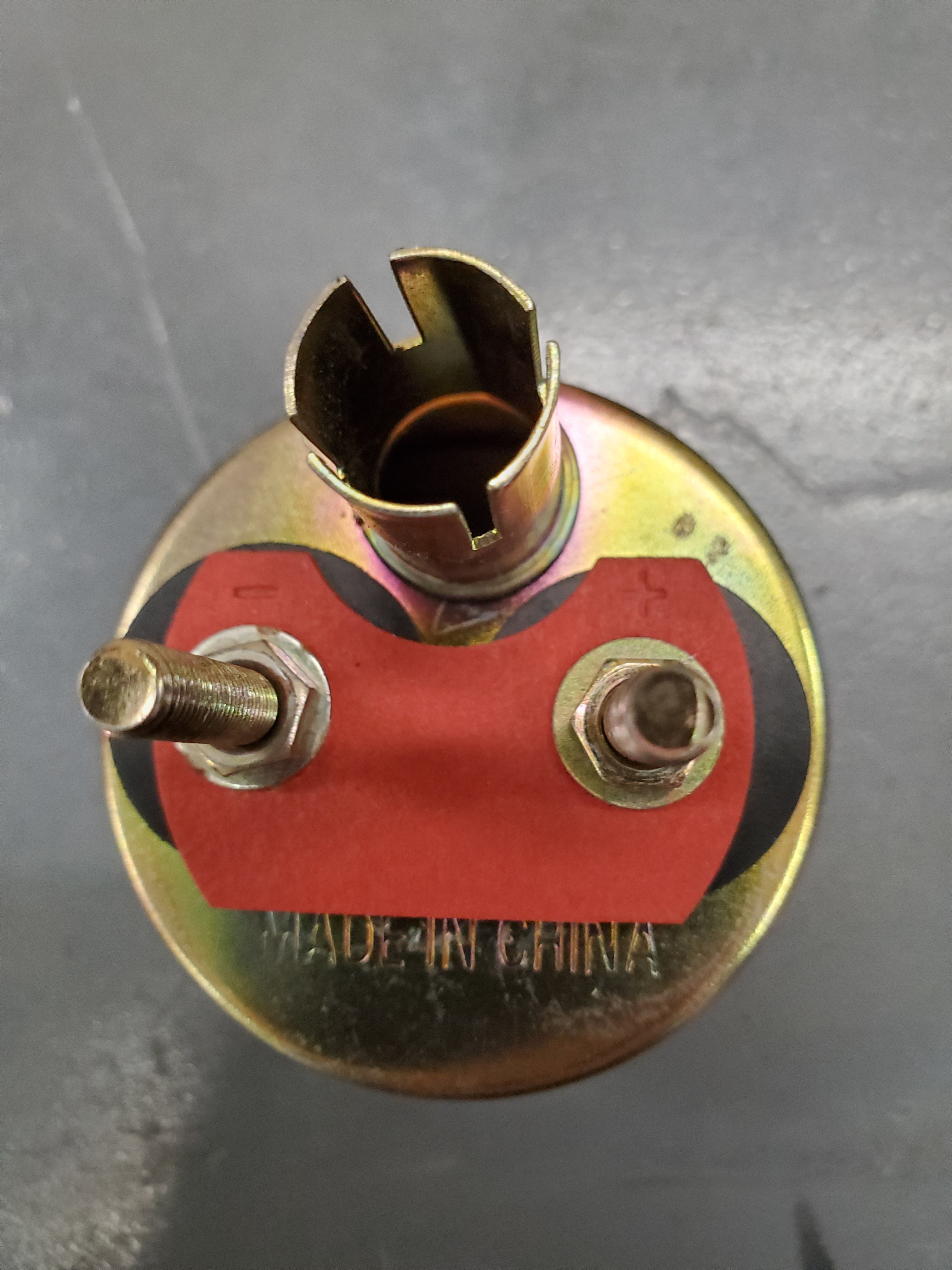

A second problem occurred as soon as I tried to connect the battery. The ground wire on the volt meter illumination bulb fried with an impressive amount of smoke. I don't know why it fried. I think I had it wired up properly. The back of the gauge has a "+" terminal and a "-" terminal. I wired the positive terminal to the No. 2 spade connector on the ignition switch, which I believe should give it keyed power. The negative was grounded to the tach mounting post thumbscrew. The bulb socket power wire was wired into the daisy chain power wire that goes to all the other gauges. The ground wire for the bulb socket (the one that burned up) was grounded to the other mounting post thumbscrew for the tach. Does anyone see a problem with this wiring method? Another couple important piece of info: 1) the volt meter has modern guts installed in a Jaeger gauge; 2) the bulb was replace with an LED bulb.
Could the generator being polarized positively caused the burned wire? I did not even attach the battery cable, just touching the battery post was enough to fry the wire.
