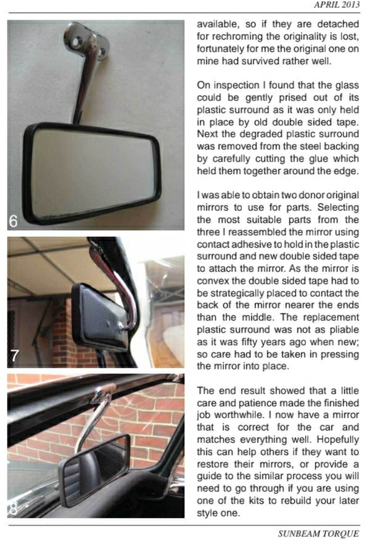

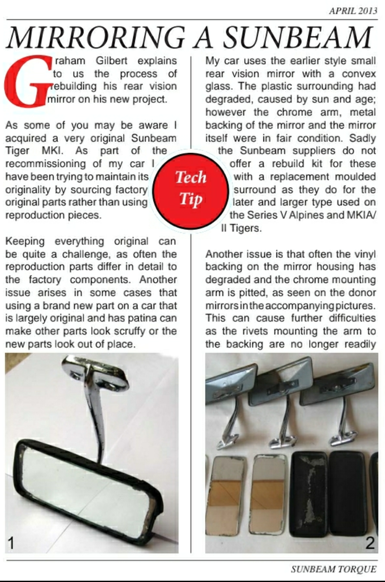

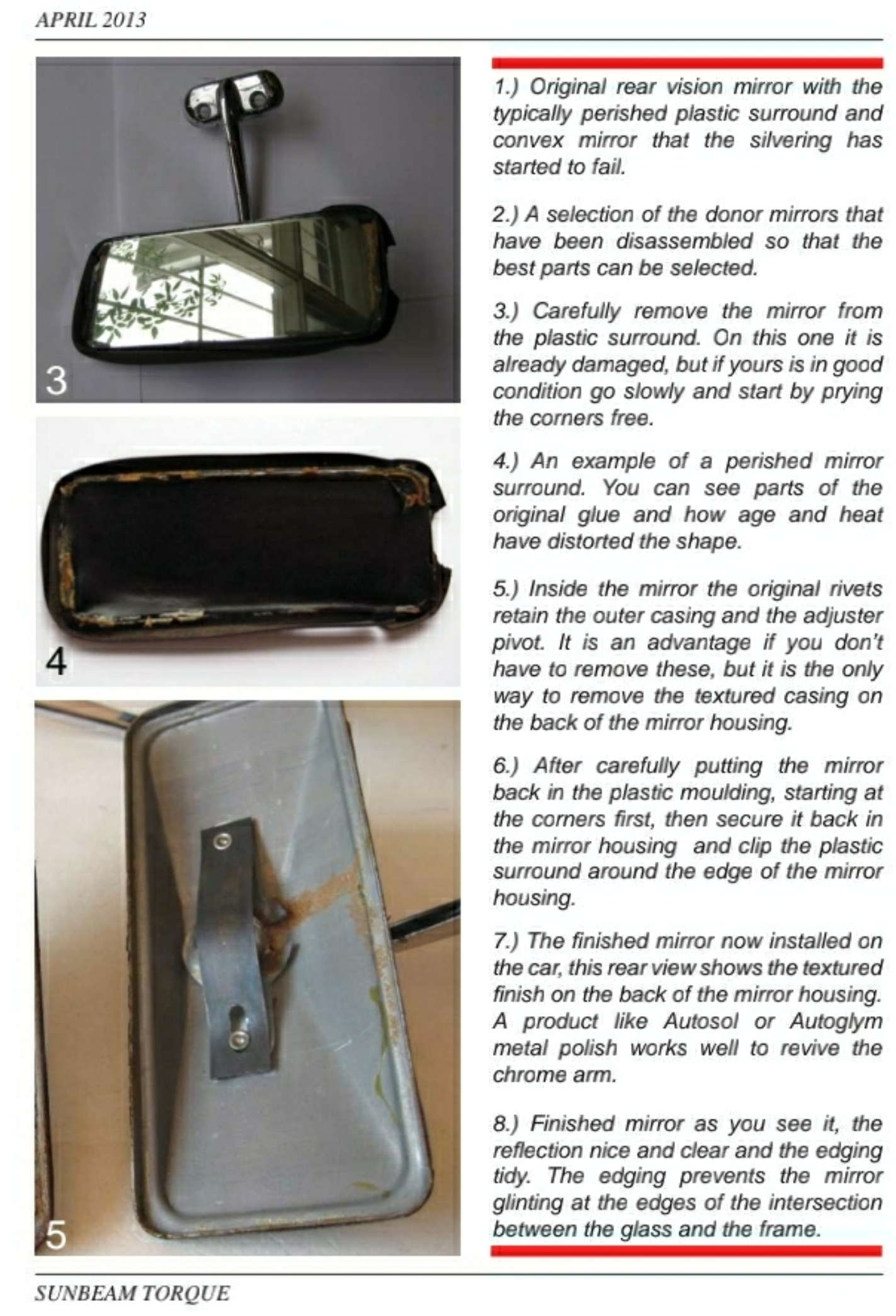

A question for any of you that have replaced the glass insert for the rear view mirror. How did you do it? It almost looks like I need to break the old one to get it out of the frame. Is this correct? The existing one was probably replaced long ago based on the thin layer of rtv holing it to the frame plus it's probably been glued to the frame as well. I don't want to get medieval with it if I don't have to.-Brad
